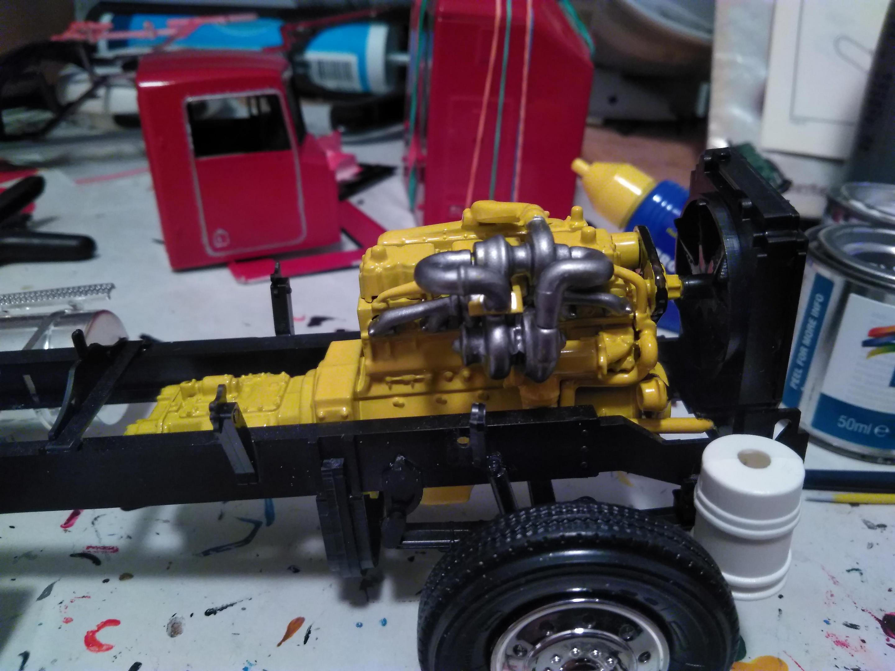

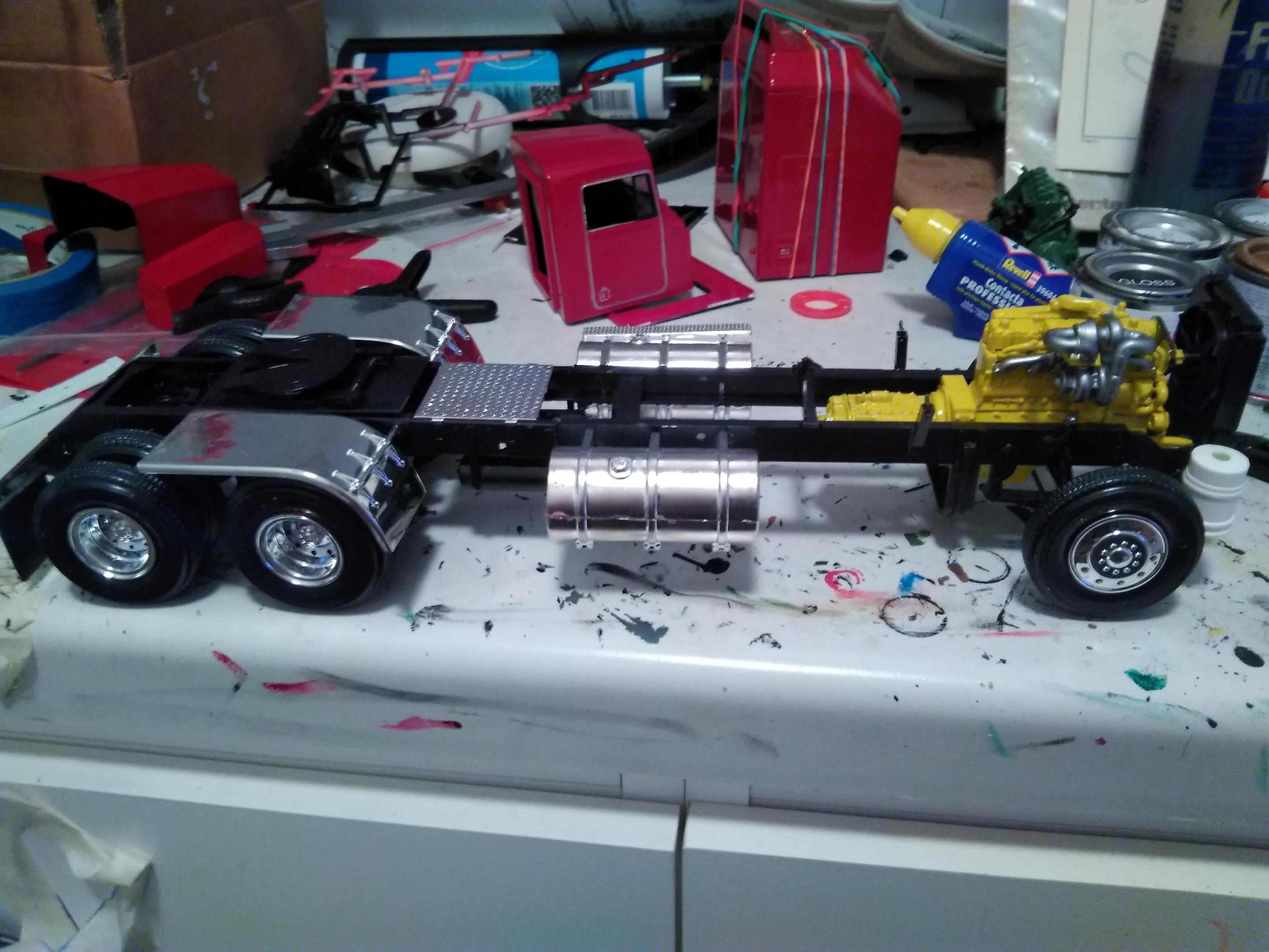

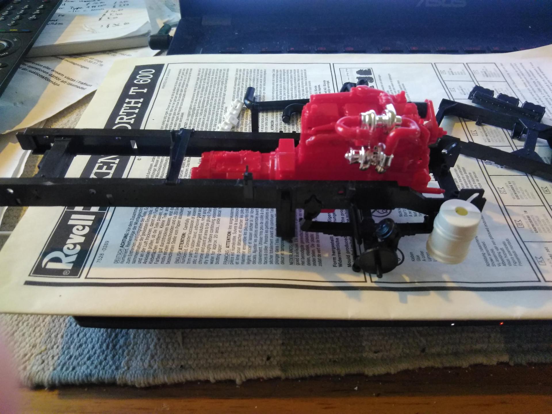

I started this a few weeks ago but there are so much wierd things in the instructions so i decided i wanted to share them.

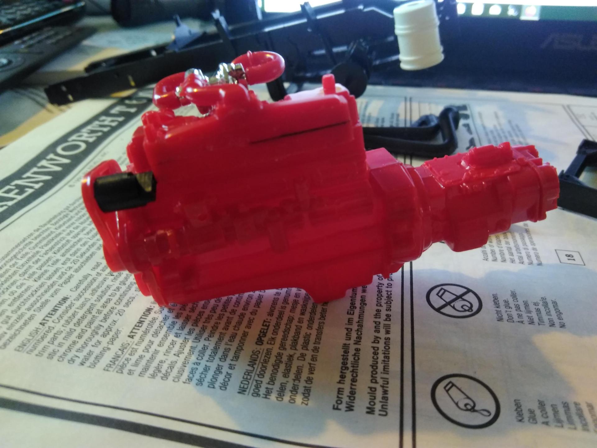

The front frame half is almost complete and the engine just needs paint now.

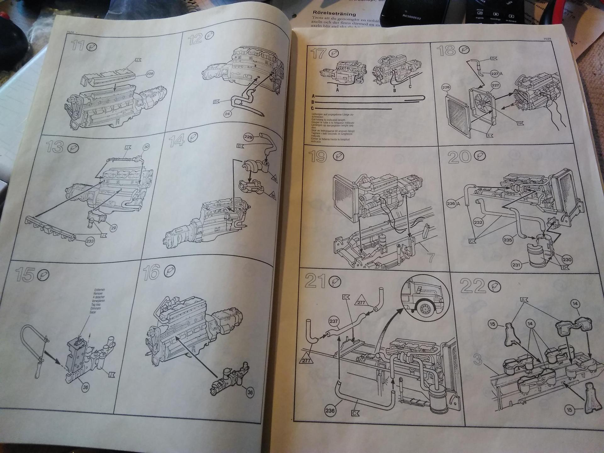

Now for the wierd parts in the instrucions.
Both of them are for the T600 with the 7528 revell number and printed the same year 1991.
One was included in the unopend kit and the other was from internet that i found after some searching.
First the one from the kit
Now the one from the internet, remember they the have same number and same printingyear:
Notice anything?

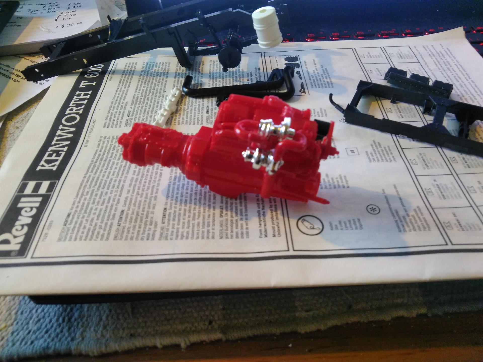

Also the engine could not be built as it is shown in the irl manual as the turbo and pipework would not work at all
The AMT version is not the best representation of a T600 but the Revell T600 is not exactly correct either as they took quite a few shortcuts too.
The turbo plumbing looks a bit weird on the upper instructions as they show just one turbo and the crossover pipe goes in at the wrong position on the aftercooler, but I don't see anything wrong with the turbo plumbing in the lower instructions.
Here is how it looks on a real NTC 475.
Edited by Force
I ended up building it like the lower with the twin turbos as that was the only way it would look good and not having parts mounted in the air.
I just think it is odd that 2 instructions for the same kit and from the same year show different ways to assemble it.
With my irl verion i would not have got the engine and turbo together.

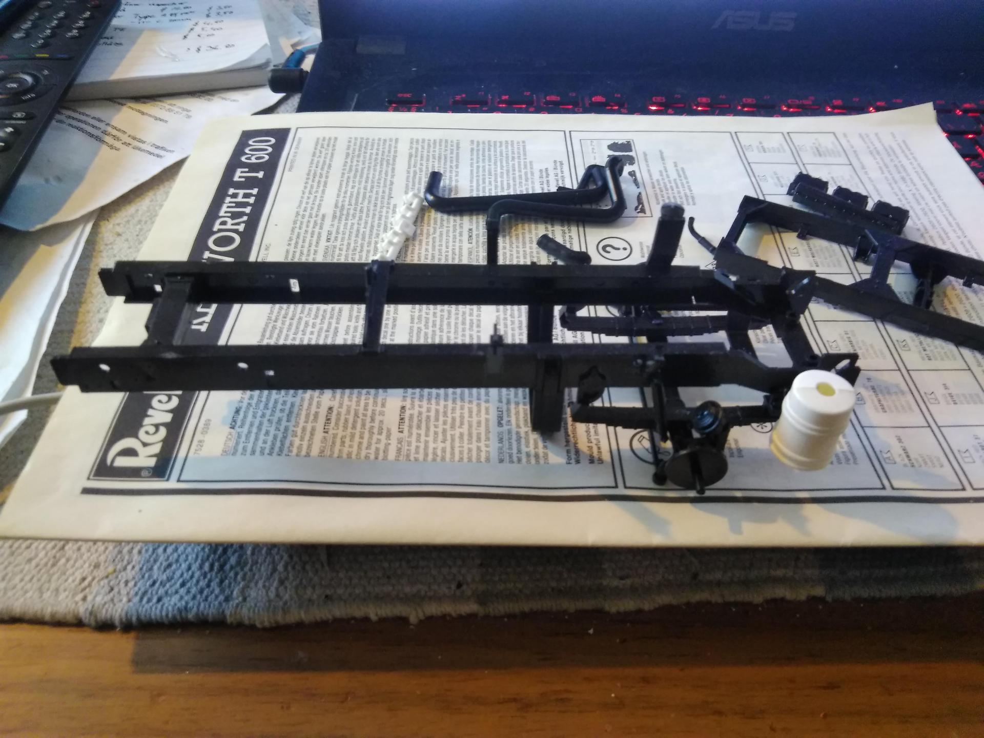

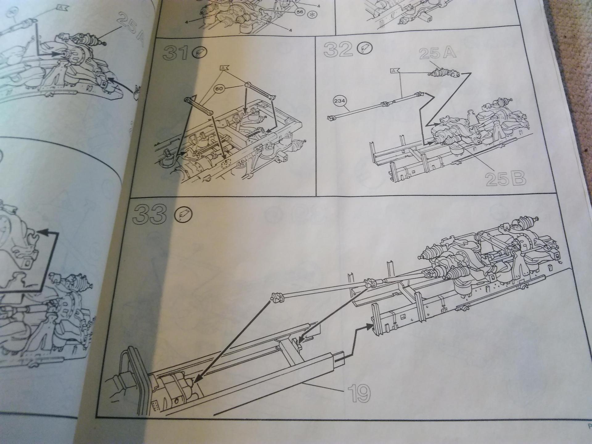

Also step 33 in my manual shows how to put the frame together again after boht sections are complete.
Step 32 show that in the online manual + that i should use a stepplate part 238 (forgot the name) to hide and possibly support the frameparts
I have that part but its only half the size + the exhaust pipes are way different in each manual.
So i wonder what happend?
If my kit is a earlier version and the online manual is a later one where they corrected alot of things.
I use both anyways so i can crosscheck to see what manual makes more sense sofar its about 50/50

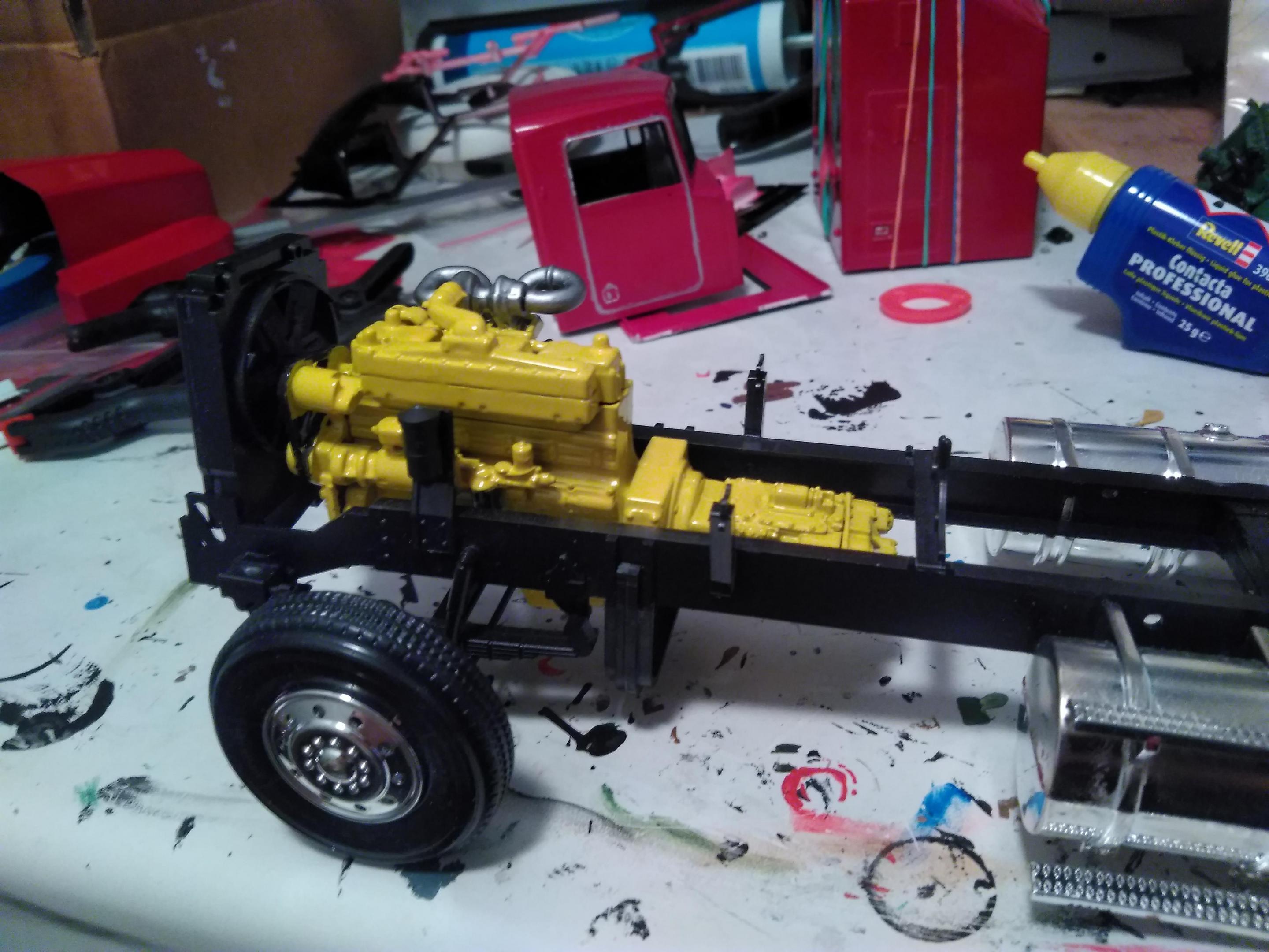

It looks like you have some progress and it looks good...the yellow Cummins engine stands out a bit and should originally have been beige.
I know that the eninge should be beige but i am tired of painting almost all truck engines in beige just because everyone have a Cummins in them.
I wanted something different.
Next might be black as some Cummins engines we use at work are black.
But those are not Cummins ntd/ntc they are Cummins qsm engines.
Well, now I am sad. I built the AMT version of this kit and it was ‘an experience’ to put it kindly, I also bought one of these kits thinking it HAD to be better than the AMT offering, but it looks like it has its own issues as well .
having said all that, you look like you’re winning the battle, it’s looking quite good!
Try this:
Most of the Cummins N14 I have seen are also black, some with red valve covers.
As far as I know there is no Cummins with NTD designation, I think AMT had it wrong when they did the White Western Star, it should be NTC 350 not NTD 350.

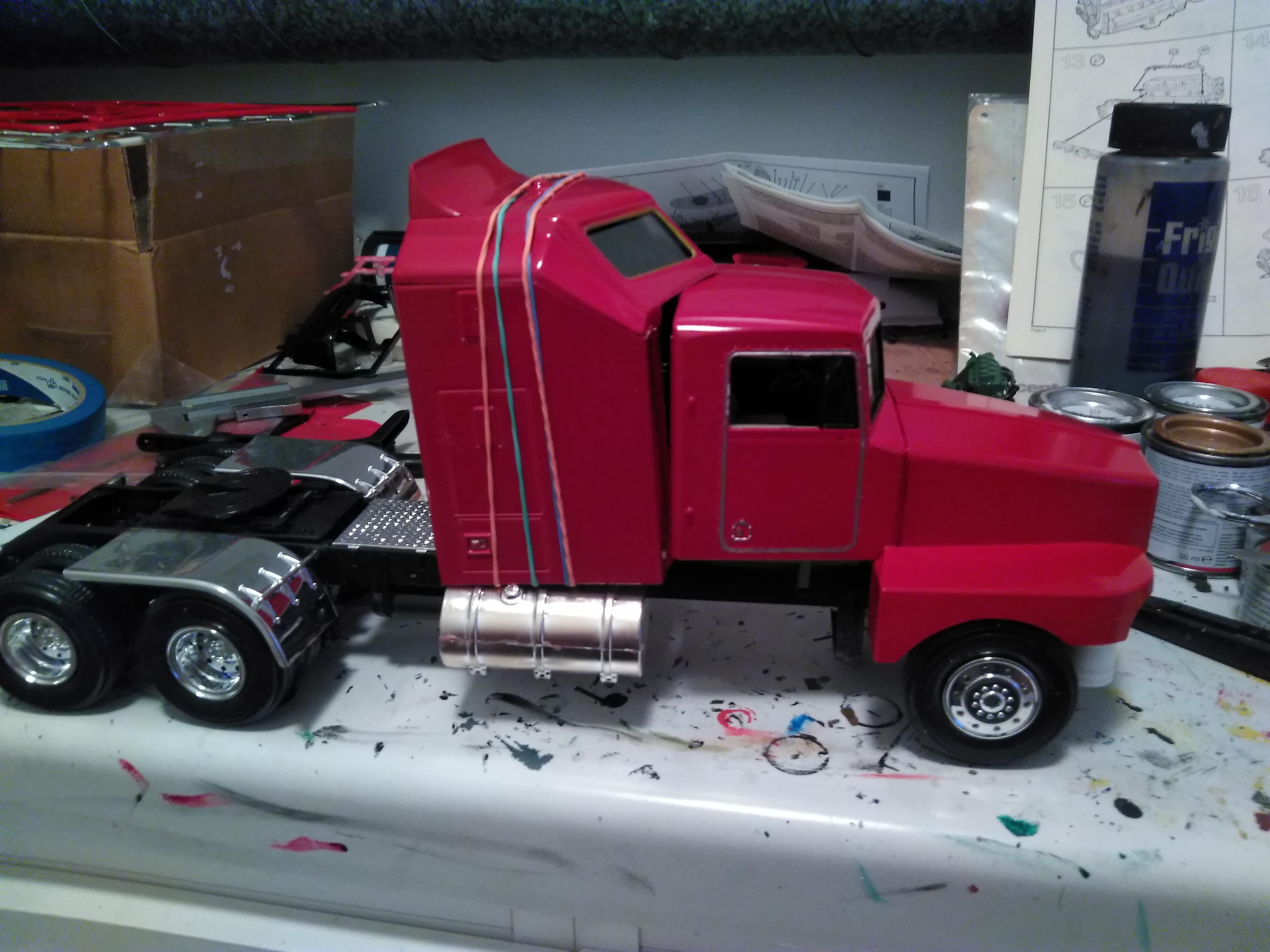

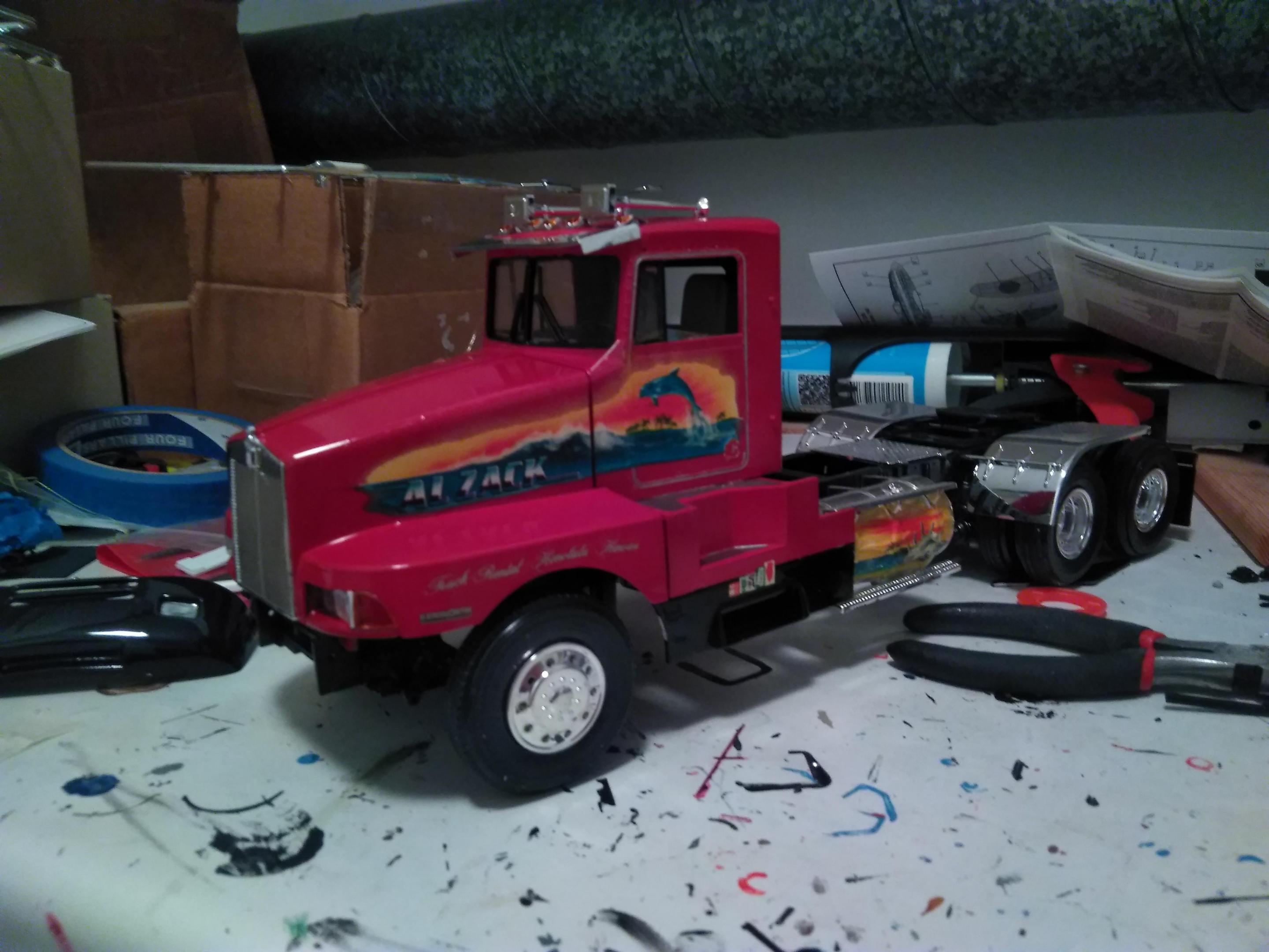

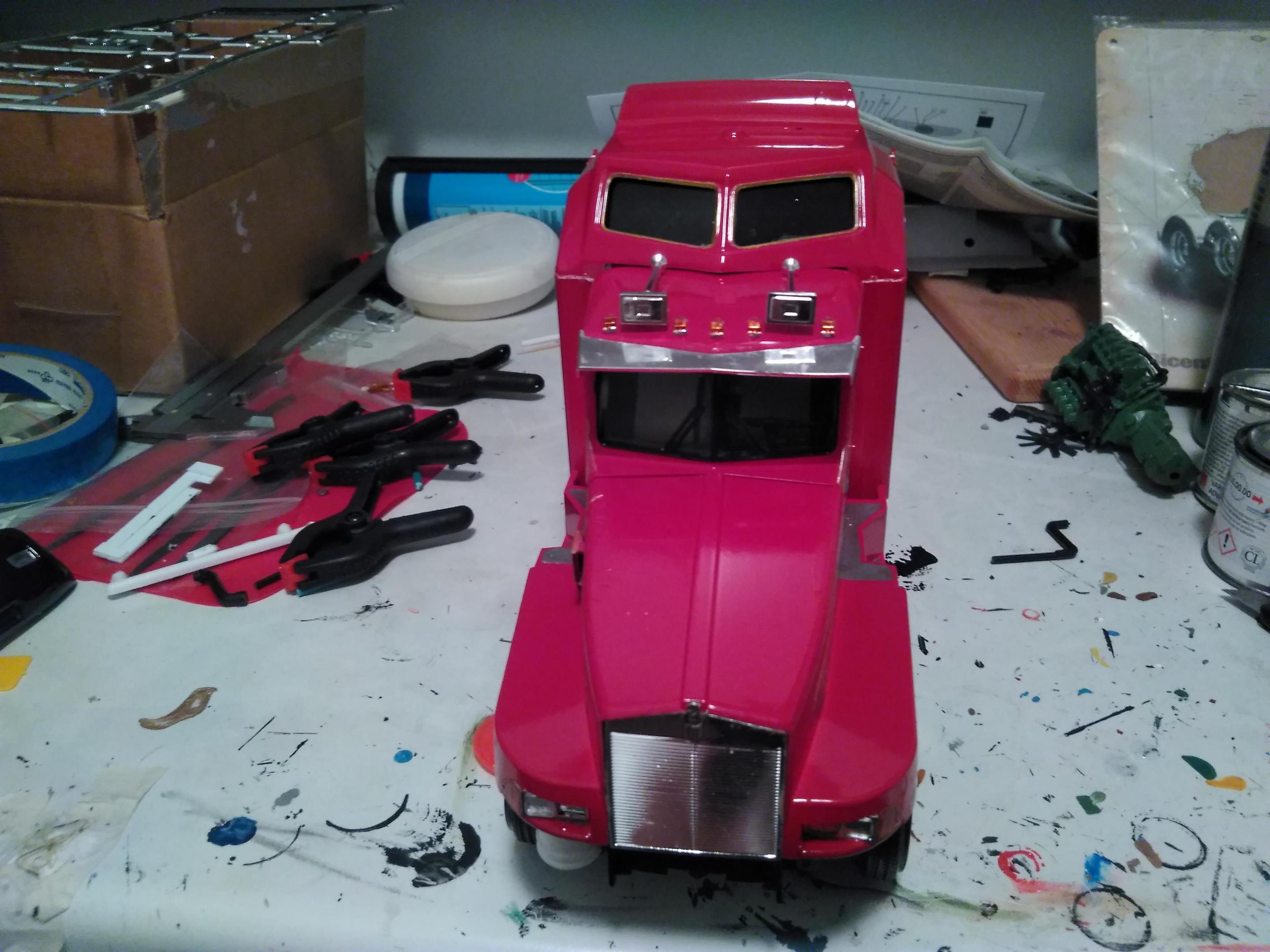

Done some more work on this and honestly not even surprised that not even the decals fit good.
Have to do some trimming on them when they have dried.
Passengerside looks really bad.
The gap between the hood and cab is as good as it gets.
Also i think the horns looks way to big for it but the other for a K100 that also are in it looks to small
It might look better when the rest of the chromeparts is on it and the sleeper with its decals.

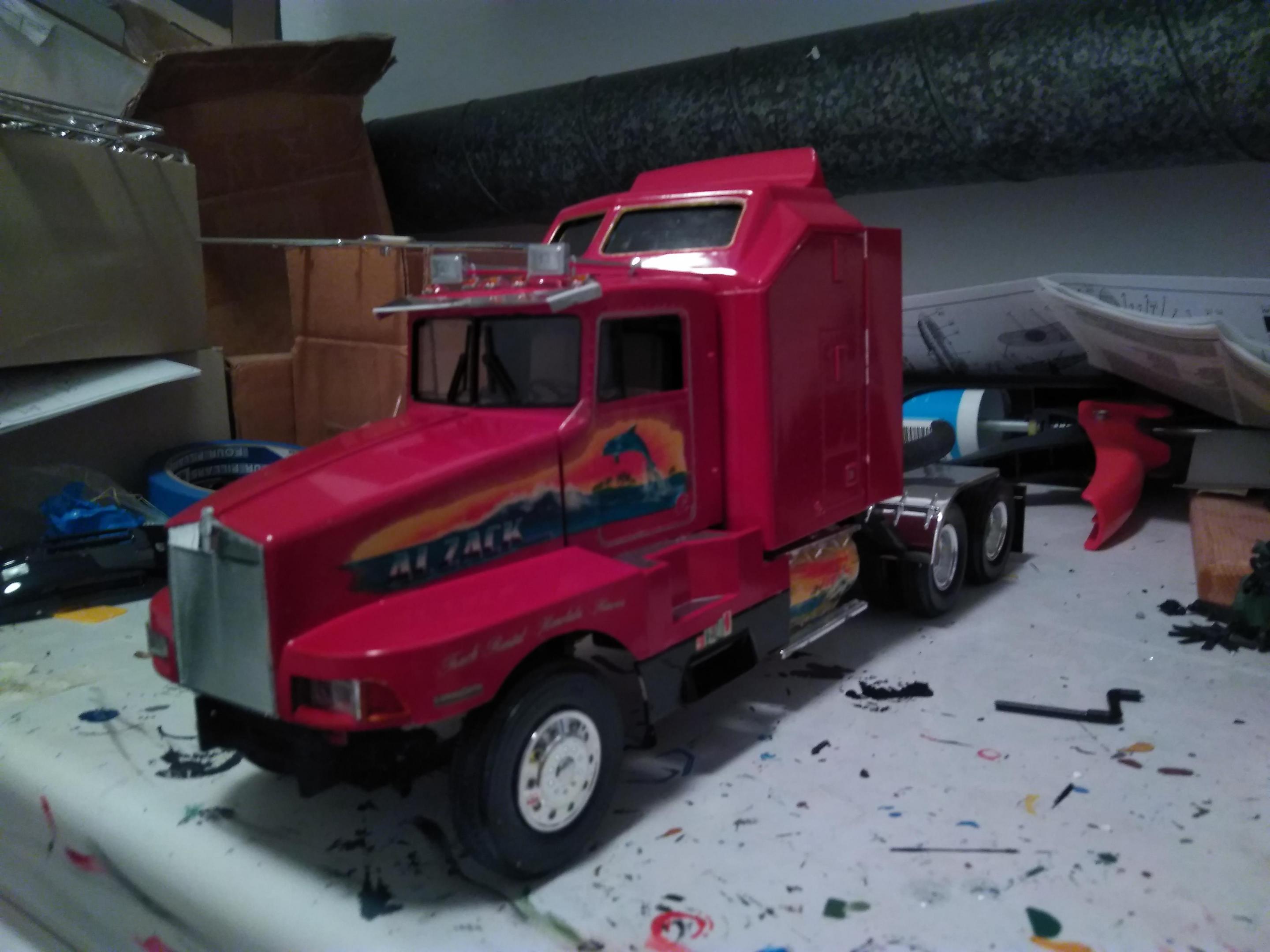

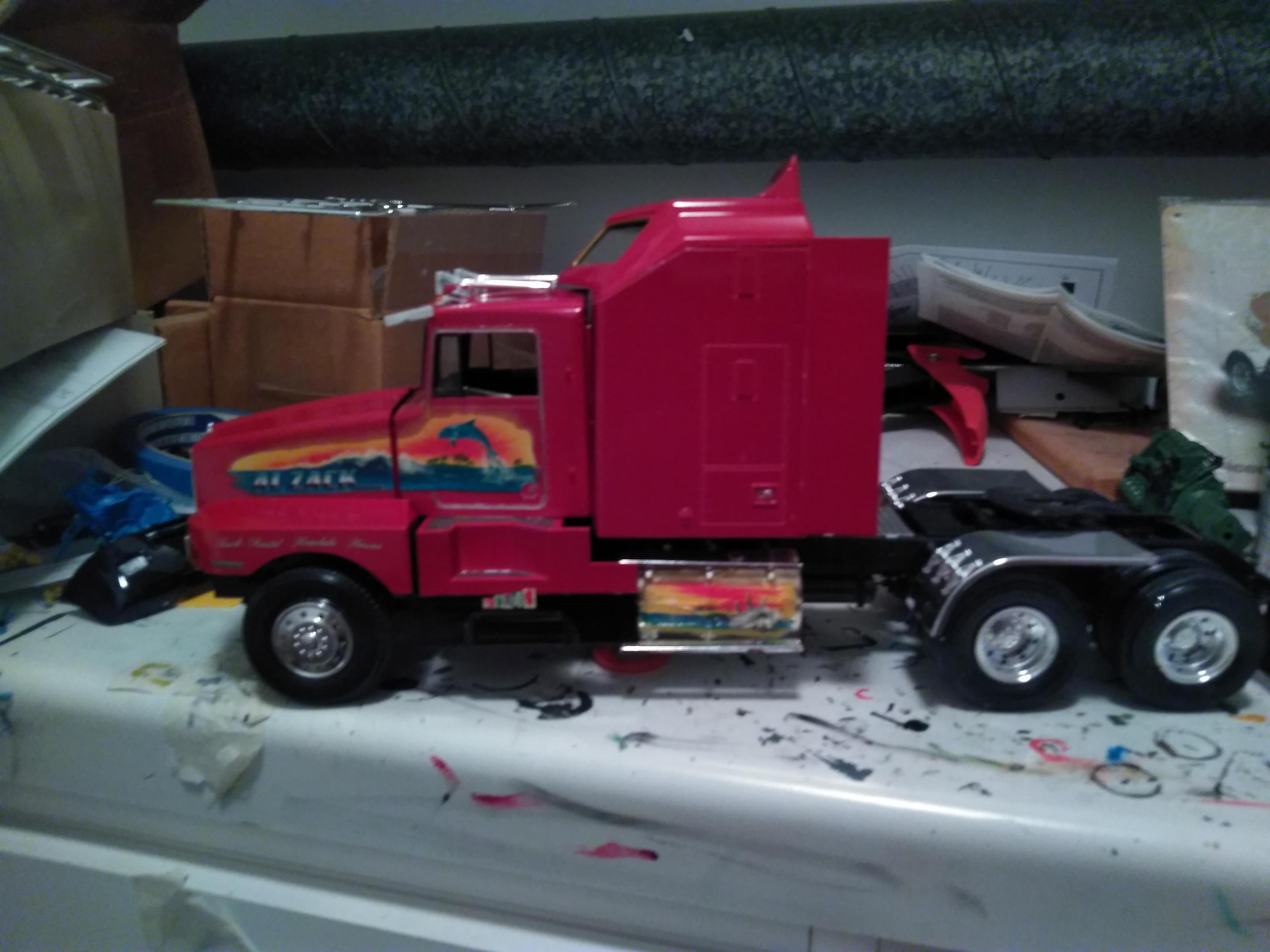

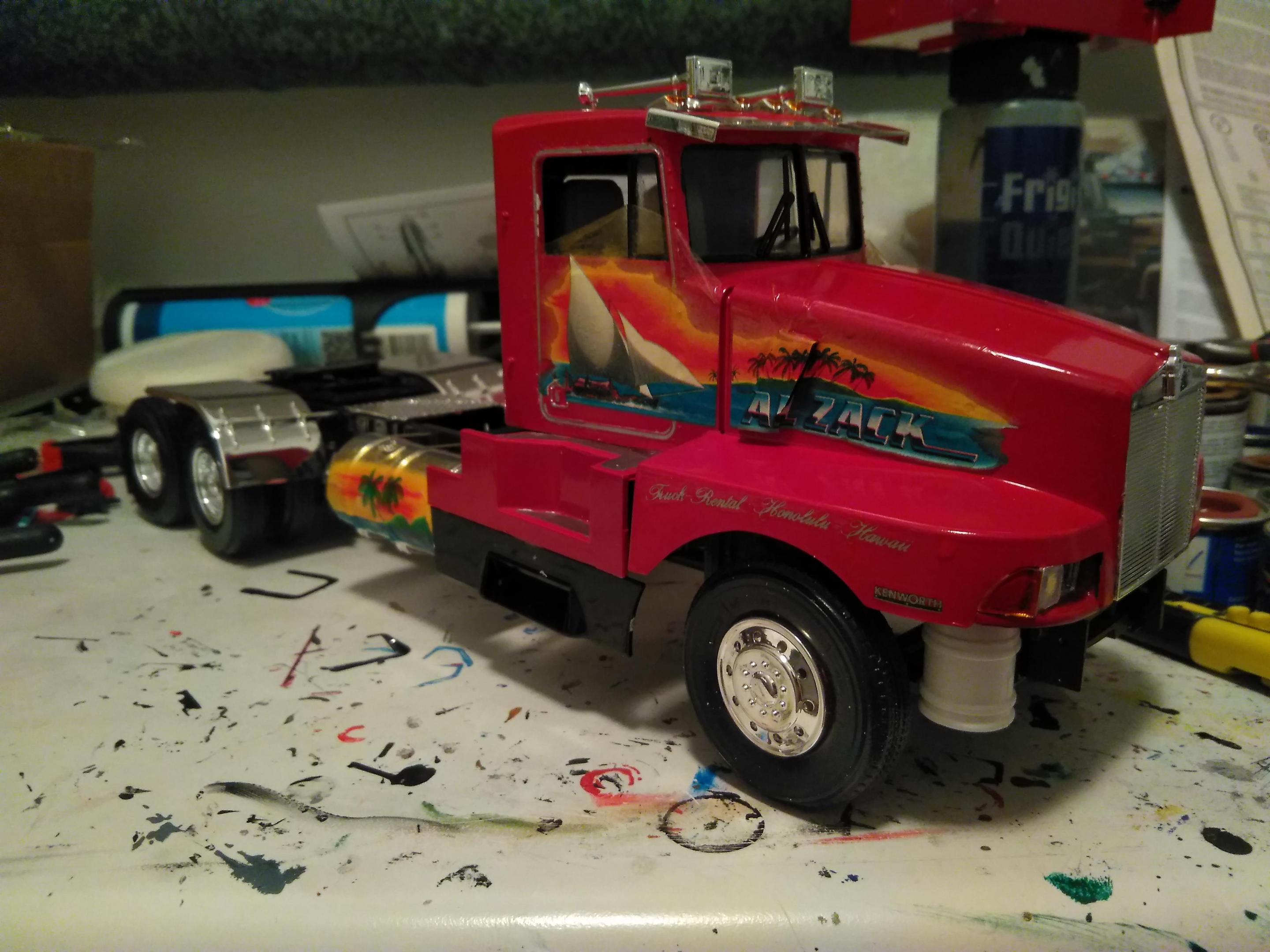

Finally did the last things on this and surprisingly the decals on the sleeper were no problems at all.
Will soon be in the under glass section.
Only real problem was one i created my self when i dropped one of the lenses for the headlights and did not find it again.

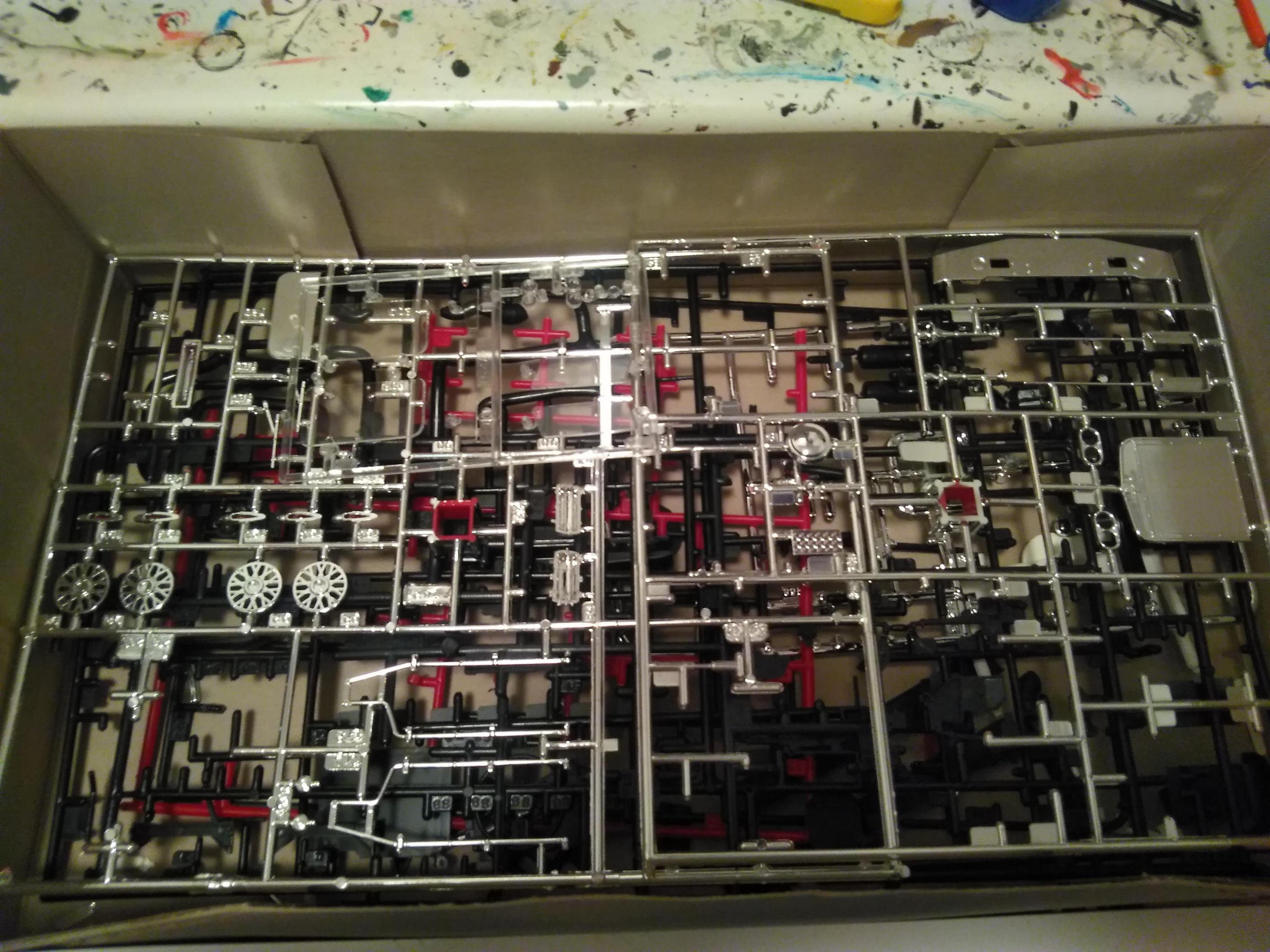

Also being used to normal truckkits with maybee 5-6 left over parts this had a "little" higher partscount.
There are 7 sprues left and the chromesprues do still have almost all of the parts left on them + a complete set of glass for the Kenworth aerodyne cabover.
Here are the leftover parts:
