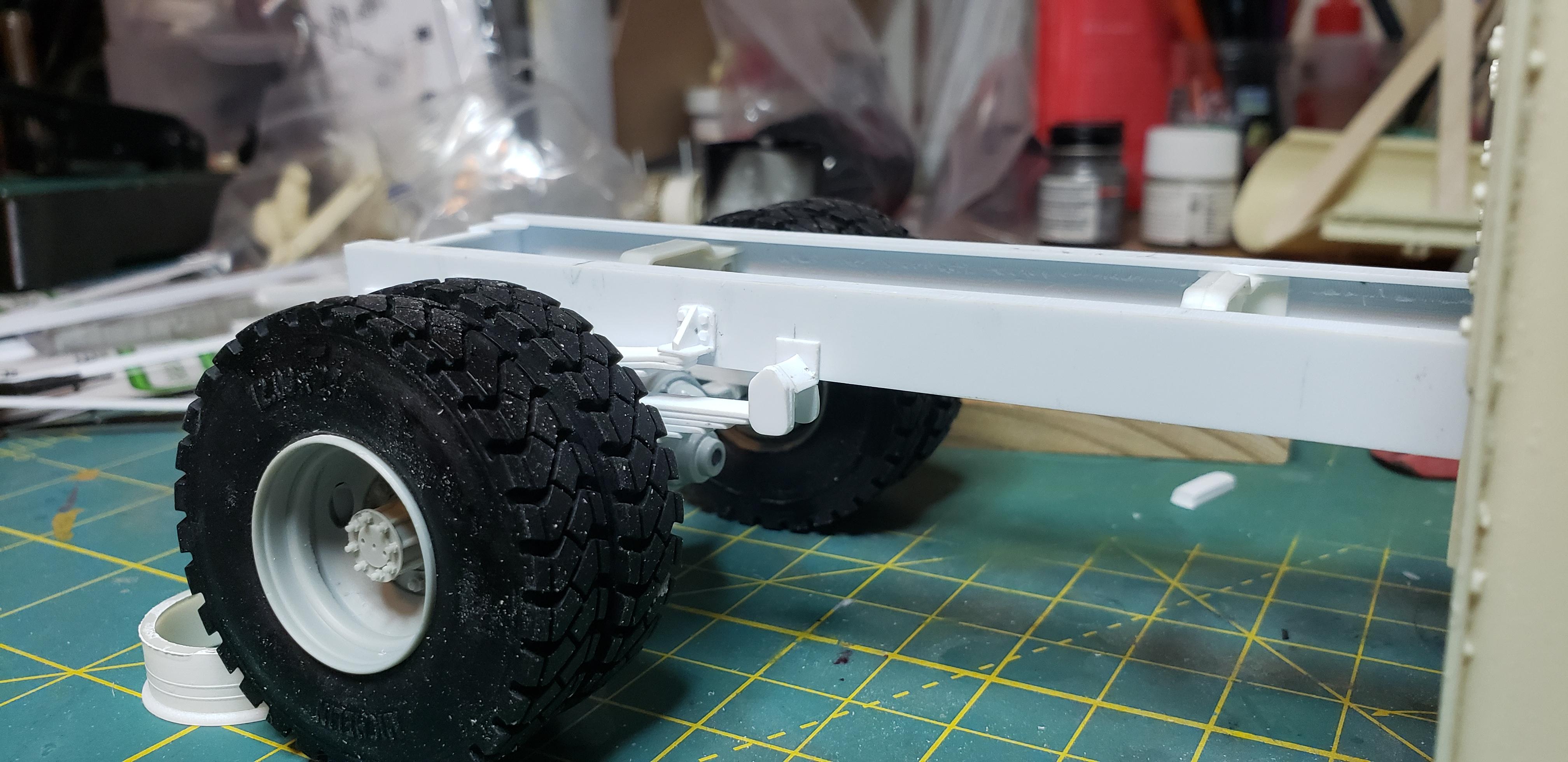

gotnitro? Posted December 8, 2019 Posted December 8, 2019 A project I wanted to tackle was a snowplow, and not just any plow..I wanted to build an Oshkosh snow plow . When the snow started falling here in Huskytown , the time had come !!! I started this build the same way I usually do, collect tons of actual photos and info about the truck. Luck was on my side because the local highway dept that owned my Brockway, also had one . The parts list required was large ! Luckily I had purchased the P series cab from Jamie at moluminum months ago before I knew what project it was to become. Normal kit tires wouldn't work for such a large truck, and then the elephant in the room..the Frink plow / wing assembly. The stars aligned w a chat w Ryan Pedone, he had cast a few more sets of his plow s , and a few weeks later the box arrived ! Beautiful parts filled the box. The tires posed another challenge, finding big tires like this truck used was sparse. A text to moluminum ended the hunt, Jamie had just finished a set of heavy duty truck tires, and they fit the 22 inch deuces I needed! That's a 20 inch drive next to them !! Time to get building!!!! Scratchbuild a frame from Gary Wallace's cnc rails, to assure everything was perfectly straight, drop a few parts box crossmember and I had a solid foundation

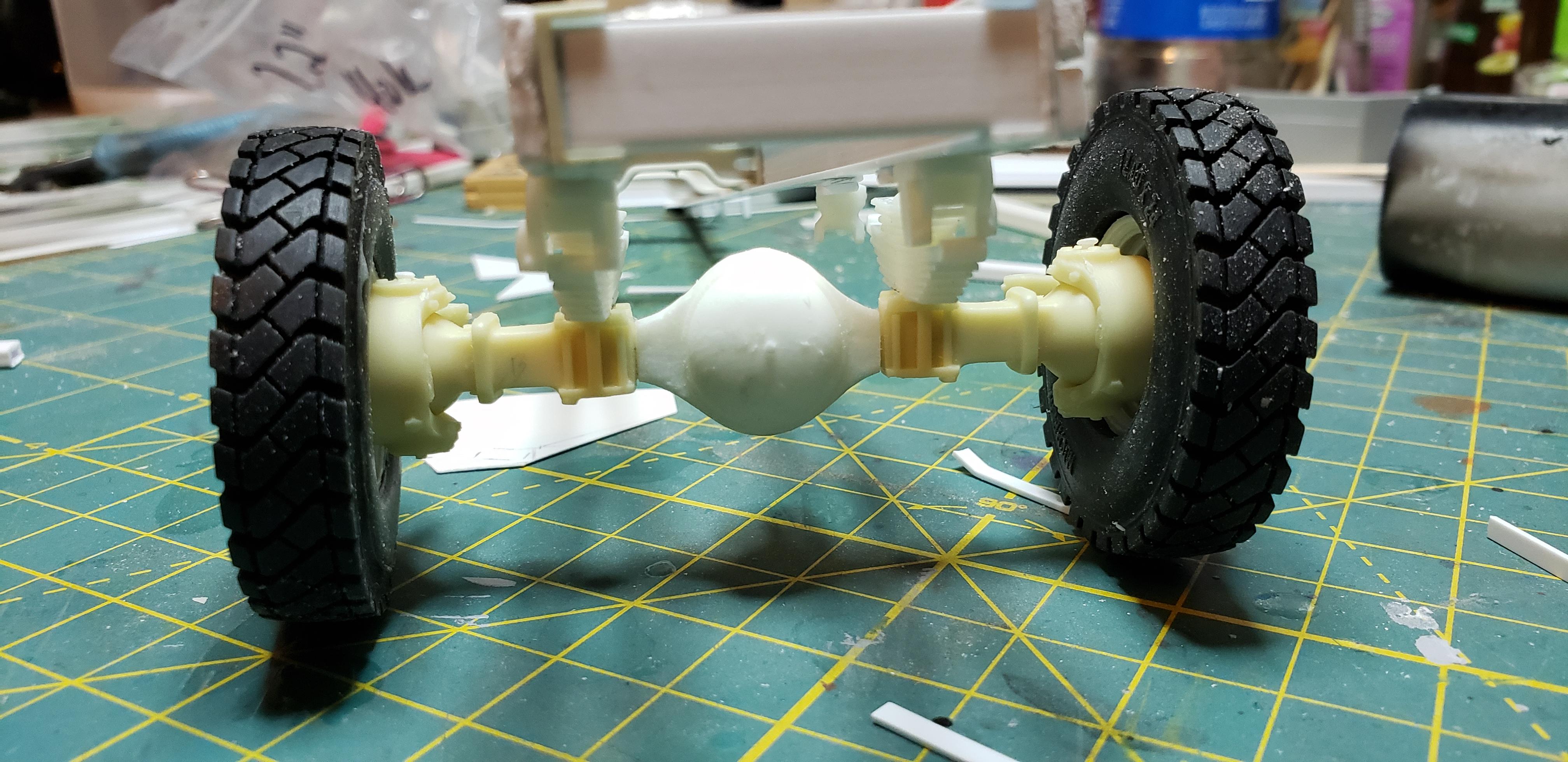

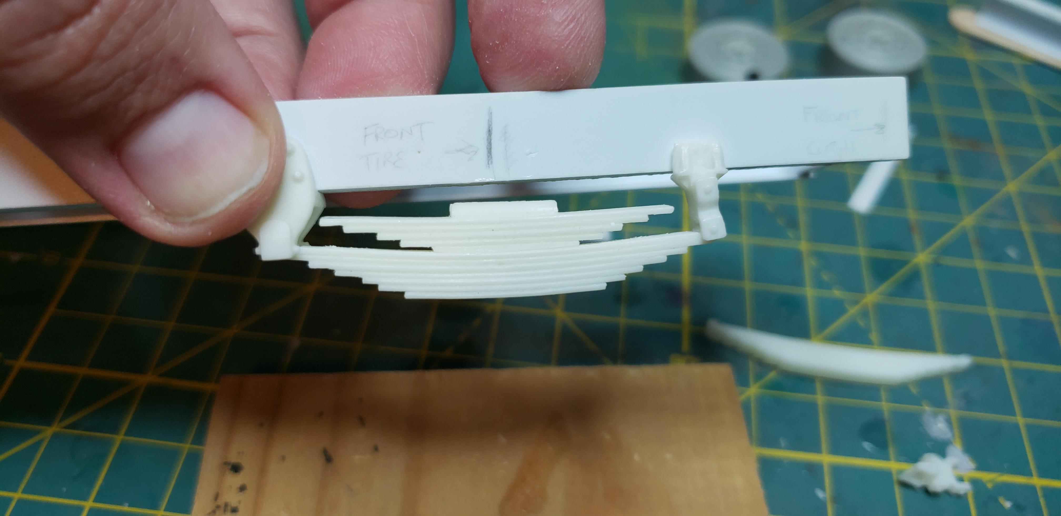

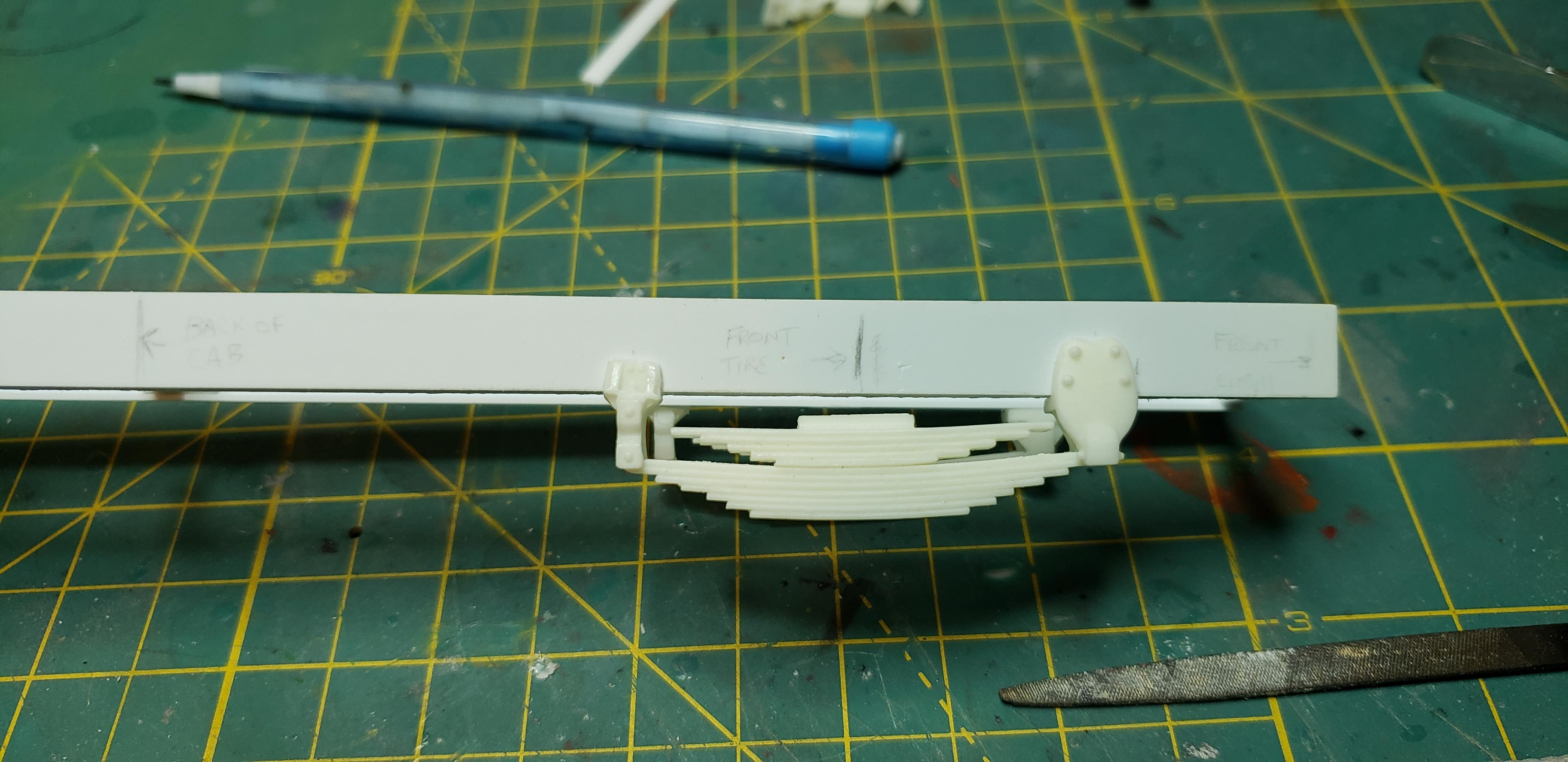

gotnitro? Posted December 8, 2019 Author Posted December 8, 2019 These trucks had heavy duty springs all around, so I scratchbuilt a stack using 030 x 156 evergreen strips, including the overload section. The eyelets are tube . The mock up axle was from parts but I'll swap it for a paystar, this one looks a little light duty for turning those tires . I propped the cab and plows for a look, nothing keeps the motivation going like seeing everything sitting together. I was grinning ear to ear right now , something about a rugged truck and that huge mailbox smasher was really working . Now the front axle..Gary surprised me w parts perfectly suited for this truck, perfectly cast spring stack w overload leaves, and beautifully cast mounts . 5 minutes after opening the package I had a proper susp. Yeah..I had the mounts flipped around , I sorted out my mistake haha ! I used the knuckles off a steerable axle and the gearbox from Gary's front axle to make my front diff. Sometimes you can have your cake and eat it too !!! Everything was drilled and wire glued inside to avoid issues later That's it for now thanks for following along , any comments welcome as always
