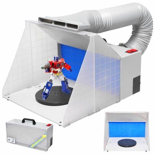

yh70 Posted December 9, 2019 Posted December 9, 2019 (edited) i brought one of these years ago and love it..its CE Approved and u can connect as many together that u need... https://www.ebay.com/itm/Portable-Hobby-Airbrush-Paint-Spray-Booth-Kit-Exhaust-Filter- Edited December 9, 2019 by yh70

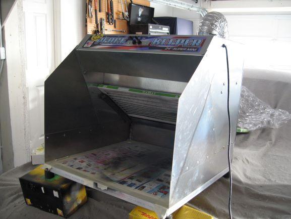

BuilderX Posted December 9, 2019 Posted December 9, 2019 (edited) Just bought a pace peacekeeper 24" mini plus booth. www.pacepaintbooth.com good rating on this booth. Edited December 9, 2019 by BuilderX

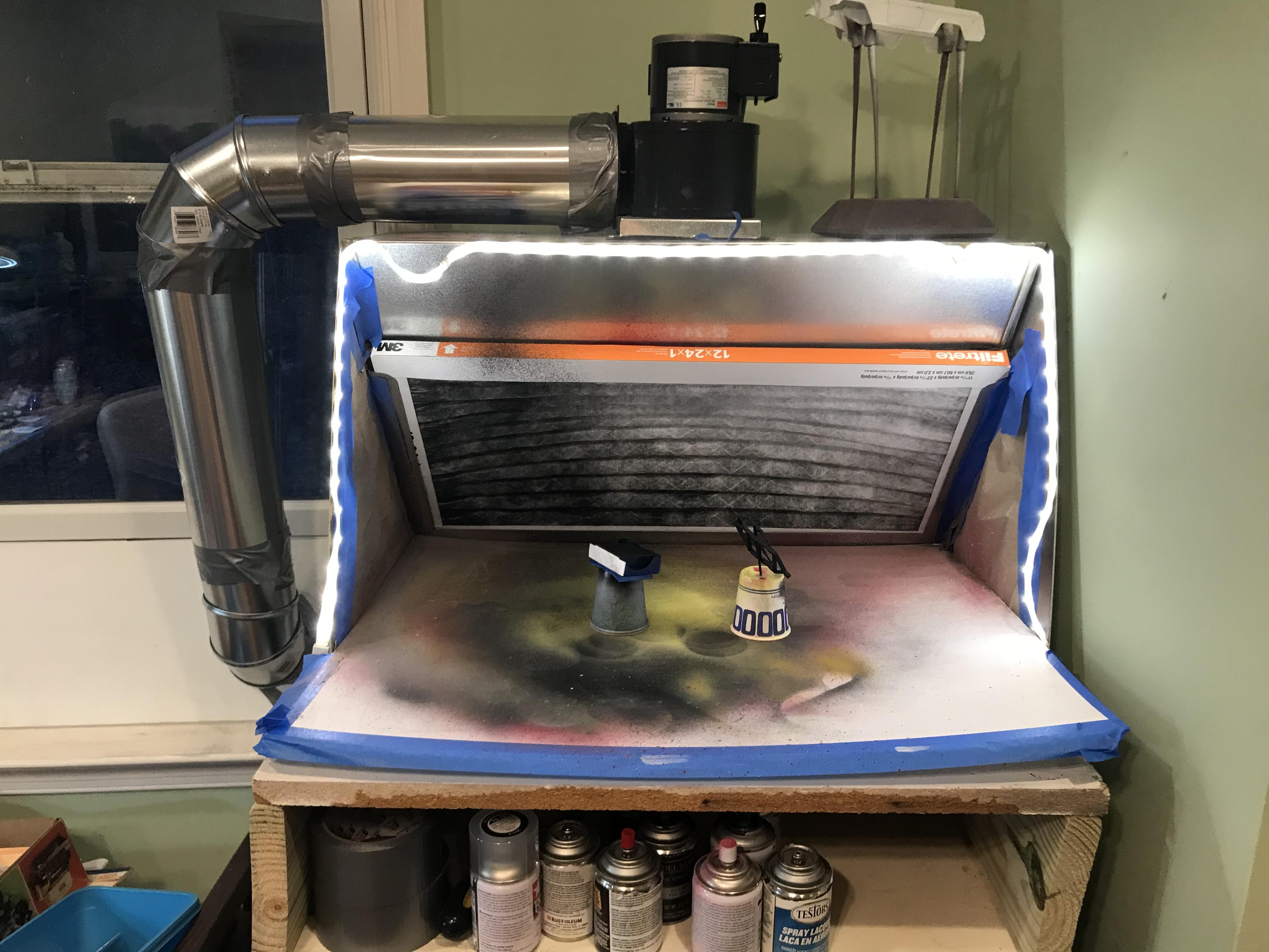

Tom Geiger Posted January 28, 2021 Posted January 28, 2021 Same Pace Peacekeeper, hard plumbed to outside. I added my own LED light strip, not permanently affixed yet in this photo. I have both on a power strip so they go on and off together. I've had this one since September and love it. I use spray cans and it handles spray and fumes completely. I changed the filter monthly and there is absolutely no leakage to the other side. Filters are standard cheap 12x24 ones that are $5 each when bought right. Dont mess with cheap ones or the “fan in a cardboard box” options. The Pace unit is on sale right now for $250 postpaid. You’ll spend maybe another $50 for ductwork and lights. Money well spent. But good tools once and they will serve you the rest of your life. You will soon forget the price but will eternally benefit!
ewetwo Posted January 28, 2021 Posted January 28, 2021 On 12/8/2019 at 8:20 PM, yh70 said: i brought one of these years ago and love it..its CE Approved and u can connect as many together that u need... https://www.ebay.com/itm/Portable-Hobby-Airbrush-Paint-Spray-Booth-Kit-Exhaust-Filter- I have this one. Works well. Where do you get your filters? The only place I can find them are in China.

Misha Posted January 28, 2021 Posted January 28, 2021 I’ve had my Pace booth since the summer and it has been great! It is fairly quiet, is very effective in evacuating fumes away from your work and you, and well built. Plus Bob Pace is a great guy to speak with over the phone. Spray booths vary greatly in design and quality... my only complaint is that I didn’t get one years ago. Cheers Misha
BuilderX Posted January 29, 2021 Posted January 29, 2021 20 hours ago, Kromolly said: What do you think of this booth now? Have you had a chance to use it much? Thanks Yes I love it, moves fumes very well!

ewetwo Posted January 29, 2021 Posted January 29, 2021 23 hours ago, espo said: I have this same unit and have used it for a few years now. While I like it fine the filters are a bit of an issue. The filters from the manufacture are very pricy and are marginally effective. I have been making my own using generic foam type filter material. I have been getting my filter material from Home Depot, but I'm sure most any hardware story would have the material needed. I just cut the material to size to fit in the filter location. For the exhaust I'm using laundry dryer duct material. I prefer the expandable aluminum rather than the plastic. When not in use the ducting can be curled up and put on a shelf without disconnecting it from the back of the blower. I have a door leading out of our basement where I do my painting and just open the door enough to put the dryer hose through the opening when in use. What is the filter material called David. I'd like to order some. I've been soaking the original filters in the purple pond and reusing them. But they are getting worn and out of shape.

randman Posted January 29, 2021 Posted January 29, 2021 On 12/8/2019 at 5:20 PM, yh70 said: i brought one of these years ago and love it..its CE Approved and u can connect as many together that u need... https://www.ebay.com/itm/Portable-Hobby-Airbrush-Paint-Spray-Booth-Kit-Exhaust-Filter- I have this same version (not sure if the exact same model, but they all appear to be the same). I get my filters from MicroMark. They have a 5 pack for around $23. This is usually the best price I have found.

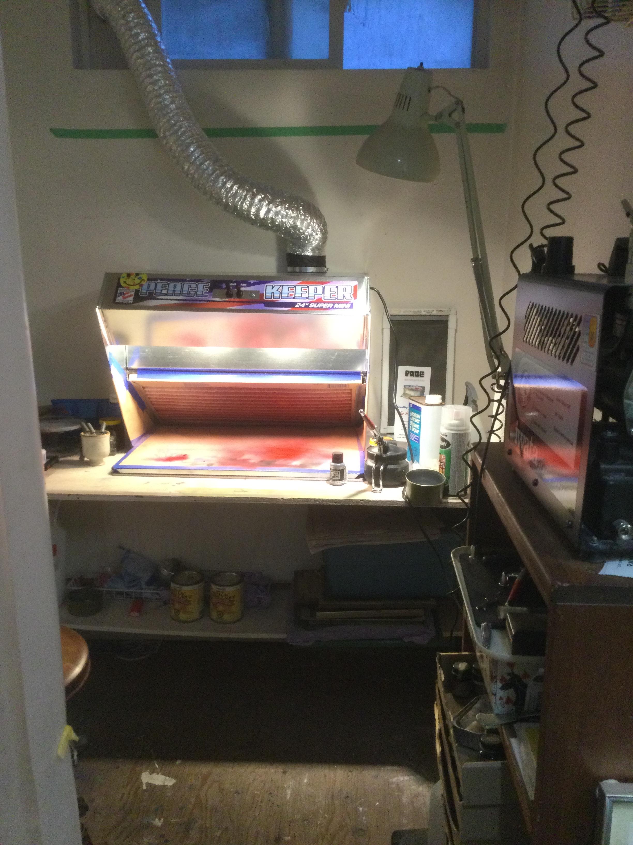

65slotcar Posted January 30, 2021 Posted January 30, 2021 i have the peace keeper 24 inch, i modified it by adding some aluminum sides and base. i love it, works great !
yh70 Posted February 4, 2021 Posted February 4, 2021 On 1/28/2021 at 9:36 AM, ewetwo said: I have this one. Works well. Where do you get your filters? The only place I can find them are in China. Amazon https://www.amazon.com/Master-Airbrush-Paasche-Enterprise-Airhobby/dp/B00AR2JC0K/ref=pd_nav_hcs_rp_1/132-2102376-6419639?_encoding=UTF8&pd_rd_i=B00AR2JC0K&pd_rd_r=e4f3a127-3ffc-4601-bf26-da794140d812&pd_rd_w=5zfNX&pd_rd_wg=32dDA&pf_rd_p=d9899928-5e81-4649-b745-3e12c8242f4c&pf_rd_r=8W26K4J29845GYCSJMYN&psc=1&refRID=8W26K4J29845GYCSJMYN
