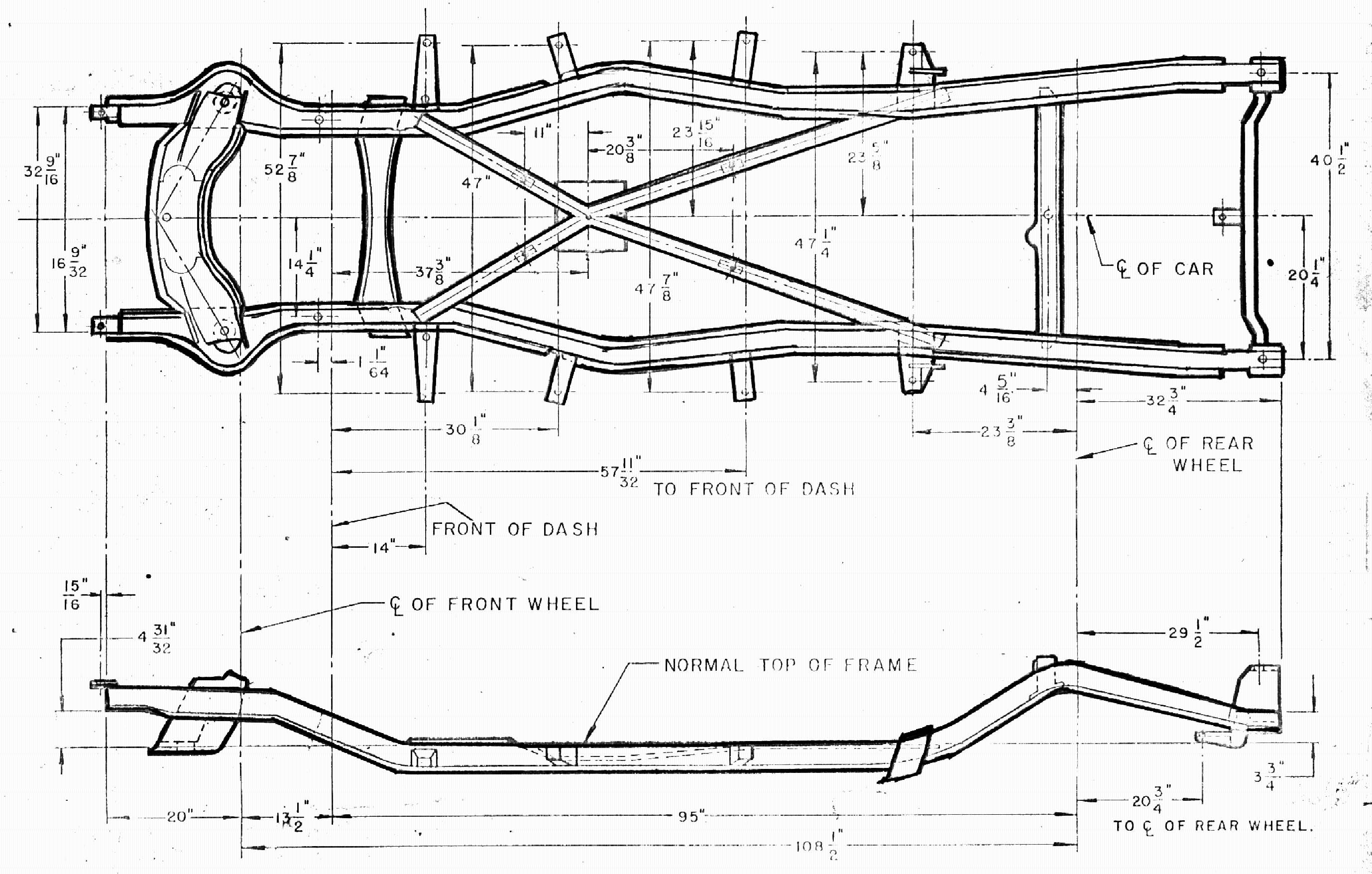

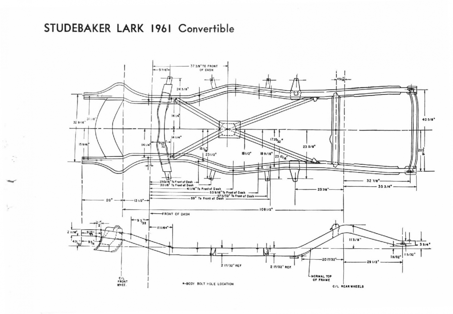

SfanGoch Posted December 13, 2019 Posted December 13, 2019 The closest you can get is the chassis from the AMT '63 Avanti. Both the Lark and Avanti have 109" wheelbases and the frames are pretty much identical.
thatz4u Posted December 13, 2019 Author Posted December 13, 2019 1 minute ago, SfanGoch said: The closest you can get is the chassis from the AMT '63 Avanti. Both the Lark and Avanti have 109" wheelbases and the frames are pretty much identical. thank youse, Joe..
SfanGoch Posted December 13, 2019 Posted December 13, 2019 '59-'61 Lark frame '61 Lark convertible frame Avanti frame
Mark Posted December 13, 2019 Posted December 13, 2019 There might be some additional work involved, as the Lark is larger than 1/25 scale.
Ace-Garageguy Posted December 14, 2019 Posted December 14, 2019 2 hours ago, Mark said: There might be some additional work involved, as the Lark is larger than 1/25 scale. Yes, this is maddening. I've been through it, have all the referenced kits.. Though it's marked 1/25 on the box, the Johan Lark wheelbase is about 10 scale inches longer than the AMT Avanti. The AMT '53 Stude has about the right wheelbase, is the same general design as the Lark, but it lacks the X-member the Avanti chassis has. The Lark coupe didn't use the X-member, but the convertible did. The second crossmember on the Avanti, the one under the firewall, is different from the Larks too. It can be cut out of the Johan Lark and swapped cleanly into one of the AMT chassis without too much trouble. If you use either of the AMT chassis, you'll need to widen the floor as well.

garagepunk66 Posted December 27, 2019 Posted December 27, 2019 On 12/13/2019 at 6:58 PM, Ace-Garageguy said: Yes, this is maddening. I've been through it, have all the referenced kits.. Though it's marked 1/25 on the box, the Johan Lark wheelbase is about 10 scale inches longer than the AMT Avanti. The AMT '53 Stude has about the right wheelbase, is the same general design as the Lark, but it lacks the X-member the Avanti chassis has. The Lark coupe didn't use the X-member, but the convertible did. The second crossmember on the Avanti, the one under the firewall, is different from the Larks too. It can be cut out of the Johan Lark and swapped cleanly into one of the AMT chassis without too much trouble. If you use either of the AMT chassis, you'll need to widen the floor as well. Bill, I am curious about your thoughts on dispensing with the basic Lark body altogether and modifying the Revell Miss Deal body, grafting on the Lark-specific sections from the Jo-Han body to come up with a more scale-accurate piece that would fit the Avanti chassis. I have a slightly warpy 1960 Lark promo with a crushed roof that I am contemplating upon with this very conversion

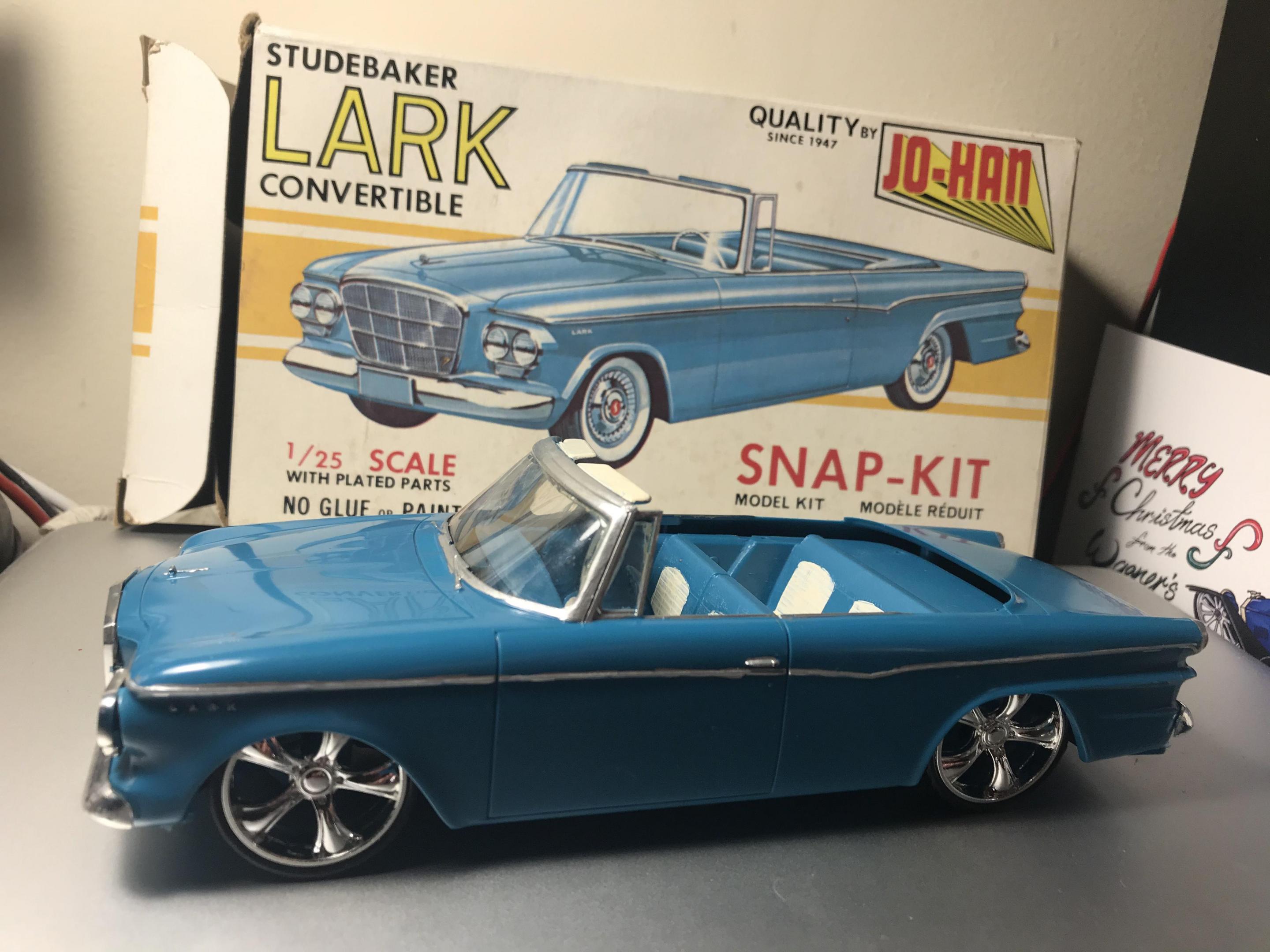

Bucky Posted December 28, 2019 Posted December 28, 2019 Here's the box I had: Here's what was in it: Here's what I did with mine: The chassis for this kit is promo/curbside style, and that is what I went with on this build. I concentrated on the topside and inside. If I had another kit, I would be interested in the chassis upgrade. I'll follow along to see what you fellas come up with for future reference.
Ace-Garageguy Posted December 28, 2019 Posted December 28, 2019 (edited) 20 minutes ago, Bucky said: ...Here's what was in it: Here's what I did with mine... I'll follow along to see what you fellas come up with for future reference. Your model looks great. Far as the kit itself goes, that's exactly what's in the original issue kit, though it's not labeled as a snapper. Frankly, I bought my hardtop intending to pull molds from the front clip and build a pickup. But with the scale discrepancy, it's getting doubtful that I'll even bother. Time seems to be slipping away, and it's becoming increasingly necessary to pick my battles with more care. Doing masters for a scale-correct hardtop and pickup had some appeal, but there are other things I'd really rather do at this point. Edited December 28, 2019 by Ace-Garageguy
