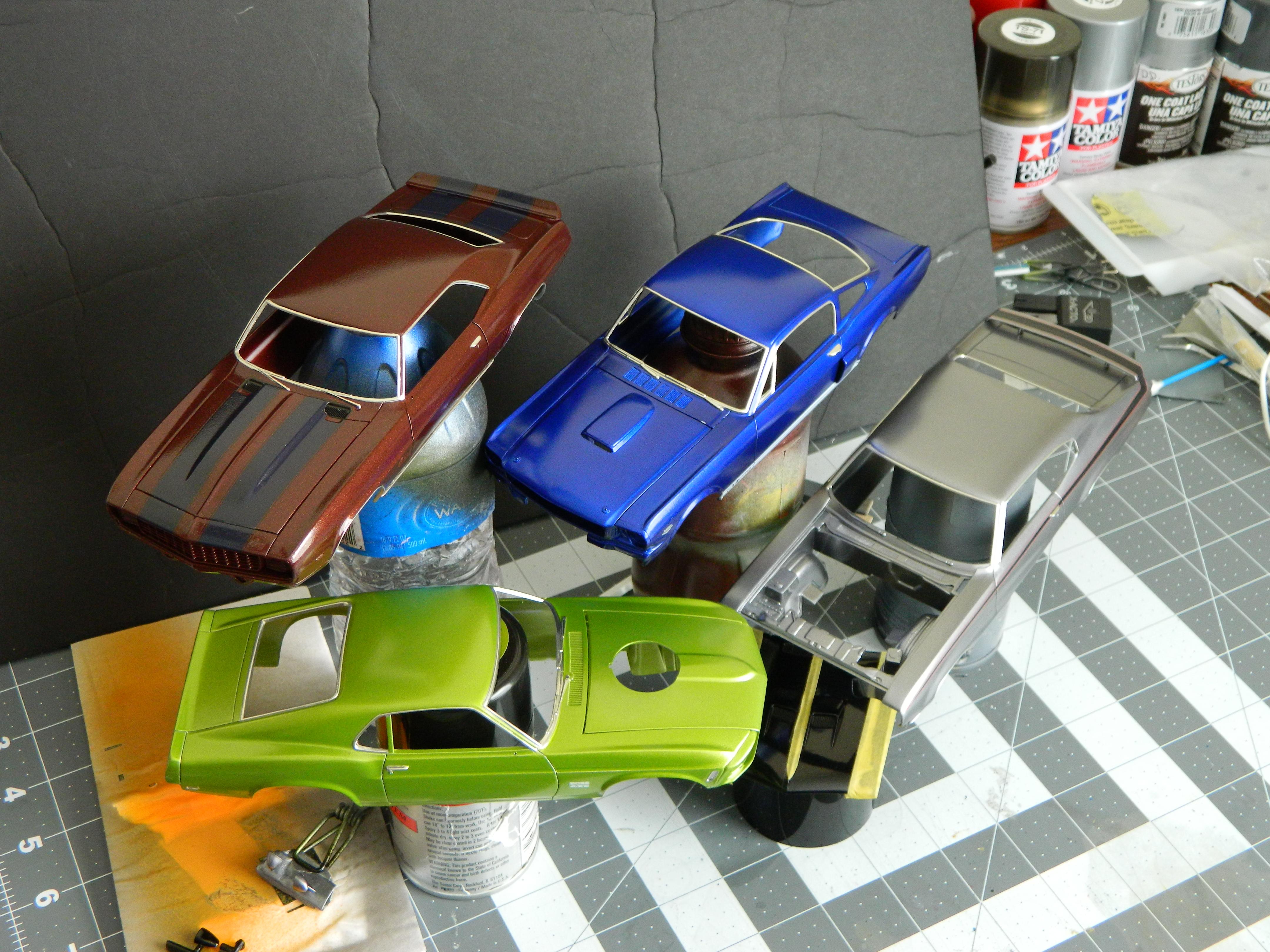

Dragonhawk1066 Posted December 19, 2019 Posted December 19, 2019 (edited) Model Master lacquer goes just fine over Rustoleum 2X primer. I primed a bunch of bodies in August with the Rustoleum 2X Flat White, Light Gray, and Flat Black primers and painted over them with Testors One Coat(Extreme) lacquers, Model Master lacquer and Tamiya in September with no problem. The problem you run into with the Rustoleum line is with their clears as they are chemically hot. Their primers and paints are fine, although the paints are a little thick. Also, here's a spoon test using Testors Green Metal Flake Enamel over various base coats... Edited December 19, 2019 by Dragonhawk1066

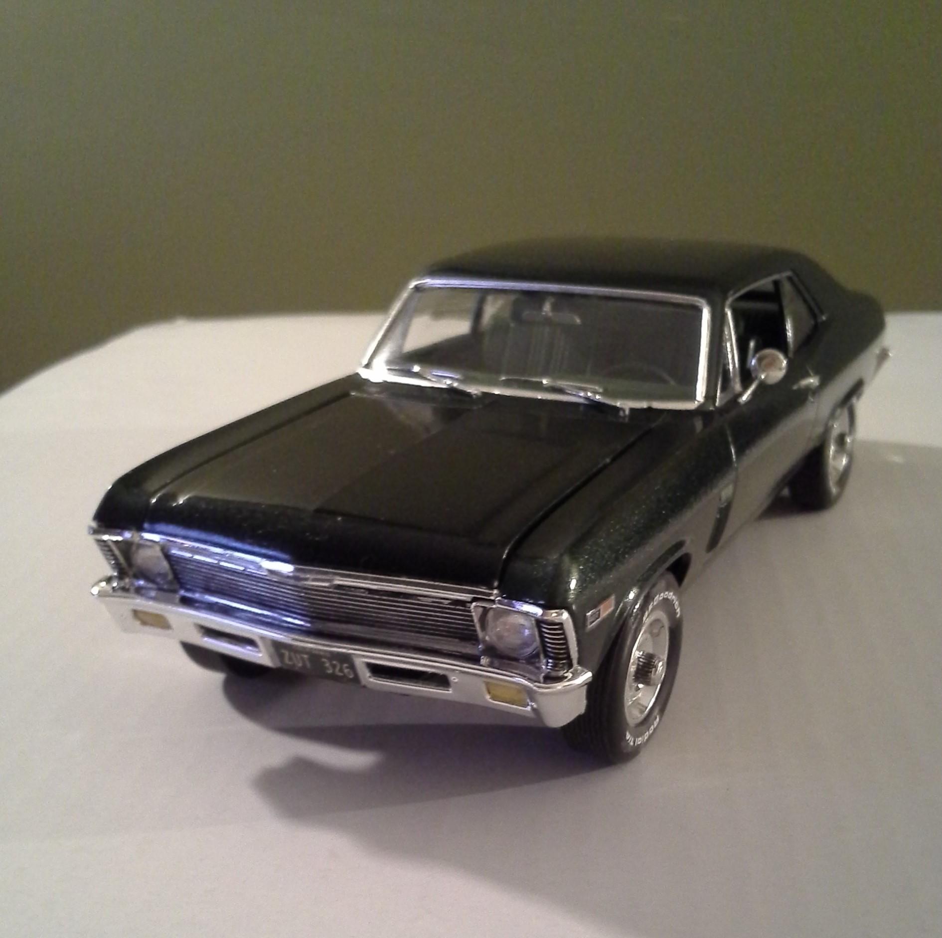

BuilderX Posted December 20, 2019 Posted December 20, 2019 Here is a nova with Testors MM fathom green over dupli color white primer ,not sure if this is what your looking for.
R.D.F. Posted December 20, 2019 Author Posted December 20, 2019 46 minutes ago, BuilderX said: Here is a nova with Testors MM fathom green over dupli color white primer ,not sure if this is what your looking for. Now that I have information on what I can use I'll do a spoon test myself and decide what looks good. I'm building a 1966 Ford Fairlane GT for a friend. His car was dark green metallic. Thanks for that picture.
