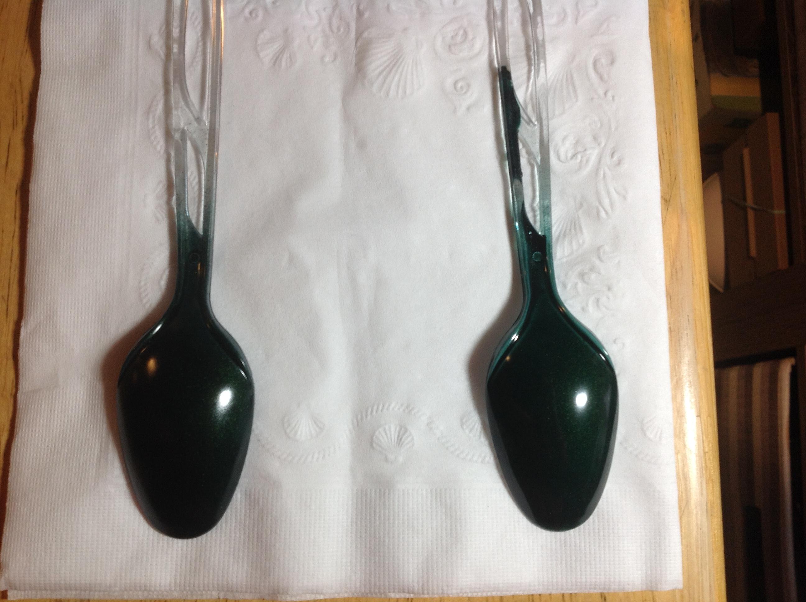

R.D.F. Posted February 6, 2020 Author Posted February 6, 2020 OK I just did a spoon test. Both where done with white primer. The one on the left is Tamiya and the right one is Rustoleum 2X. The paint used is Dupli color Forest Green Pearl BCC0423 (PG8) I let the primers cure for 24 hours. Under a 60 watt LED table lamp is how I took the picture. Neither crazed on me and I put the paint on wet, one coat. The Rustoleum has more gloss as seen by the light.
