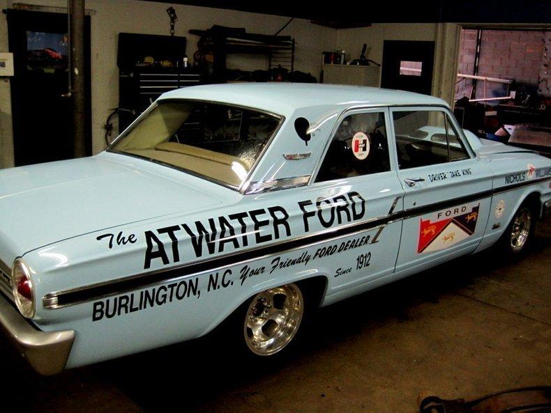

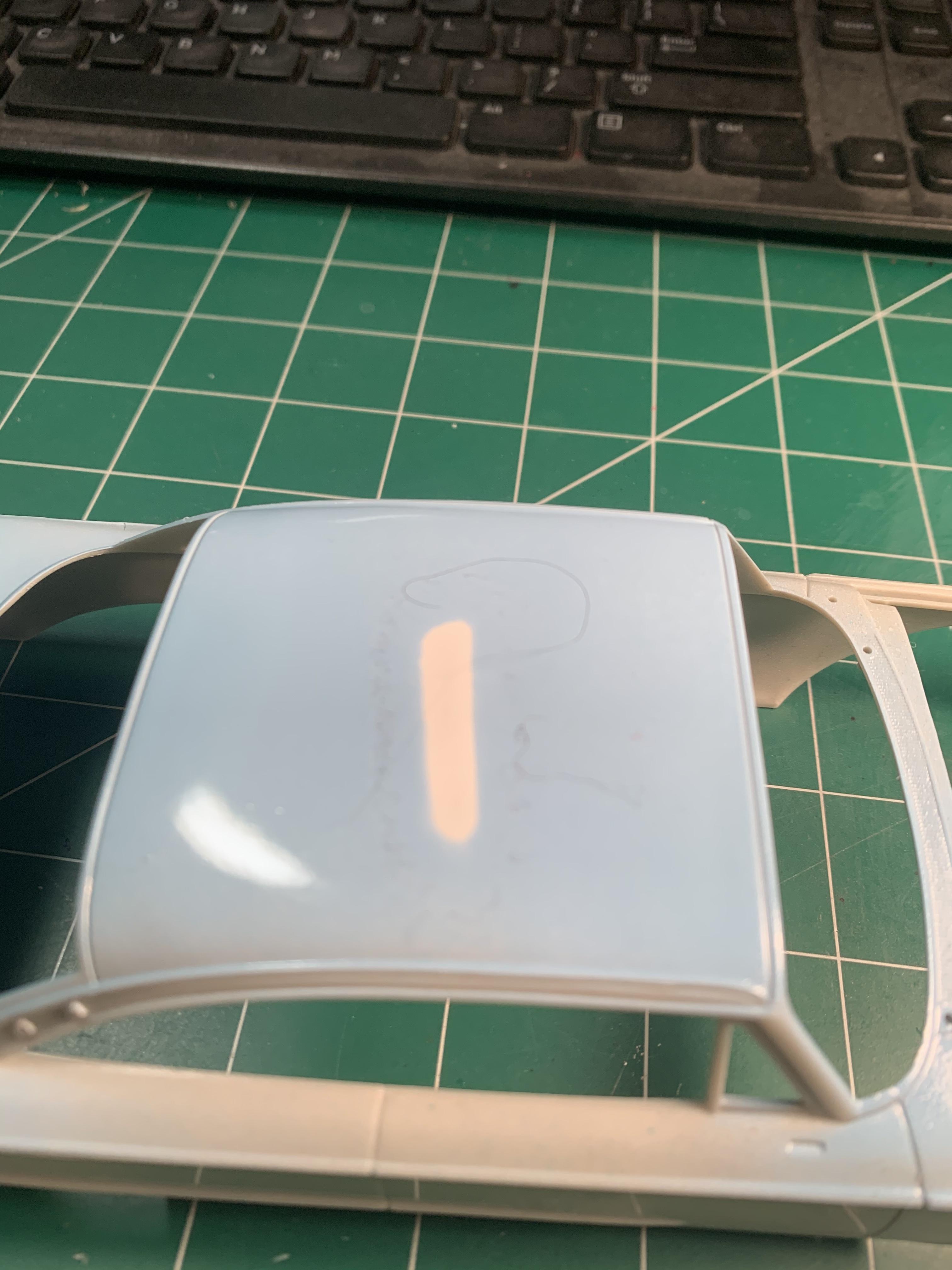

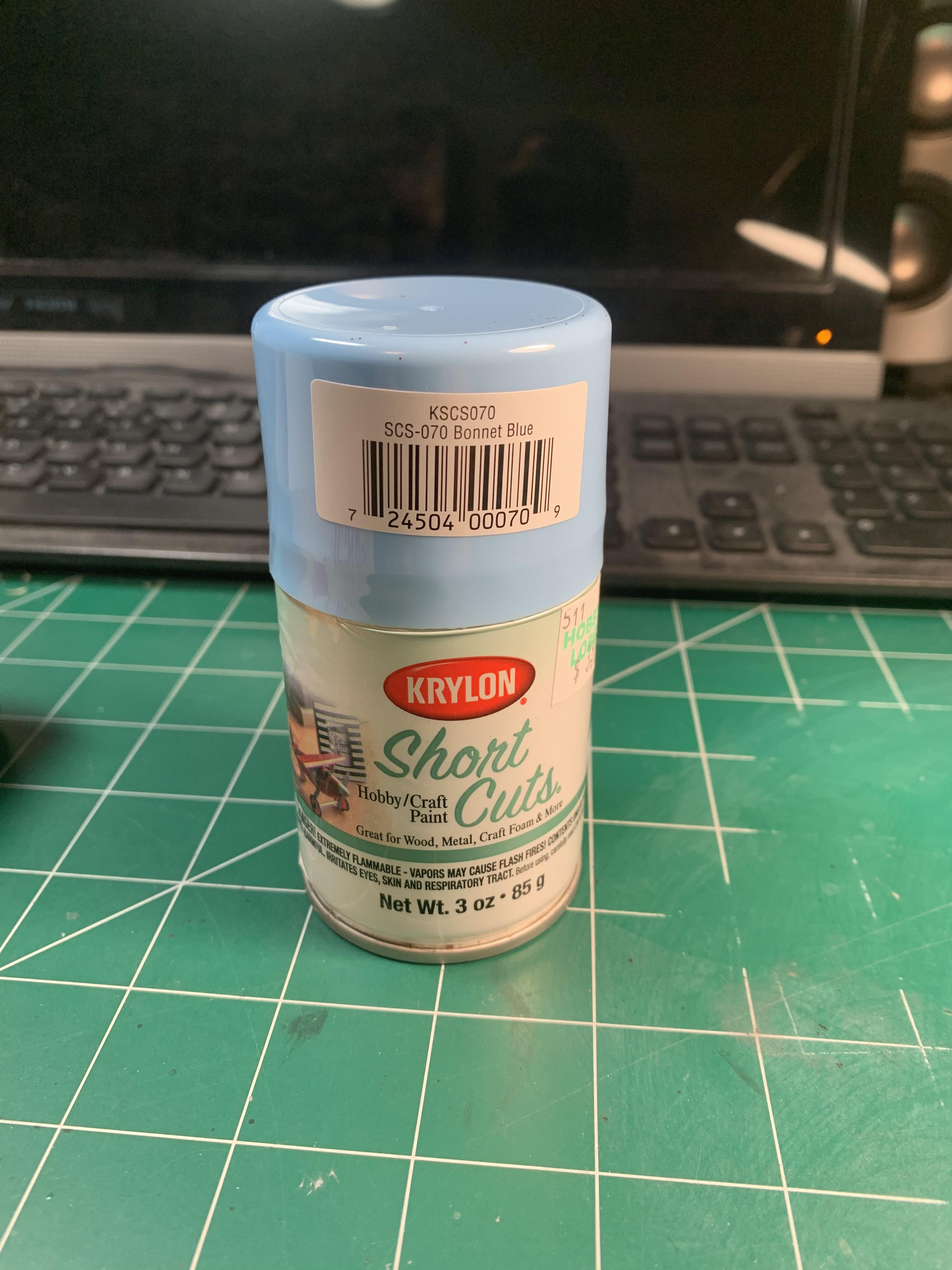

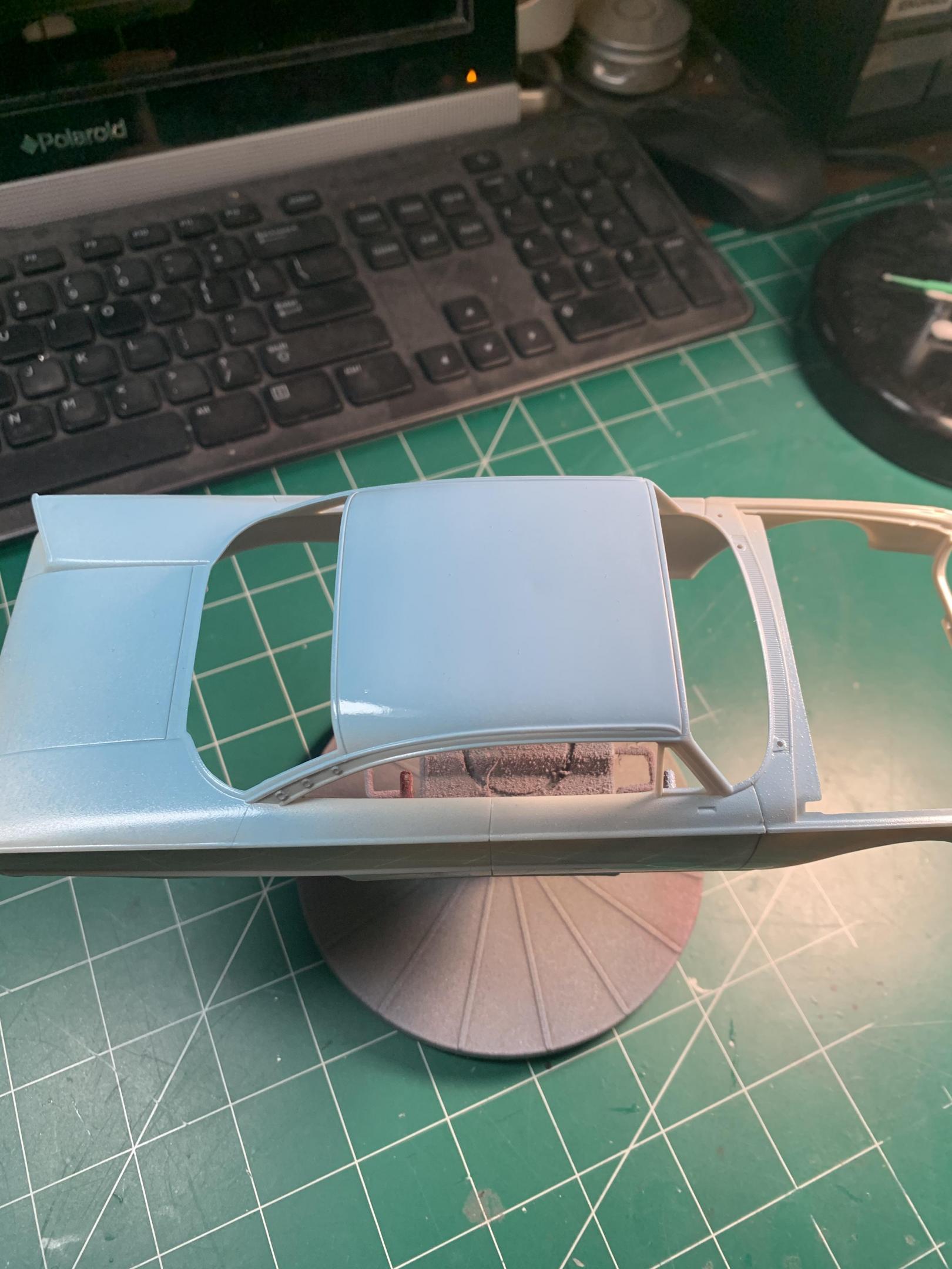

I know, I should just buy an airbrush already, and I won’t have this problem, BUT, I was looking for a paint close to resemble Fords 1964 Skylight Blue, to build Jake Kings Atwater T Bolt. I bought this can for about a buck and a half cheaper than the Testors, and Tamiya sprays. I was a bit skeptical on using it, as there is no mention on the can whether it’s an enamel, or lacquer, or acrylic. So I tested it in an old body with Tamiya white primer, then the Krylon, then Testors lacquer clear. Looks pretty good with no signs of cracking, or wrinkles.
Has anyone tried these colors at all? They do have some nice colors that are not available in the typical model sprays.

Nice color btw. Use some auto rubbing compound or silver polish to beat down some of the orange peel.
I too believe it's enamel similar to Testor or the old Pactra enamels. As Meat Man said, it can be polished out nicely, provided coverage is sufficient (at least three coats) and it's allowed to dry/cure fully (till it doesn't smell like paint anymore). This can take several weeks.
It was pretty dry to the touch in about twenty minutes.
As far as the texture, I just sprayed it on without any prepping to see how it would react to the primer and clear.
The label only states that there is acetone, toluene, and the like. It also states “dries to the touch in 30 minutes”.
It acts more like a lacquer, than an enamel.

Sorry 'bout that. I actually called the offices at (800)457-9566 to get that info. I did bring up the fact that there isn't any mention as to whether it's enamel, lacquer or acrylic and was informed that Short Cuts aerosol paints are enamel. Also, I was told if the paint (product no. SCS-070) isn't listed in the color chart, it has been discontinued in that particular line.
