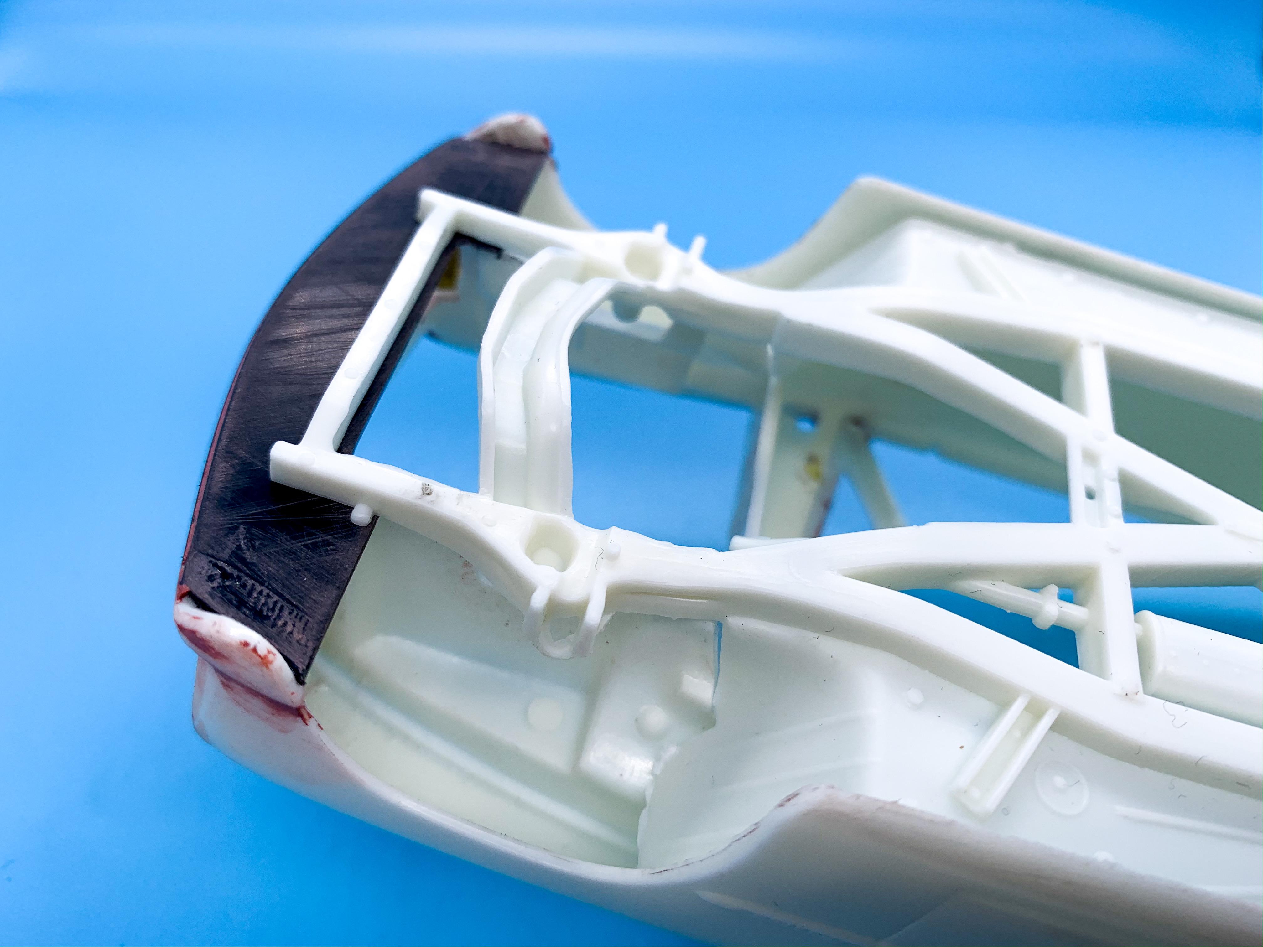

OldNYJim Posted January 10, 2020 Author Posted January 10, 2020 Apologies for all the single replies - I get the dreaded 404 error if I do more than one at a time... As I’m replying anyway, a little progress from today’s time at the bench. First up, I didn’t like how the underside of the body met the frame... ...so I shortened those frame horns and added some little bulges...I think they’re actually custom body pieces from the kit: They won’t be super visible but it’s a little detail to spot if you looked underneath. Whilst I was under there I didn’t like the appearance of the inner arches in the front there, so that’s this weekend’s can of worms... More soon, soon as I’ve done more!

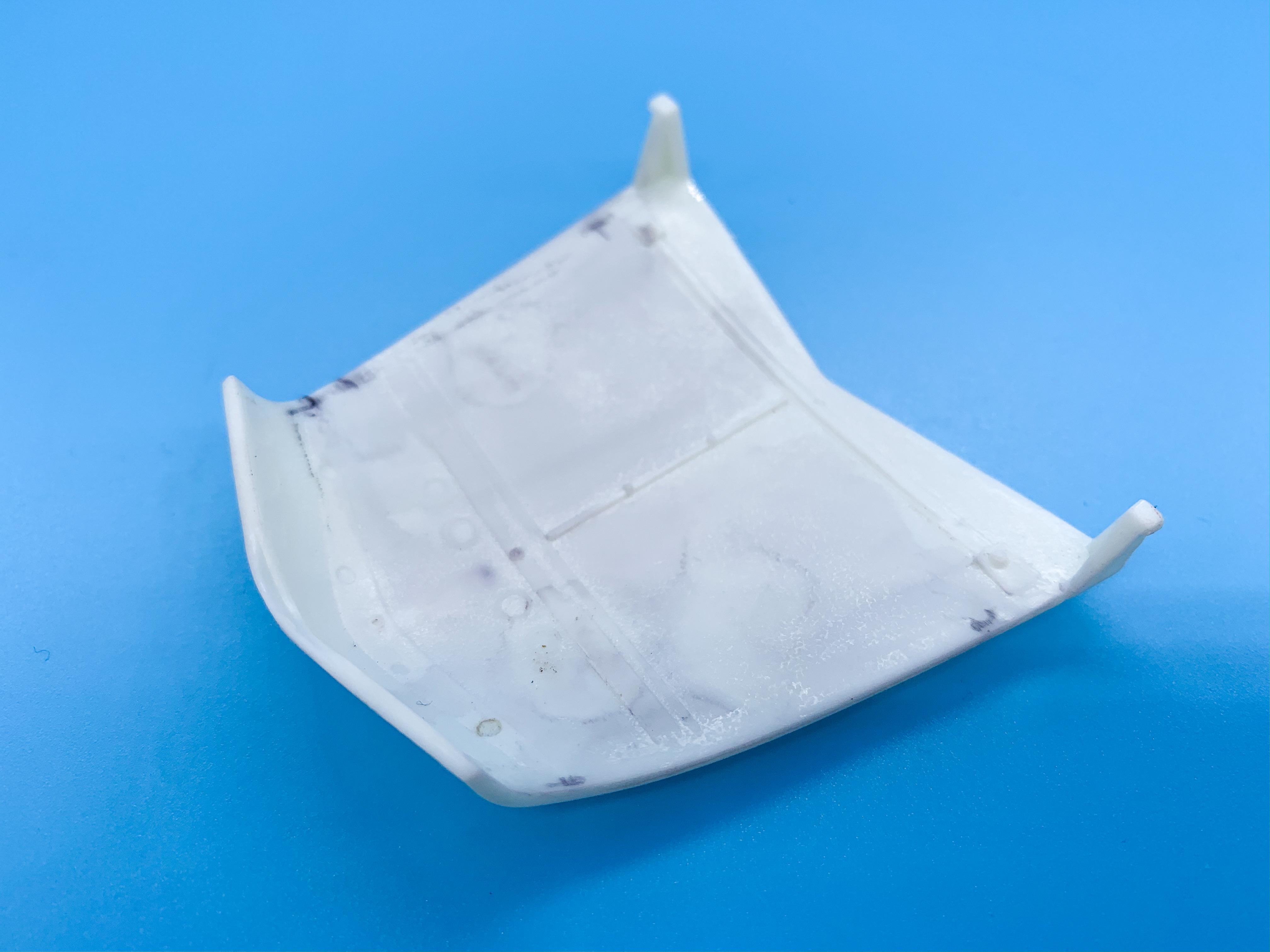

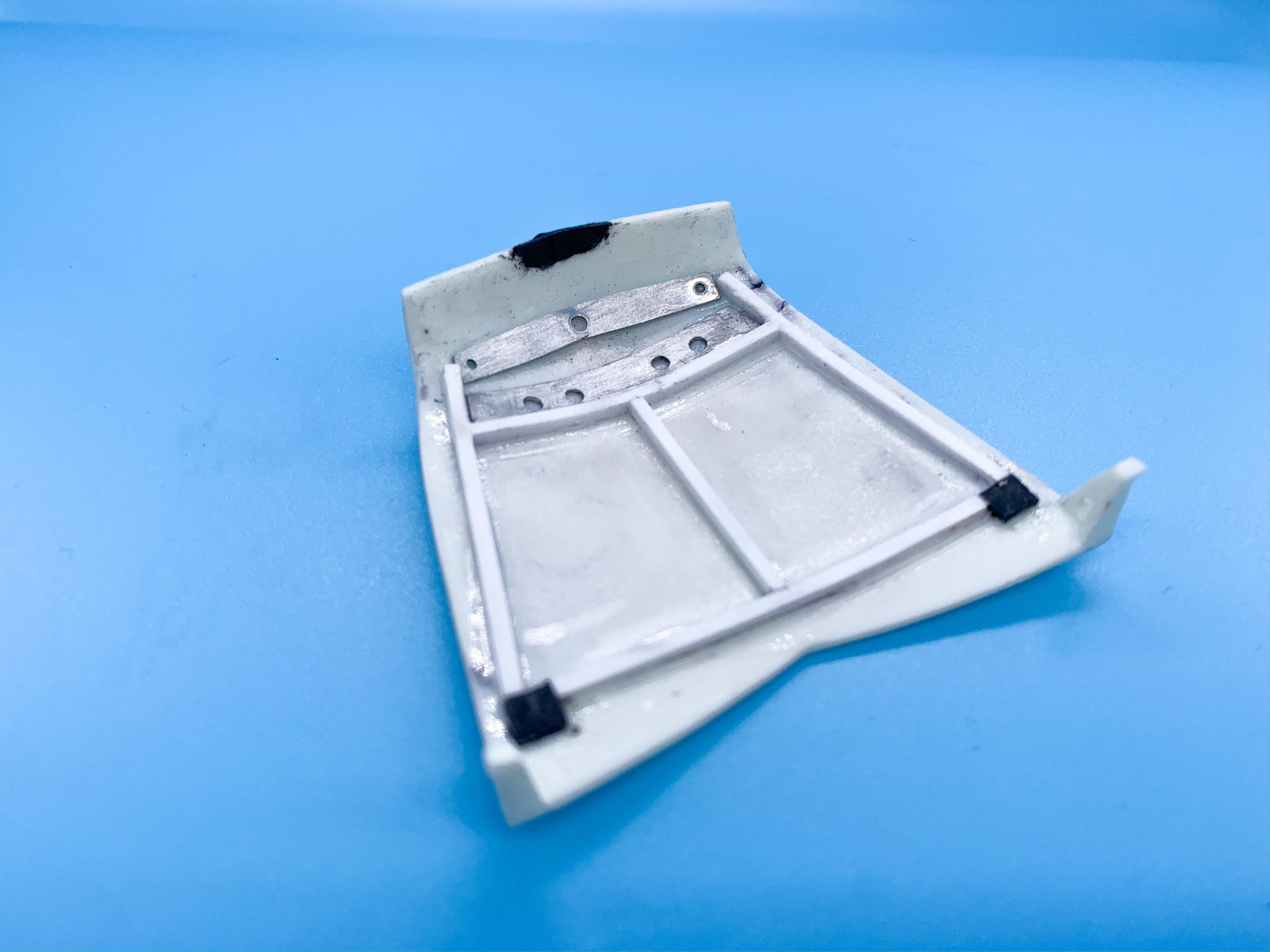

OldNYJim Posted January 13, 2020 Author Posted January 13, 2020 A little update, and a not-super-exciting one...I wanted to improve on the moulded-in detail on the underside of the hood as it comes out of the box: Most of this is hidden anyway, even with the hood open - it’s pretty hard to see under there, but I added some bracing and stamped panels to (somewhat) replicate what you’d find under the hood of a 1:1: Once the glue dries I’ll sand it all smooth and blend it in nicely ready for paint (if I ever get that far ??). Whilst I was messing with the hood I cut a little strip to fill a gap that was visible from underneath - it’s actually a fraction oversized but I’d like to use that to my advantage and shape the new piece to have the hood sit nicely: I think I finally have an idea, after a couple of weeks of thinking, of what to do about a front grille...more on that next!

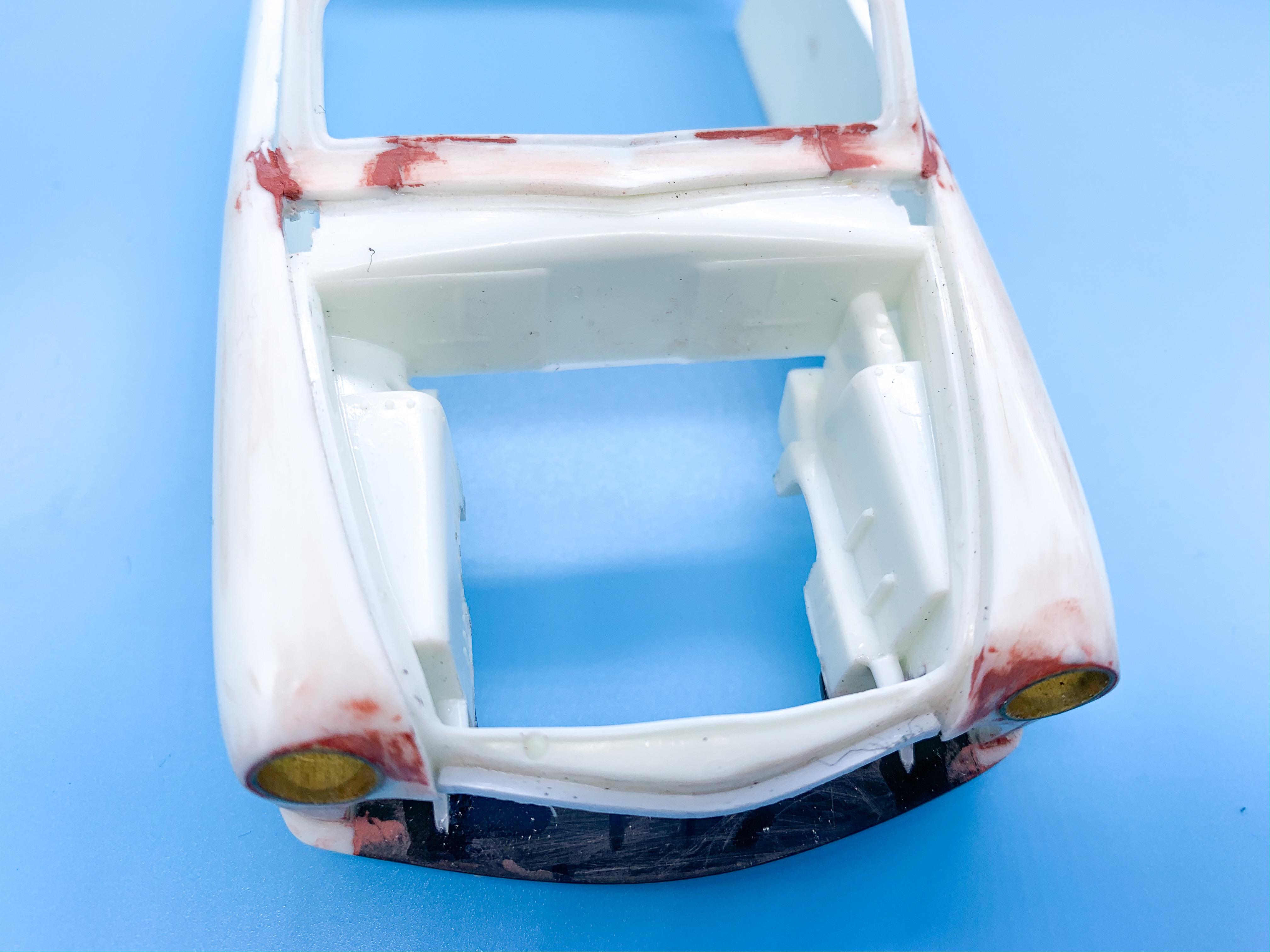

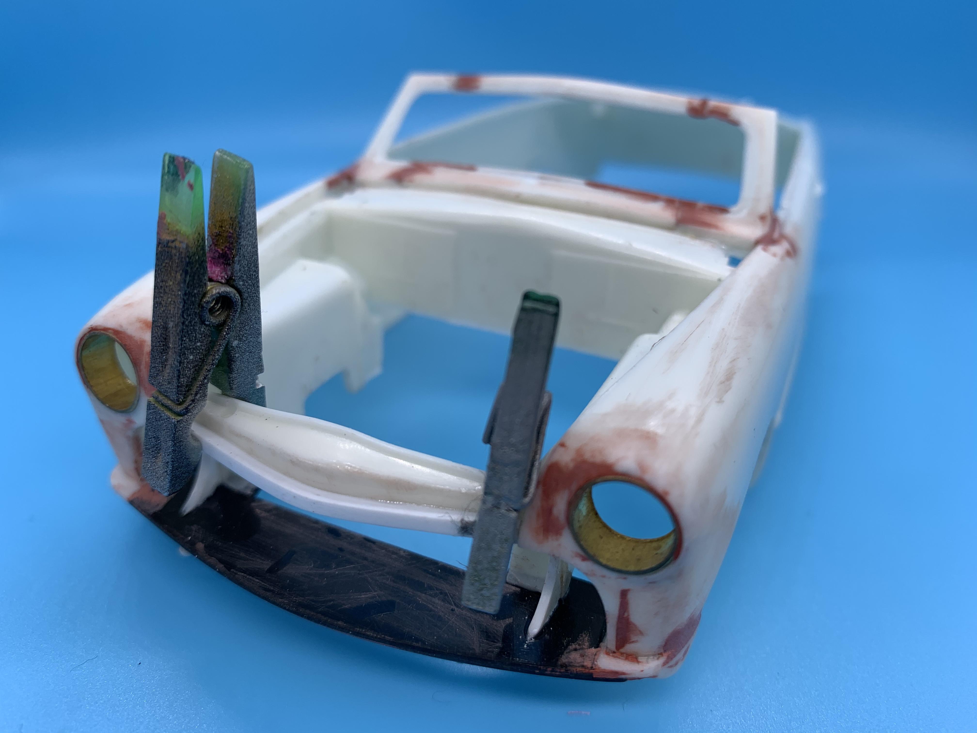

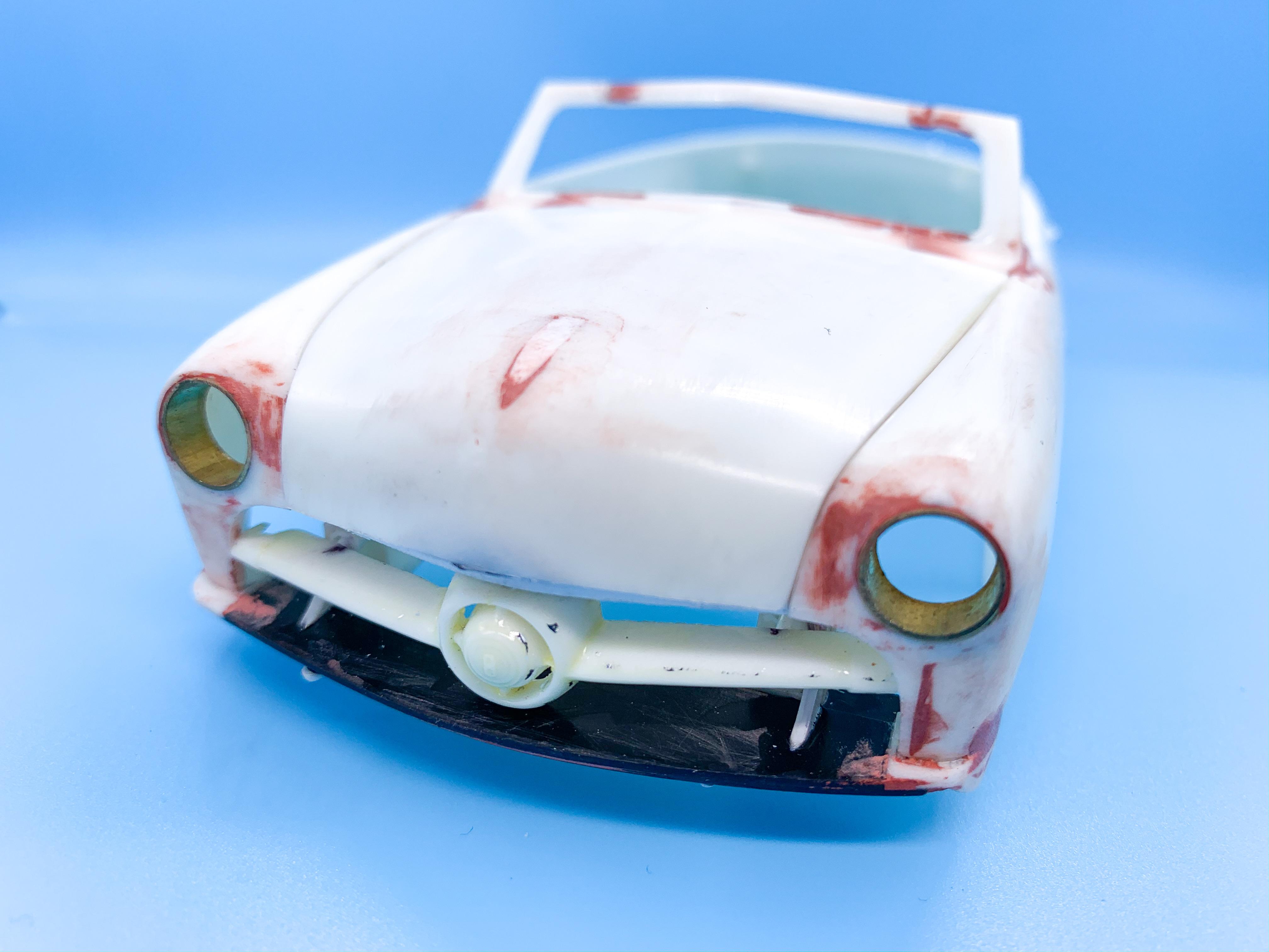

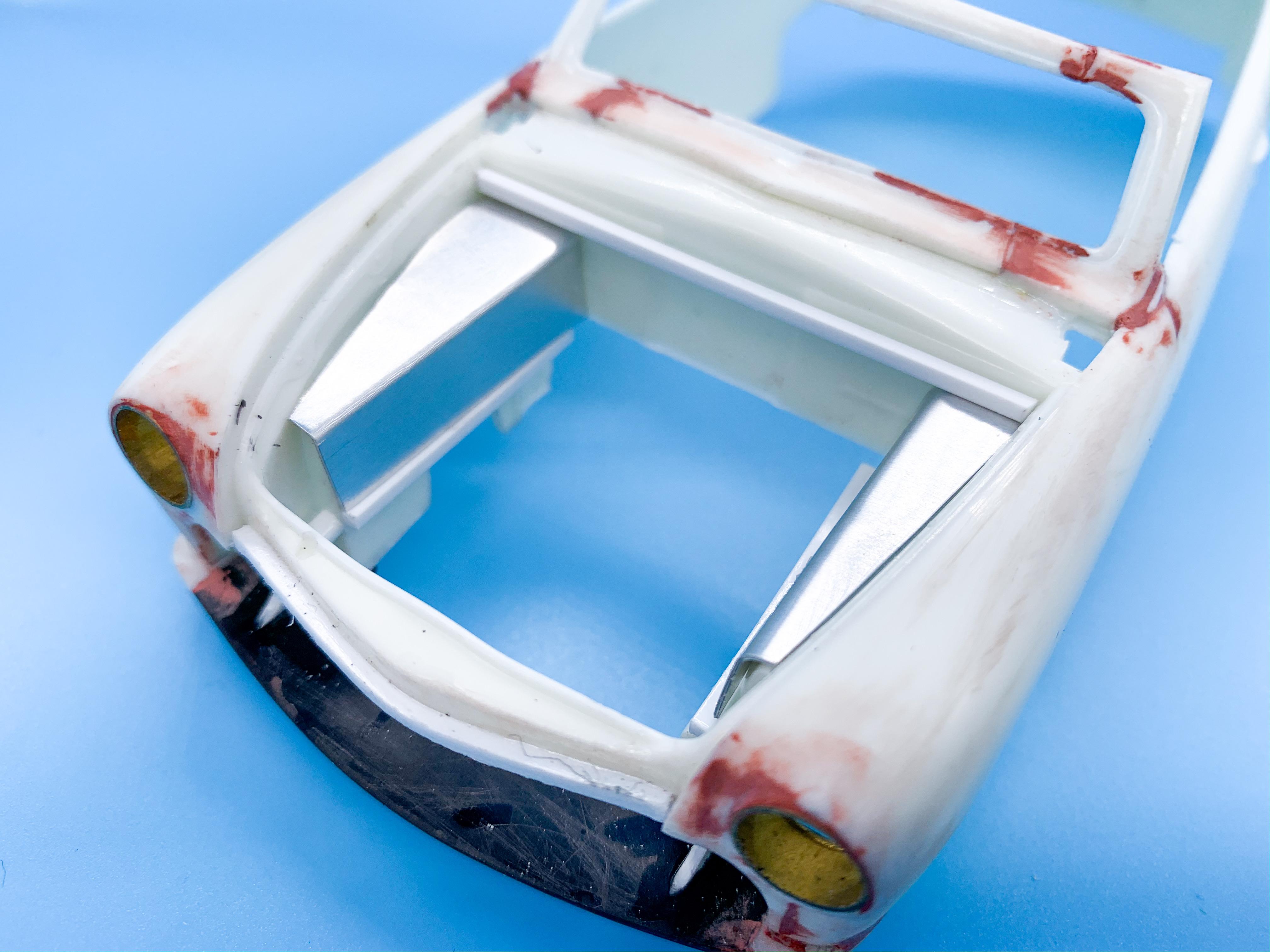

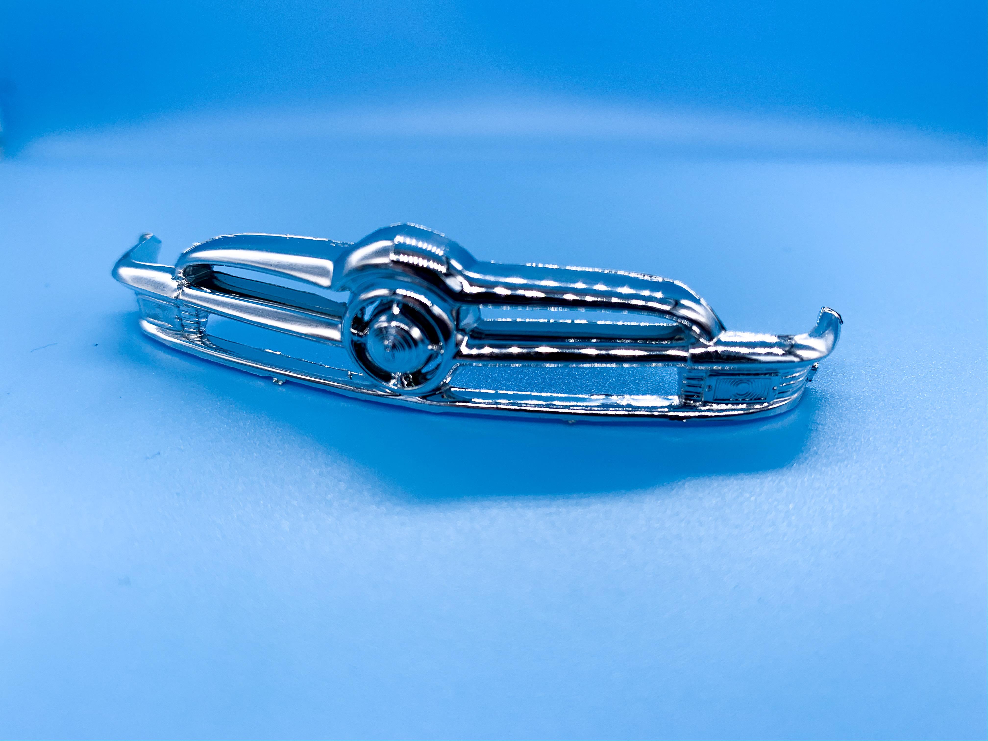

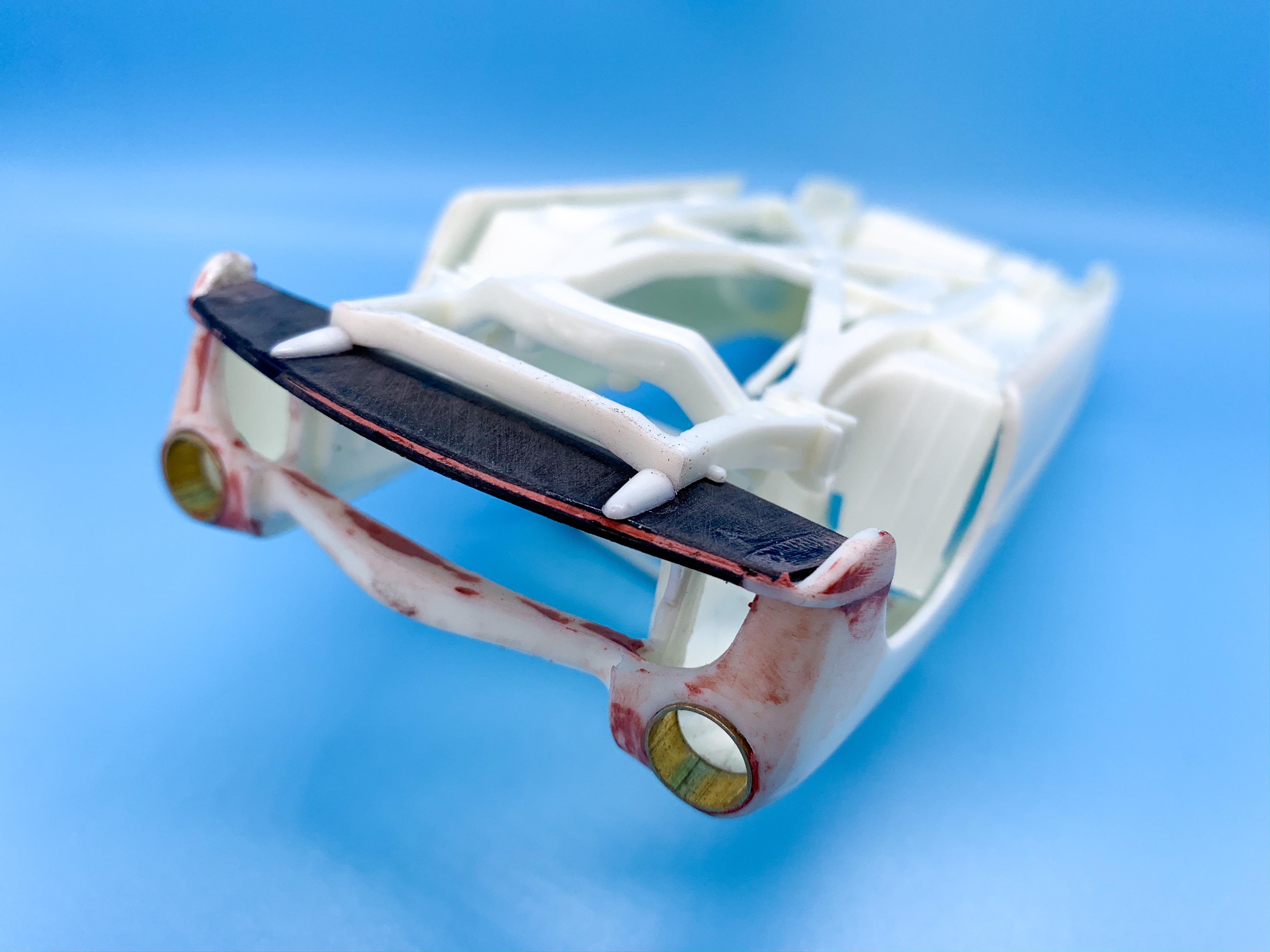

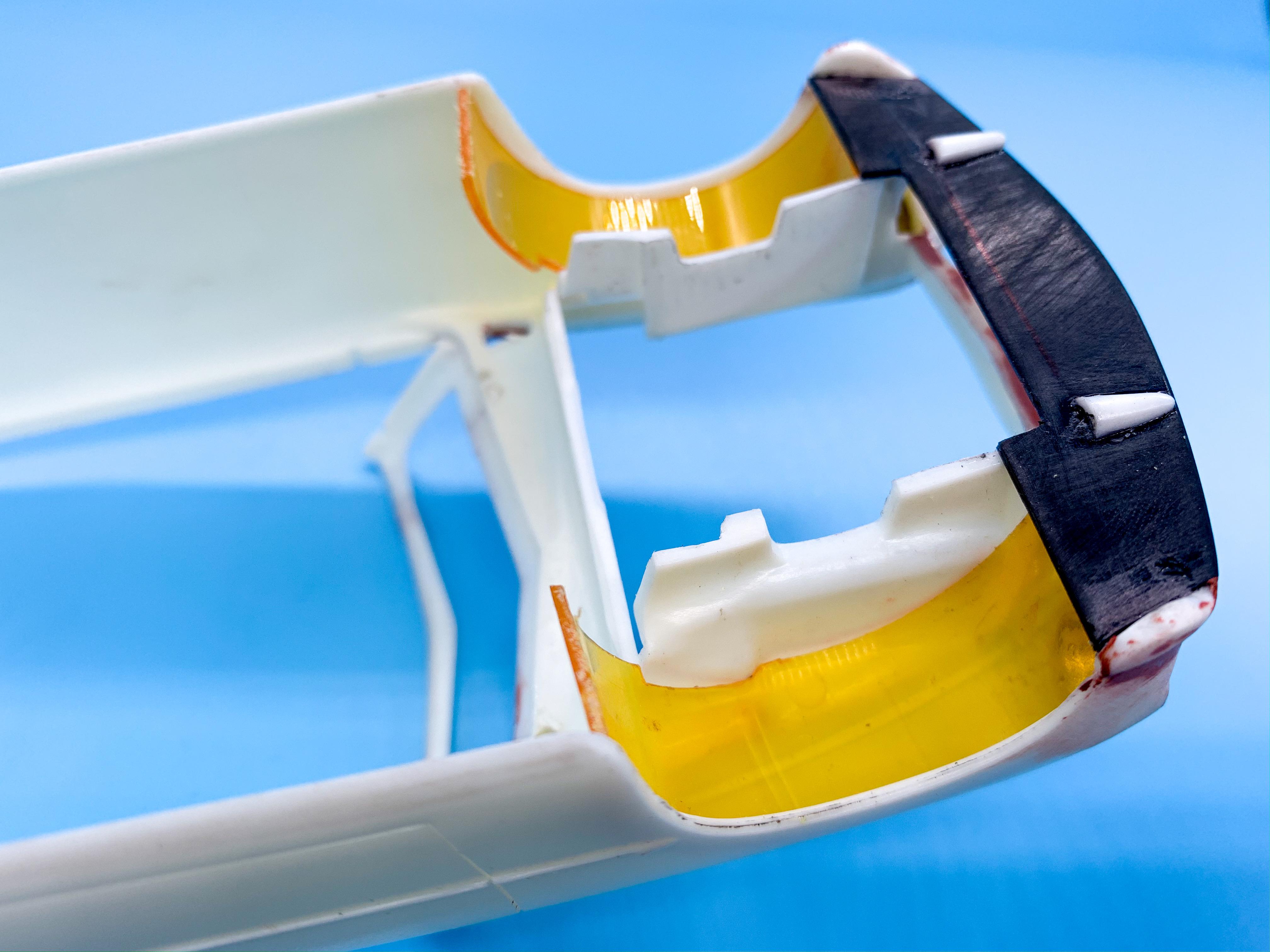

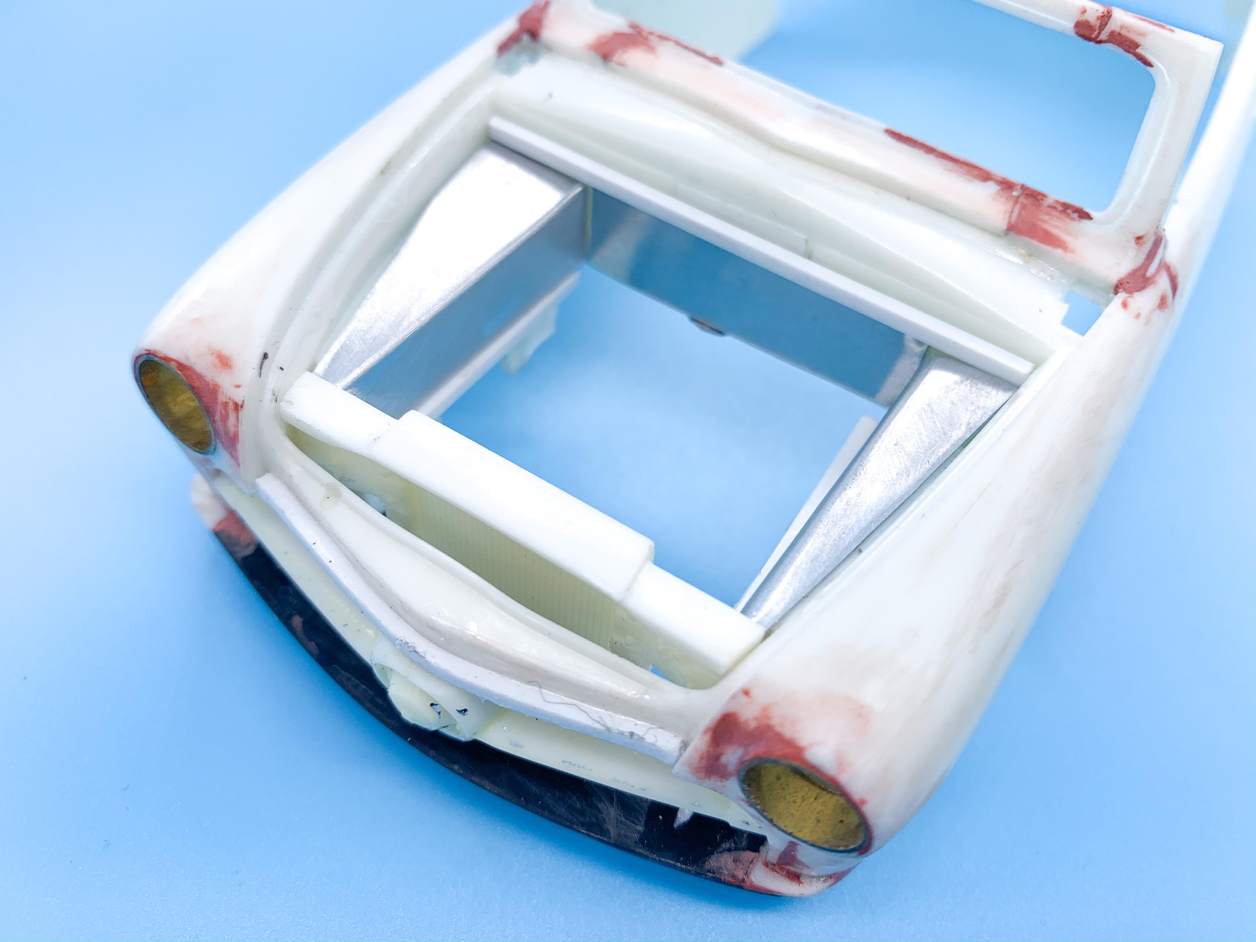

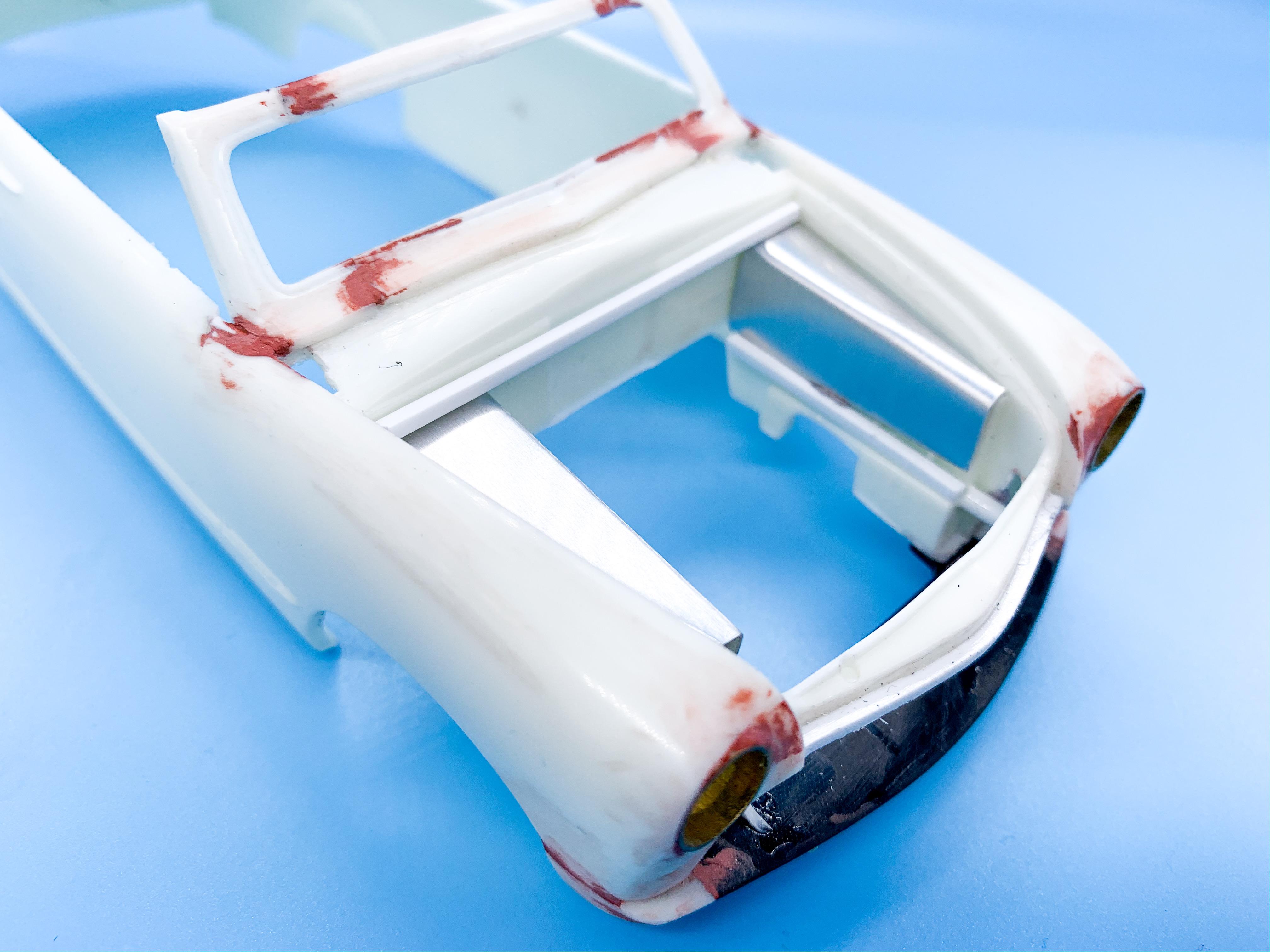

OldNYJim Posted January 15, 2020 Author Posted January 15, 2020 Speaking of the grill, I removed the top and bottom bars and recessed it inside the opening - I wanted to keep that big center bullet but simplify the design to fit the theme I’m doing with here: Ive really gotta put some primer on this thing, it’s driving me nuts seeing all those different colors ? Continuing backwards, I wanted to clean up these inner arches: I wanted to retain the general shape of them but have them extend to meet the firewall and cover some of those lumps and bumps and whatever that hose is on the drivers side there (fresh air intake?), so I used some K & S aluminum sheet to make some pieces to level all that out: I’m not sure if they’ll be painted or polished yet...can’t quite decide! I think the next thing to tackle is a matching firewall too, and then I can get the radiator in there and blend THAT into these arches. More soon!

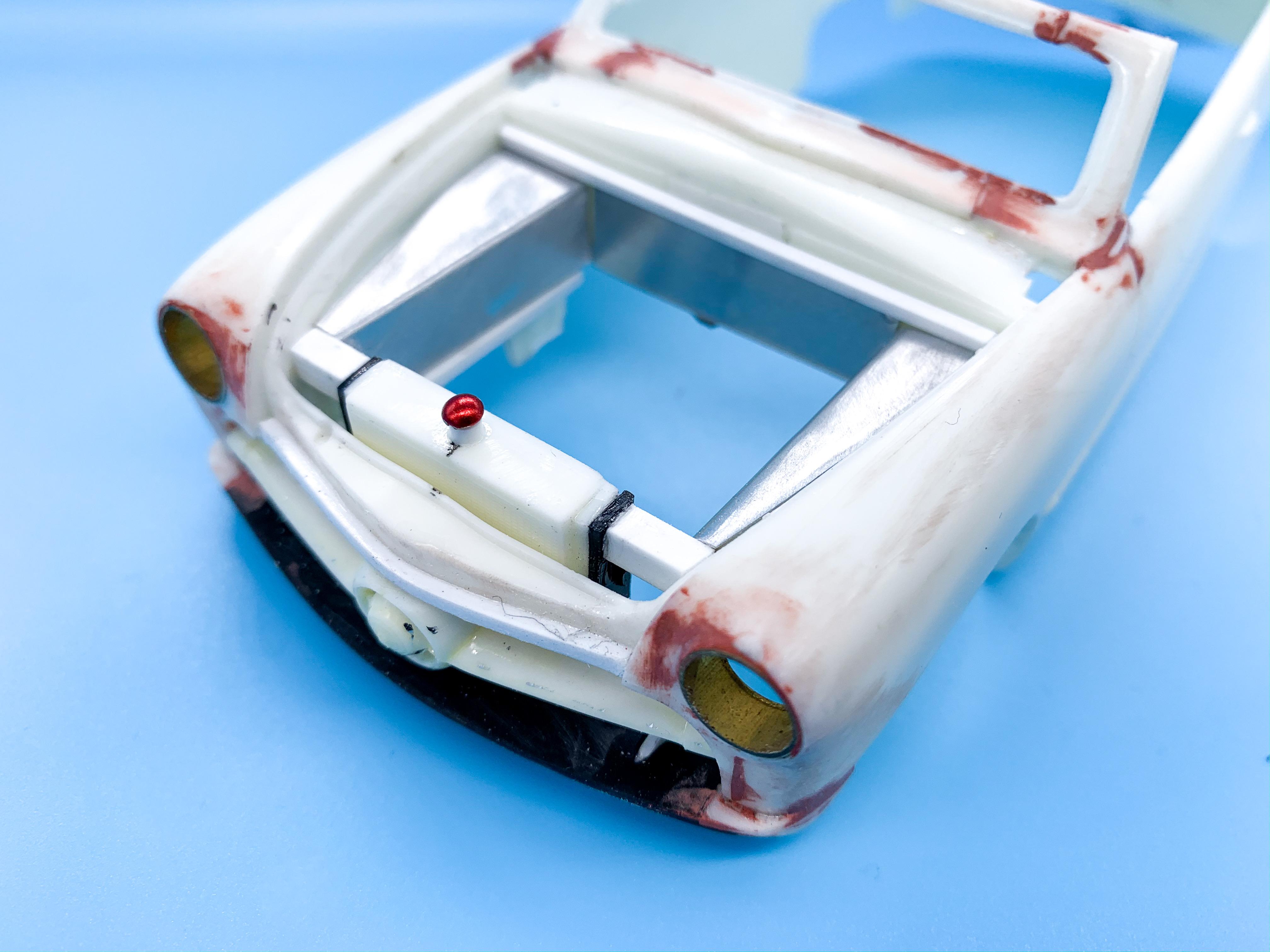

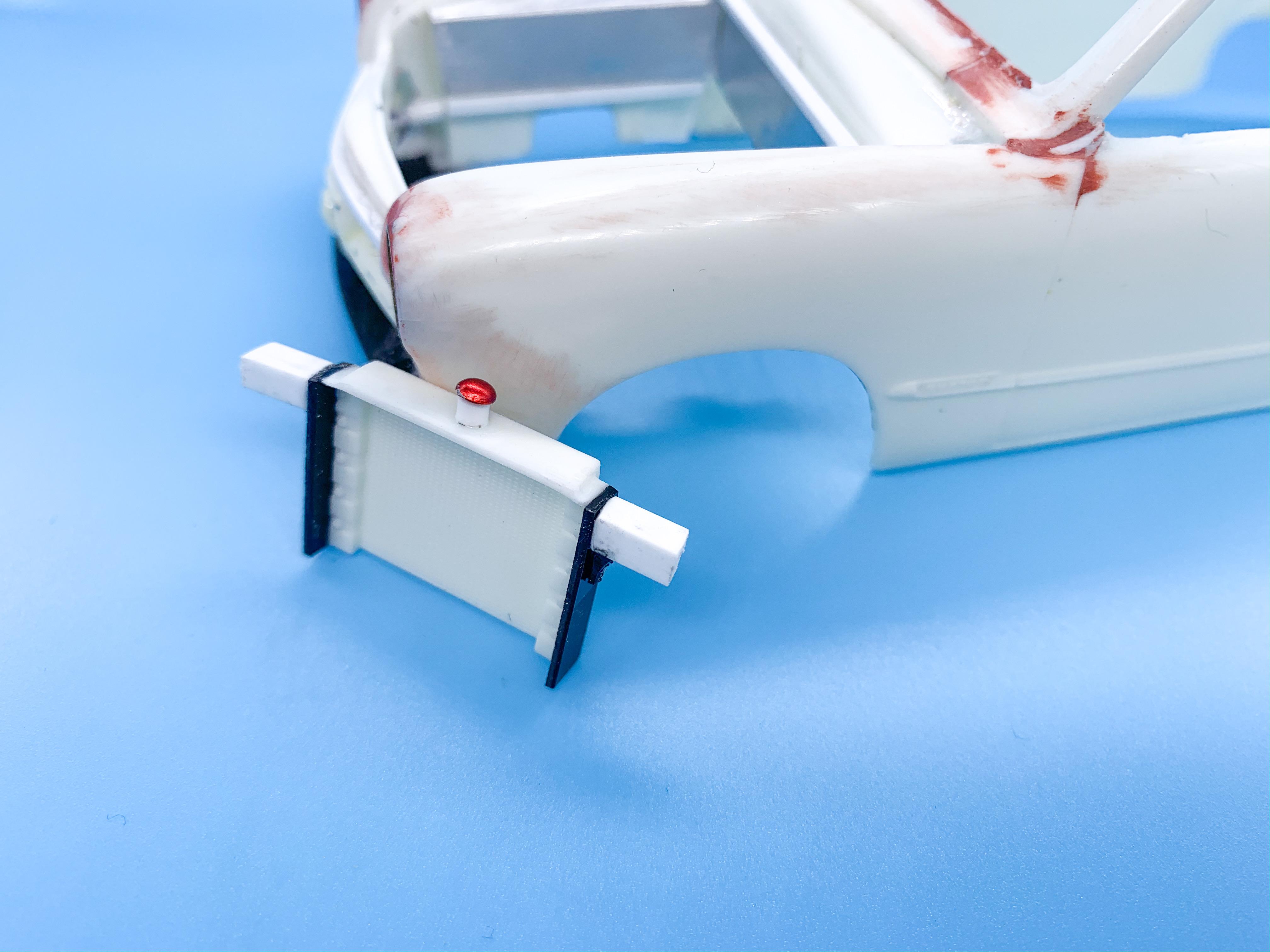

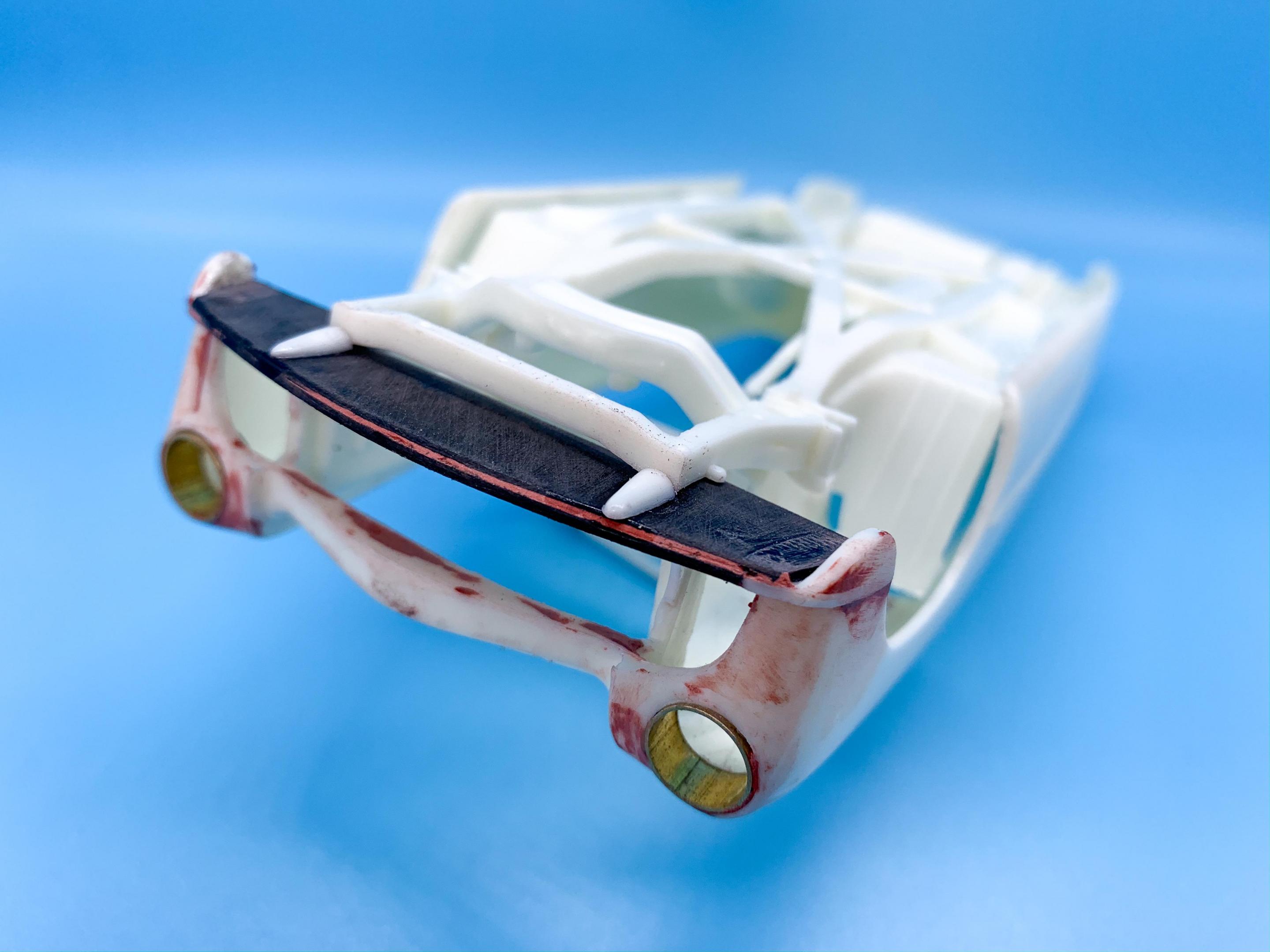

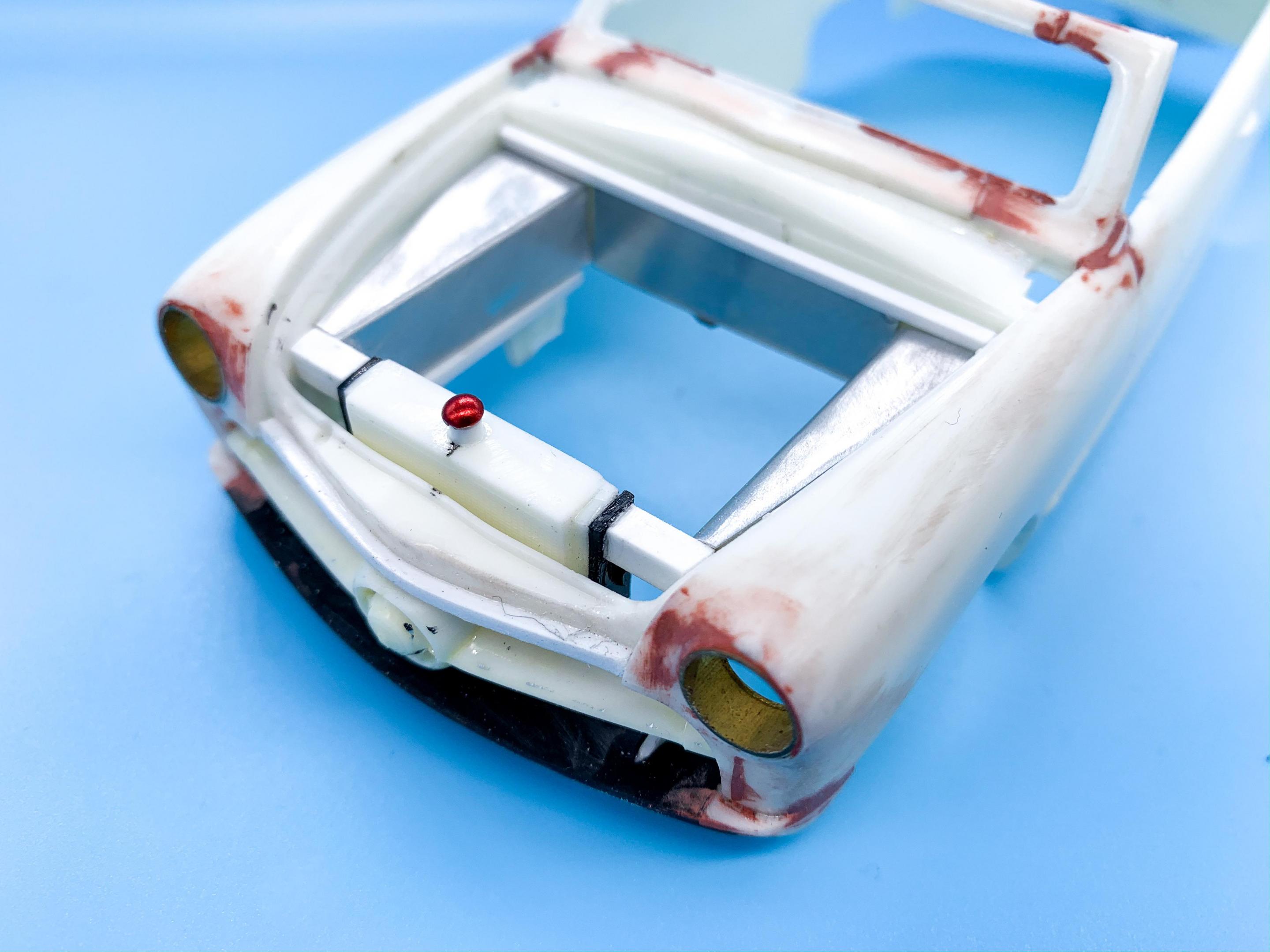

OldNYJim Posted January 17, 2020 Author Posted January 17, 2020 A little more progress this morning - I wanted to use the stock radiator, but the support didn’t line up nicely with the new inner wings that I had made - I wanted it all to be level and even and nice and clean looking. I sliced the edges of the stock support off, leaving just the rad itself, and make a new support assembly from styrene strip and square bar: I spotted these little split-pins (intended for scrapbooking, I think) in the clearance rack in Michael’s last weekend, and for a quarter I figured I’d find a use for them - I think if I strip the anodizing off they’ll make a nice looking metal cap for radiators, oil tanks, gas tanks etc. Not sure what will strip the coating off just yet - tried some industrial bleach which doesn’t seem to be touching them, and the Purple Pond didn’t make an impact either...any ideas anyone? Anyhoo, bright red radiator cap aside I’m pleased with how this looks in the newly cleaned-up engine bay: Next job is to tackle the windshield, seeing as I chopped that frame up and messed with it ??. More soon!

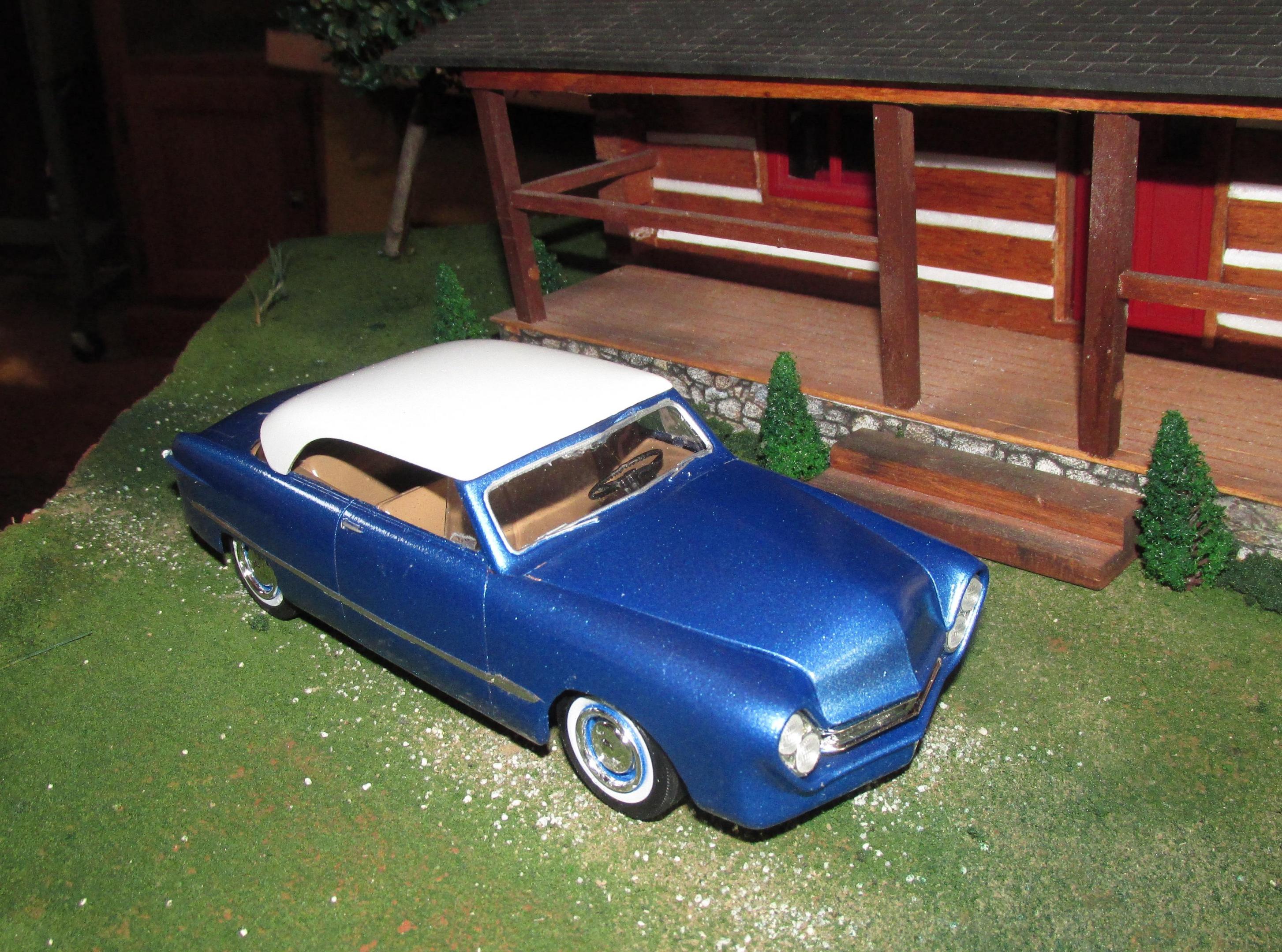

Sixties Sam Posted January 18, 2020 Posted January 18, 2020 Lookin' good, Jim! Nice woek on the top/windshield frame mods. I recently built that same kit, and used a custom top, custom front end, and extended hood from an original kit. My paint job isn't so great, but it will have to do.
OldNYJim Posted January 19, 2020 Author Posted January 19, 2020 21 hours ago, Sixties Sam said: Lookin' good, Jim! Nice woek on the top/windshield frame mods. I recently built that same kit, and used a custom top, custom front end, and extended hood from an original kit. My paint job isn't so great, but it will have to do. Nice kustom Sam! I like the color scheme - pretty close-ish to what I’m thinking!
