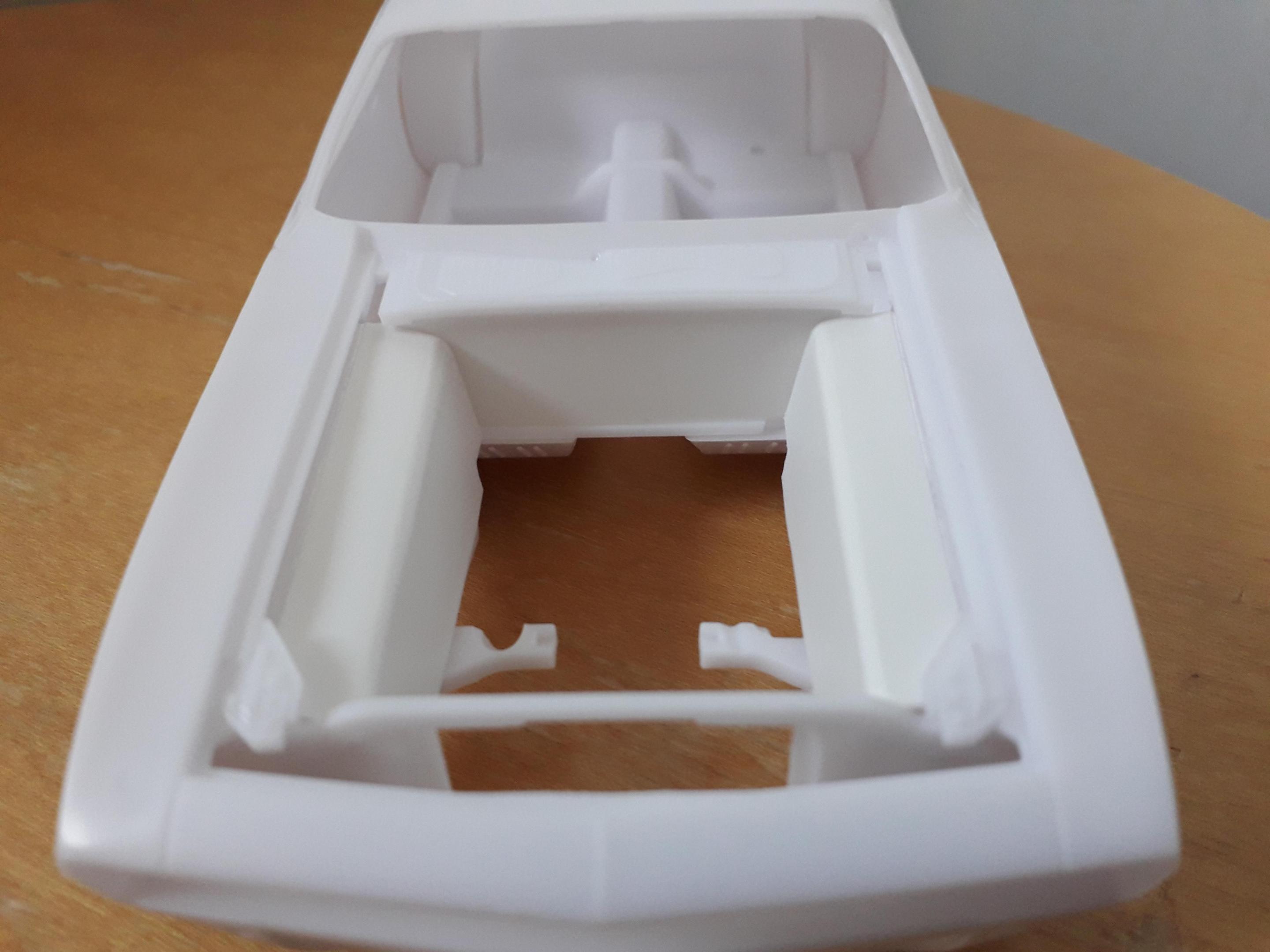

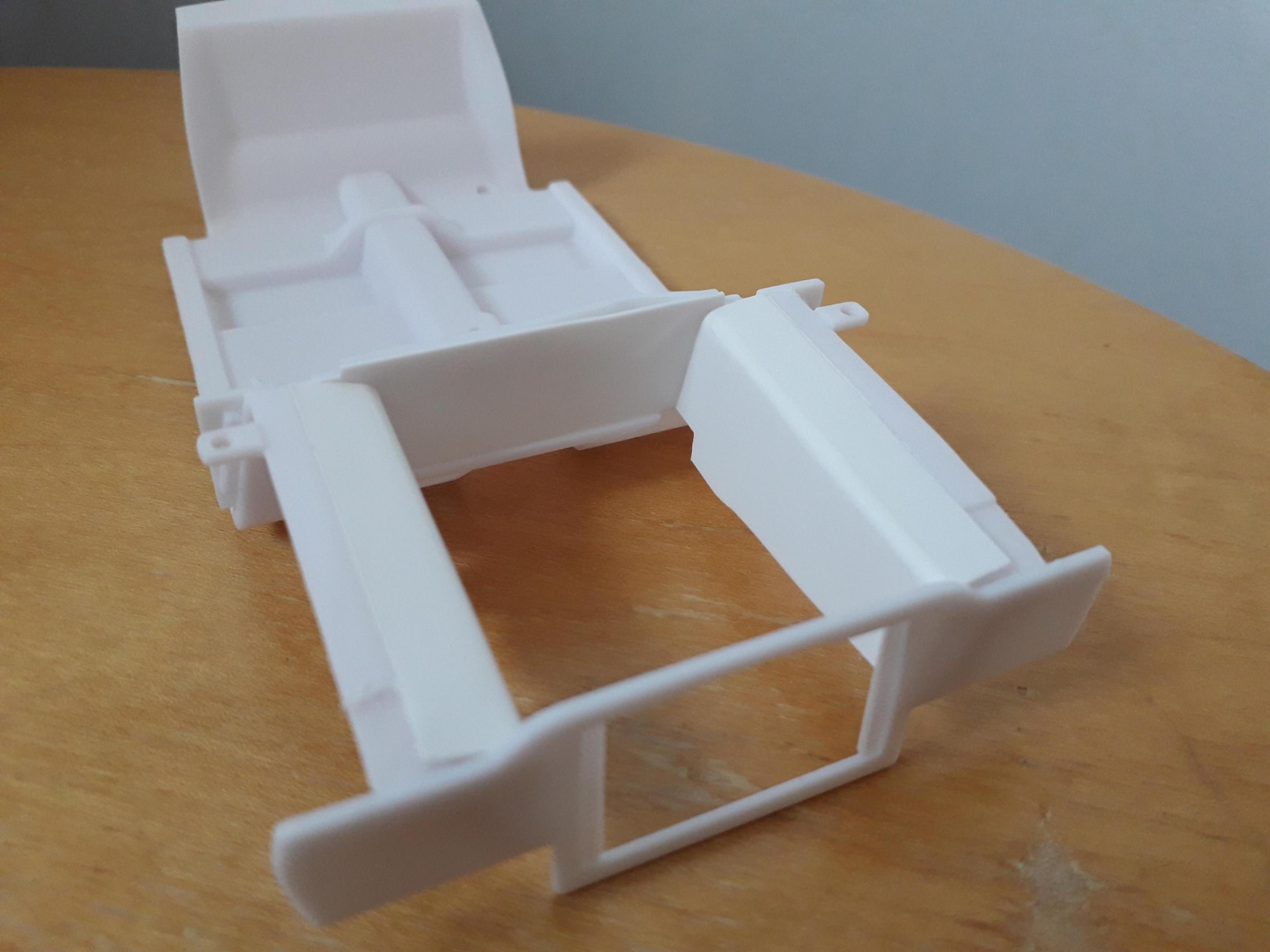

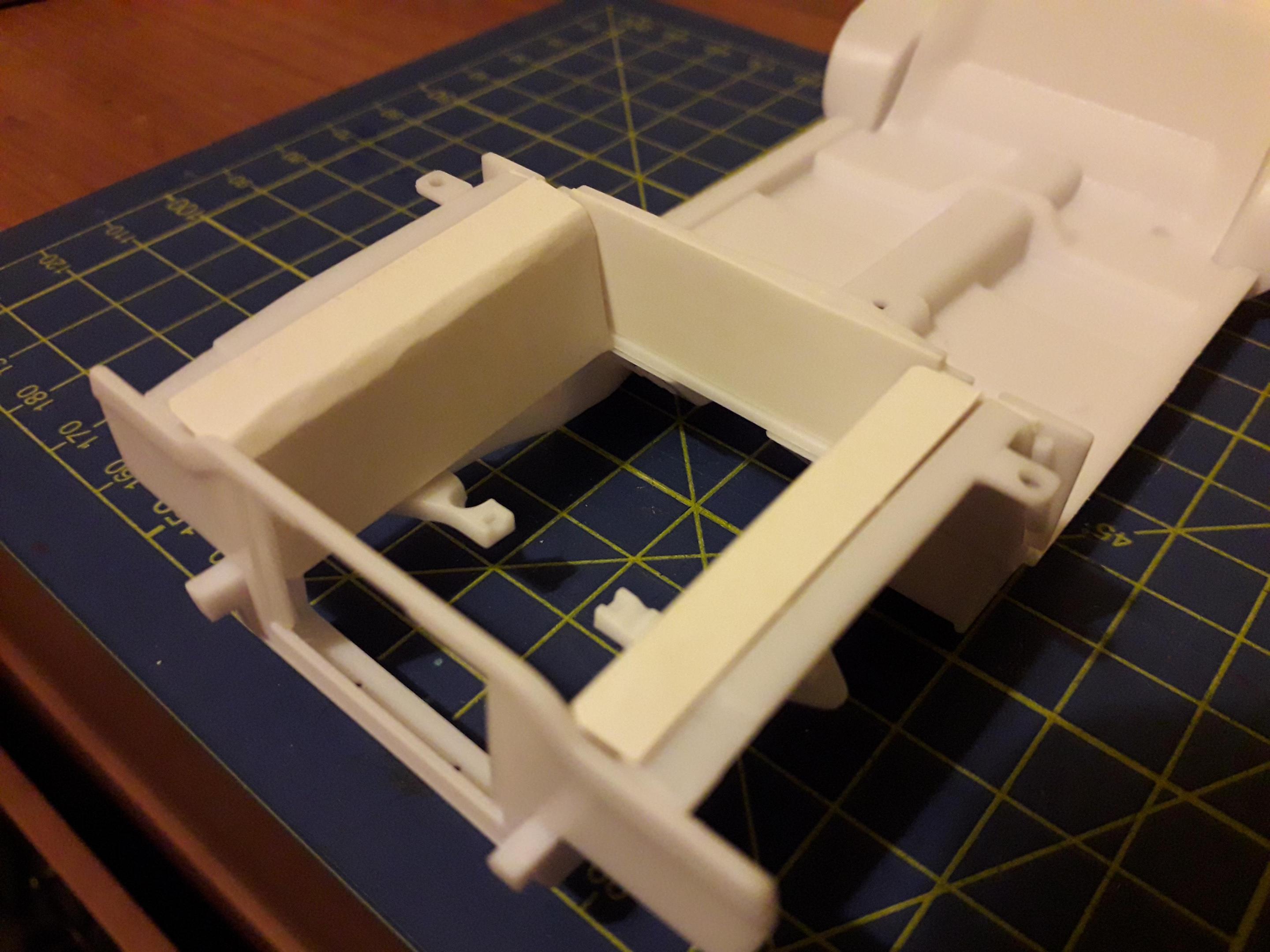

Lowlife ! ! Posted January 3, 2020 Author Posted January 3, 2020 (edited) So i thought id start with the engine bay ! First a smooth firewall, and inner arches from cardboard........ Then transfer to plastic, and a bit of trial and error..... this ! Edited January 3, 2020 by Lowlife ! !

Cool Hand Posted January 3, 2020 Posted January 3, 2020 Yeah, great inspiration. Like the smoothing out of the engine bay, look forward to seeing what other custom work you do Martin.

beeRS Posted January 4, 2020 Posted January 4, 2020 Nice work so far Martin. I love that car you're taking inspiration from. It kind of reminds me of the stuff that the Ring Brothers, or Foose would build. The smoothed out engins bay not only looks good, but saves a lot of detailing work further down the line. Of course an engine bay like that needs a serious motor in it. What's it gonna be? Something supercharged with 1000bhp?
Lowlife ! ! Posted January 4, 2020 Author Posted January 4, 2020 11 hours ago, Dann Tier said: This is gonna be BRILLIANT!!!!.....I love making stencils first!! Haha, thanks Dann its so much easier working with cardboard, i also save the chrome effect card you get in easter eggs etc and use it on my lowrider builds.. You can engrave it too as its card ! 1 hour ago, beeRS said: Nice work so far Martin. I love that car you're taking inspiration from. It kind of reminds me of the stuff that the Ring Brothers, or Foose would build. The smoothed out engins bay not only looks good, but saves a lot of detailing work further down the line. Of course an engine bay like that needs a serious motor in it. What's it gonna be? Something supercharged with 1000bhp? Thanks Sonny i do love those style of cars, Foose is the master, and some of the Ring Brothers stuff are the best detailed cars ive seen. Not sure about saving detailing work later though ? When you add these smooth panels you also have to think about how it looks from underneath, and the bonnet has to close properly, engine has to still fit etc ! I think its probably easier to add the details in the bay rather than smooth it all ! As for the engine, it has a HEMI so its going to be big whatever happens !

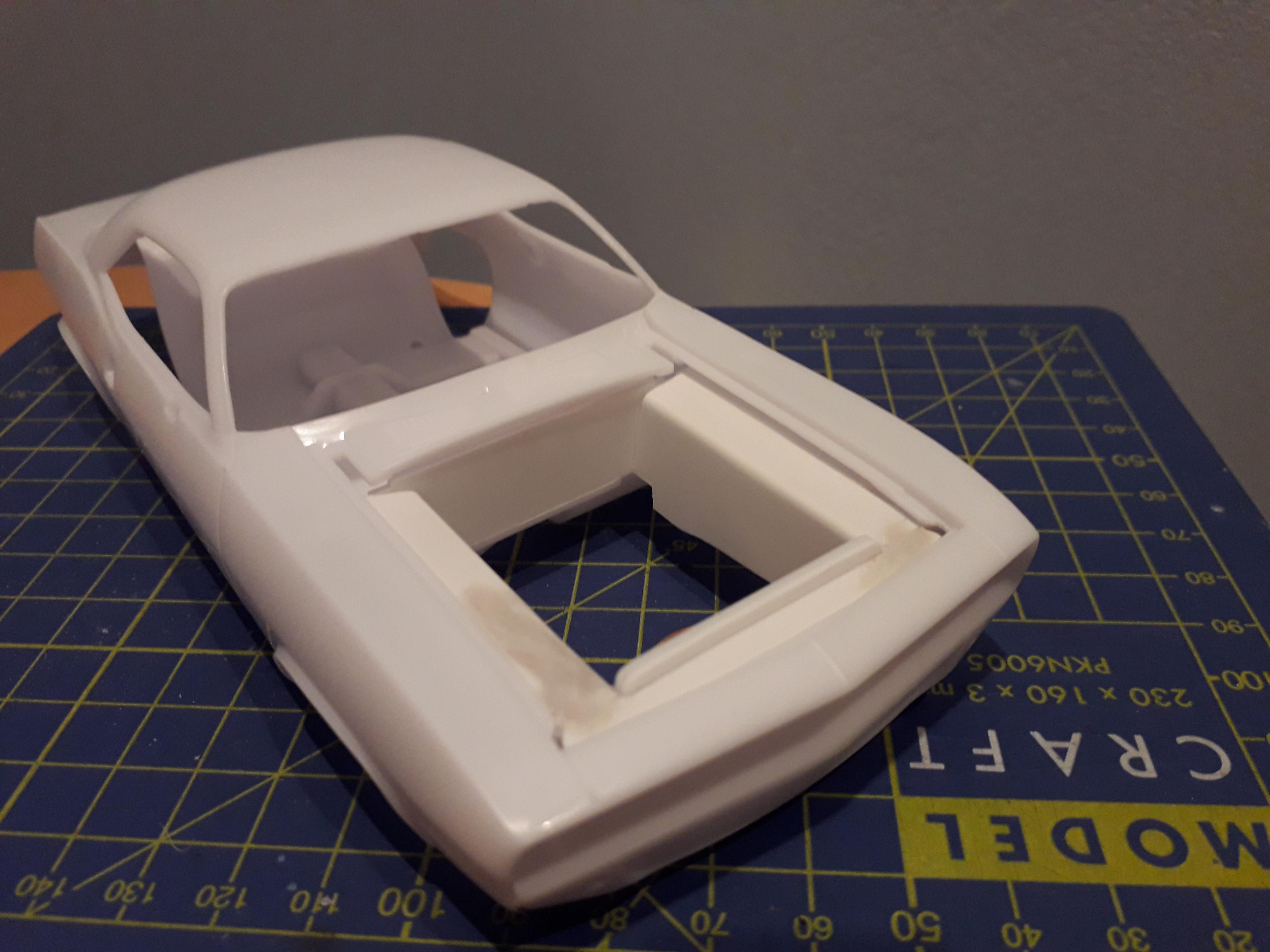

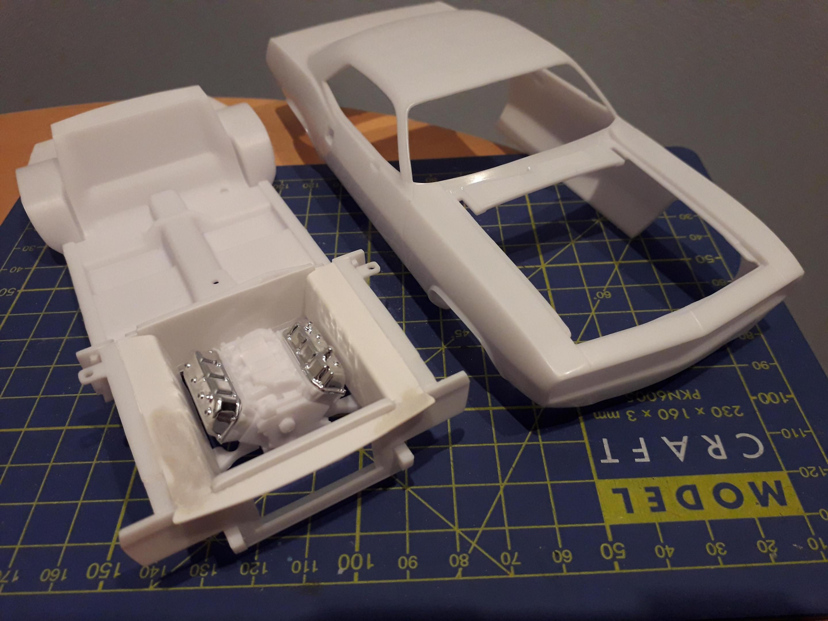

Lowlife ! ! Posted January 4, 2020 Author Posted January 4, 2020 (edited) Added a bit more to this, i wanted to fill the gap in front of the radiator so ive continued the smooth sides, down to the front. The front panel has to fit exact or it lifts the body away from the engine bay. Covered the radiator bulge in plastic, and removed the bonnet pin panels from the sides. Bit more smoothing and i can primer it next ! Hemi has been started, its a bit tight in there but does fit ok ! More soon, thanks for looking ! Edited January 4, 2020 by Lowlife ! !
mustang1989 Posted January 4, 2020 Posted January 4, 2020 Very good work boxing that engine bay in. This is gonna look shuweeeet!!!
Dann Tier Posted January 4, 2020 Posted January 4, 2020 4 hours ago, mustang1989 said: Very good work boxing that engine bay in. This is gonna look shuweeeet!!! I agree 100%!!!!, and thats a cool idea about the shiny paper!!!

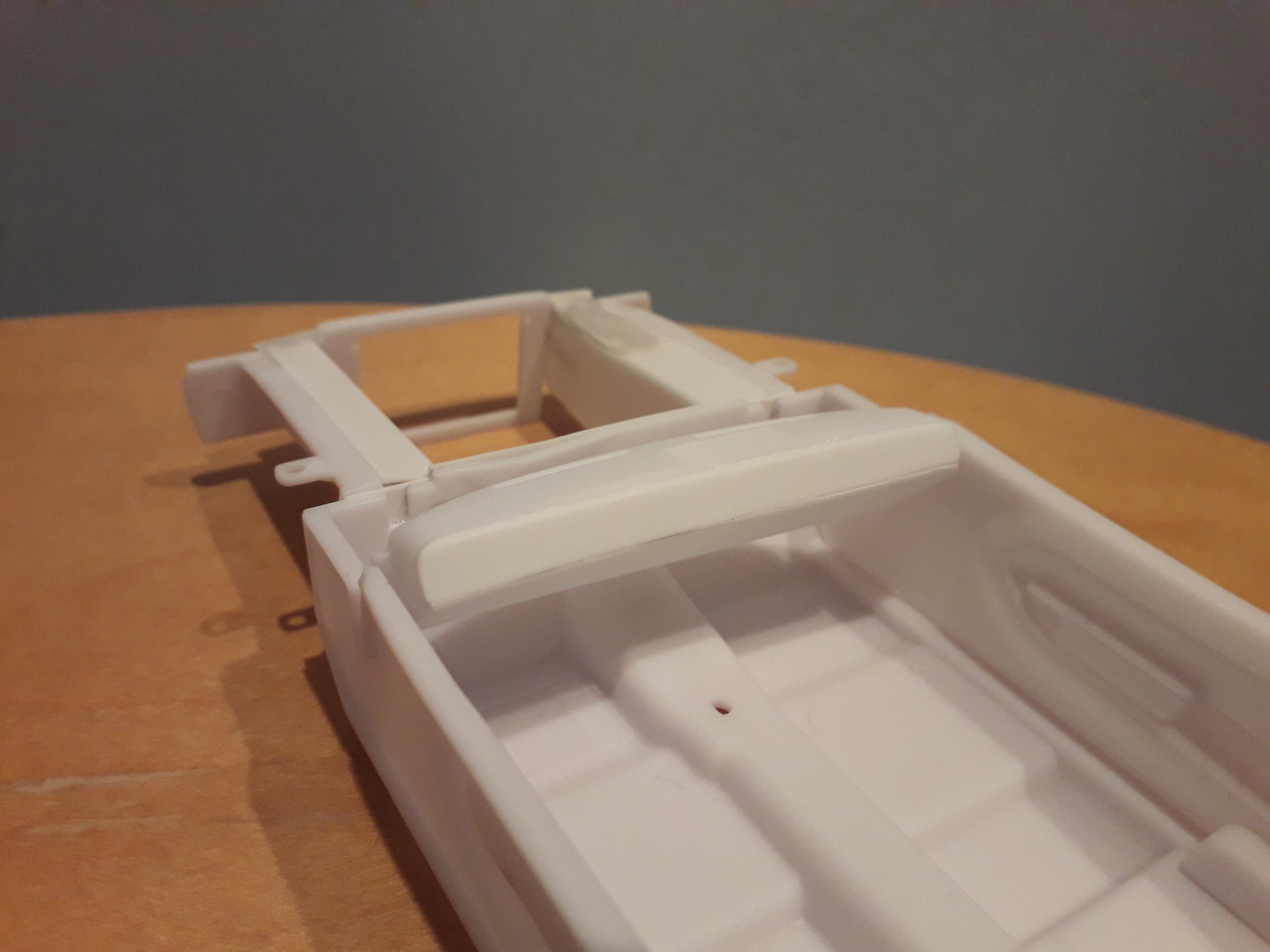

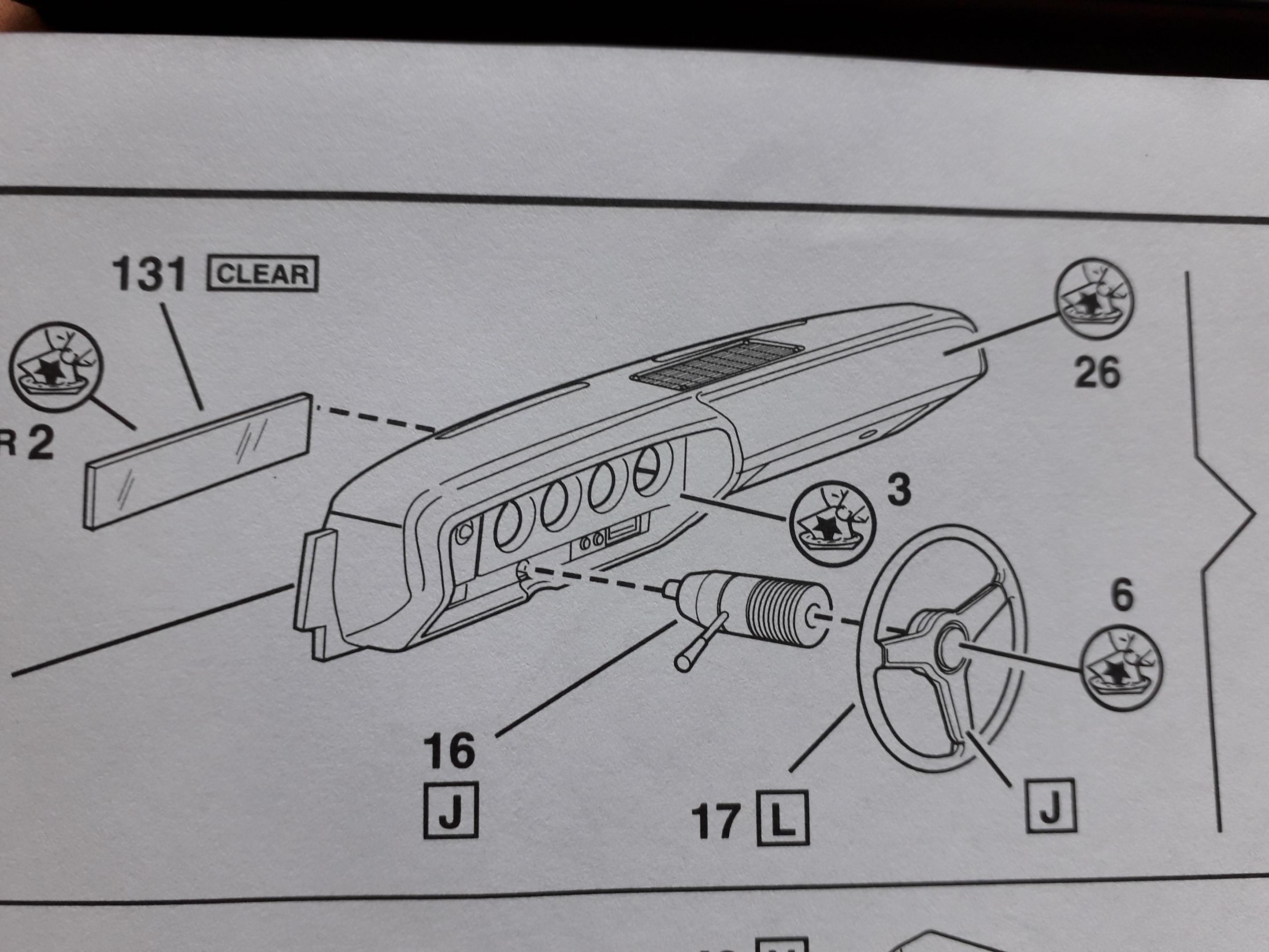

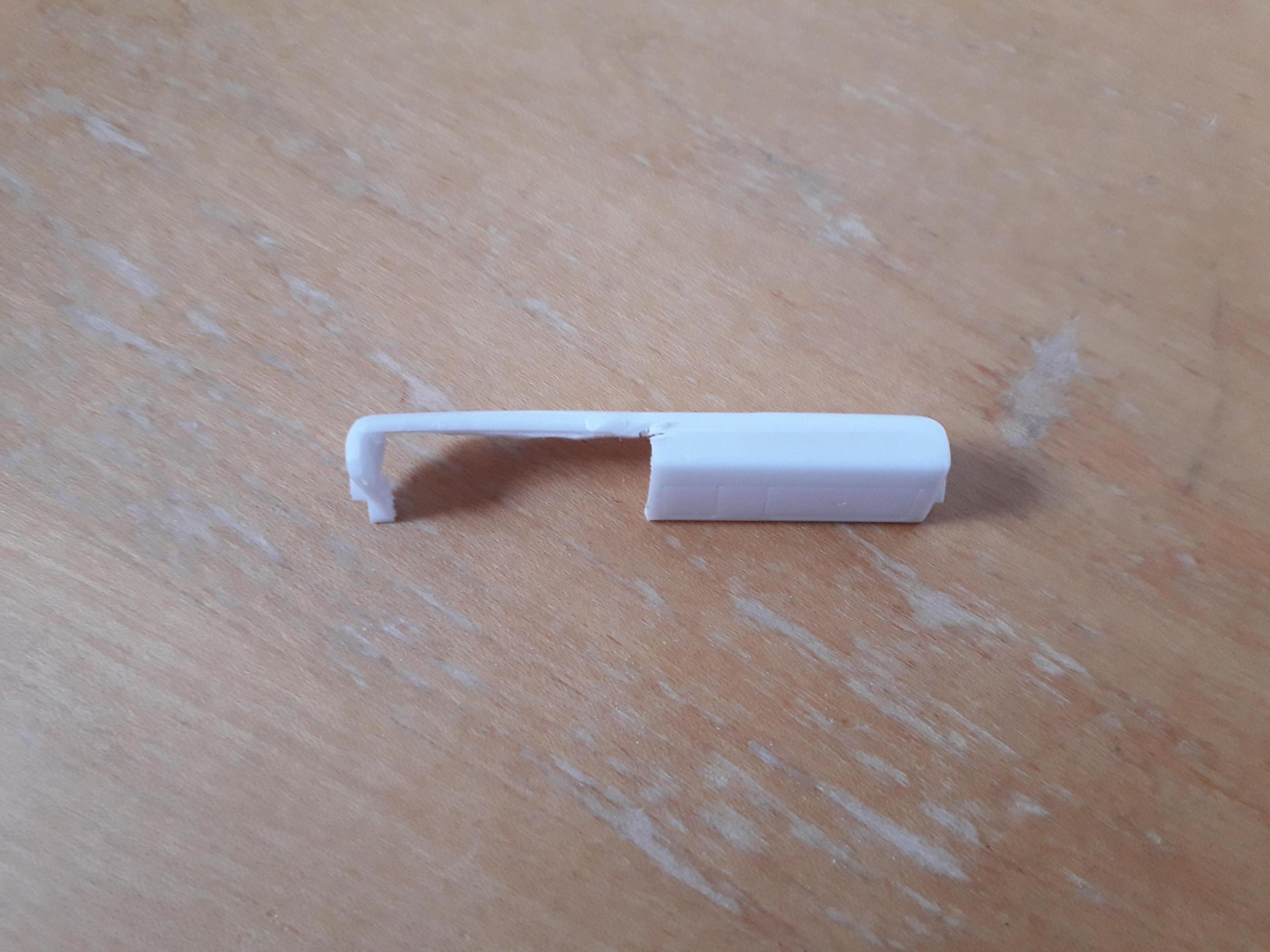

Lowlife ! ! Posted January 7, 2020 Author Posted January 7, 2020 (edited) Joe, Dann, thanks guys ! Im doing bits here n there on this, weathers still naff to even primer so im still cutting stuff up ! Dashboard was next, wanted a different look so ive smoothed it ! Here it is before , sorry forgot to take a pic of the real thing ! Chopped out the drivers section... And heres an interior mock up, maybe a centre console next ? ( dash not quite finished off yet! ) Edited January 7, 2020 by Lowlife ! !

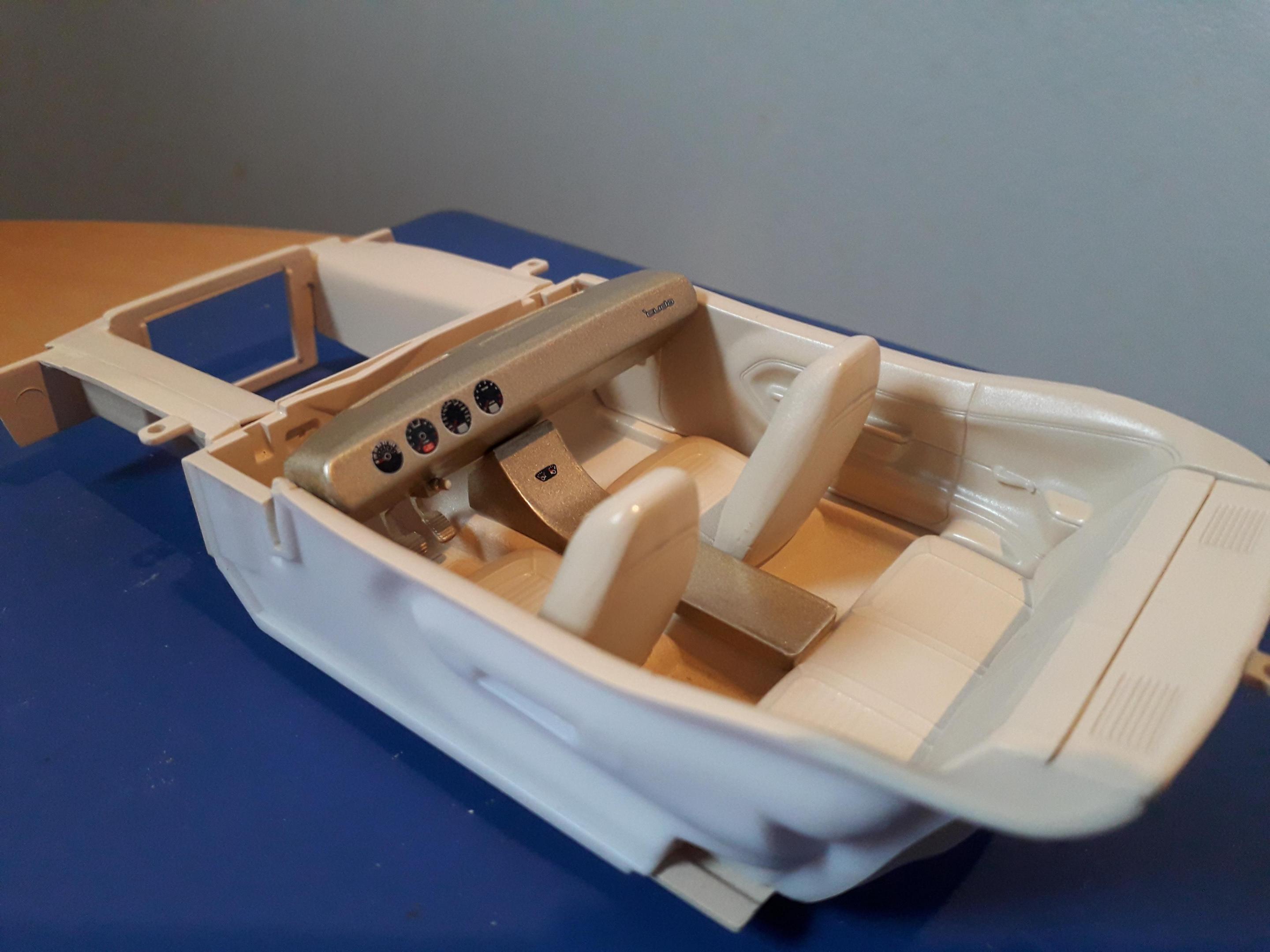

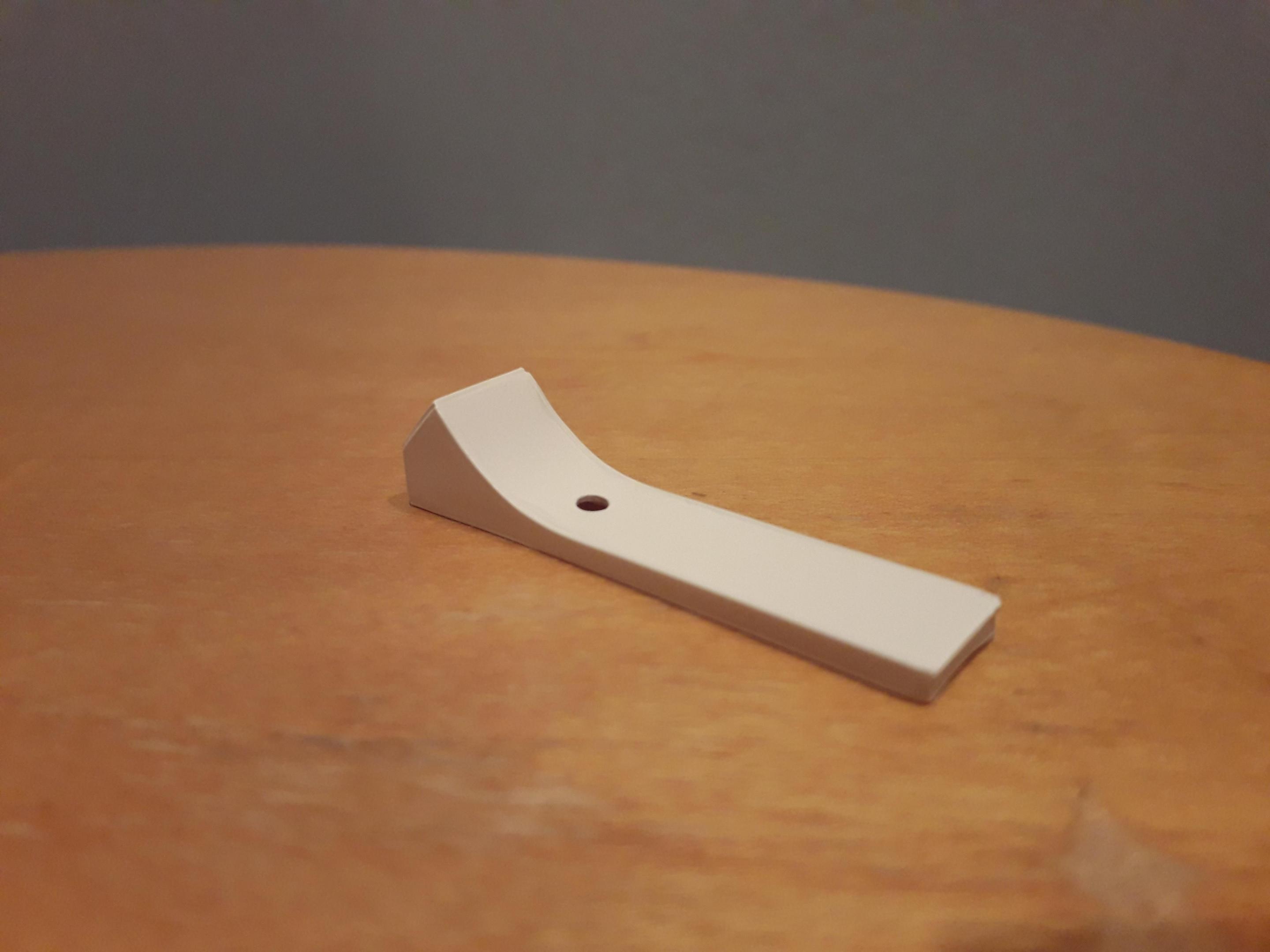

Lowlife ! ! Posted January 17, 2020 Author Posted January 17, 2020 (edited) Thanks guys ! Bit more on this, centre console has been scratchbuilt and the interior is now Ivory with a gold dash and console... So i guess im not following the original cars colours of blue and silver ! The 4 dials (Audi R8) and cuda badge are copying the original layout, just smoother ! Might add another colour to the interior as its a bit plain, but the Ivory colour is also going on the engine bay and floorpan. Still lots more to add to the interior, so i`ll post up a pic when its finished ! Edited January 17, 2020 by Lowlife ! !
DumpyDan Posted January 17, 2020 Posted January 17, 2020 Looking awesome, will be following along. Keep the pics coming.
lghtngyello03 Posted January 17, 2020 Posted January 17, 2020 This is going to be an awesome build. Love the work you have done on the engine bay and interior. Lots of good skill there. Can’t wait to see what else you’re going to do.
Dann Tier Posted January 17, 2020 Posted January 17, 2020 Just as i predicted...its looking PERFECT!!!....outstanding job on that smoothed look, bud!!!
Cool Hand Posted January 17, 2020 Posted January 17, 2020 Clean looking interior there Martin, good selection with the colour combo.
