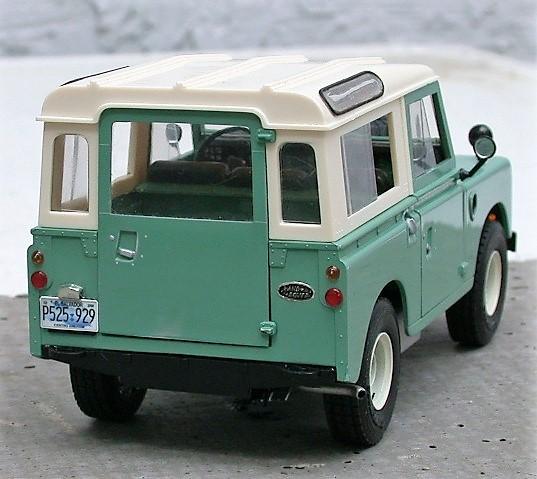

Revell's new-tool Land Rover kit is a dream come true! While I give my local hobby shop (Top Shelf Models near Tulsa) a chance to get it in stock, I decided to dig this old relic out of the attic and give it a try.
The Land Rover is probably my all-time favorite Monogram kit. I bought my first one at TG&Y in 8th grade, and it went through several paint/modification stages that seemed cool to me in junior-high. The kit pictured here came from a hobby shop in the mid-1980s when I was in high school. I broke the body early in the build process, and then put it in the box where it remained for decades.
At first, I thought I was keeping the parts for when Monogram eventually reissued the kit. I've tried finding an unbuilt example for years, but prices are through the roof. Revell's new tool hints (in the best possible way) that Monogram's old tool is probably gone for good, and Revell's new kit probably outshines the 1980s version in every way. I can't wait to build the new kit. Meanwhile, what I have here looks mostly complete, and I'm not so discouraged by the repair as I was years ago.

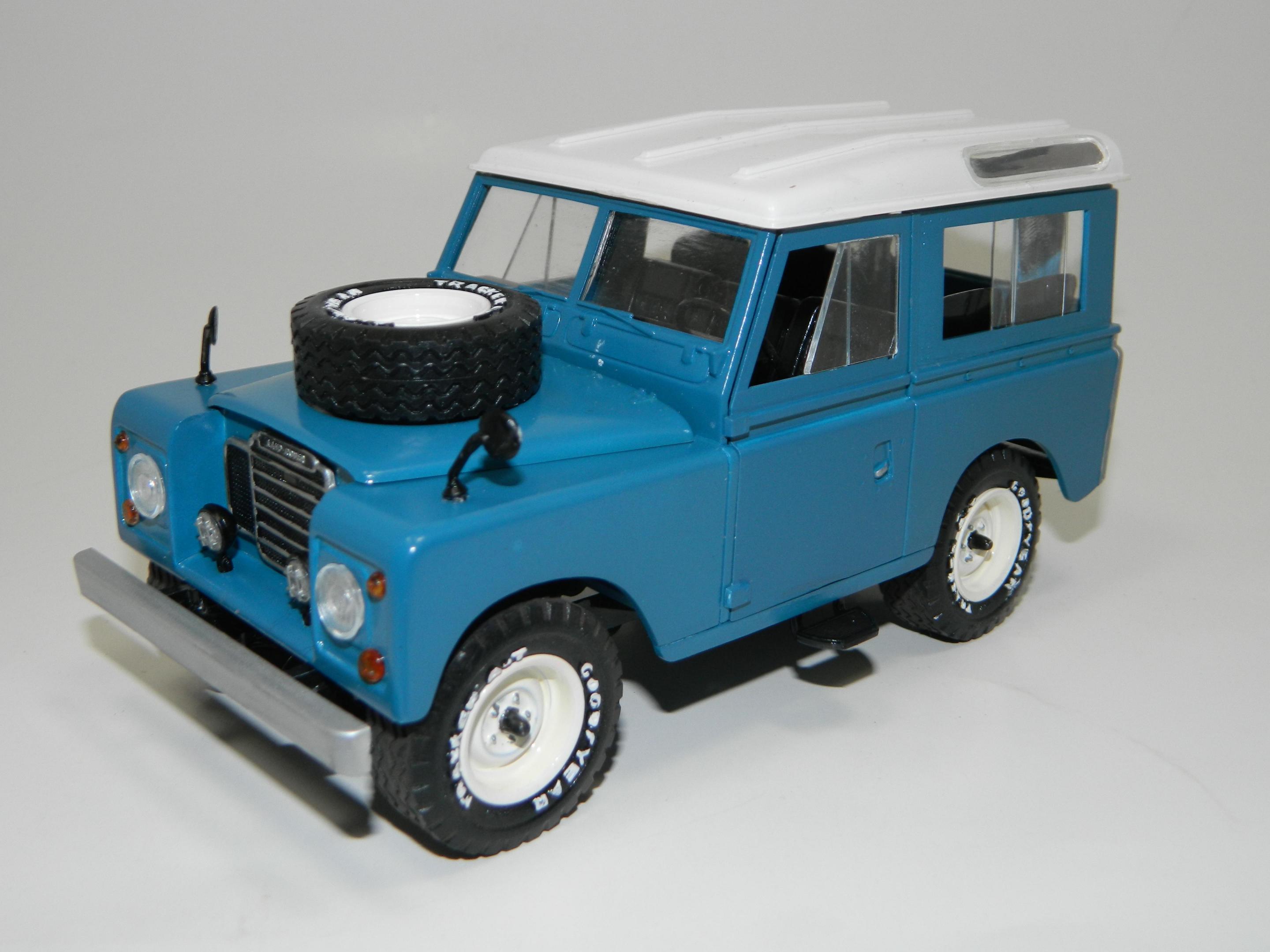

I was also trying to work out why the headlights on the built examples above look different to standard, in reality they're set slightly behind the surround, which can be either body-coloured or painted silver:
1974 Land Rover 88" 2.2 petrol by Spottedlaurel, on Flickr
1974 Land Rover 88" Petrol by Spottedlaurel, on Flickr
1982 Land Rover 88" Diesel by Spottedlaurel, on Flickr
Edited by Spottedlaurel
I'm glad you pointed that out. My kit is missing one of its headlights, and Monogram LR's pieces are molded larger than most. In fact, I can't find anything that size in my parts box. I was planing to make do with smaller replacements, and now I can see smaller may be better for this build.
