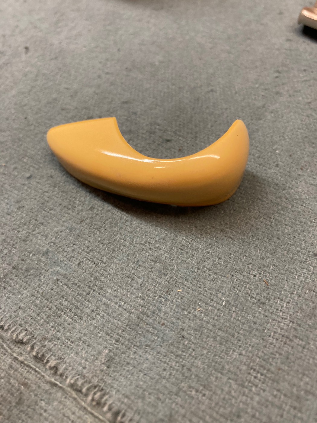

StevenGuthmiller Posted January 24, 2020 Posted January 24, 2020 1 hour ago, 1972coronet said: I avoid Testors Lacquer clear coat --- in the old standby can as seen in your image --- like the plague . I've used their Enamel Glosscoat numerous times throughout the decades , and have recognised only excellent results (best results are when sprayed-atop Tamiya's 'TS' paints --- the glossiness looks wet when fully-"cured" , as though it's "sitting-on-top-of" the colour coats .) . Testors aerosol Lacquer Glosscoat always dried dull , no matter the colour coat . That stuff requires colour sanding and polishing . Well, I will throw out this warning about Testors enamel clear. Don't use it over any lighter colors. It will yellow horribly over time. This '37 Chevy was a pale beige.....until it turned this glorious yellow after a couple of months under Testors clear enamel. Steve
1972coronet Posted January 24, 2020 Posted January 24, 2020 4 hours ago, StevenGuthmiller said: Well, I will throw out this warning about Testors enamel clear. Don't use it over any lighter colors. It will yellow horribly over time. This '37 Chevy [ image in original post - Shoe ] was a pale beige.....until it turned this glorious yellow after a couple of months under Testors clear enamel. I've heard about that ! I typically only clear coat metallic and pearl colours (which is , by nature , necessary) , and rarely over solid colours (unless they dry dull or semi-gloss , and I don't want to burn-through while polishing) . I will take your expertise -- your expert advice -- to heart .

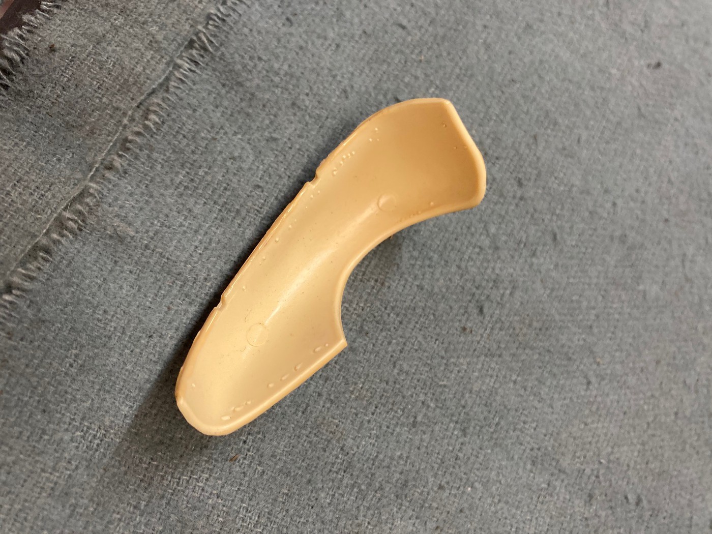

Snake45 Posted January 25, 2020 Posted January 25, 2020 On 1/23/2020 at 10:42 PM, peteski said: I venture a guess that the can is simply not labeled properly. I wonder if it was just a on-off mistake, or a larger batch of mislabeled cans is out there in hobby shops ready to ruin bunch of models? That was my first thought, too, because it looks exactly like the Dullcote I've used. You might be able to remove it from your body with 92% rubbing alcohol without damaging the underlying paint, depending on what kind it is. (If the red is Testor lacquer, the alcohol will take that off too.)

Larry Rose Posted September 2, 2021 Posted September 2, 2021 On 1/23/2020 at 11:00 PM, StevenGuthmiller said: "This '37 Chevy was a pale beige.....until it turned this glorious yellow after a couple of months under Testors clear enamel. Steve Wow. It even yellowed where you wouldn't have sprayed clear, like the inside of the body and fenders...very curious.
StevenGuthmiller Posted September 2, 2021 Posted September 2, 2021 54 minutes ago, Larry Rose said: Wow. It even yellowed where you wouldn't have sprayed clear, like the inside of the body and fenders...very curious. Well, there goes my credibility. Oh wait! Maybe not. You might want to clean your glasses before you challenge someone's integrity. Steve 2 1
