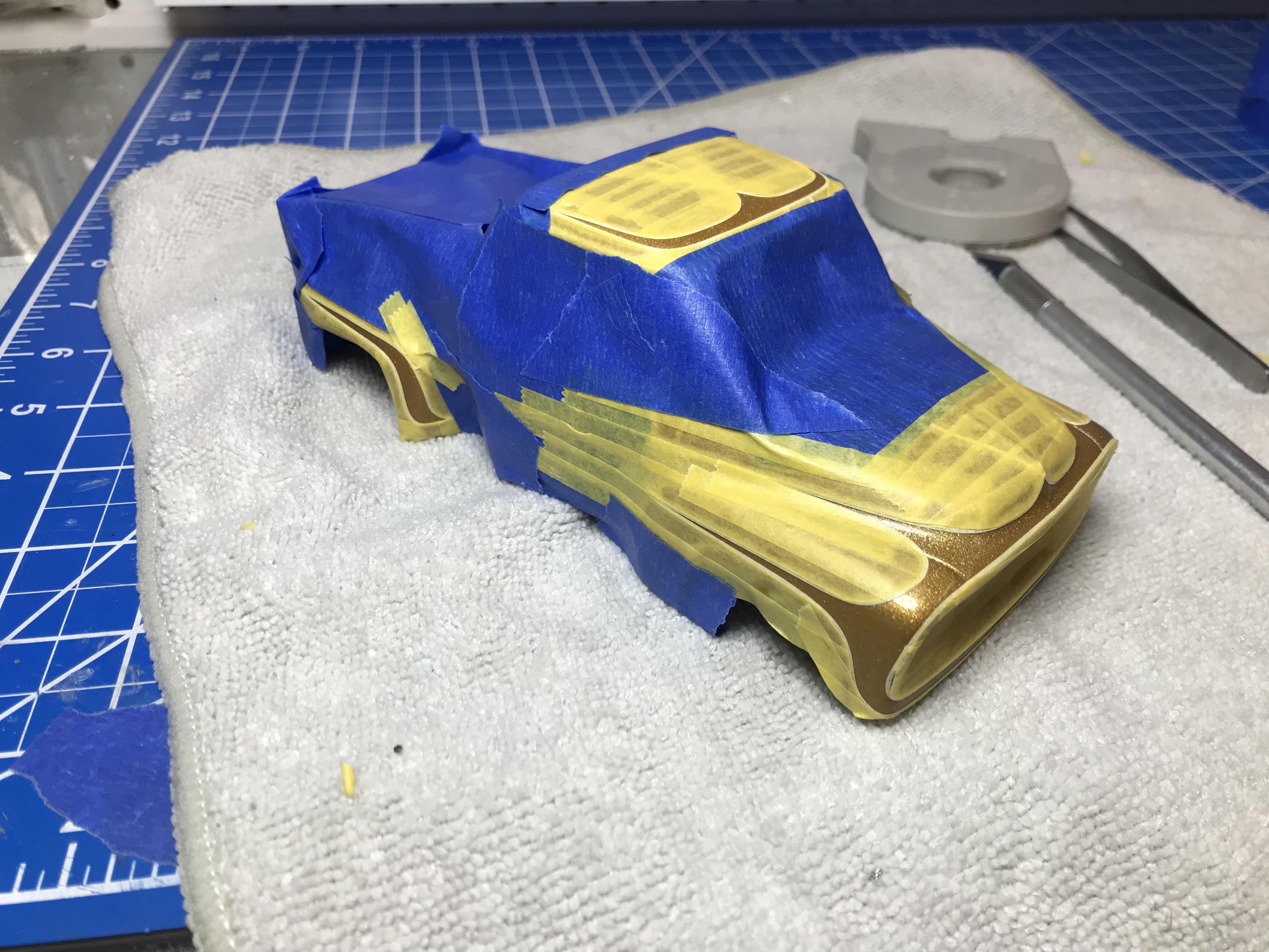

Tom Geiger Posted January 28, 2020 Posted January 28, 2020 I use Tamiya yellow for the important paint match lines. Then I use 3M Painters Blue for the rest of the masking. The white sections in this photo were painted blue. Look to the top of the photo, that's Tamiya tape in it's dispenser. The dispenser is important because it keeps the edges clean and dent free so you get a great match line. The first time you buy this tape, it's a bit more expensive to get the dispenser, but then you can buy the cheaper tape refills. Another tip to prevent bleed through is to shoot some clear over the tape edges prior to your color coat. The clear should bleed through any tiny imperfections in your taping, and seal them. It's easier to sand out / polish out the clear than a color coat.
