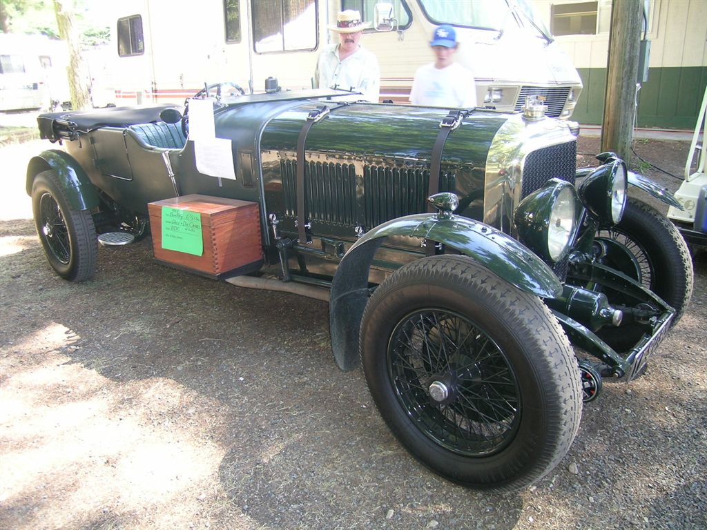

Phildaupho Posted February 11, 2020 Posted February 11, 2020 8 hours ago, DonW said: Vintage Bentleys are a passion of mine, my father owned a 1930 Speed 6 when I was in my 'teens and i absorbed all about the cars. But I never saw one like that! Have you got any photos? A properly set up Blower with the right bodywork - like on this lovely model - is good for 125 miles per hour, the team cars and other tuned ones even more. Many of the more sporting ones would give a 65 Falcon a run for it's money on a racetrack. Not so much off the lights. Thanks, -Don. It must have been this one although clearly it does not have dual rear wheels. Were they put on for the parade laps or is my memory playing tricks with me. Albeit that Bentley was mighty impressive when driven with gusto !!
DonW Posted February 11, 2020 Posted February 11, 2020 (edited) 4 hours ago, Phildaupho said: It must have been this one although clearly it does not have dual rear wheels. Were they put on for the parade laps or is my memory playing tricks with me. Albeit that Bentley was mighty impressive when driven with gusto !! No wonder it went so well. That's a Speed Six, 6597cc / 402 cubic inches, OHC and 4 valves per cylinder. What identifies it are the parallel sides to the radiator itself and the cylindrical alloy casting in front of the radiator, between the dumb-irons, which is the dynamo. Only the Speed Six and the Big Six had this. Not to be confused with the supercharger that sat in the same place on the Blower four and a half litre cars. Thanks for posting, Phil -Don. Edited February 11, 2020 by DonW
