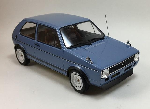

Erik Smith Posted February 14, 2020 Posted February 14, 2020 (edited) I have a cardboard box with the sides cut out and tissue paper over the holes set up right next to my work bench. I can put it in my paint booth for more light, but for WIP, I just use ambient light and my iPhone camera. Top photo is in the paint booth, so more light. Bottom photo is with ambient light. Both with iPhone. Edited February 14, 2020 by Erik Smith
