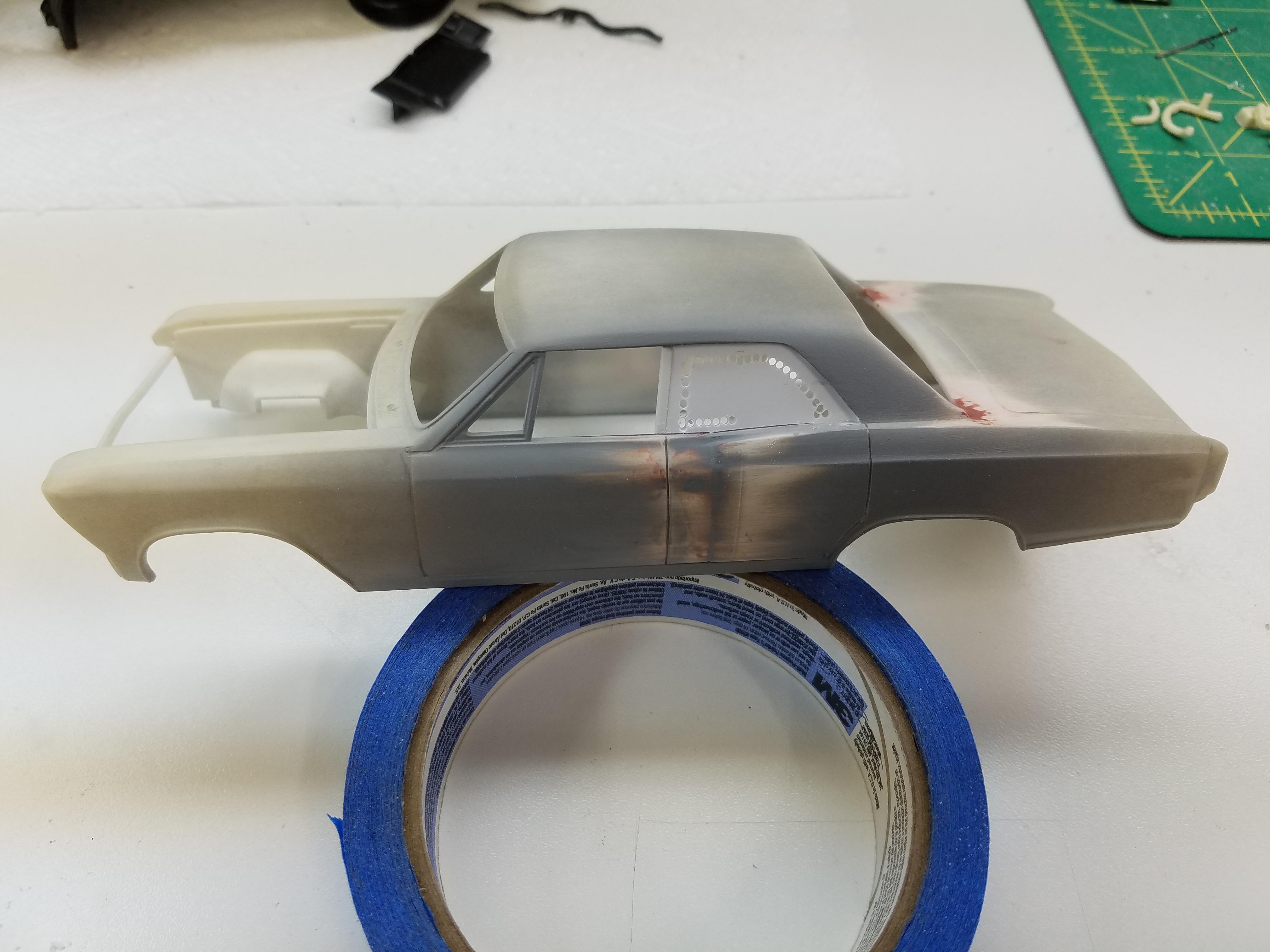

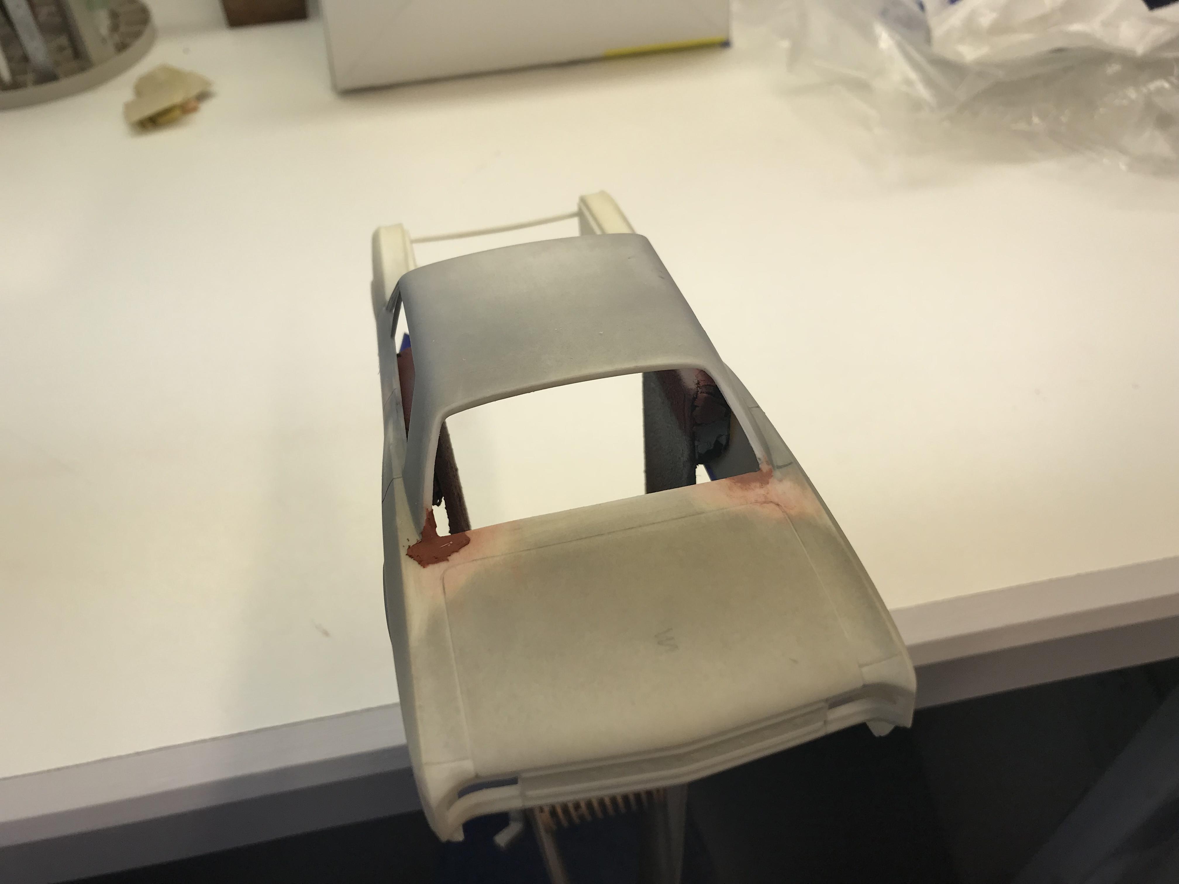

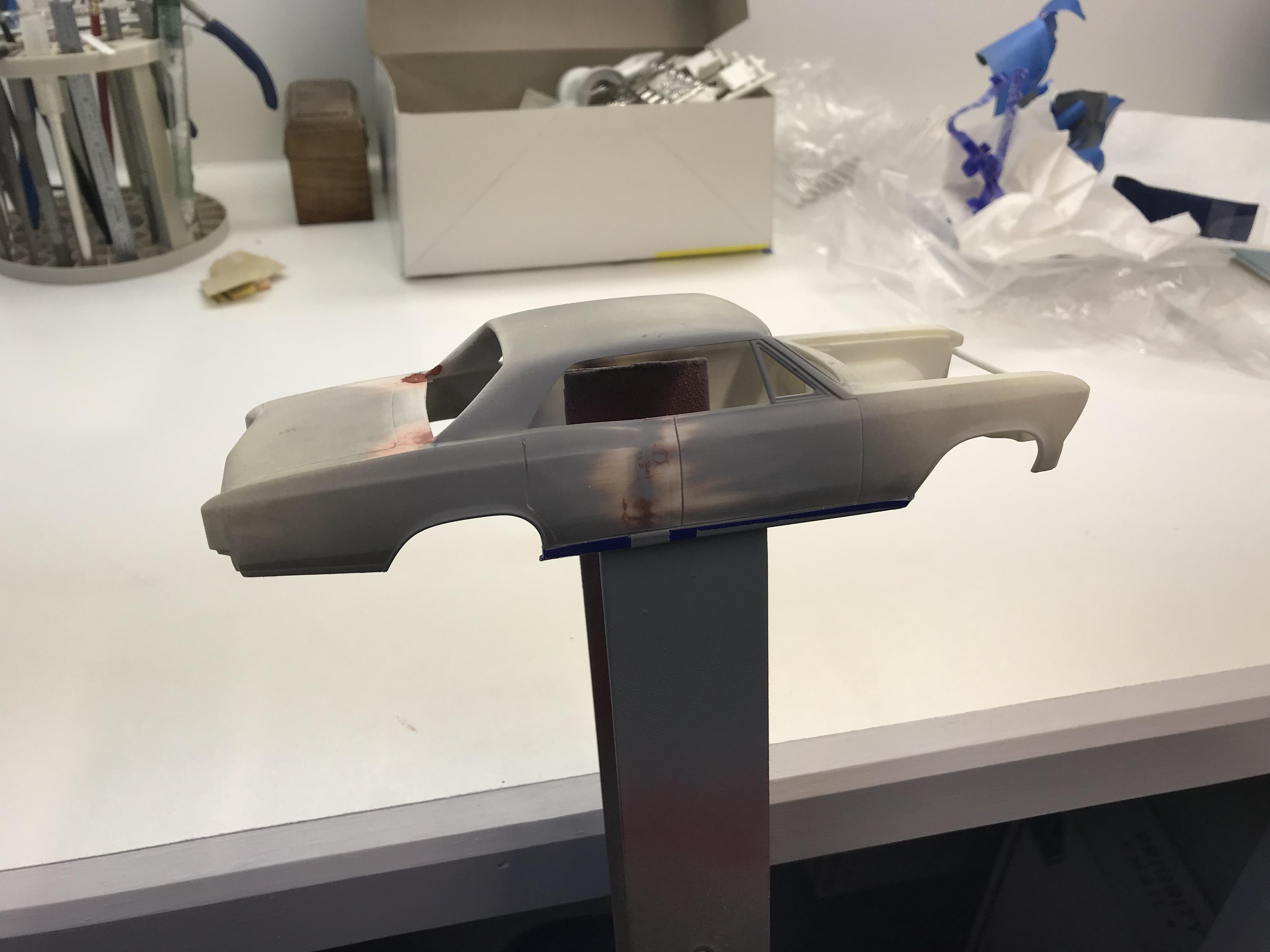

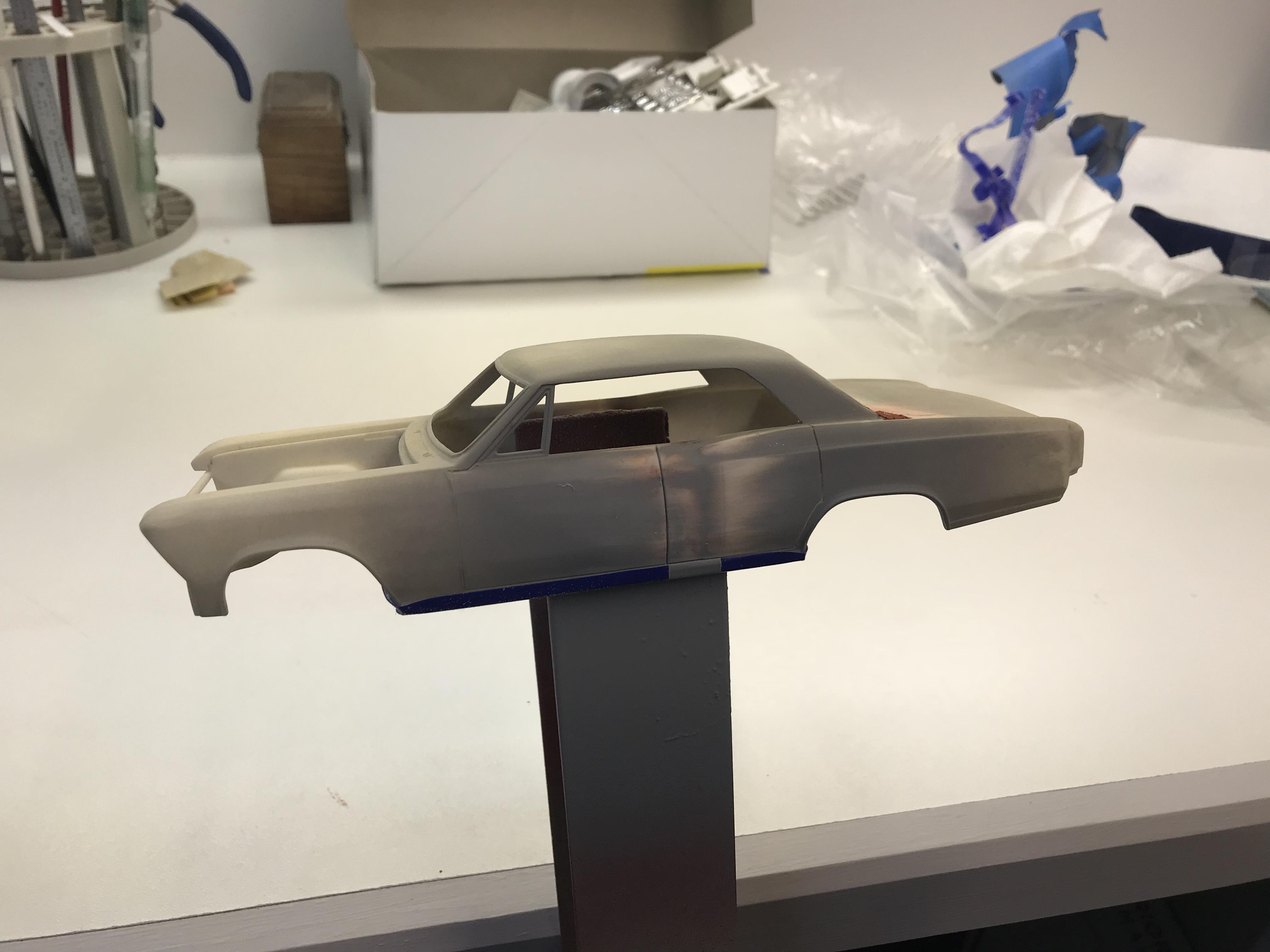

Dave72 Posted February 19, 2020 Posted February 19, 2020 Finally getting around to building my first car. A 1966 Malibu 4D that was given to me by my Grandma. Working on the door lines, and reshaping the side and back window openings. Using the Lindbergh 66 Chevelle SS. Fun so far! Got the steel wheels and hubcaps in the other day. First pic is what it would look like only with two more doors. Got the styrene ordered for the B pillars and window frames.
espo Posted February 19, 2020 Posted February 19, 2020 Great job so far on your conversion. That rear window area had to be fun.

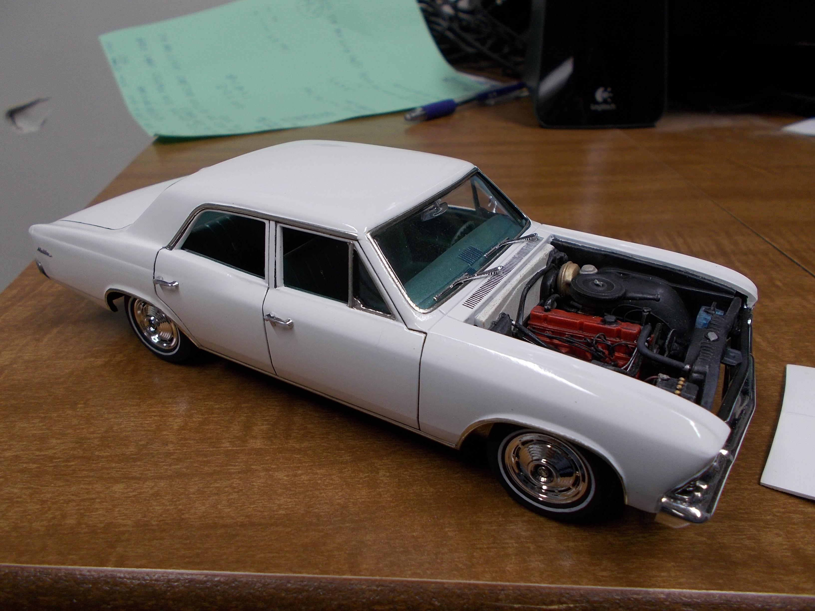

Repstock Posted February 19, 2020 Posted February 19, 2020 Great minds think alike. I used the '66 Chevelle wagon as a starting point. 1
Dave72 Posted February 20, 2020 Author Posted February 20, 2020 I just bought one from MCW finishes. Yes, that one looked the best. WOW TOM! Exactly what I’m shooting for. Your build looks awesome!!!!! You set the bar very high! How did you do the window frames so well? Do you have more pics of your build? A link maybe? Man that’s cool.

Repstock Posted February 23, 2020 Posted February 23, 2020 On 2/19/2020 at 9:17 PM, Dave72 said: I just bought one from MCW finishes. Yes, that one looked the best. WOW TOM! Exactly what I’m shooting for. Your build looks awesome!!!!! You set the bar very high! How did you do the window frames so well? Do you have more pics of your build? A link maybe? Man that’s cool. If I understand your question correctly, the window frames on the side windows are part of the wagon kit.

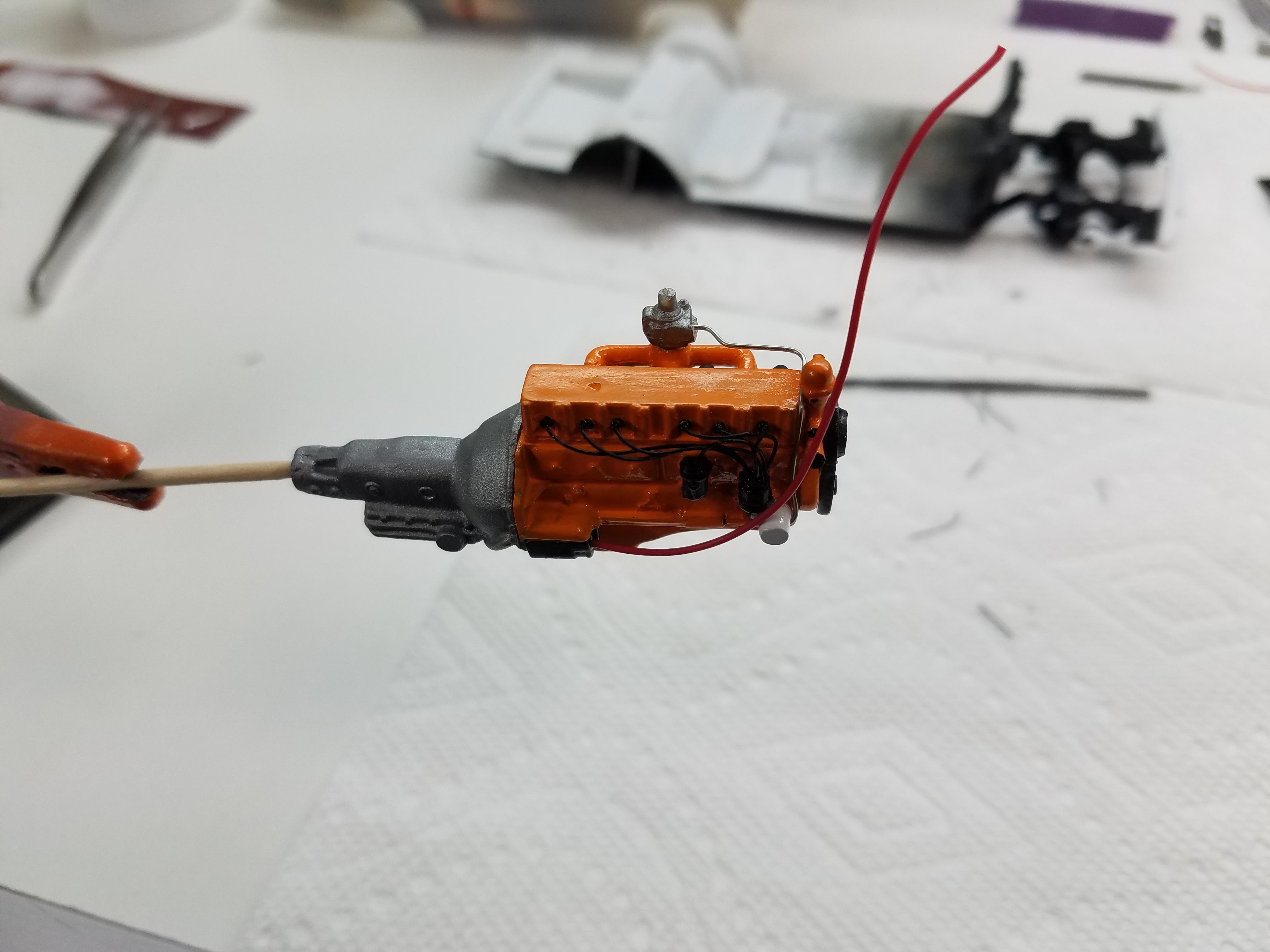

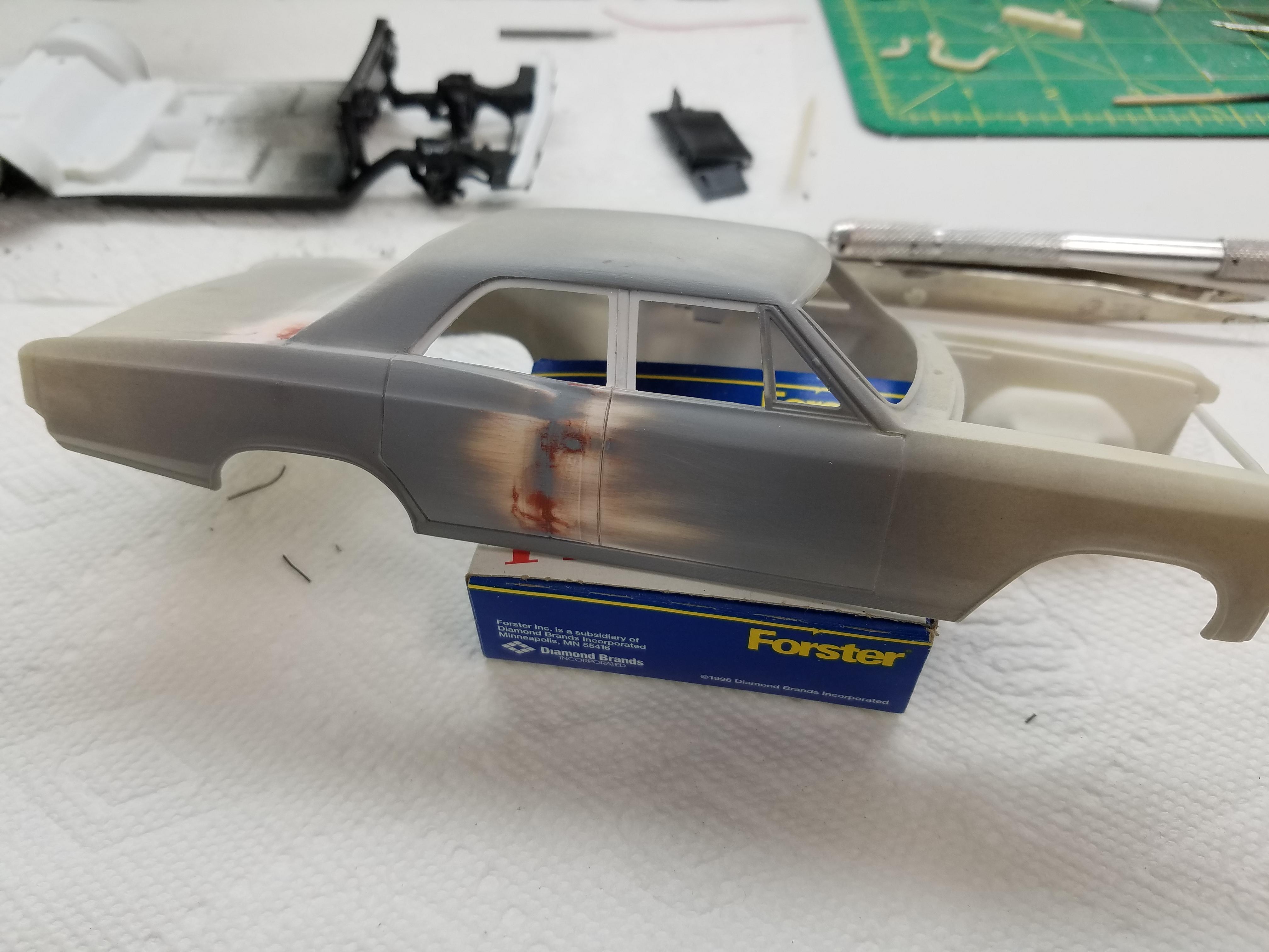

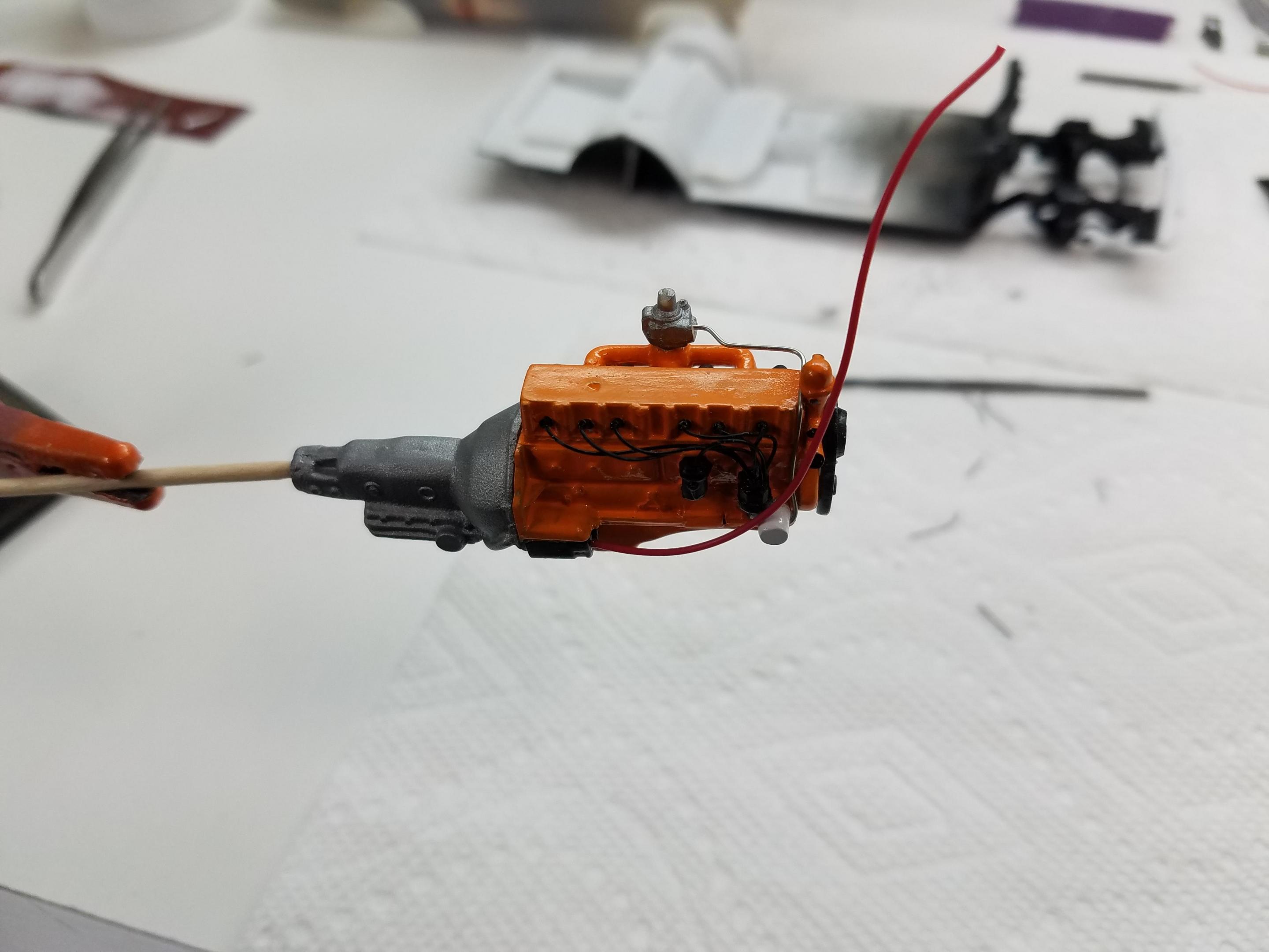

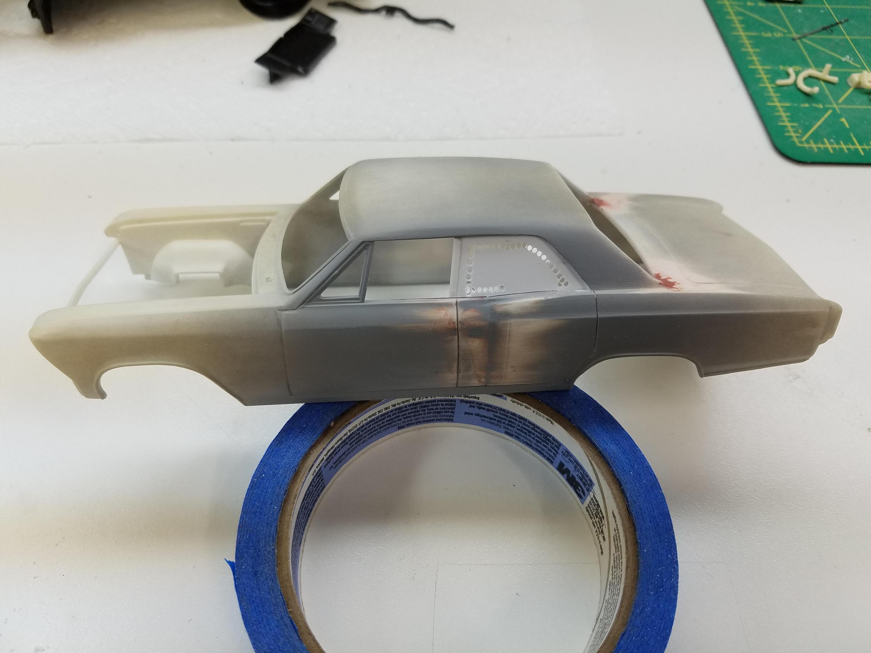

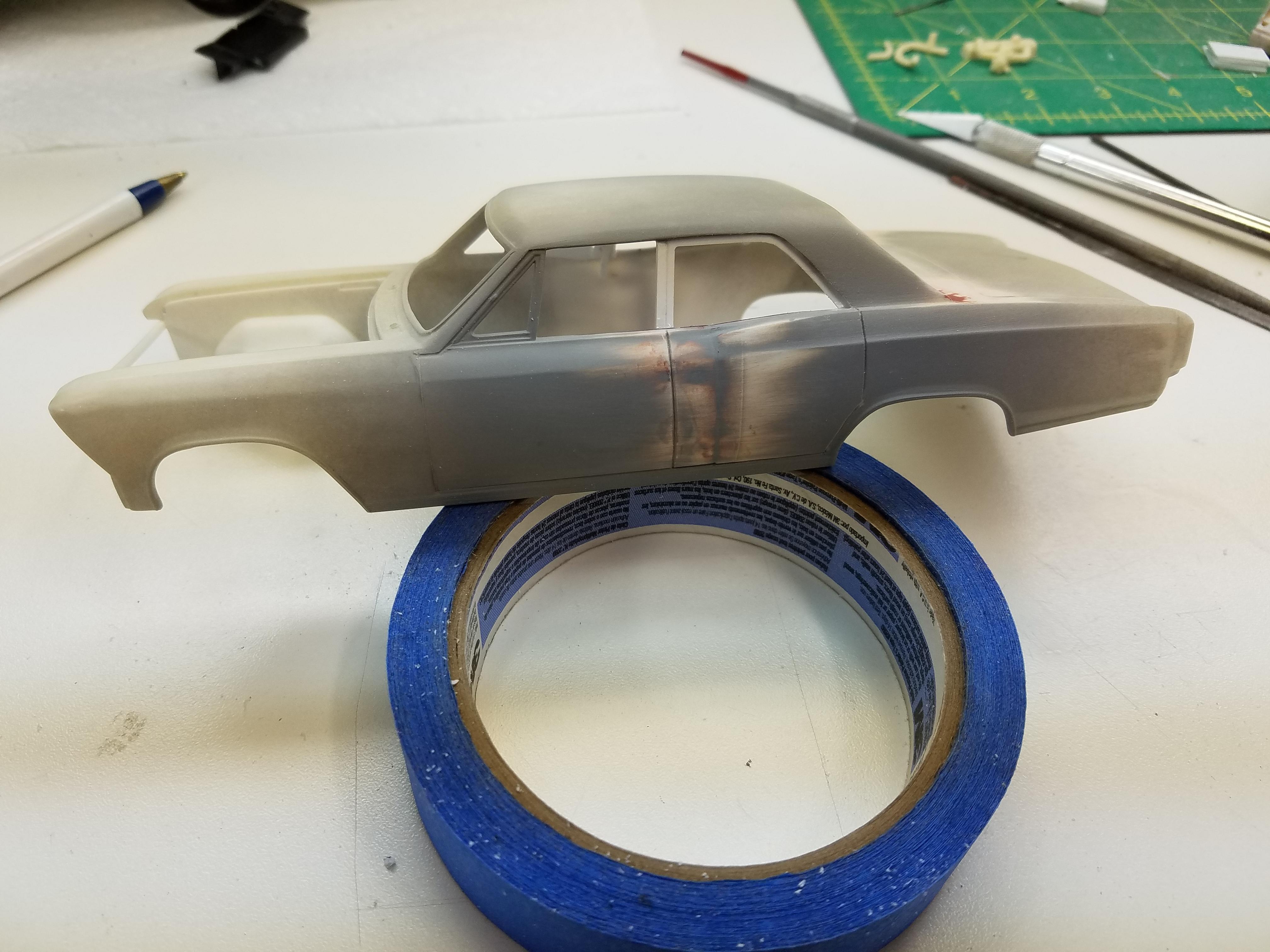

Dave72 Posted December 6, 2020 Author Posted December 6, 2020 Well finally got back to working on this build. I figured out a way to scratch build the window frames. I cut and fitted an piece of styrene over the whole window area. Then cut out the majority of the center and painstakingly filed the frame to the desired thickness. Long process but worth it in my opinion. Got a little work done on that straight six too.
espo Posted December 7, 2020 Posted December 7, 2020 Your upper door frames look perfect. Nice looking engine.
Dave72 Posted December 7, 2020 Author Posted December 7, 2020 8 hours ago, espo said: Your upper door frames look perfect. Nice looking engine. Thank you! A long process but I think it’s worth it. Now to remove the rocker trim and put on the drip rail. Just got the stock stock steel rims and hubcaps from Fireball Resin. Their stuff is fantastic!
