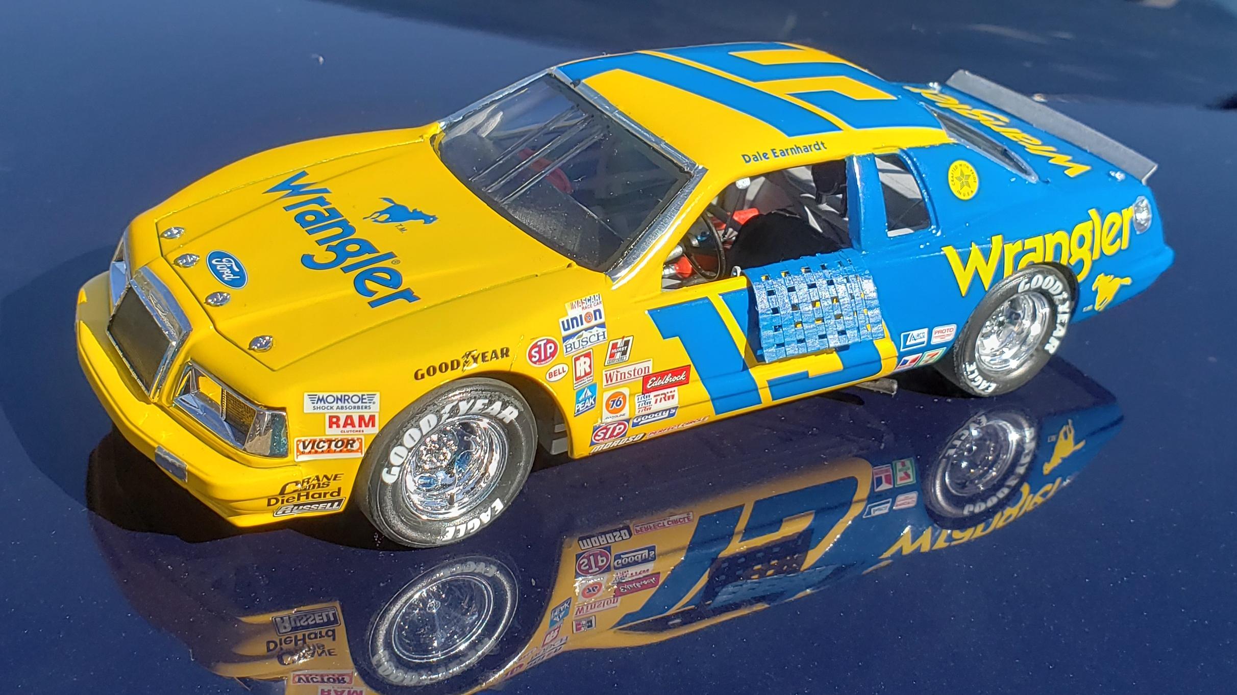

Steamboat Posted February 28, 2020 Posted February 28, 2020 I made one out of strips of masking tape for one of my models. I used pieces of wire to support the top and bottom. You could add seat belt buckles too, although I didn't. I wanted to portray it in the open position and couldn't find anything close.

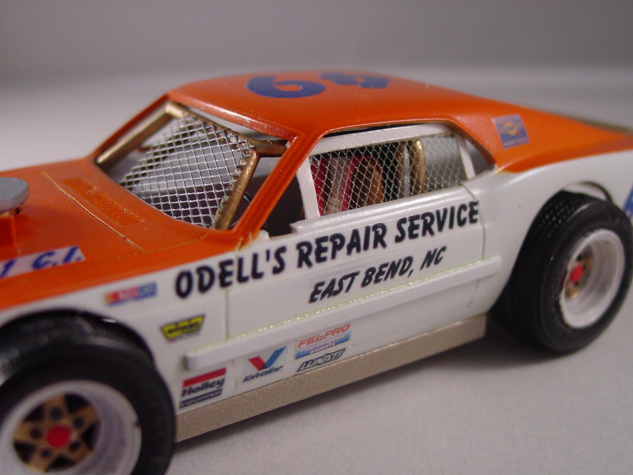

gatorfan69 Posted February 29, 2020 Posted February 29, 2020 This is made from strips of masking tape aslo.
TarheelRick Posted February 29, 2020 Posted February 29, 2020 If you go to the personal hygiene section of WalMart they have nylon mesh bath puffs (for lack of a better description) in multiple colors. They normally sell for around $1. These can be cut to any size you need and by stretching them you are able to make almost any size mesh you desire. The window net on this 1?32 Mustang is an example. I stretched the mesh out and pinned it to a piece of cardboard, used masking tape on both sides to make the edges, which I later cut to the proper size. It can also be painted.
