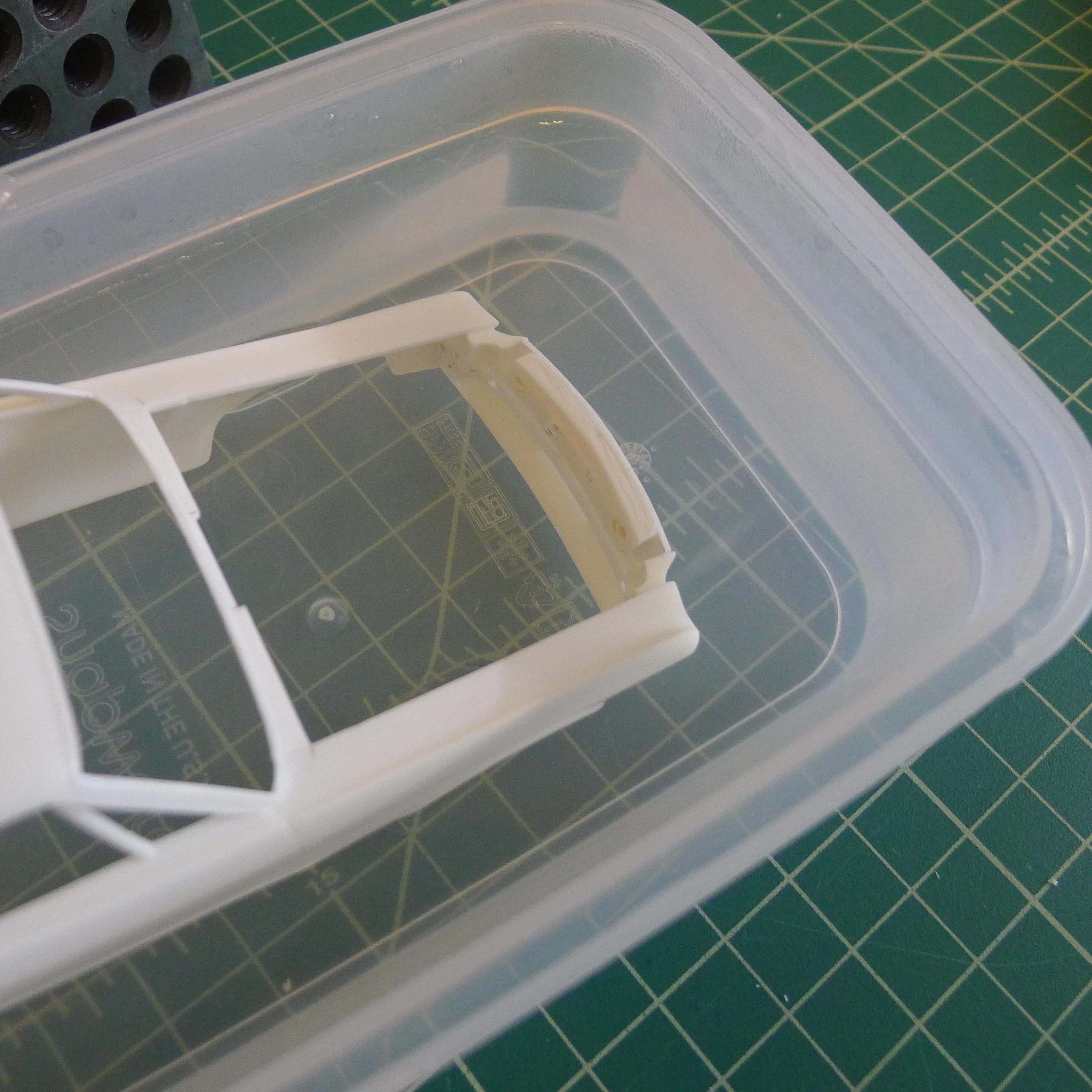

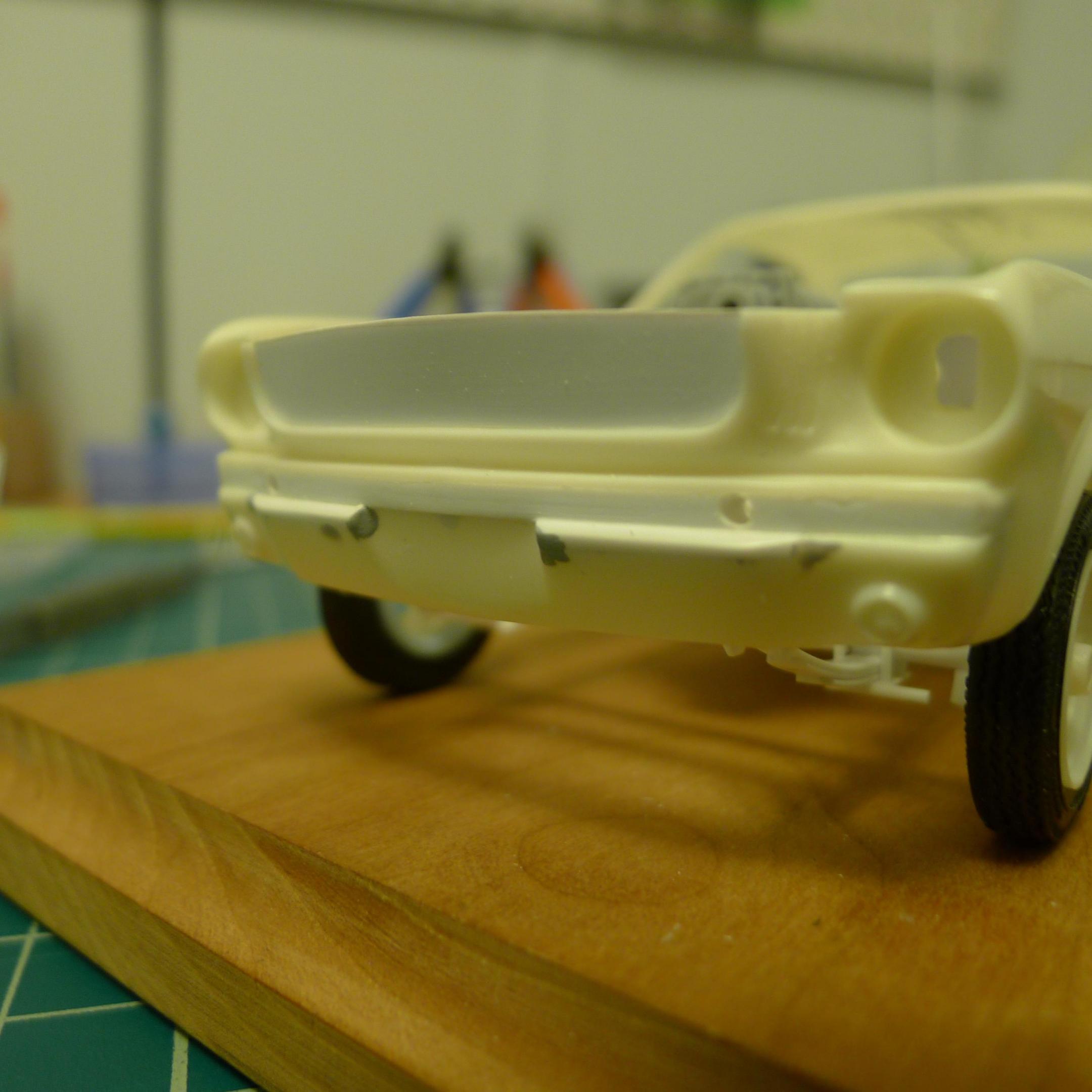

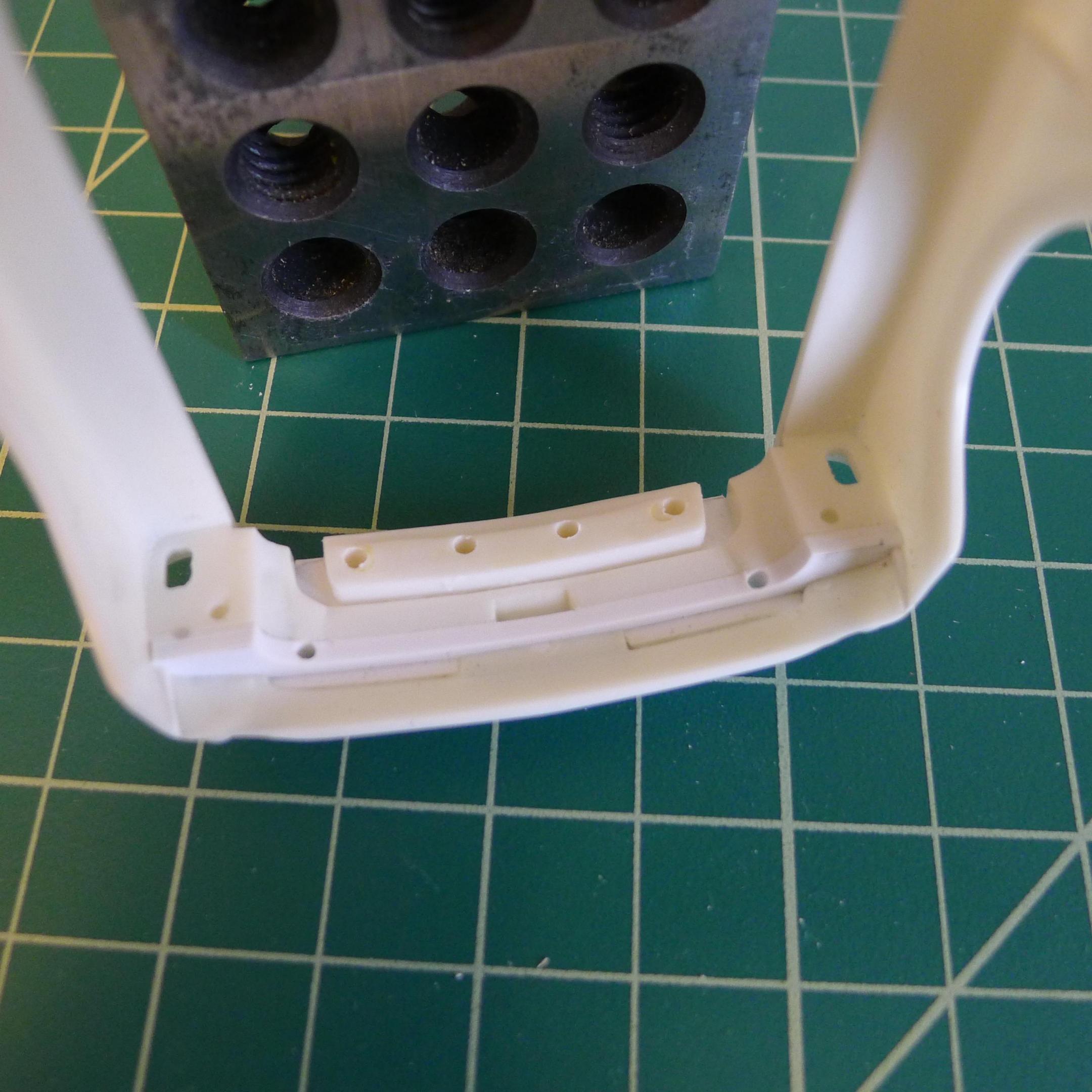

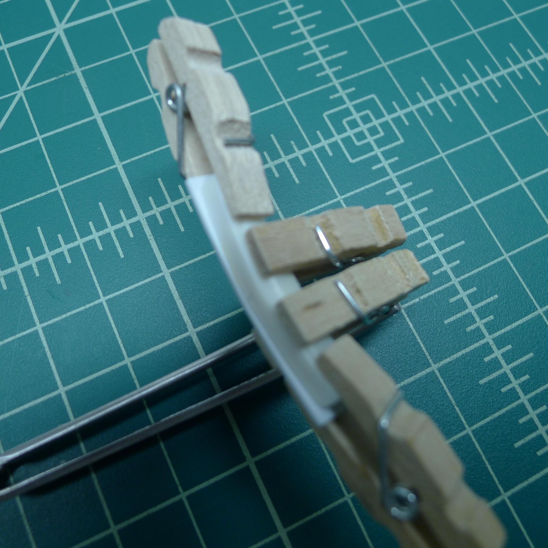

STYRENE-SURFER Posted February 29, 2020 Posted February 29, 2020 (edited) Was trying to get this grill fill in piece to hold its shape while gluing it in. It was giving me such problems/fits that I figured using the kit part as a buck to hold its shape and make it easier to place. I did cut that original kit part down a bit to keep it from being glued in along with the fill. Just the contour was needed. So I used Elmer's to attache that fill piece to the grill part and also covered the backside to halt glue creep. Used small clothespins as clamps to hold the fill and kit grill parts together till the glue dried . Then did some final sanding to fit and glued it into the body as shown. After the glue dried overnight soaked it in warm water to release that part used as the buck. No glue creep, and it worked out well. I'm going to try this out with CA. I use it all the time but not on so much with this kind of thing because it can really make a mess. So basically the idea is a barrier for were you don't want the glue to go and a way to hold parts in place/shape while getting it where you want it. Yah, thats how my brain works. Always experimenting and OCD as ever. ? Edited February 29, 2020 by STYRENE-SURFER Dang iPad

STYRENE-SURFER Posted February 29, 2020 Author Posted February 29, 2020 7 hours ago, afx said: A technique I use is friction fit the part then flow in liquid cement into the seams from the back side using my every trusty Touch-n-Flow applicator. I love this applicator and use it constantly. The piece I was trying to glue in which has a compound curve kept trying to flatten out and this was after some man handling to get it to comply. There was a bit of a friction fit just not enough. That Touch-N-Flow applicator look like the ticket, going to order that kit.
STYRENE-SURFER Posted March 1, 2020 Author Posted March 1, 2020 (edited) I just did a test on a flat piece of styrene. Made two circles of Elmer's glue brushed on leaving a void in the middle. After that dried put a puddle of Tamiya thin in one instant Jet CA in the other. Neither of them creeped past the white glue barrier. And warm water washed the rest away. No pictures because my camera could not pick up the thin layers of glue on a white styrene surface. Take from this what you will, there are situations when I just dont have enough hands and fingers and don't want glue getting everywhere ? Edited March 1, 2020 by STYRENE-SURFER

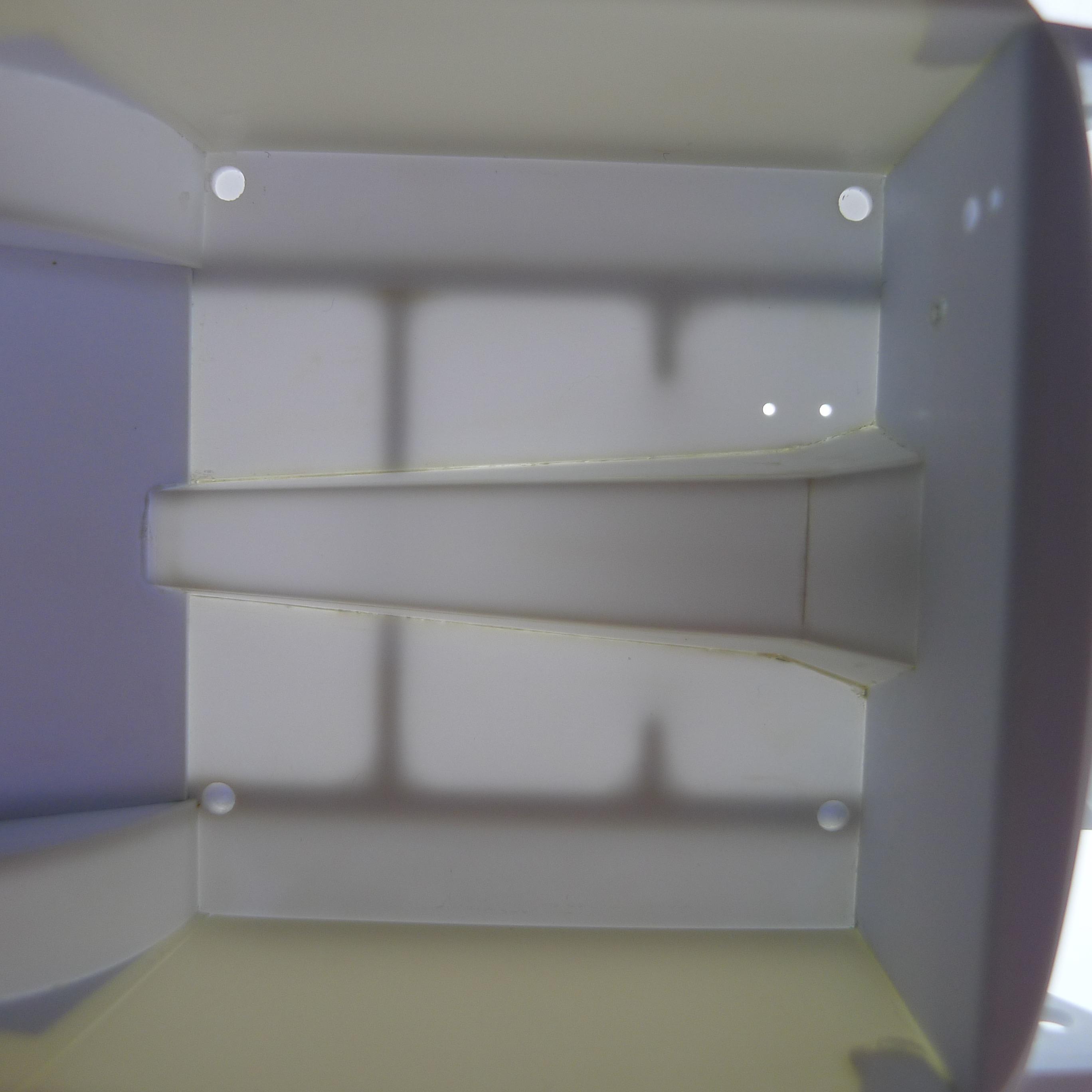

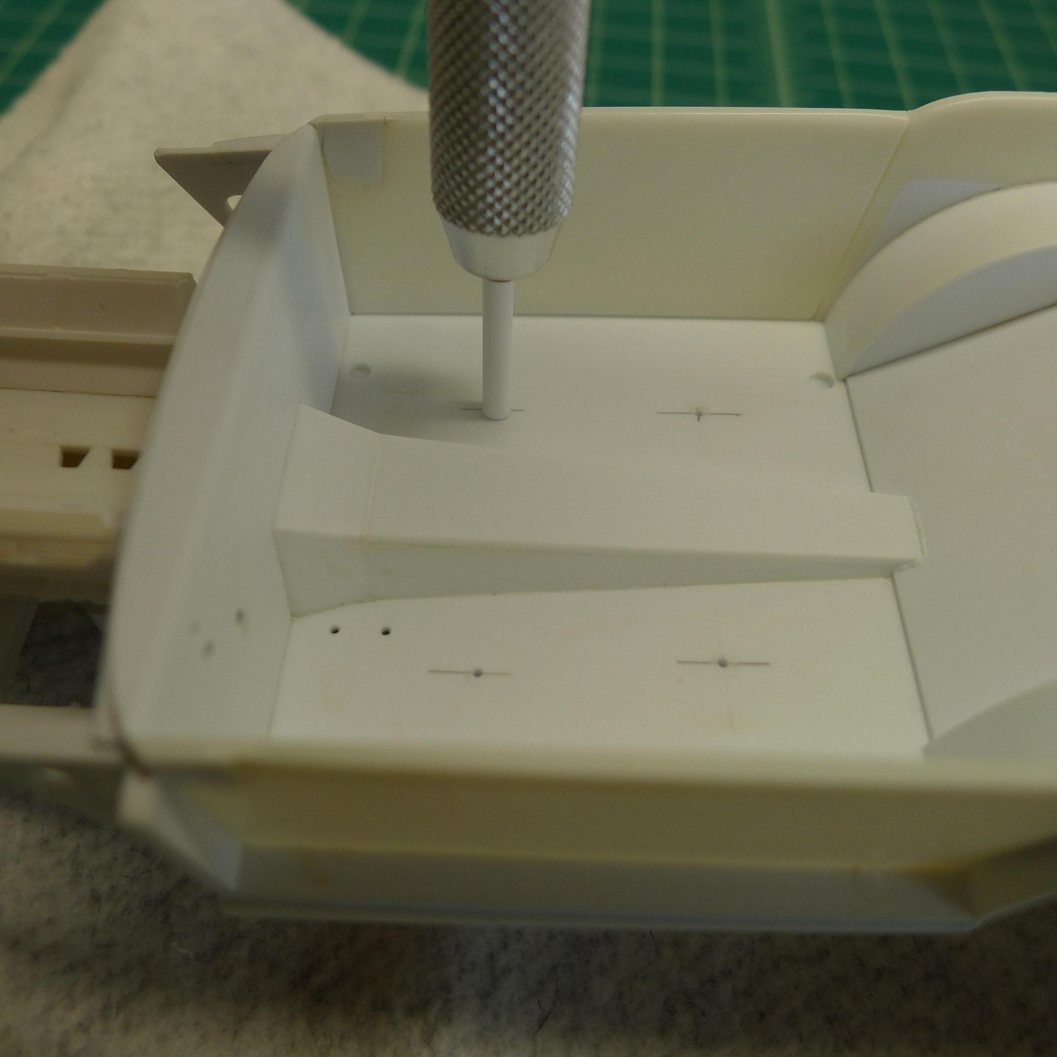

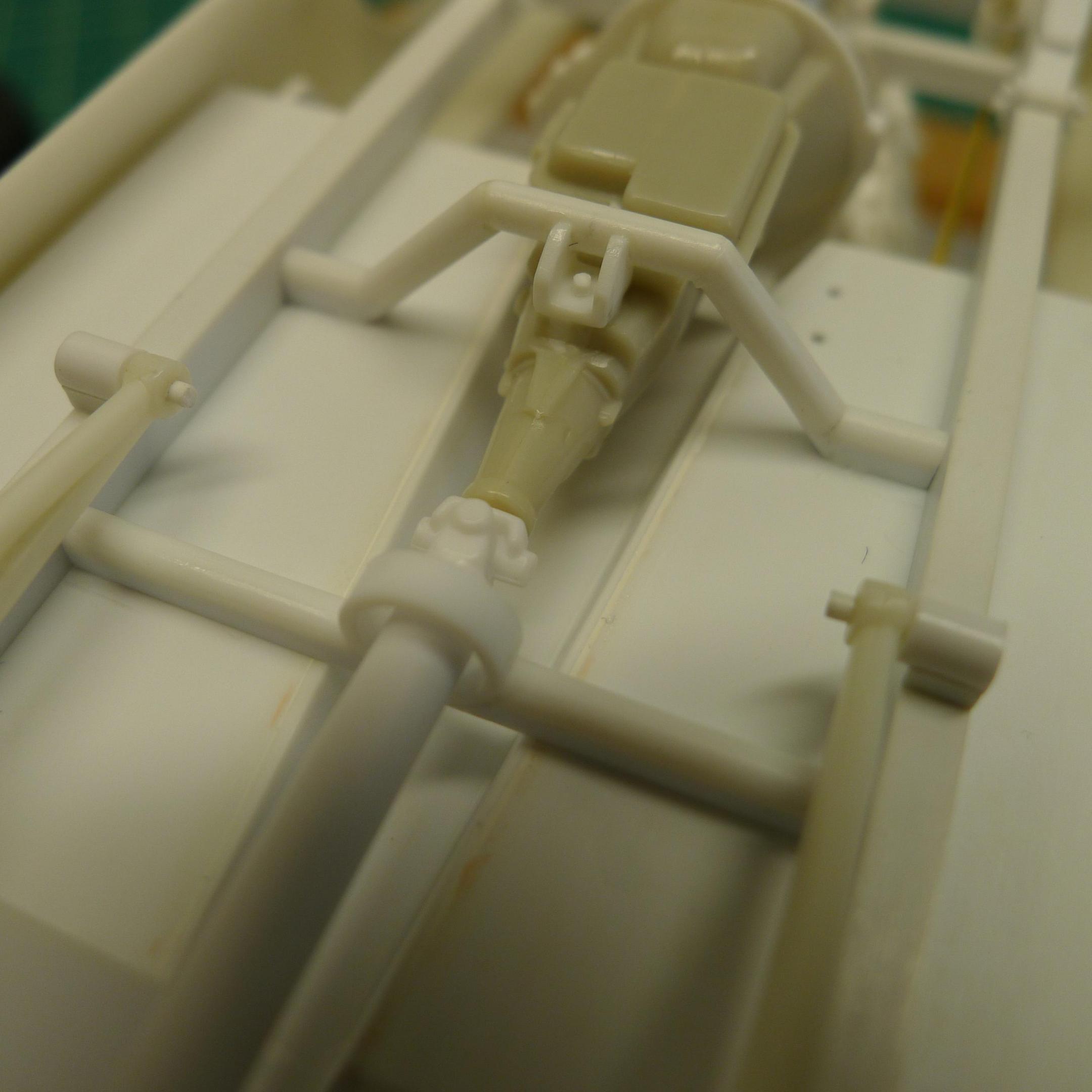

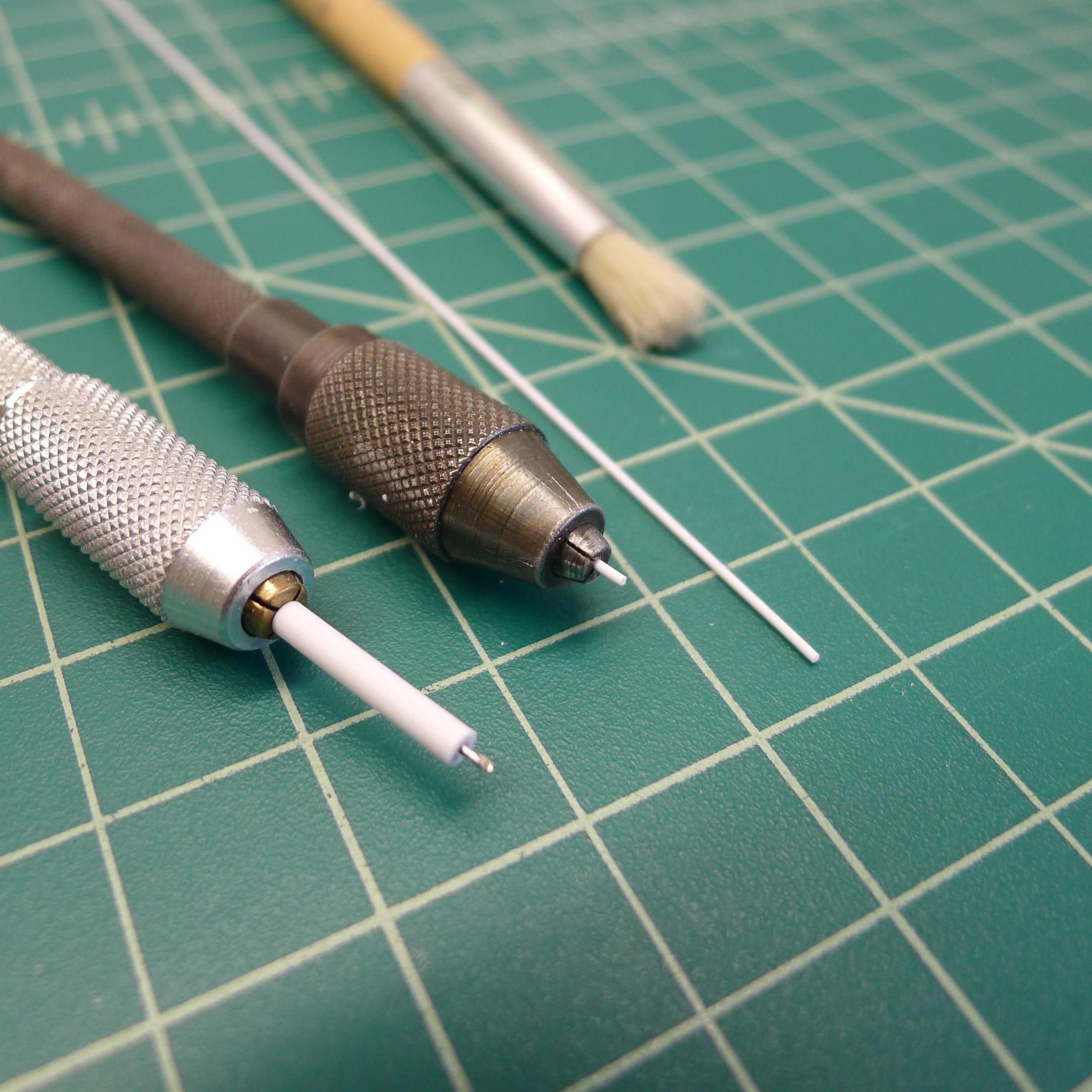

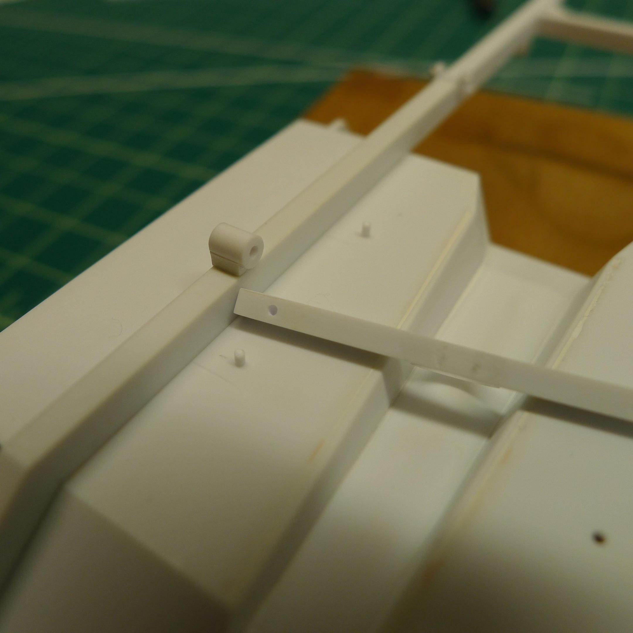

STYRENE-SURFER Posted March 5, 2020 Author Posted March 5, 2020 Here is a situation where I needed to locate/pin some parts, so they can be accurately assembled after paint. The two cross members here I plan on gluing in after they are painted. This to hopefully make masking easier. All parts are temporarily mocked up in this pic. cross members glued in w/Elmer's glue. I used a light source and from the interior side marked exactly where I wanted to drill the holes for the pins. I set up a pin vise for the drill size and a short piece of evergreen tube to be used to set the depth. The other one chucked w/the actual rod I chose to use and also set to the depth for checking my work. (This extra step isn't really that necessary). Then proceeded to drill the holes for the pins through the interior tub and partially into the cross members that are being held on by the Elmer's glue. When I was sure that all the pin placement holes where deep enough I released all the mocked up parts w/water and cleaned things up. This technique can be modified many ways, you can choose the hole placement first then attach the corresponding part temporally to get the drilled hole exactly where you want. Or you can do it like I have here which I could not have done with pre painted parts (using light to show thru to establish pin locations) Keep in mind that it makes things easier to use common sizes on all your pinning because these will need to be most likely reamed out after any paint during final assembly ?
Modelbuilder Mark Posted March 5, 2020 Posted March 5, 2020 Great method. I like to have locating pins, but I like the way you go about it here.
OldNYJim Posted March 5, 2020 Posted March 5, 2020 I really like both of these Elmer’s related tips! I always assumed Elmer’s wouldn’t be strong enough for a job like you demonstrated in the first tip - I guess I was wrong! I’ll be filing that one away for future reference. I like the technique for the pinning too - super clean precise work!

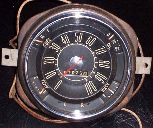

ChrisBcritter Posted March 28, 2020 Posted March 28, 2020 (edited) 3 hours ago, misterNNL said: Ford Speedos then registered from zero on the left to 85 on the right. I remember sitting in the back seat looking as the Speedo indicator arm went past the 85 mark and stood straight down to what (?) maybe 100? Definitely a gear head moment to remember. Here's a '50 Ford speedometer - if that needle was pointing straight down, you guys were hitting 110! (via 2040-parts.com) Edited March 28, 2020 by ChrisBcritter
