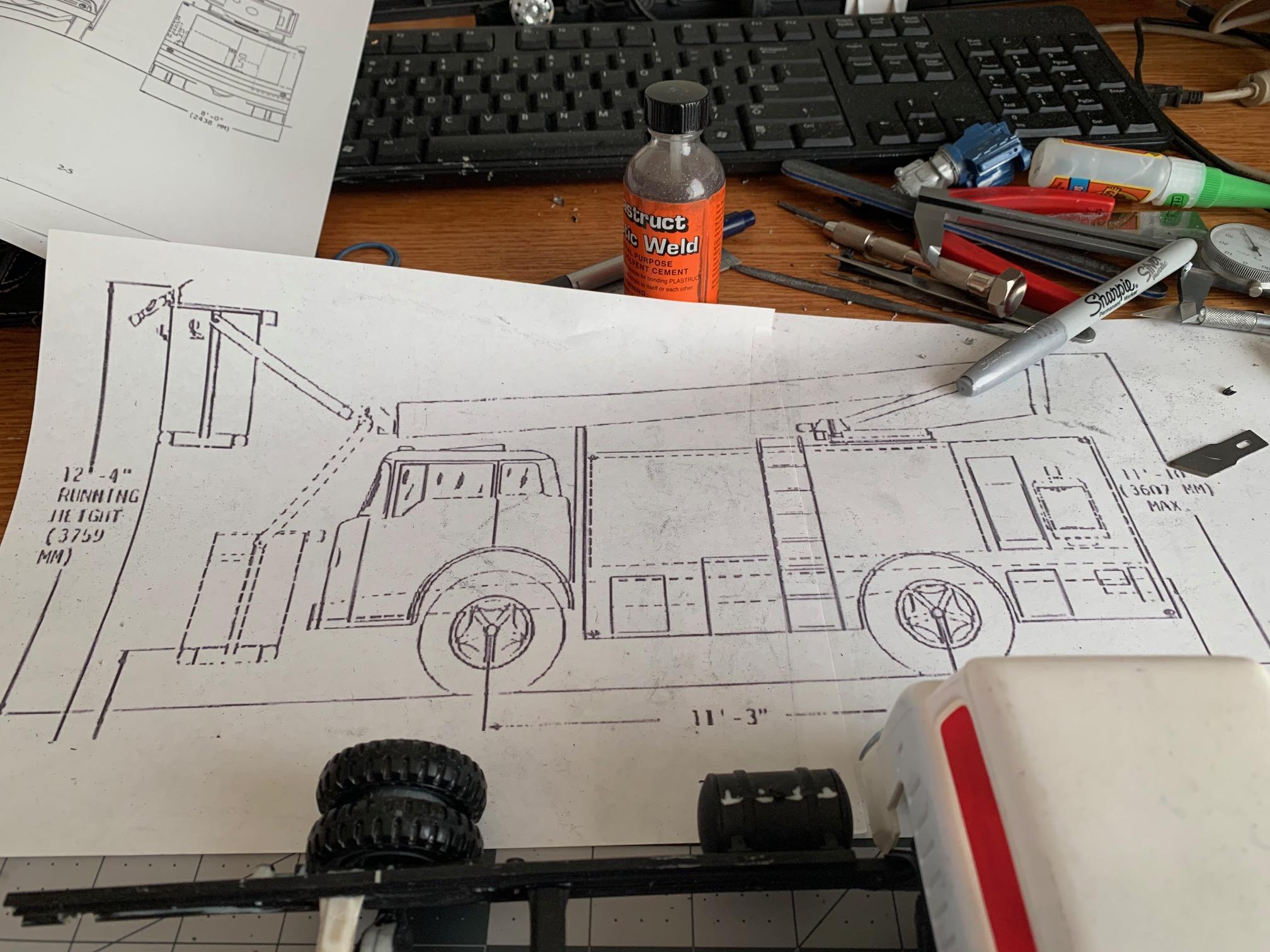

Oldmopars Posted March 7, 2020 Author Posted March 7, 2020 (edited) I needed some different tires than the kit had and different wheels. The kit wheels are 5 spoke and the C800 uses 6 spoke. I purchased several kits from a fellow member here and in the lot of kits was a Italeri/RoG truck that had 6 spoke wheels, he also sent me the nearly correct military lugged tires. I had to slightly modify the wheels as they had holes all the way through for axles. Parts box extras fixed them up right nicely. I also had to change the wheel base to match the FMC trucks. A bit of internet searching landed me an Air Force manual for the truck complete with drawings. I scaled one of them up so I have something to measure from and build off of. At this time I have made a "bench" seat for the cab and started working on the box/tank for the back. I have a huge amount of work left to do, but it is fun to build something that I used to use all the time. BTW the last picture is a Landoll, not an FMC. Almost the same, but slight differences. Edited March 7, 2020 by Oldmopars

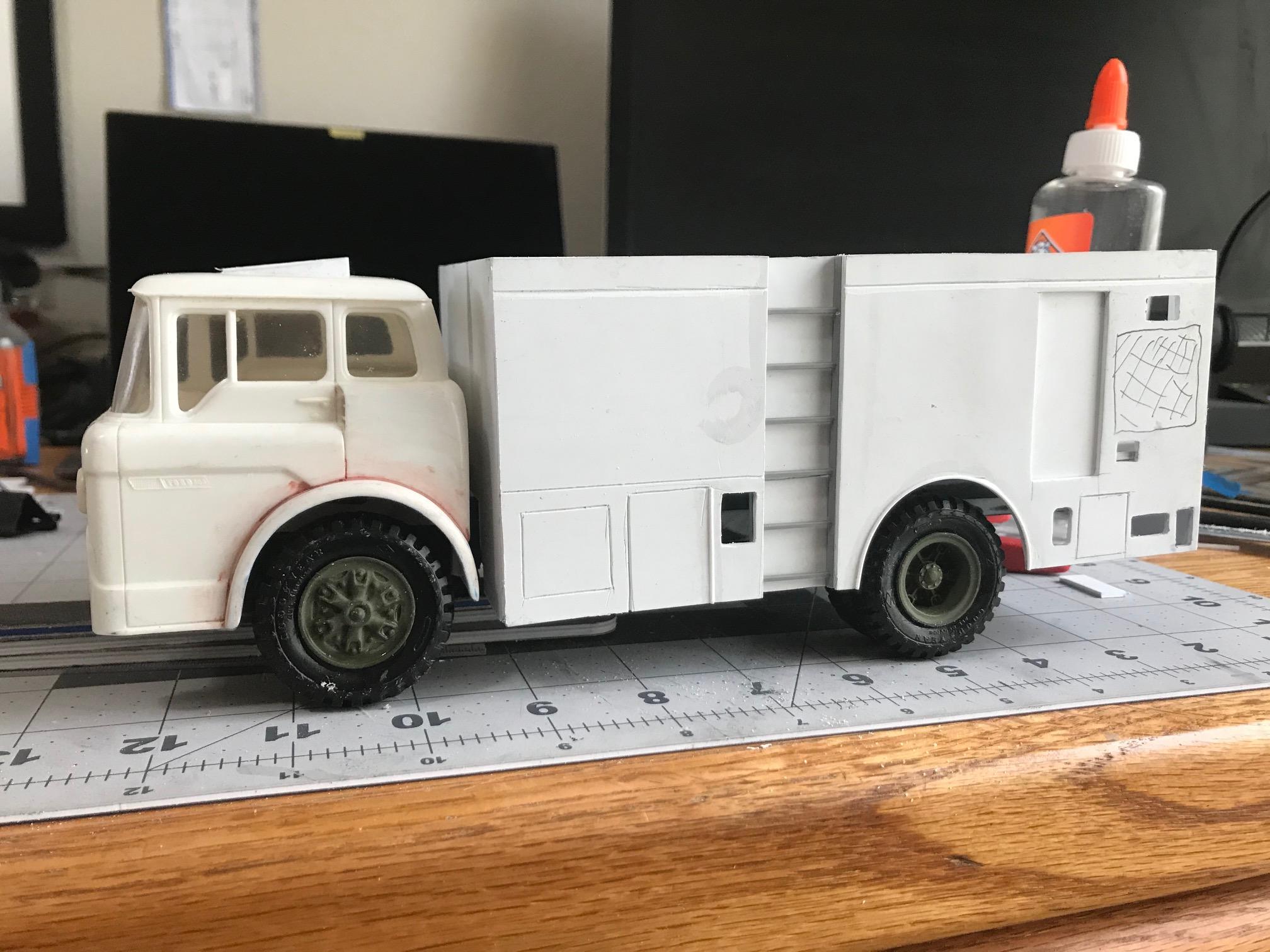

Oldmopars Posted March 9, 2020 Author Posted March 9, 2020 It seems that my pictures are always a little behind what I have actually done. I have more done, but this gives an idea where I am at. I have the "Box" together, however it is still open on the top. I am working on other details that I need to and so the top will remain open for a little while more. This does give you an idea of where I am going with it. I have made some adjustments to level out the truck. I may still lift the front some. I have added some vents and made a hose reel, but those will be in the next pictures.

TarheelRick Posted March 11, 2020 Posted March 11, 2020 Retired in '89 and saw a few of these in Korea, Ohio, Oklahoma, and even North Carolina. Didn't pay a lot of attention to them, my job was inside the aircraft, working avionics. Really like where you are going with this one. Going to be fun to watch you doing the scratchbuilding. One thing I noticed in the pictures is a lack of stabilizers. I sort of thought those were required on any highlift vehicle. I know when I had to repair the HF antennas on C-130's and B-52's, those had to be extended and in place or QC or Safety would ream us a new one. Looking forward to your progress.
Oldmopars Posted March 12, 2020 Author Posted March 12, 2020 10 hours ago, TarheelRick said: Retired in '89 and saw a few of these in Korea, Ohio, Oklahoma, and even North Carolina. Didn't pay a lot of attention to them, my job was inside the aircraft, working avionics. Really like where you are going with this one. Going to be fun to watch you doing the scratchbuilding. One thing I noticed in the pictures is a lack of stabilizers. I sort of thought those were required on any highlift vehicle. I know when I had to repair the HF antennas on C-130's and B-52's, those had to be extended and in place or QC or Safety would ream us a new one. Looking forward to your progress. Funny thing is, they do have stabilizers, but they are "Spring Locks". The was a switch on the control panel that caused these locks to come down on the springs and lock them in place. So, even when they are deployed you can't see them. I may try to replicate them on this build.
TarheelRick Posted March 12, 2020 Posted March 12, 2020 (edited) That sounds logical. But if I am in that bucket and going to be spraying the T-Tail on a C-141 I would want extended stabilizers. You are doing an excellent job with this build; looking forward to updates. Edited March 12, 2020 by TarheelRick
