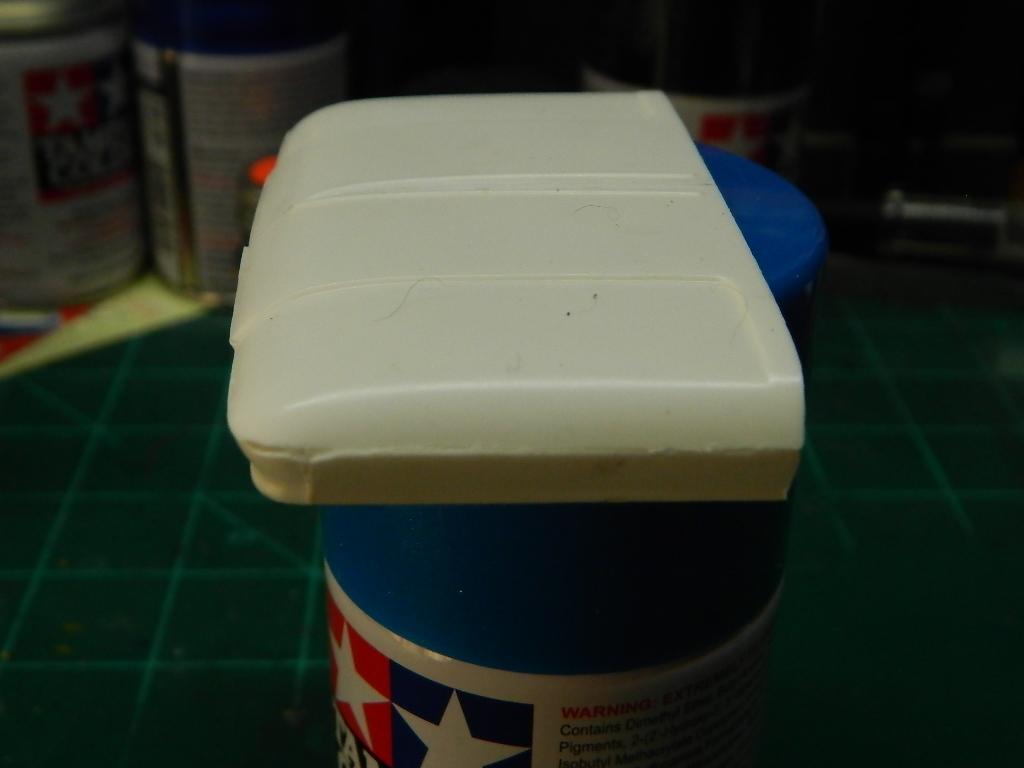

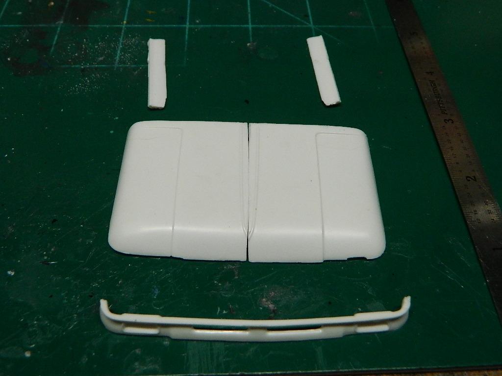

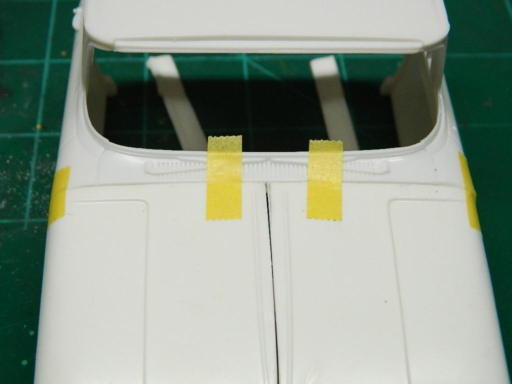

mrmike Posted March 19, 2020 Author Posted March 19, 2020 (edited) I took the first step to making the Revell hood fit the AMT body by sawing it in half and sanding the cut with a sanding wand. Looks pretty good! Now to shorten the hood front. More '60 Fleetside to come... Edited March 19, 2020 by mrmike

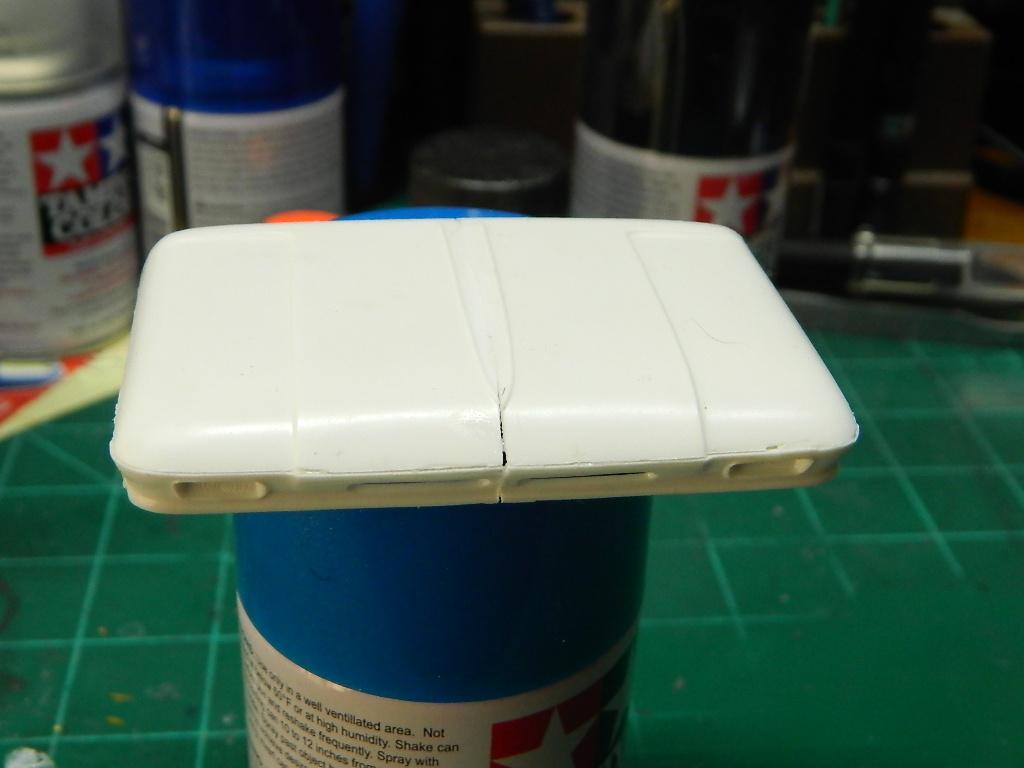

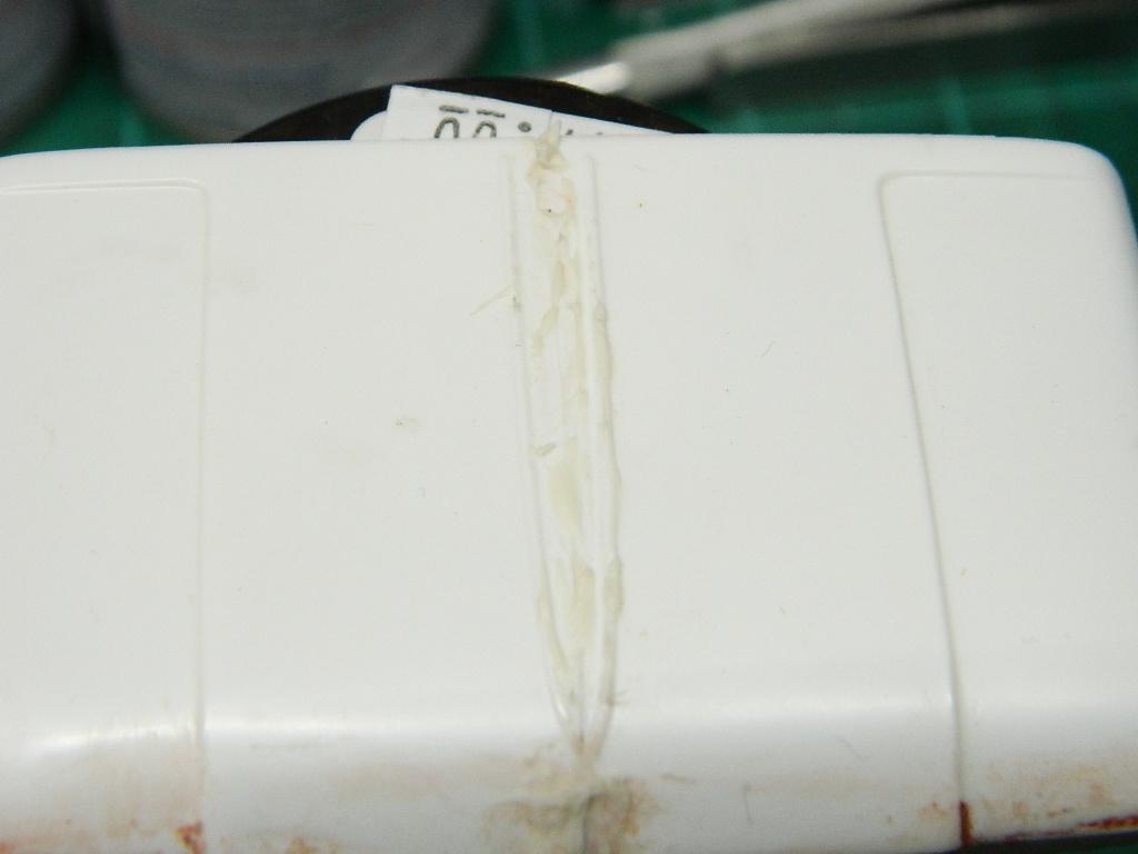

mrmike Posted March 22, 2020 Author Posted March 22, 2020 I glued the hood back together and now to start adding filler and a lot of sanding. If I can't get this hood looking good, I'll use the '60 Chevy hood instead. More '60 Fleetside to come...

mrmike Posted March 26, 2020 Author Posted March 26, 2020 After an initial coating of Bondo and some sanding, I applied a coating of Mr. Dissolved Putty and sanded that. Now, to spritz some primer on the hood and see just how much more sanding and putty I will need. More '60 Chevy to come...

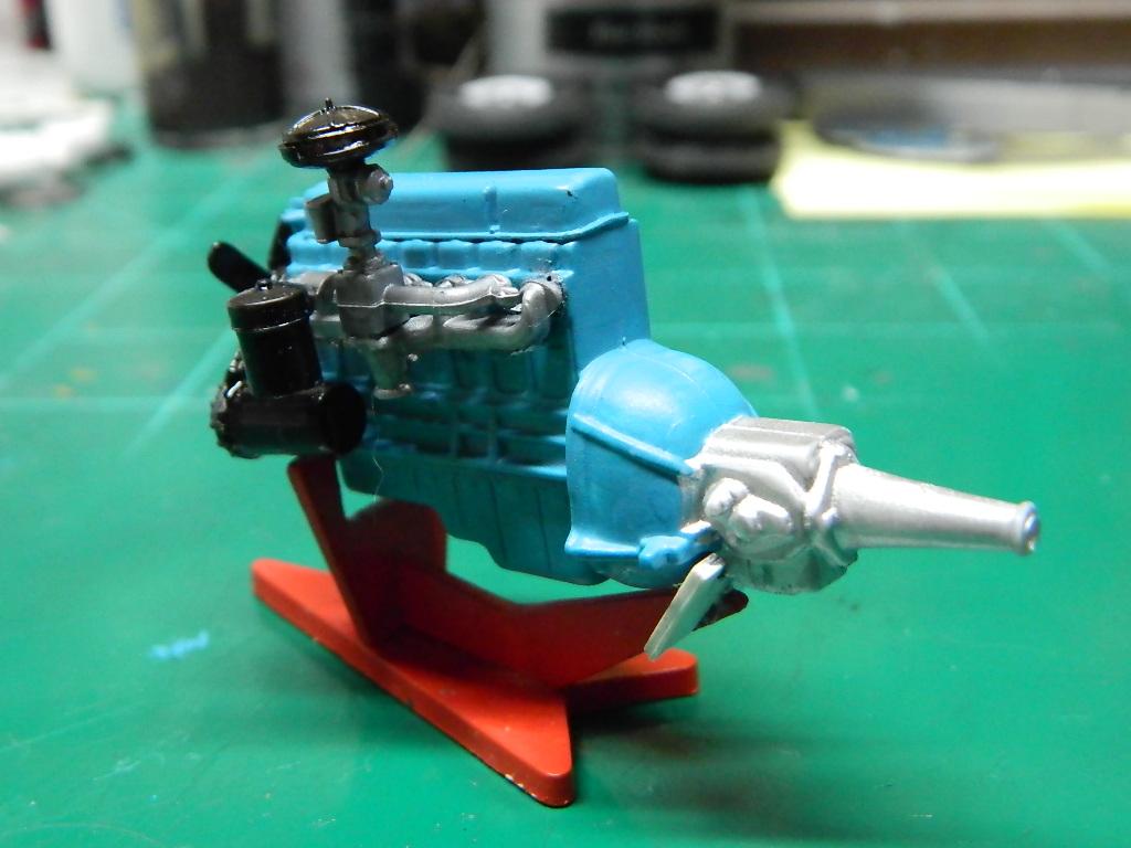

mrmike Posted April 5, 2020 Author Posted April 5, 2020 I started work on the 6 cylinder engine that is in this kit. I drilled out the heads and distributor for plug wires.
mrmike Posted May 11, 2020 Author Posted May 11, 2020 Some work done on the Home Town Chevy pickup. I got the Revell wheels and tires assembled, the engine painted with Polly Scale St. Lawrence Blue and the distributor painted and wired. More Fleetside to come...
mrmike Posted May 12, 2020 Author Posted May 12, 2020 Thanks Al! I finished the Chevy engine tonight. All wired and ready to go! I assembled the chassis and will paint the entire unit as one in semi gloss black and then pick out the details as needed. More Fleetside to come...

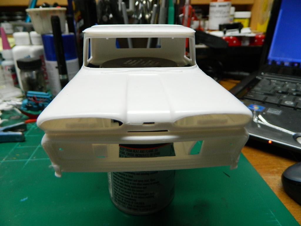

mrmike Posted May 12, 2020 Author Posted May 12, 2020 I have been playing around with the '65 Chevy hood and I am really starting to hate it. I doesn't matter how much I sand from whatever side, it just doesn't want to fit. The right side character line is just too high. I assembled the '60 Chevy hood and, of course, it fits a whole lot better. Nice and flush and character lines all line up. I think I am going with the '60 Chevy hood instead. More Fleetside to come...

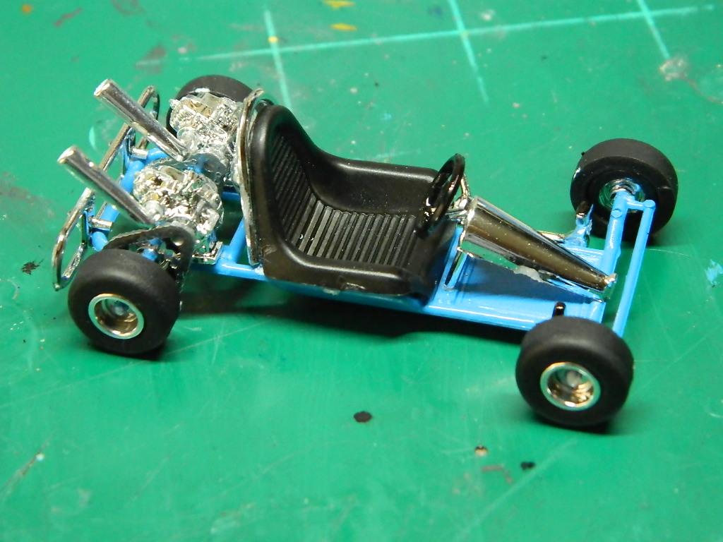

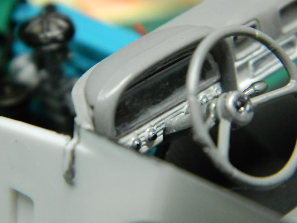

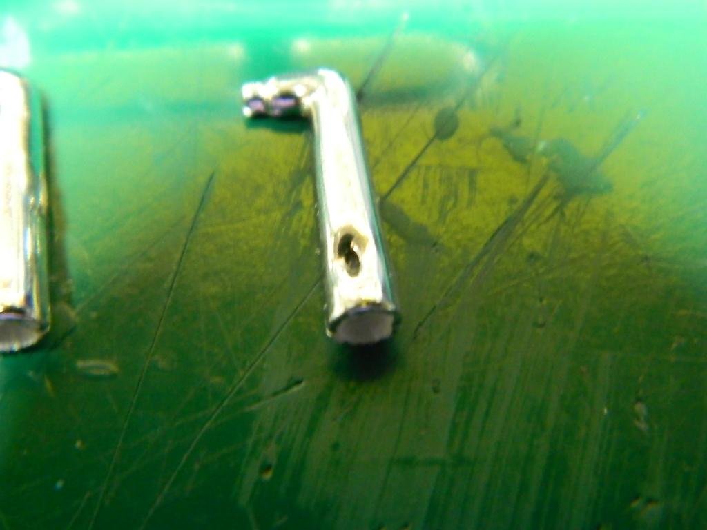

mrmike Posted May 17, 2020 Author Posted May 17, 2020 I got the interior completed and the chassis is nearly done. I made a clear lens for the dash gauges. The go-cart is nearly done, but I noticed a sink mark in the top of the right exhaust pipe. More Fleetside to come...
slusher Posted May 17, 2020 Posted May 17, 2020 Truck is coming along nicely. That’s just a real bad place for a sink Mark or flaw on a Crome tail pipe..
mrmike Posted May 18, 2020 Author Posted May 18, 2020 Thanks Carl! The sink mark is prevelent on several builds that I have seen. I haven't decided on how to repair that sink mark.

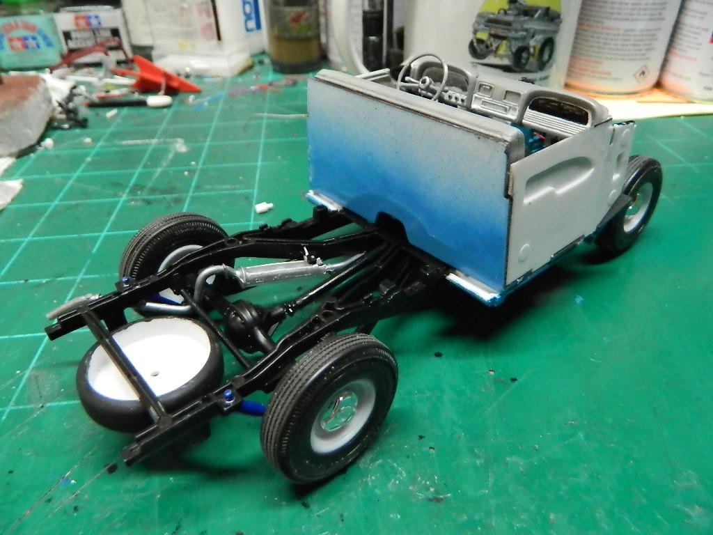

mrmike Posted May 19, 2020 Author Posted May 19, 2020 I have finished the chassis and the interior of the '60 Fleetside pickup by adding the wheels and tires. The go-cart has been receiving some touchups. More Fleetside to come...
