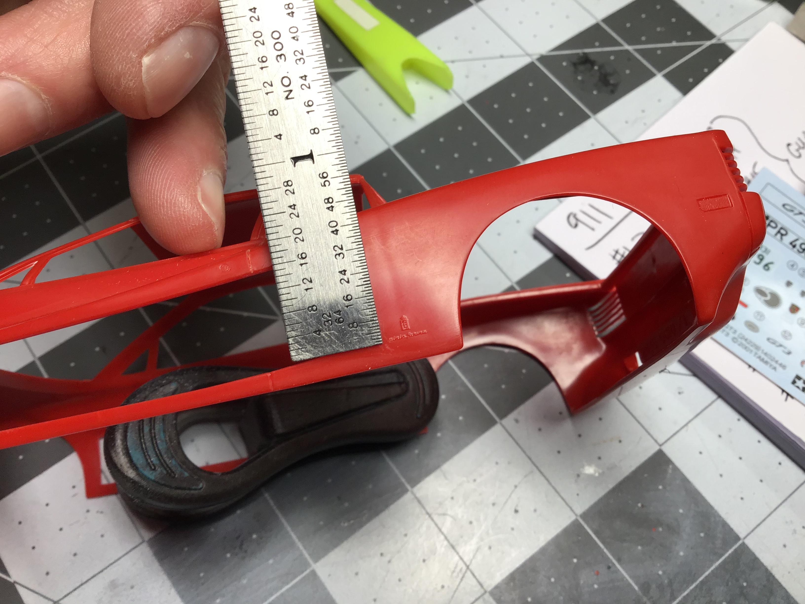

NOBLNG Posted March 21, 2020 Posted March 21, 2020 Rather than start a new thread, I will ask it here since it is foil related...maybe. Is it even possible to foil something this tiny? I am considering just polishing this model. Any other options than foil?
Snake45 Posted March 21, 2020 Posted March 21, 2020 44 minutes ago, NOBLNG said: Rather than start a new thread, I will ask it here since it is foil related...maybe. Is it even possible to foil something this tiny? I am considering just polishing this model. Any other options than foil? The emblem could easily be foiled. The lettering underneath, I'd dry-brush with silver paint.
Plowboy Posted March 22, 2020 Posted March 22, 2020 2 hours ago, NOBLNG said: Rather than start a new thread, I will ask it here since it is foil related...maybe. Is it even possible to foil something this tiny? I am considering just polishing this model. Any other options than foil? I would mask those off until the final coat of primer. Prime, foil and paint. Then use 2000 grit to sand the script and emblem to reveal them.
StevenGuthmiller Posted March 22, 2020 Posted March 22, 2020 53 minutes ago, Plowboy said: I would mask those off until the final coat of primer. Prime, foil and paint. Then use 2000 grit to sand the script and emblem to reveal them. I would use a similar technique without the masking or the sand paper. I foil prior to the final color coat and then clean the script off with thinner prior to clear coating. Of course a lot of this is dependent upon your painting process, but I can foil some extremely faint scripts using this method. And believe it or not, a coat of primer over that bare plastic in the photo will make that script appear much more pronounced. Steve
Snake45 Posted March 22, 2020 Posted March 22, 2020 1 hour ago, Plowboy said: I would mask those off until the final coat of primer. Prime, foil and paint. Then use 2000 grit to sand the script and emblem to reveal them. 6 minutes ago, StevenGuthmiller said: I would use a similar technique without the masking or the sand paper. I foil prior to the final color coat and then clean the script off with thinner prior to clear coating. Of course a lot of this is dependent upon your painting process, but I can foil some extremely faint scripts using this method. And believe it or not, a coat of primer over that bare plastic in the photo will make that script appear much more pronounced. Am I the only one who actually read the post? He said he was thinking of "just polishing" it, which I took it to mean that he wants to polish the plastic--no paint. Of course, I could be wrong. In which case...Never Mind.

NOBLNG Posted March 22, 2020 Posted March 22, 2020 (edited) 2 hours ago, Snake45 said: Am I the only one who actually read the post? He said he was thinking of "just polishing" it, which I took it to mean that he wants to polish the plastic--no paint. Of course, I could be wrong. In which case...Never Mind. The reason I don't want to paint is because of the extremely faint script. I am quite certain I would obliterate it, knowing how I paint! I have never "just polished" a model and thought this may be a candidate. I think the dry brushing is the best solution as this script is far to fine for my fat fingers and failing eyes to trim around! Sorry Bart...I should have started my own thread. Edited March 22, 2020 by NOBLNG
StevenGuthmiller Posted March 22, 2020 Posted March 22, 2020 2 hours ago, Snake45 said: Am I the only one who actually read the post? He said he was thinking of "just polishing" it, which I took it to mean that he wants to polish the plastic--no paint. Of course, I could be wrong. In which case...Never Mind. I'll be the first to admit that I don't always read every word of a post. Guess this was one of those times that I just skimmed over the high spots. That said, I have to believe that someone probably makes a PE set for this car? Steve
Snake45 Posted March 22, 2020 Posted March 22, 2020 9 hours ago, StevenGuthmiller said: That said, I have to believe that someone probably makes a PE set for this car? That nameplate cries out for either PE or a decal.
