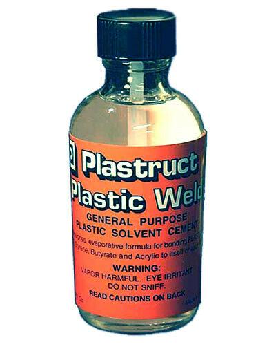

935k3 Posted March 25, 2020 Posted March 25, 2020 This is Plastruct for ABS, look for the orange label
Ace-Garageguy Posted March 26, 2020 Posted March 26, 2020 9 hours ago, 935k3 said: This is Plastruct for ABS, look for the orange label Hmmmmm...why do you suppose Plastruct specifically labels the white-label Bondene for ABS then? <<<<<<<<<<<<<<<<<<<<

Ace-Garageguy Posted March 26, 2020 Posted March 26, 2020 4 minutes ago, peteski said: ...And even some of the harder to work with ones will be easily bonded using methylene chloride based cements, like the one SfanGoch mentioned earlier ( Sci-Grip 4/Weld-On 3 ). Which is the active chemical in Bondene, and is labeled as such. The orange-label Plastruct cement is MEK, methyl ethyl ketone, and may or may not bond engineering-grade ABS. The op's reference to the part in question mentions it being the cover for the door of a microwave.
