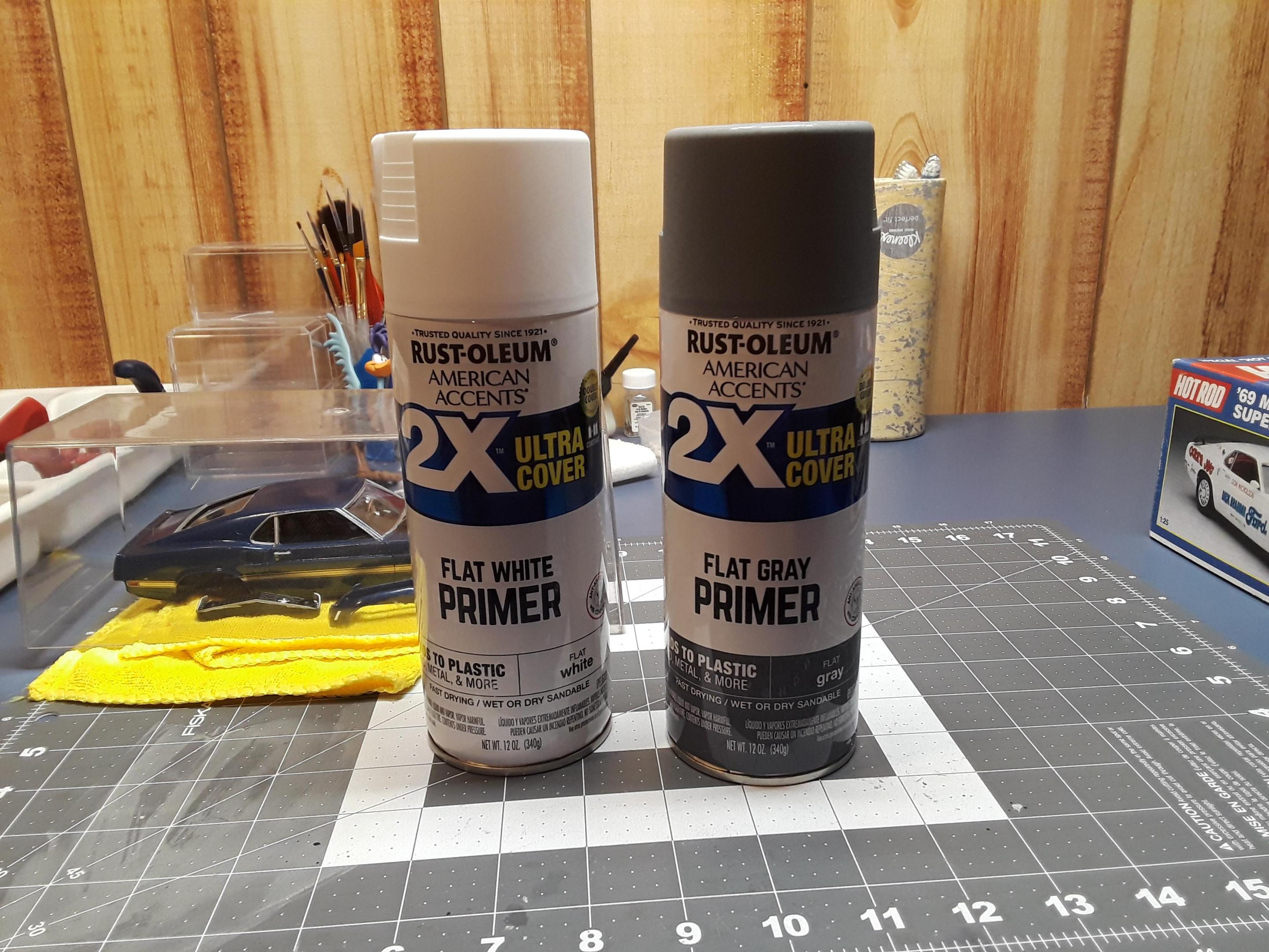

Hotrod 97 Posted March 25, 2020 Posted March 25, 2020 I've been using Rustoleum American Accents primer. The can says that it bonds to plastic. I use it under Rustoleum sprays and Testors sprays without any apparent problems.
