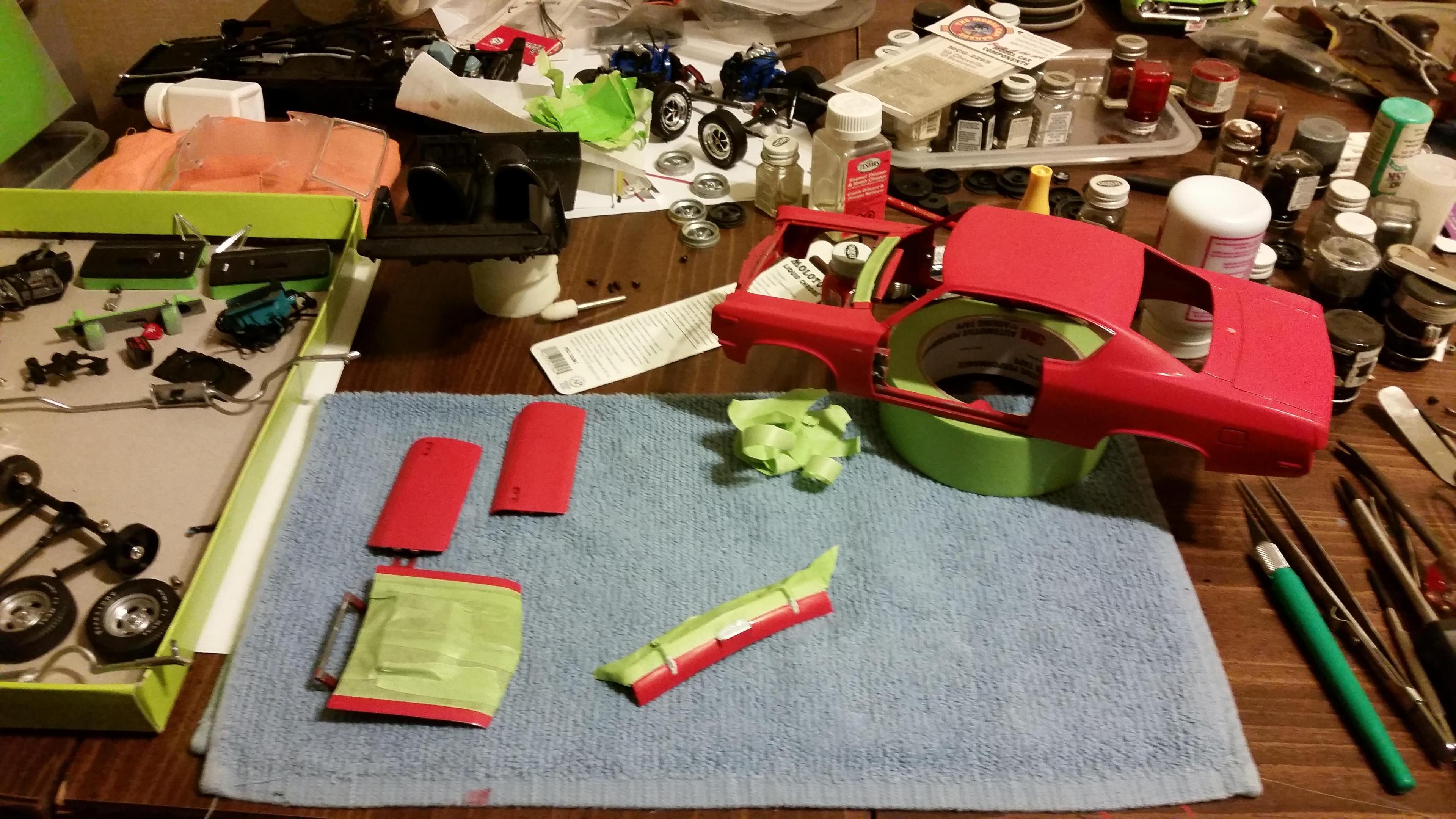

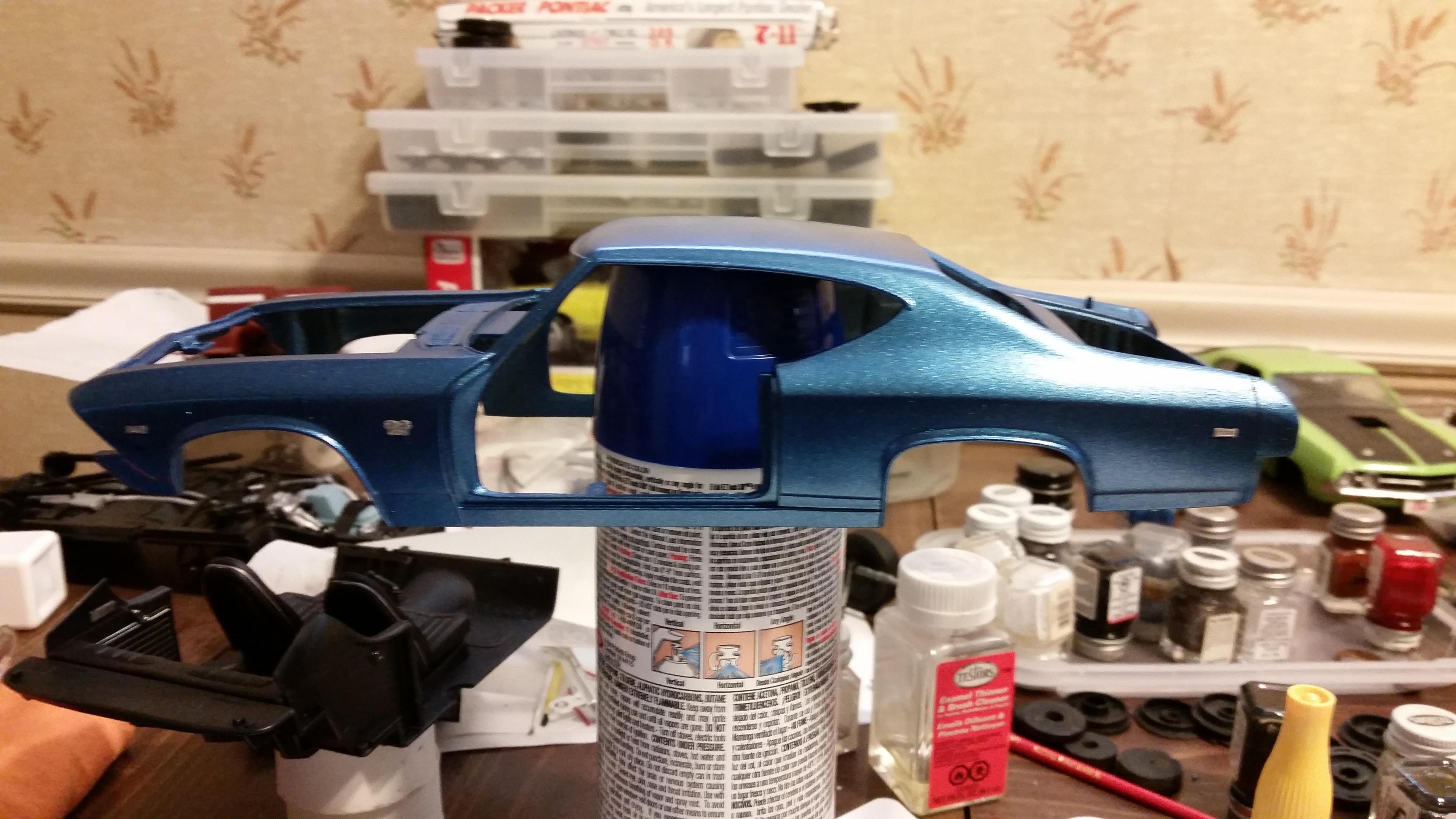

kilrathy10 Posted March 28, 2020 Posted March 28, 2020 (edited) Well, I've tried a few things.... Depending on how far you want to go, you could strip the paint with a nice brake fluid bath, but you could probably use thinner or something, as it is metal.... But I've also had success with just going old school and breaking out the old paint brush and model paint like I did in high school...?Just depends on the quality of paint and your steady hand... I've painted quite a few models this way... I just hand painted this orange Nissan GTR with a hand brushed coat of Future floor polish.. It was just like the one on the left... And I hand painted the red truck and sprayed the orange one...The red one has a coat of Future floor polish on it, as well, filling in all the brush strokes...No masking necessary.... I think they came out pretty good.... Spraying always delivers a superior finish, but brush painting, to me is a bit of a lost art.... Edited March 28, 2020 by kilrathy10

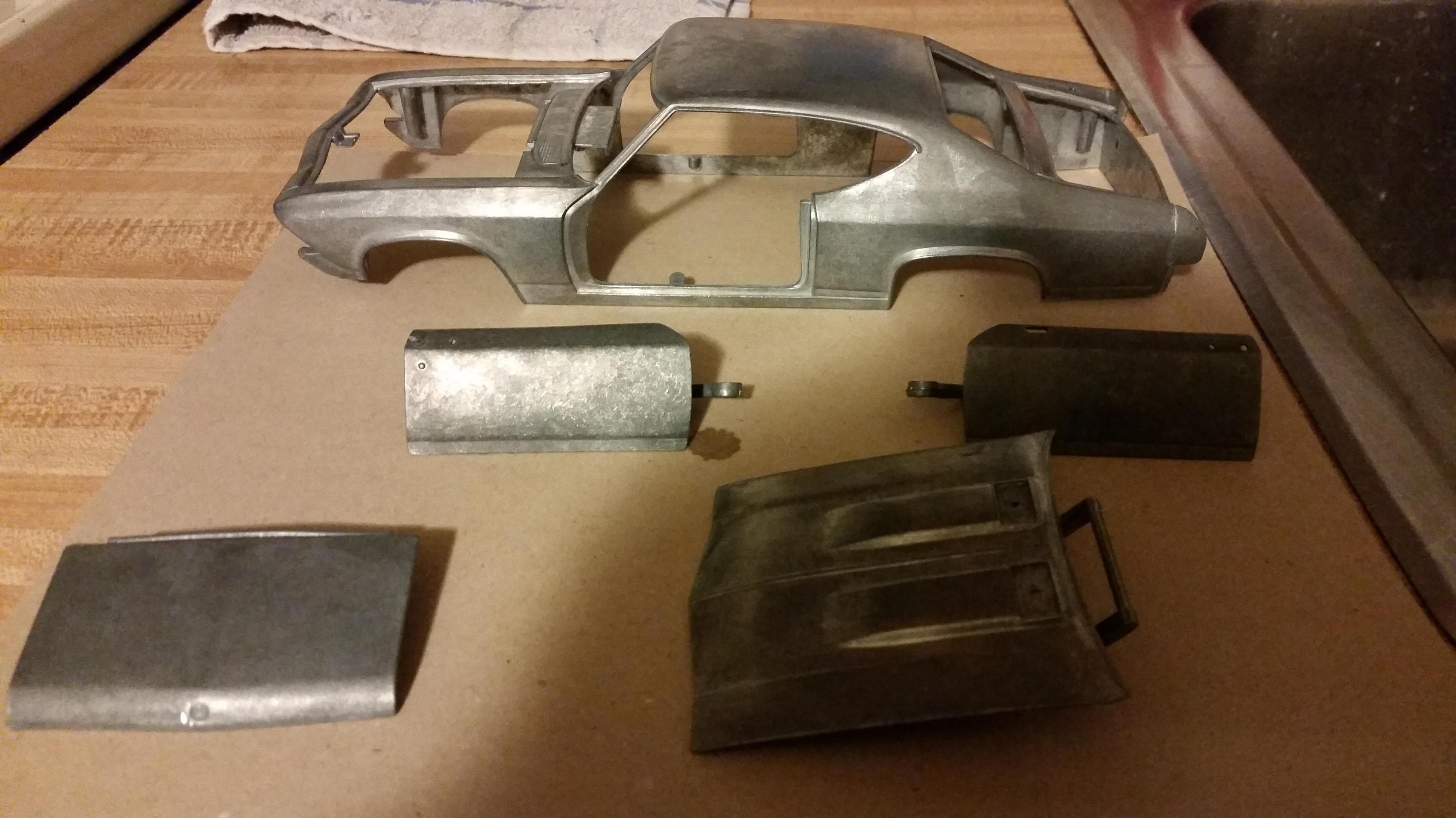

Pete J. Posted March 28, 2020 Posted March 28, 2020 That is a whole differant ball game than plastic. Some of it good others not so much. Most of the detail pieces I have seen have pins that are melted on the back side. Carefully cut to remove. Not to hard. However the stuff like window trim is an entirely differant kettle of fish. I generally just replace it all with scratch built plastic pieces. As to the paint, I found that most diecast have really thick paint and if you paint over them, you lose a ton of detail. I think most of manufactures dip the models rather than spray them. Once you have taken everything off of the body you can dump it in a tub of acetone or lacquer thinner that will strip it down pretty quickly, but be prepared to do some file work. The reason the paint is so thick on diecast is that it hides the imperfections and pits in the cast metal. A good fine file and some sandpaper will do the job of clean the metal and then a quality body filler will deal with a lot of the other issues. Then a good coat of Tamiya gray etching primer and you are ready to do the final paint. Here is a photo of fender of an MGBGT that I did some time back. You can see how rough the metal is finished and why the manufactures put such thick paint on. Best of luck with your project. 1

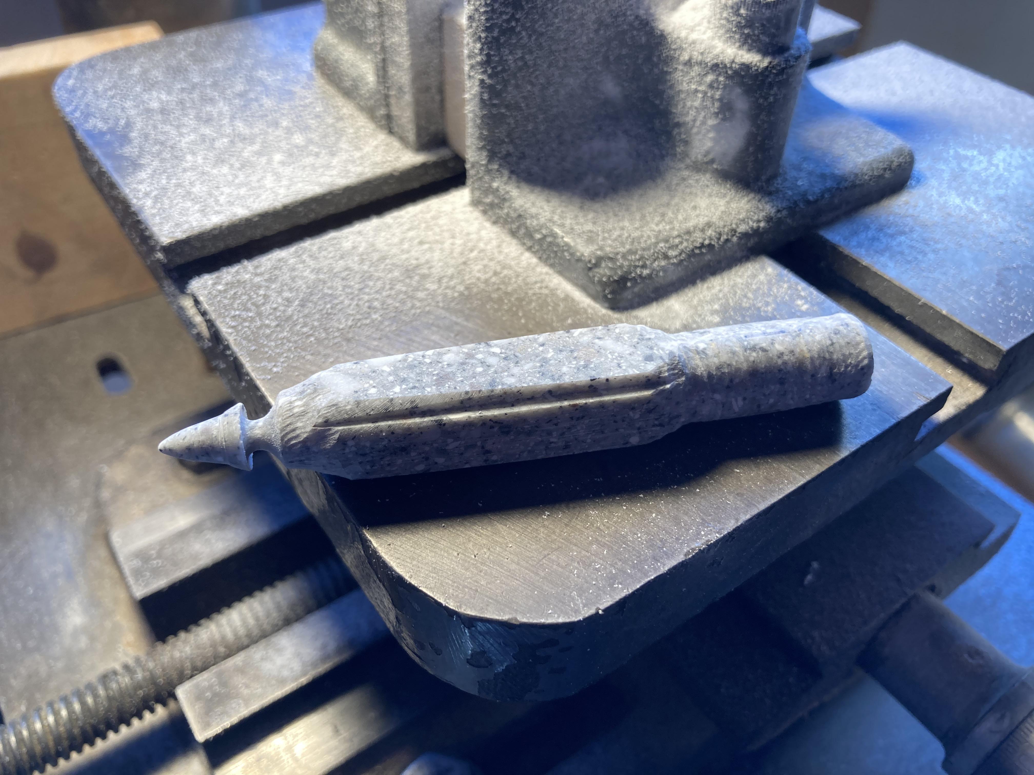

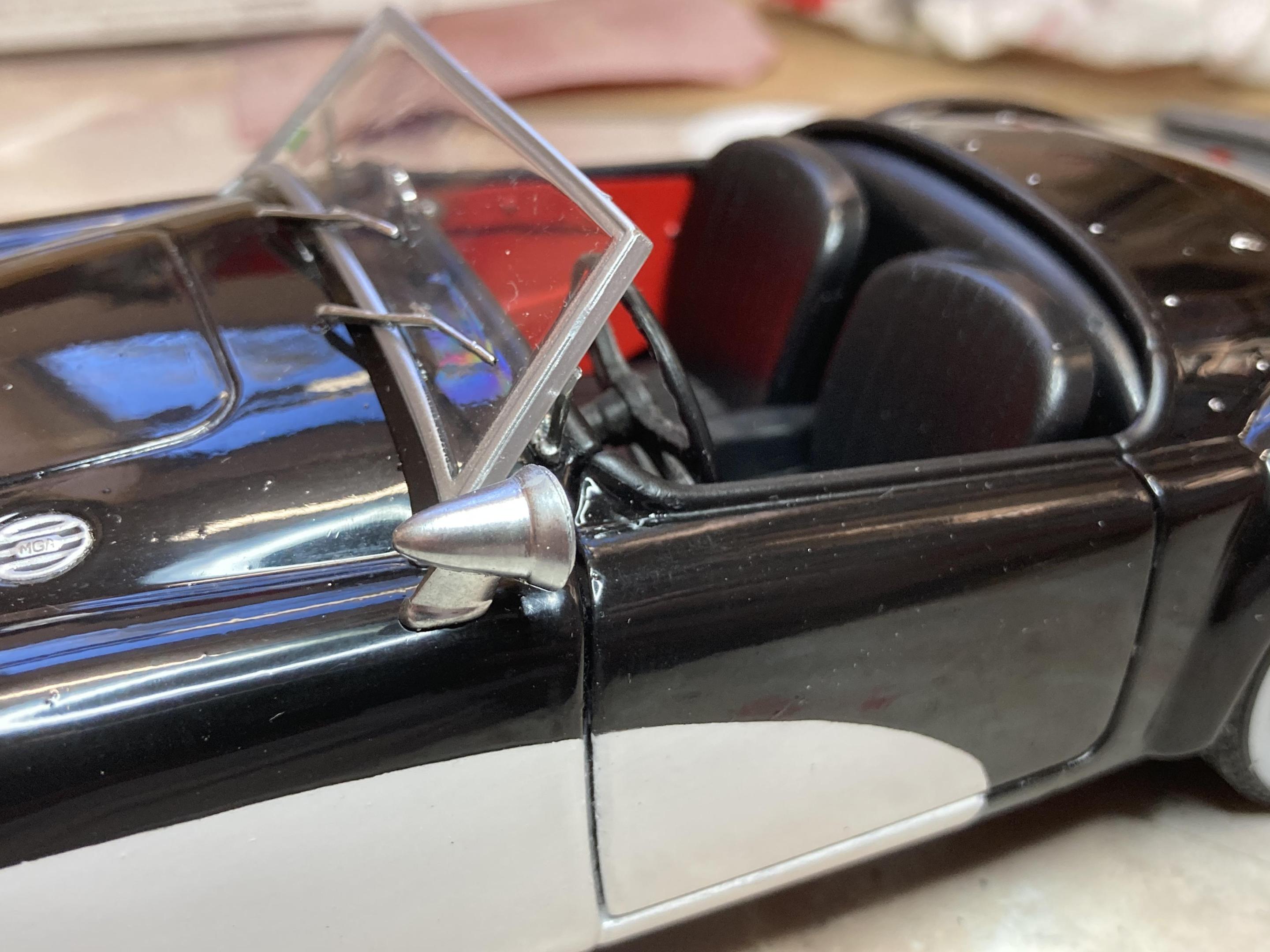

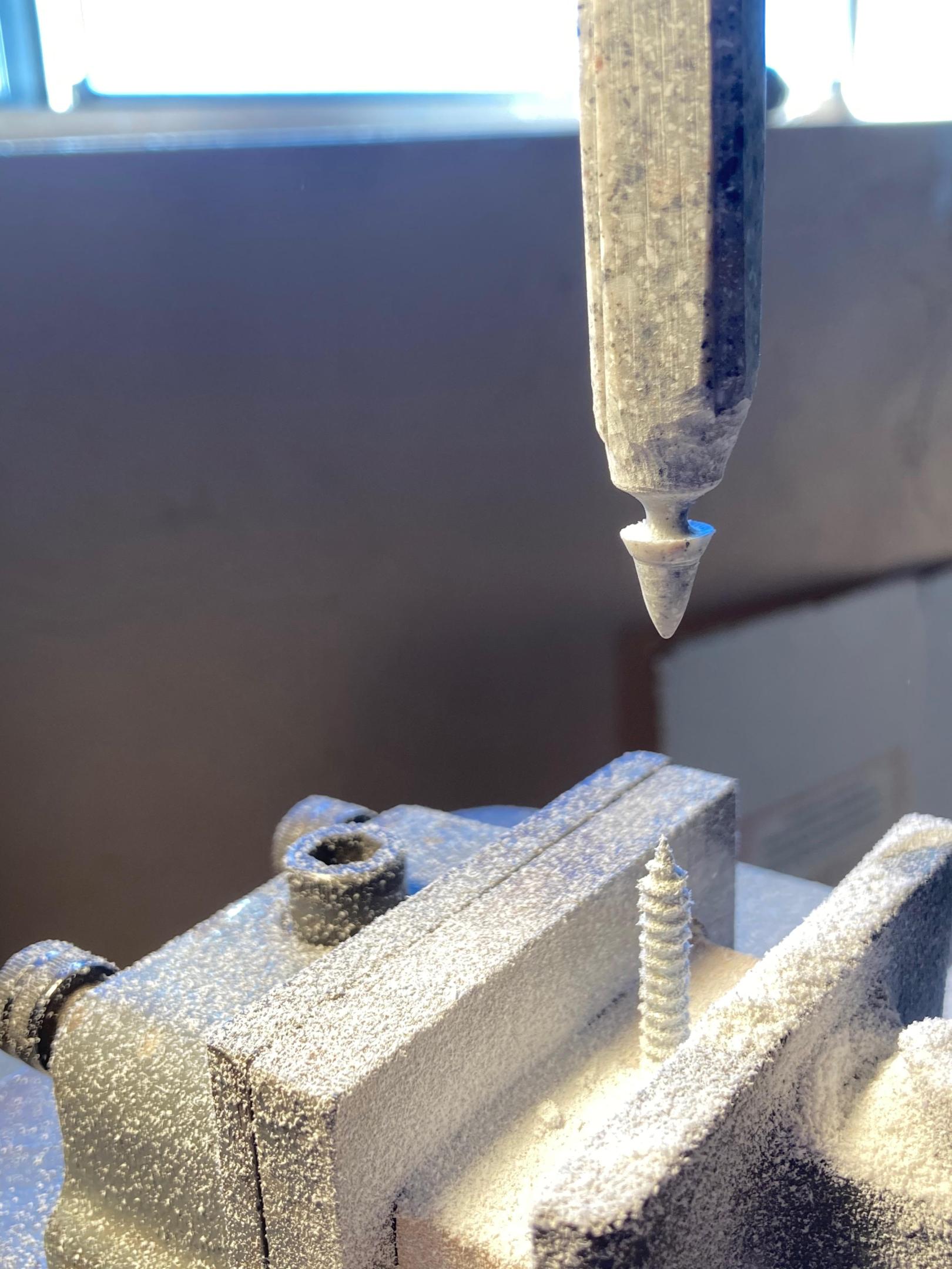

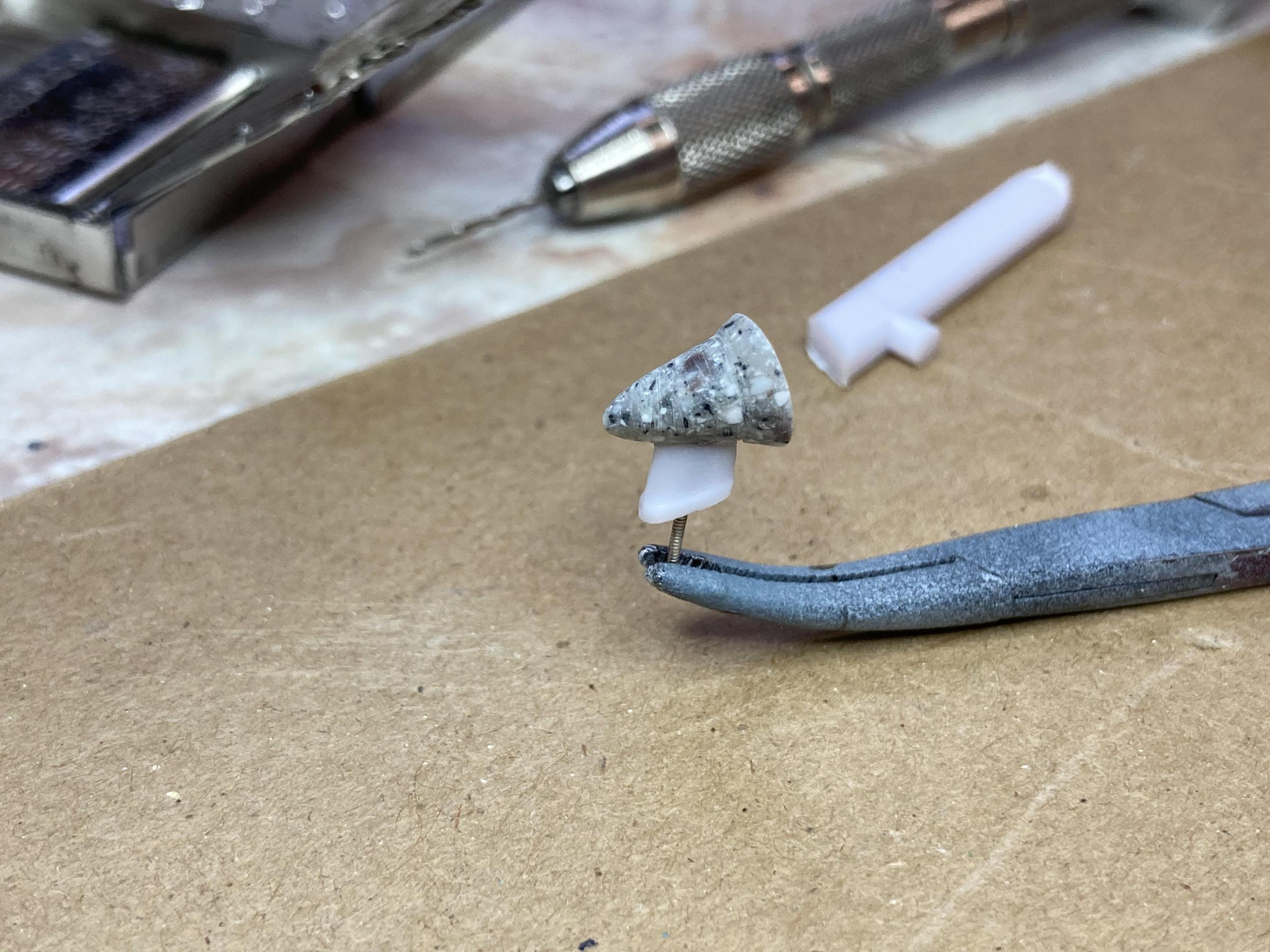

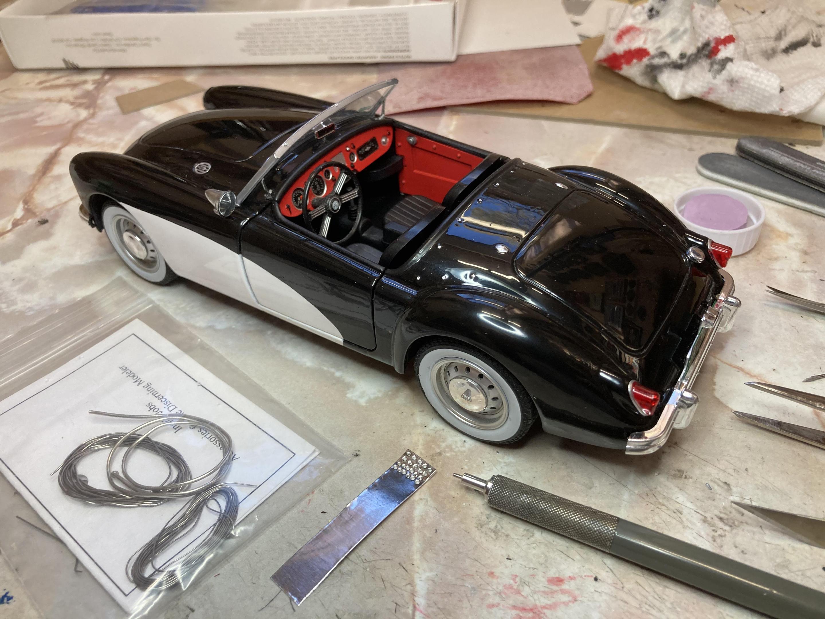

89AKurt Posted December 30, 2022 Author Posted December 30, 2022 Well, this topic only shows that it takes me forever to get anything done. This sat for two years! I just wasn't motivated to work on this, even though the owner was willing to pay. So I handed it off to a model club member who needed money more than me, and he pulled it off. The big PITA was parts that would not come off, so lots of masking was involved. I told him to lightly wet sand the paint with fine grit emory cloth. What we both found out, it's like handling a brick, I had to make a wood jig to hold the body, and doors, for painting. So he got 95% of it done, I made the mirror like what the owner had on his car. Corian® was turned on the drill press. Made the mount from fat sprue. Painted with Alclad chrome, which matches what the model chrome is. The owner has it on a shelf up high, so it wasn't important to have a perfect finish on it, he is happy. 5
