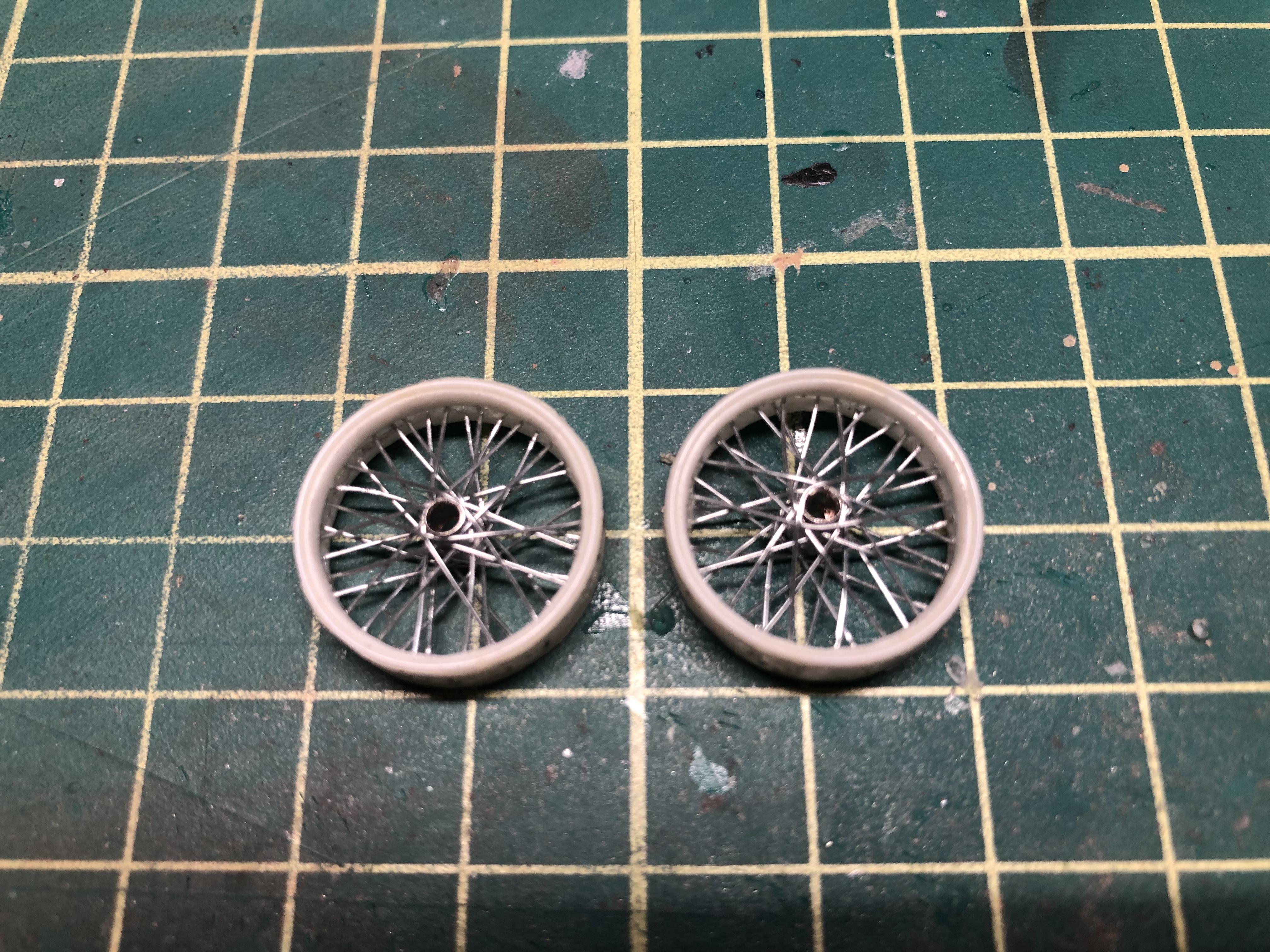

WHOSBAD Posted March 1, 2022 Posted March 1, 2022 (edited) My first wheel done with the kit rim filed down and fishing line. These are certainly the weak point of the kits, thx for the idea. Edited March 1, 2022 by WHOSBAD
Mike Williams Posted March 1, 2022 Author Posted March 1, 2022 @WHOSBAD, looks very nice! Not sure of the scale shown, maybe 1.25? If so, sensational! The rims come together very nicely! Compliments! The hub is a bit cluttered still, might like to not make too sharp of winding the "wire" around the hub. Perhaps go instead of trying one less turn on the first twist, instead of going 2 to the side. This will reduce loading and clogging at the hub..the paint will come out better, too. Sensational job, well done! Mike..
WHOSBAD Posted March 3, 2022 Posted March 3, 2022 (edited) Thanks Mike. These are indeed 1/25 and yes working on cleaning up around the furrell for the hub, trying wire that should hold its shape a bit more than the plastic fishing line. This pattern was only moving one spoke past the opposite pin, so minimal wrapping. Just trying to make this FED look a little more real. Edited March 3, 2022 by WHOSBAD

WHOSBAD Posted March 5, 2022 Posted March 5, 2022 And the steel wire worked much better than the plastic fishing line.

Mike Williams Posted March 7, 2022 Author Posted March 7, 2022 On 3/5/2022 at 4:03 AM, WHOSBAD said: And the steel wire worked much better than the plastic fishing line. Very nice! You have it!
