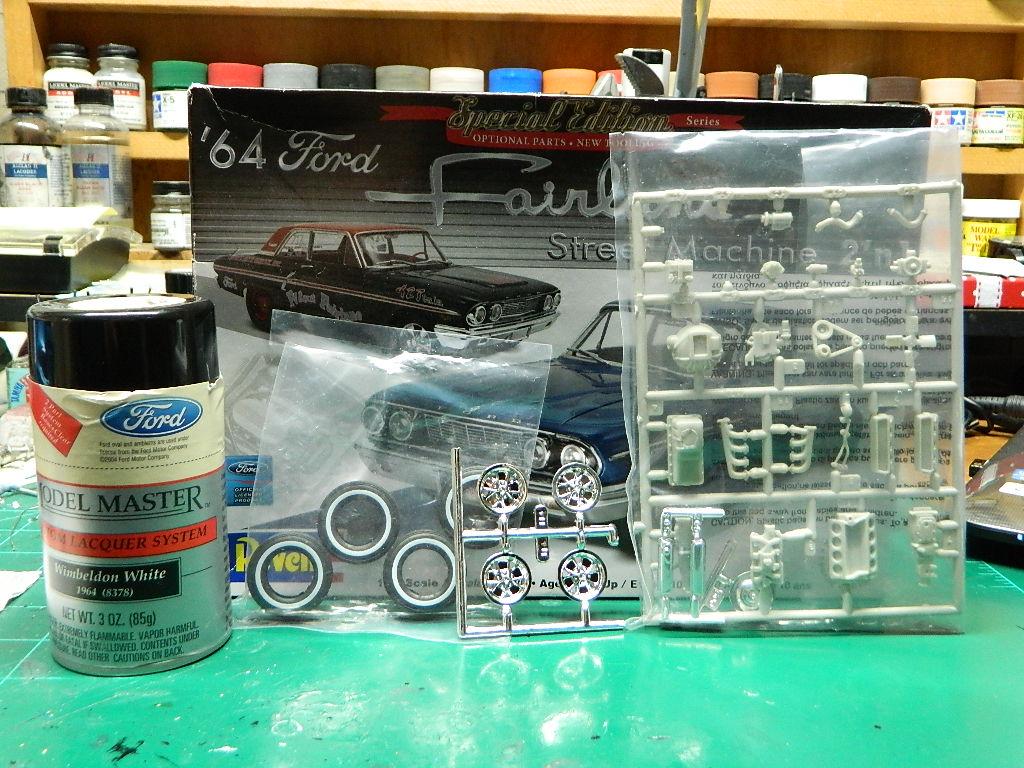

mrmike Posted March 30, 2020 Posted March 30, 2020 (edited) This afternoon, I was looking around Facebook and I saw a name I haven't seen in a long while. His name is Erik. I investigated the name and it was the friend I had lost contact with many years ago. I had bought this kit off of him years ago and he was going to build it as a 289 CI powered Sport Coupe. His plan was to paint it Wimbleton White with a red interior and I liked the plan. But, I made a few changes to that plan. Instead of steel wheels and hubcaps, I'm going with a set of Ford Styled Steel Wheels and whitewall tires. I filled the cutouts for the drag slicks on the rear fenders. I will use a dual exhaust system from the AMT '62 Thunderbird. Let's see what I can do with this kit... More Fairlane to come... Edited April 1, 2020 by mrmike

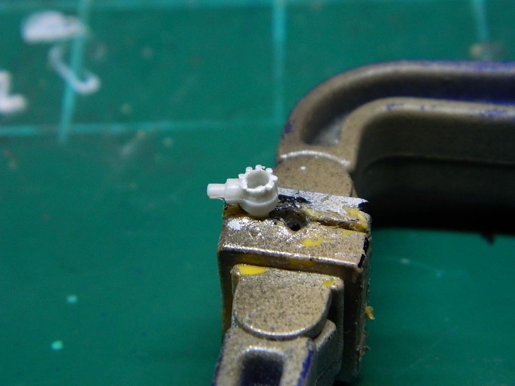

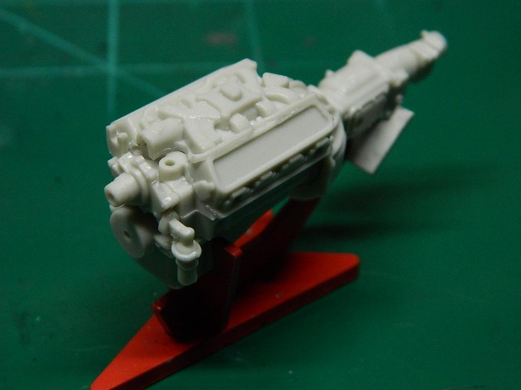

mrmike Posted April 2, 2020 Author Posted April 2, 2020 (edited) I started on basic engine assembly and paint detailed the parts to go with it. I have drilled out the distributor for plug wires. I've completed the 289 CI engine and I have painted the wheels and have assembled them with whitewall tires from the Moebius '65 Satellite. More Fairlane to come... Edited April 2, 2020 by mrmike

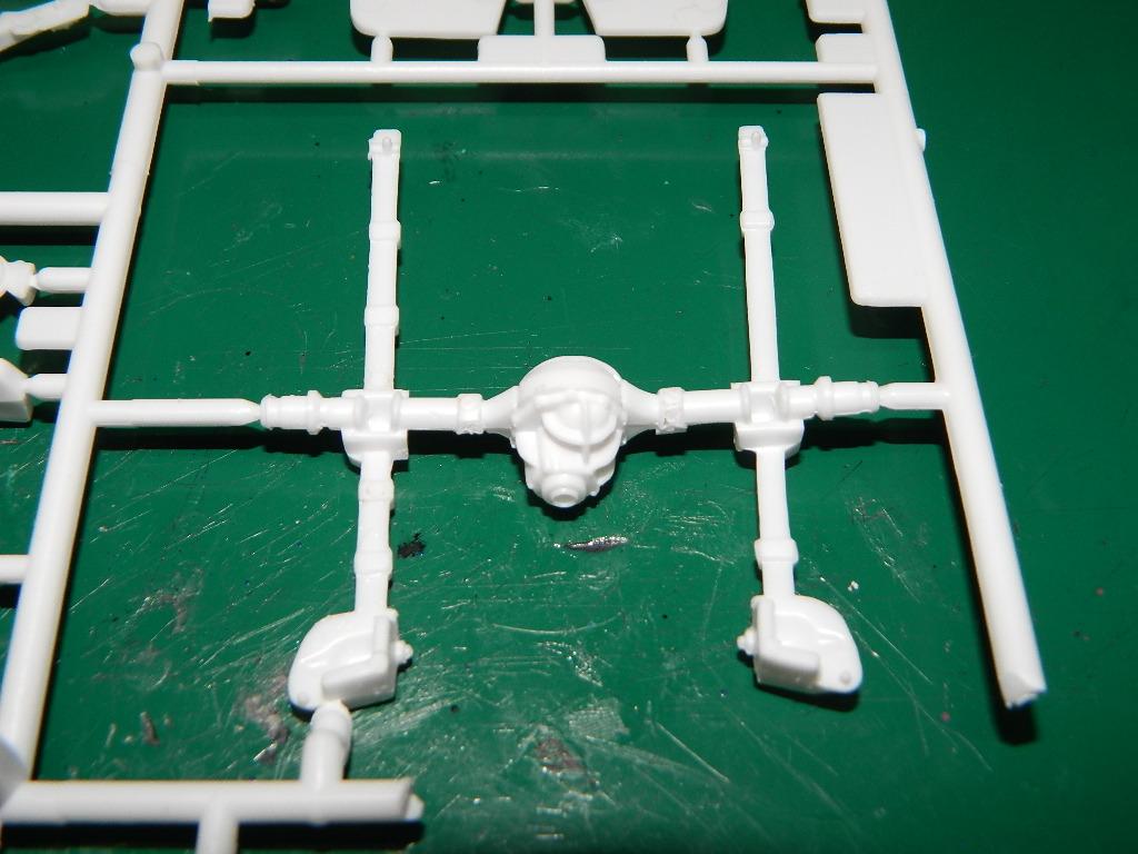

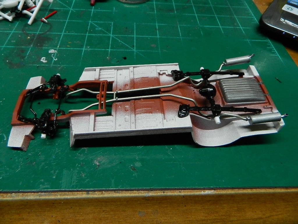

mrmike Posted April 8, 2020 Author Posted April 8, 2020 I found an exhaust system that will fix my needs for this model. It comes from the AMT '62 Thunderbird and it was given to me last year by the late Barry Fadden. I added the second half of the rear axle housing. The rear axle assembly is made for the 427 CI engine, but I'll use it here. I added the wheel backings, but I noticed the different lengths of the hubs. I'll add these last to get the correct axle widths. More Fairlane to come...
mrmike Posted April 8, 2020 Author Posted April 8, 2020 I've been painting some parts this morning with Tamiya X-18 Semi Gloss Black. I thought I had lost an entire sprue with the dash board on it, but I found it off to the side of the box on the floor. I painted the front and rear shock/coil spring assembly, but they may be replaced with some simple shocks in the rear. More Fairlane to come...

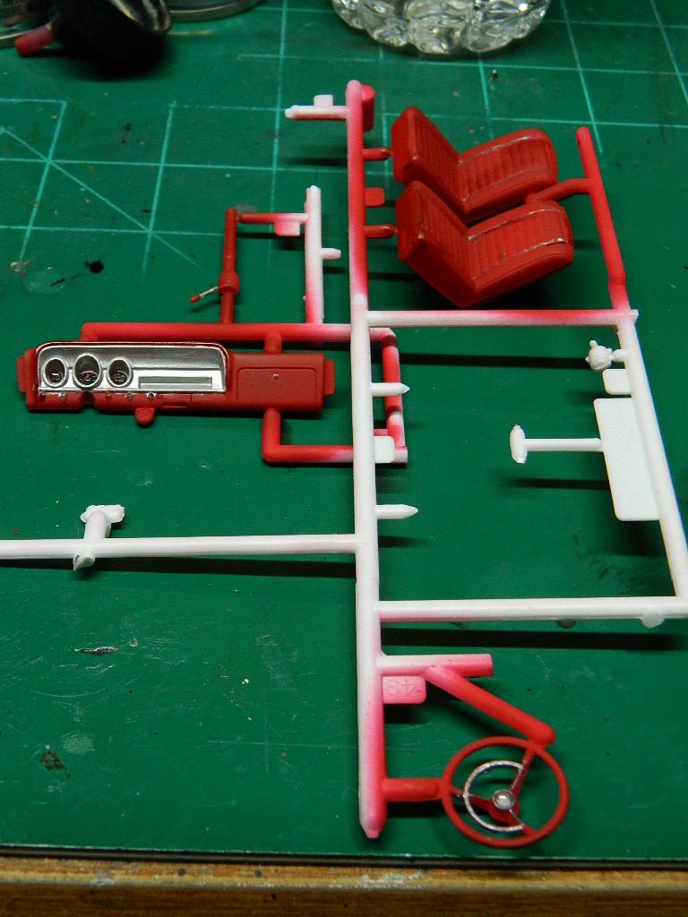

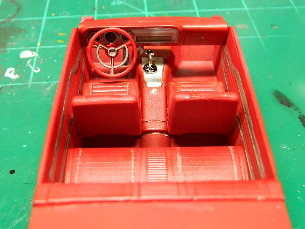

mrmike Posted April 9, 2020 Author Posted April 9, 2020 I have painted the interior with Model Master Insignia Red with my Badger Universal 360 Airbrush. I drew the silver stripes on the seats with my Molotow Liquid Chrome 1mm pen. After looking at some pictures of a Fairlane interior, I remembered having a console from the AMT '62 Thunderbird. A little sanding and I added it to the interior. More interior parts ready for a coating of Semi Gloss Clear. The Dash has been detailed with silver and gauge decals. I detailed the front and rear panels and the shifter. More Fairlane to come...

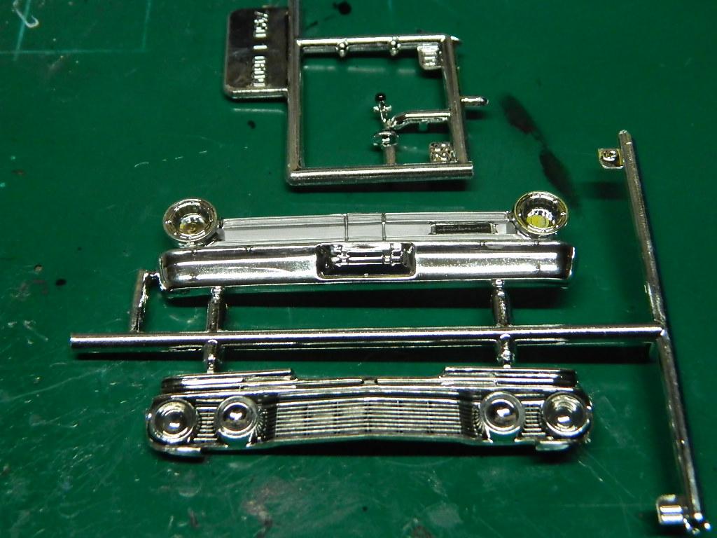

mrmike Posted April 10, 2020 Author Posted April 10, 2020 I have finished the front grille and rear panel of the Fairlane. I am almost finished with the chassis. I need to make a set of shock absorbers since the set I found are way too long. More Fairlane to come...
mrmike Posted April 11, 2020 Author Posted April 11, 2020 The interior has been assembled. I glued the wheels and tires on so the Fairlane wouldn't roll and I made a pair of shock absorbers for the rear suspension with some 1/8th inch tube and 1/16th inch rod and painted them gloss yellow. More Fairlane to come...
