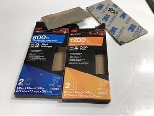

Nice write up Steve. This stuff does a nice job on contoured surfaces. It also comes in 3000 grit, which is what you would want.  What is the advantage of a panel scriber over the backside of a blade? Different contour?
You could use the back of a blade if that's what you're comfortable with, but I have a hard time with control with that operation.
I have much better control with the scriber.
You might be able to bypass the scriber altogether and go straight into the files as well.
You can also use whatever you prefer for sand paper, but you're really not doing much for sanding anyway.
You don't want to grind down the definition that you just created by scribing.
This is really no more than a different technique for basic scribing and you could modify it in any way that you feel comfortable with it.
