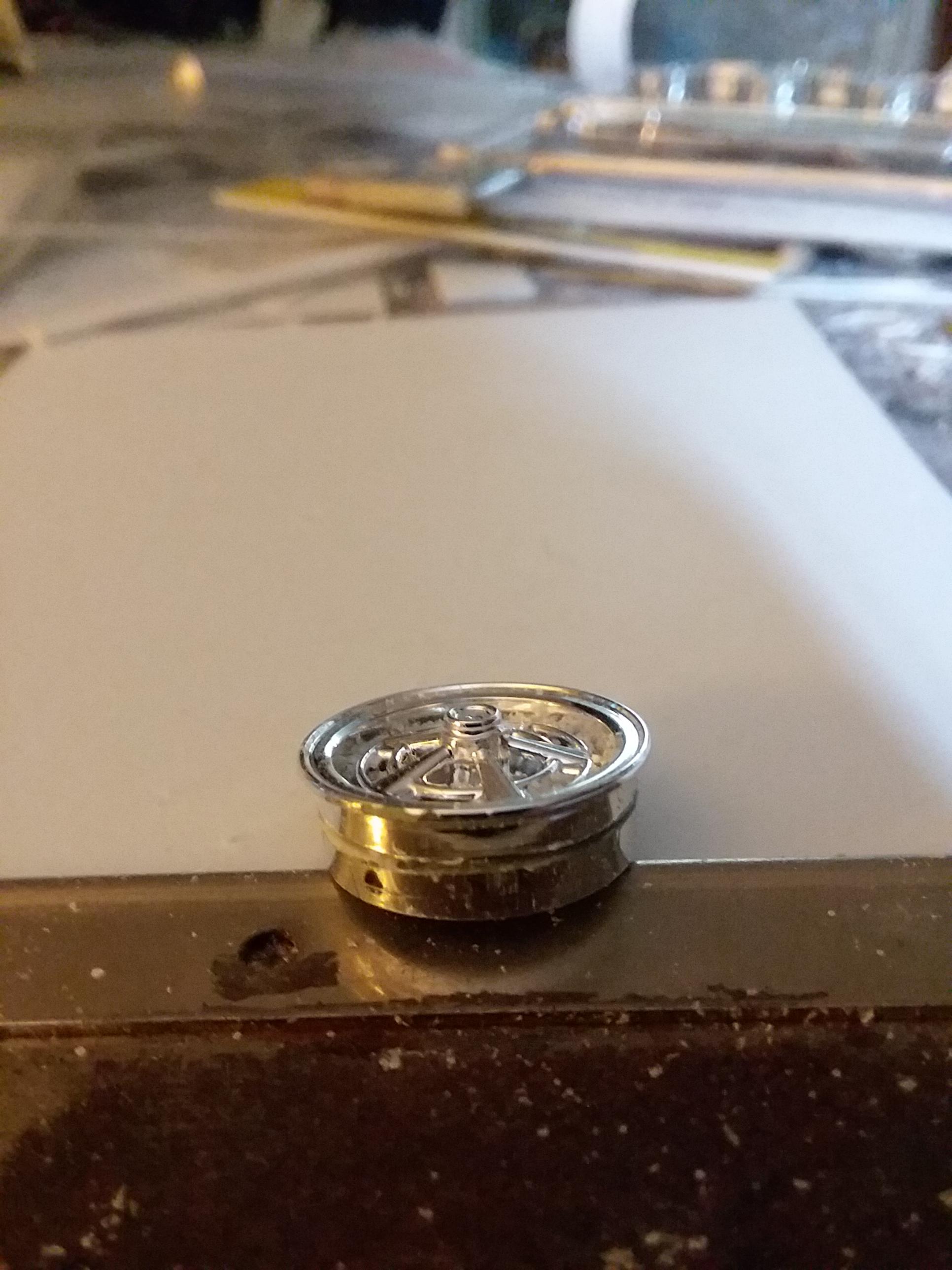

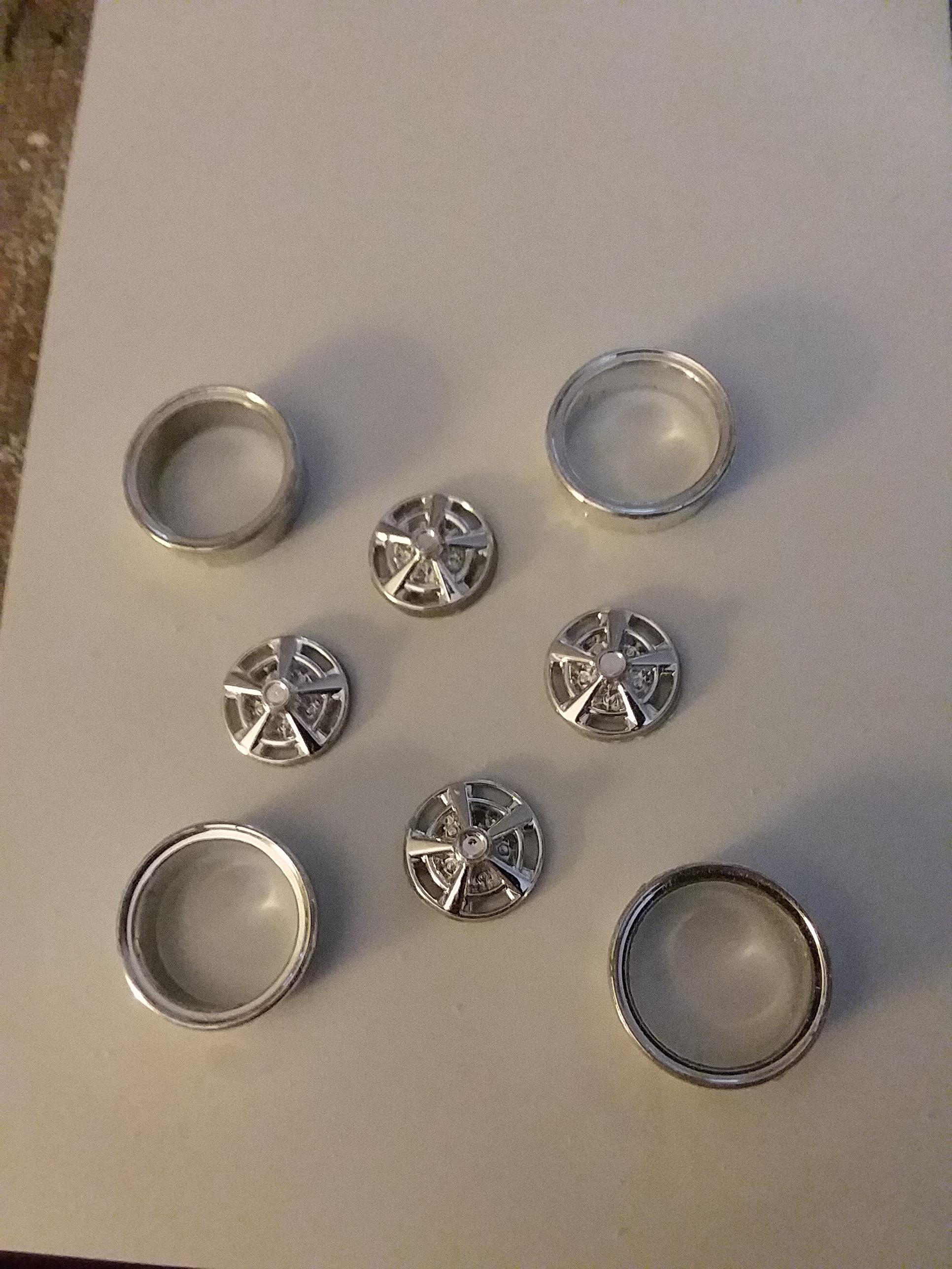

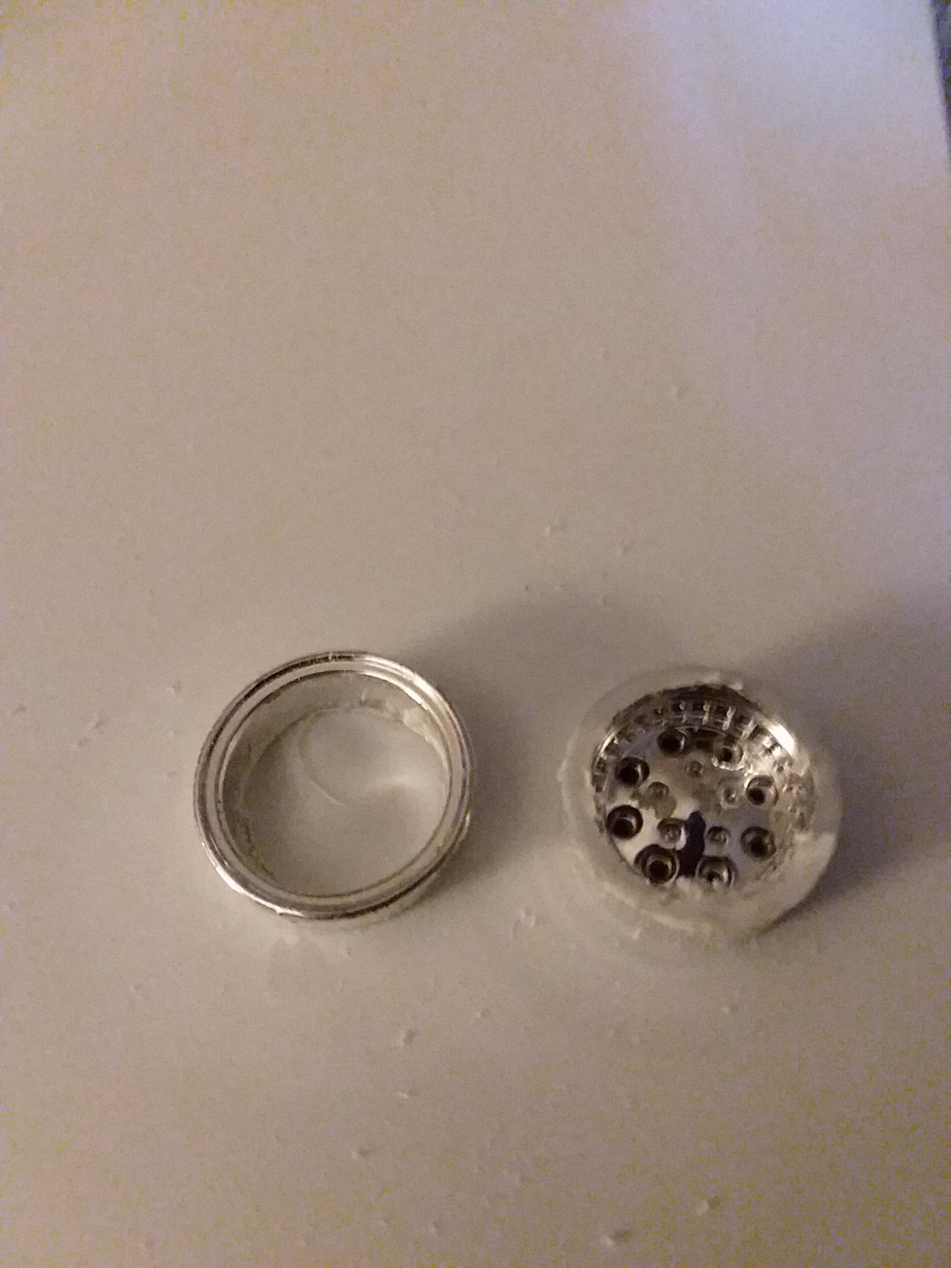

Oldcarfan27 Posted April 8, 2020 Author Posted April 8, 2020 (edited) Next up the Rally IIs. We all know how shallow the stock Rally II wheels are in the kit and you guys may have your own personal preferences on replacements. However, I'm not about to spend a lot of time and money trying to find better representations, so I'm going to try to improve the wheels in this kit. In the original issue, the wheels weren't that thick because they went inside solid, narrow polyglas tires from the era. But, over time the tooling gained some bulk so they could fit into wider, hollow, more modern tires. Even after all the cutting, they only added thickness to the BACK of the wheels, not to the front, so they are still too shallow looking on the business end. First off, is to separate the centers from the rings. I ended up cutting off about half the thickness of the wheel just to get close to where the wheel center is to sand it away from the trim ring. Once separated from all 4 wheels, I set aside the wheel centers and looked for suitable replacements for the trim rings. I found a bunch of deep dish custom wheels that I had too many of, so that's what I decided would fit my needs. I could adjust the depth to look closer to OEM. I took the first wheel and cut away the center and then sanded the rim down to the depth that I liked. Once satisfied, I used it to mark the point to cut the other 3 rims to match. I glued the original centers to a sheet plastic backing and then detail painted them, before attaching the trim rings to finish. I've decided I like the look of the BF Goodrich Radial T/As for this car. Now I just need to figure out what paint to use for the white letters. Enamel stays sticky forever and acrylic will peel off when the tire flexes. All in all this little project only took me a couple hours to do and I'm happy with the results. Edited April 8, 2020 by Oldcarfan27

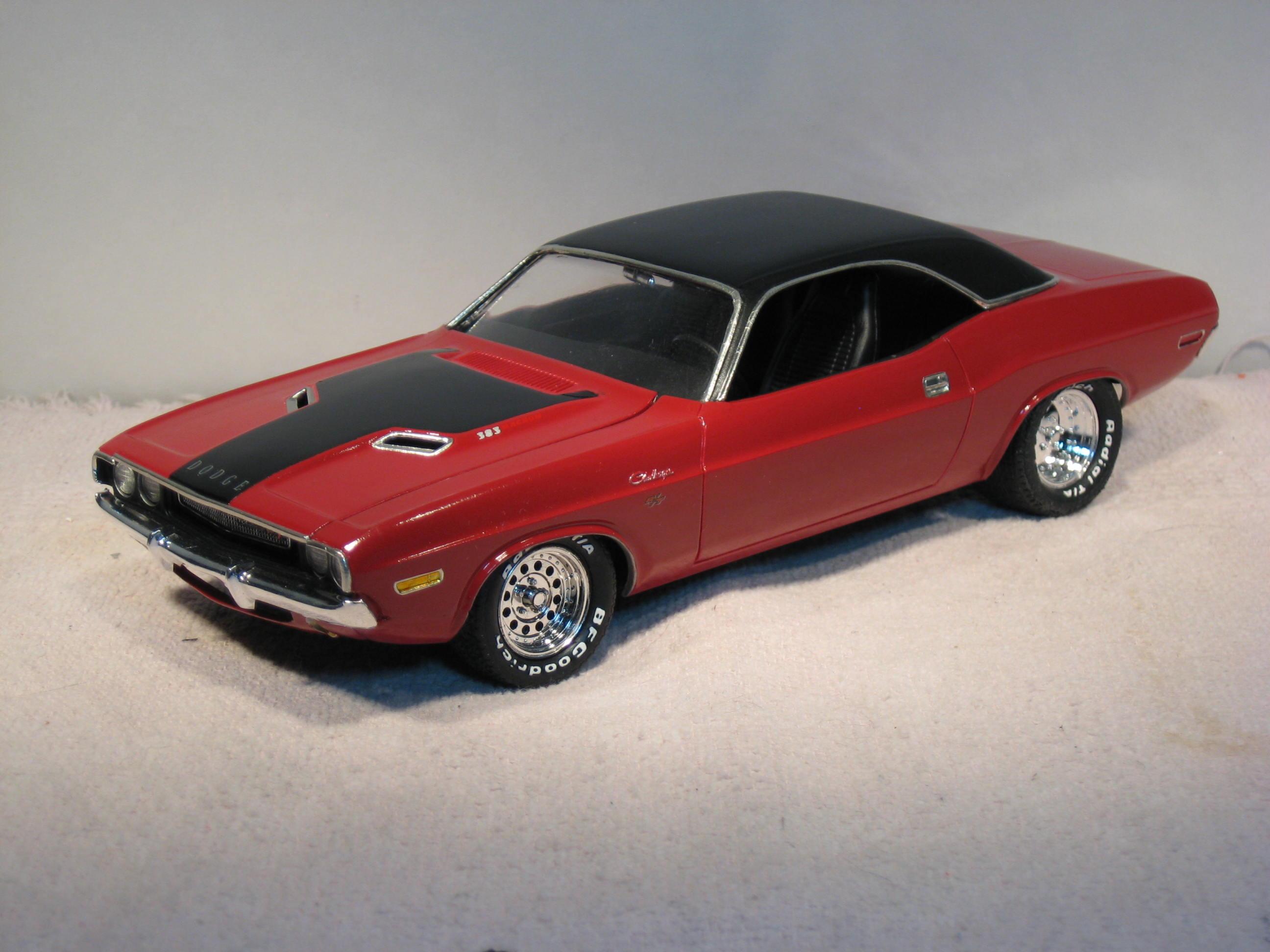

Oldcarfan27 Posted April 8, 2020 Author Posted April 8, 2020 12 minutes ago, Can-Con said: Yup, I did the exact same thing for this one. Beautiful TA, Steve! I really like the deep dish look to the Rally II's, too bad MPC never got that right from the beginning.
