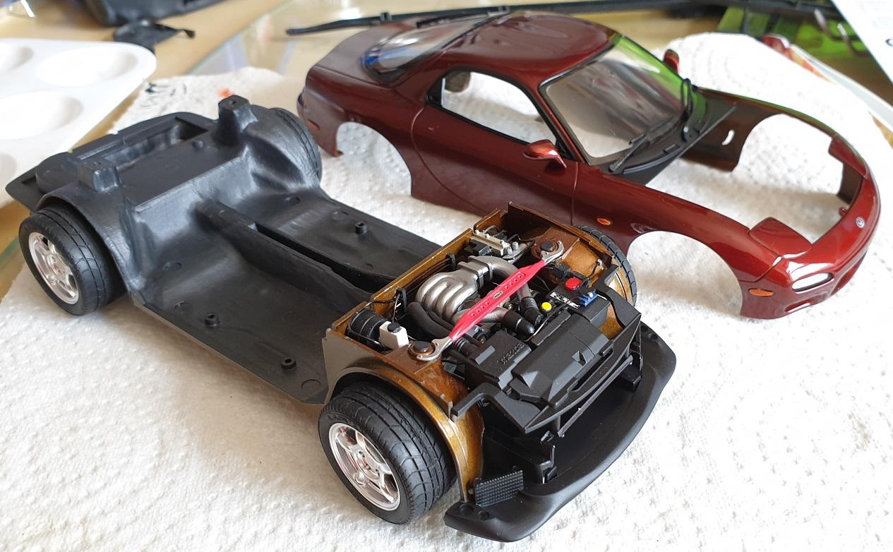

Funkychiken Posted May 17, 2020 Author Posted May 17, 2020 Body shell 99% complete, just needs a clean & wax, then the window pieces and lights. was sanded with micromesh and polished with heavy scratch & light scratch Nuovos polish. Most of the details ahve also been picked out - like the side indicator lights & the black window surrounds

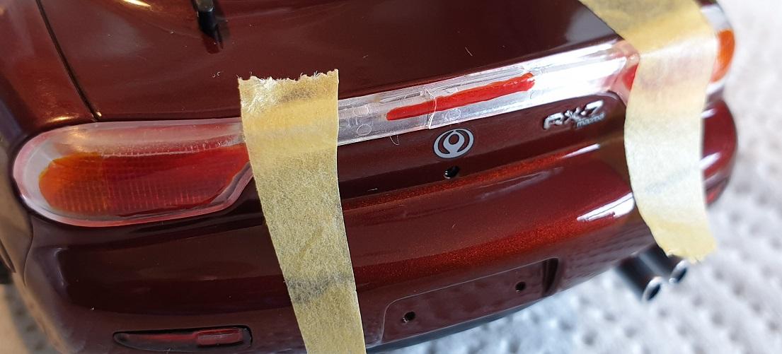

Funkychiken Posted May 17, 2020 Author Posted May 17, 2020 I really don't know how to do this tail light, its being hand painted, but its prominent in the final assembly, and hand painted, will not look very good... Any Suggestions?

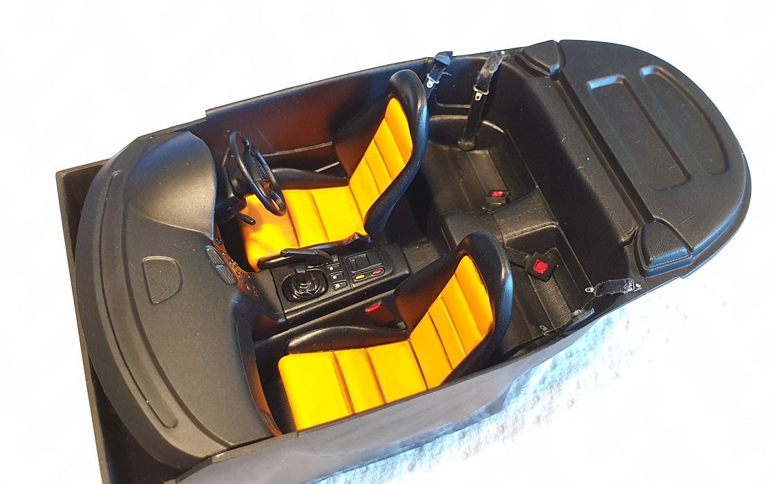

Funkychiken Posted May 17, 2020 Author Posted May 17, 2020 Interior finished today, detailing and assembly took the last full week! I'm pleased with it, but most of the work was done by Tamiya quality moulding and detailing - I can't take all the credit here!
Italianhorses Posted May 17, 2020 Posted May 17, 2020 Interior and body paint look great! For the lights - it should have a faint outline of the area to be painted imprinted there. Take a piece of masking tape, and stick it over it, then find that outline and lightly run a side of a soft pencil over it - that will transfer the outline to the masking tape. Peel it off, cut along the line with a sharp blade - and there you have it - a custom paint mask! Put back on, and spray or brush paint away.
89AKurt Posted May 17, 2020 Posted May 17, 2020 29 minutes ago, Funkychiken said: I really don't know how to do this tail light, its being hand painted, but its prominent in the final assembly, and hand painted, will not look very good... Any Suggestions? Love the paint color, doing a good job far as I can tell, but I should study the advice given. Clear taillights is a pet peeve of mine. I've been using stickers more, avoids the brush strokes, and creates sharp edges. If AAA Insurance isn't in England, then don't know what else to suggest, perhaps red electrical tape.
matthijsgrit Posted May 18, 2020 Posted May 18, 2020 16 hours ago, 89AKurt said: Love the paint color, doing a good job far as I can tell, but I should study the advice given. Clear taillights is a pet peeve of mine. I've been using stickers more, avoids the brush strokes, and creates sharp edges. If AAA Insurance isn't in England, then don't know what else to suggest, perhaps red electrical tape. Maybe paint it form the inside as good as possible and the smoke it on the outside?
Funkychiken Posted May 21, 2020 Author Posted May 21, 2020 On 5/17/2020 at 8:54 PM, Italianhorses said: Interior and body paint look great! For the lights - it should have a faint outline of the area to be painted imprinted there. Take a piece of masking tape, and stick it over it, then find that outline and lightly run a side of a soft pencil over it - that will transfer the outline to the masking tape. Peel it off, cut along the line with a sharp blade - and there you have it - a custom paint mask! Put back on, and spray or brush paint away. Thanks Alex, I think this is the route i'll take On 5/17/2020 at 9:01 PM, Brizio said: Love the body color Thanks Fabrizio! On 5/17/2020 at 9:15 PM, 89AKurt said: Love the paint color, doing a good job far as I can tell, but I should study the advice given. Clear taillights is a pet peeve of mine. I've been using stickers more, avoids the brush strokes, and creates sharp edges. If AAA Insurance isn't in England, then don't know what else to suggest, perhaps red electrical tape. Thanks Kurt, I will definately try the tape method on a future build, I'd never have thought of it, great tip! On 5/18/2020 at 1:18 PM, matthijsgrit said: Maybe paint it form the inside as good as possible and the smoke it on the outside? Good suggestion on the Smoke Matthijs, I will be doing that too, but i'll still hand paint the colour, and mask/AB the black... unfortunately I've snapped the tail light peice whilst painting it... Doh! The clear plastic is so much more brittle than the coloured stuff...

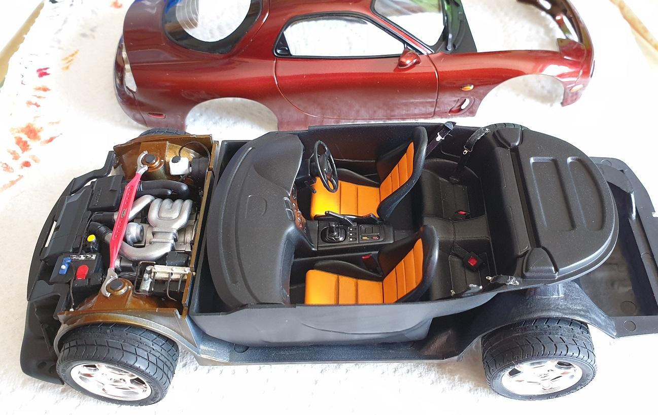

Funkychiken Posted May 21, 2020 Author Posted May 21, 2020 And this is where I am now. 2 remaining points - the seat belt hanger I added is conflicting with the glazing, I'm going to heat it and bend it in, or cut it off and put a spacer in And the tail light is yet to be done... this will be my lock down build - hopefully complete within 1 week - the quickest I've ever completed a build - by far!
Funkychiken Posted May 26, 2020 Author Posted May 26, 2020 On 5/21/2020 at 4:10 PM, Italianhorses said: Looks great! On 5/22/2020 at 3:14 AM, Jonathan said: Really like the color choice! On 5/23/2020 at 12:34 AM, Dann Tier said: STUNNING EVERYTHING!!!!! Johnathan, Alex & Dann, thanks for your kind comments! The tail light is taking longer than I imagined. It's had a few hand brushed coates of clear red & orange, left to dry, then it snapped. so here i'm using the body as a jog to glue the 2 pieces together.
Funkychiken Posted May 26, 2020 Author Posted May 26, 2020 After leaving over night for the PVA to set, when taking off the tape, it left print marks in the clear red! had to sand down a little with micomesh. then carefuly mask the underside & give it a few coats of Tamiya Smoke thinned with Lacquer. this tail light process has now taken a week! I dont't understand how folk can build a car on a weekend...
