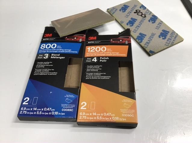

NOBLNG Posted April 10, 2020 Author Posted April 10, 2020 (edited) It stretches slightly, so I just used it and my fingertips to sand the inside radius on the hood. It didn’t clog at all. It works good on styrene also. I made a sanding stick with it and that did clog when sanding the Milliput. I also have some 3m sanding sheets that are like a 1/8” thick foam in 800, 1200, and 3000 grit. They work great for smoothing areas that have been filed to shape, but they wear out very quickly. Edited April 10, 2020 by NOBLNG

Casey Posted April 14, 2020 Posted April 14, 2020 On 4/10/2020 at 3:17 PM, peteski said: These 3M flexible abrasive sheets Note this "paper" is not actually paper backer, but rather is backed by clear, rubber-like film. Great for sanding irregular or rounded surfaces (like stair balusters) but do not use this stuff if you want a flat surface. The backing will stretch ever so slightly, and that's not ideal.
