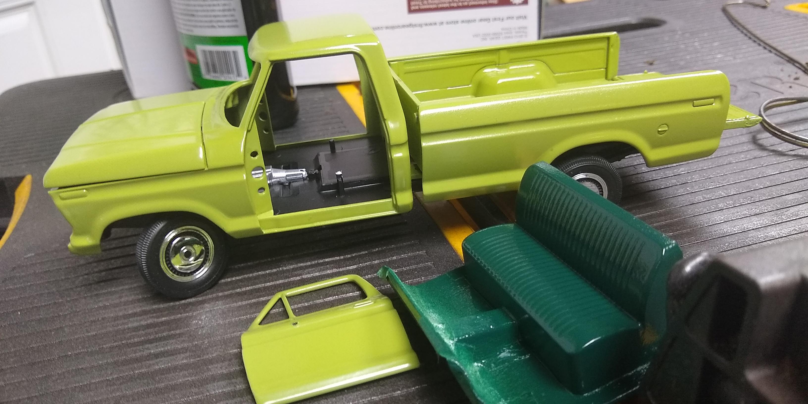

randyc Posted April 14, 2020 Posted April 14, 2020 This is the Krylon. ColorMaxx over Rust-Oleum 2x primer on a diecast. I primered it before I bought the green. This is over the factory paint that I scuffed with scotch Brite pad. They're is a thread in the diecast section that shows original model. The paint itself works ok but does seem to react with others. I had some light crazing on the door tops. In the gray that was applied over the blue. I let it sit for a couple days and it seems fine. Shiny enough for this one. I may try to polish out or I may repaint the get closer to the factory green. This is on metal though. If I were doing plastic, I would probably still prime. Or try to find the Rust-Oleum 2x paints. They give pretty good results from what I've found. I'm not sure what the dark green on plastic seats is. A can of appropriate color with no primer or anything. I can check that too, if you need to know. It came out very shiny and I really would have liked it duller. Will have to dullcote that. Good luck
