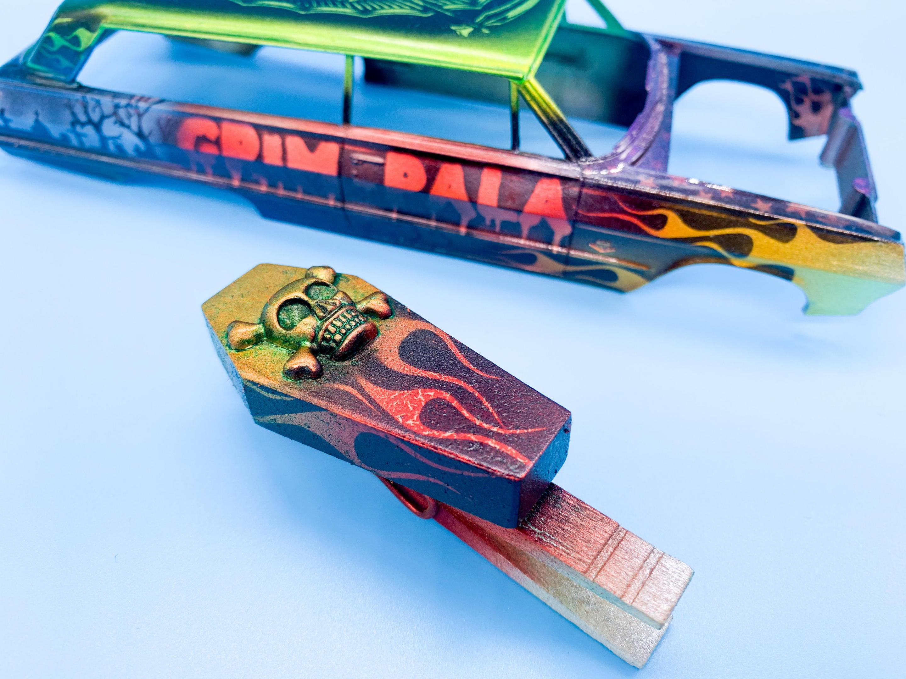

OldNYJim Posted April 14, 2020 Posted April 14, 2020 (edited) I found (accidentally) a while back that blasting too-thickly-applied Tamiya acrylic with a hair drier will make subtle splits and cracks as the paint shrinks and blisters a little when it dries too fast. Just used the same trick, intentionally this time, on a coffin that I painted for one of my projects: Im doing to go back in and brush some black pastel dust into the cracks to exaggerate the effect, but that might be a trick you can use? Edited April 14, 2020 by CabDriver
jaymcminn Posted April 14, 2020 Author Posted April 14, 2020 1 hour ago, CabDriver said: I found (accidentally) a while back that blasting too-thickly-applied Tamiya acrylic with a hair drier will make subtle splits and cracks as the paint shrinks and blisters a little when it dries too fast. Just used the same trick, intentionally this time, on a coffin that I painted for one of my projects: Im doing to go back in and brush some black pastel dust into the cracks to exaggerate the effect, but that might be a trick you can use? Whoa. That is exactly what I was looking for. Did you airbrush or brush the Tamiya acrylic? Was the paint still wet when you hit it with the dryer? I see that working really well with a tan base coat and a leather/brown top coat for the effect I want. Great paint on that Chevy (and the coffin, too)!
OldNYJim Posted April 14, 2020 Posted April 14, 2020 I airbrushed the acrylic on, nice and heavy of a coat and unthinned right from the jar and then blasted it with my wife’s hairdryer on the highest setting (which seems like it’s hot enough that it would burn your head if you actually used it on yourself ?) The longer you blast it the more of the effect you’ll get, within reason. I could’ve got a more extreme effect on this particular project but I didn’t want the candy to split too much and reveal the silver base underneath in this instance. Might take some experimenting, but I suspect it would work with paint other than Tamiya too
