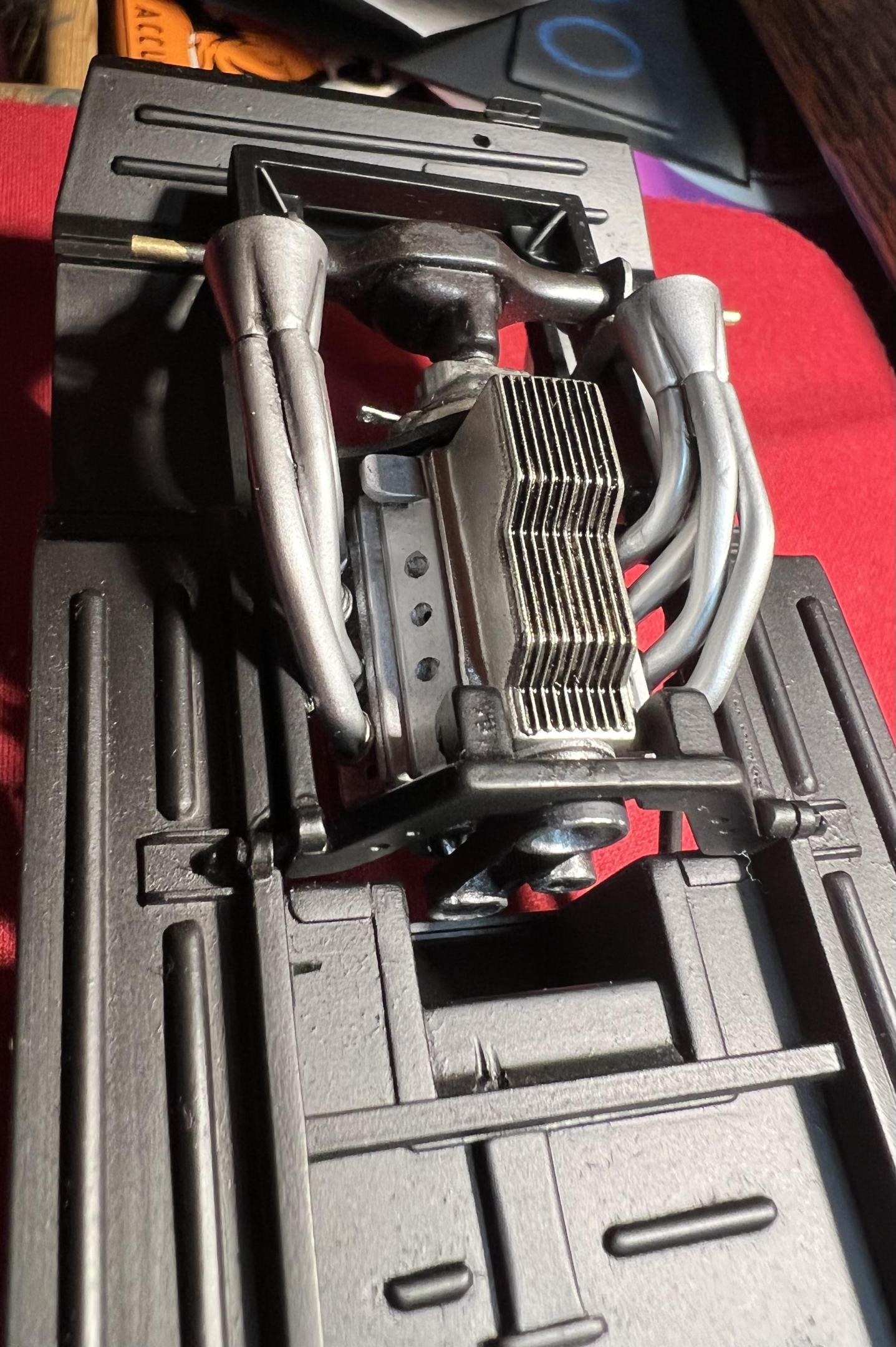

Above photo shows the axle with the brackets to attach it to the engine cradle so the axle isn’t just floating.

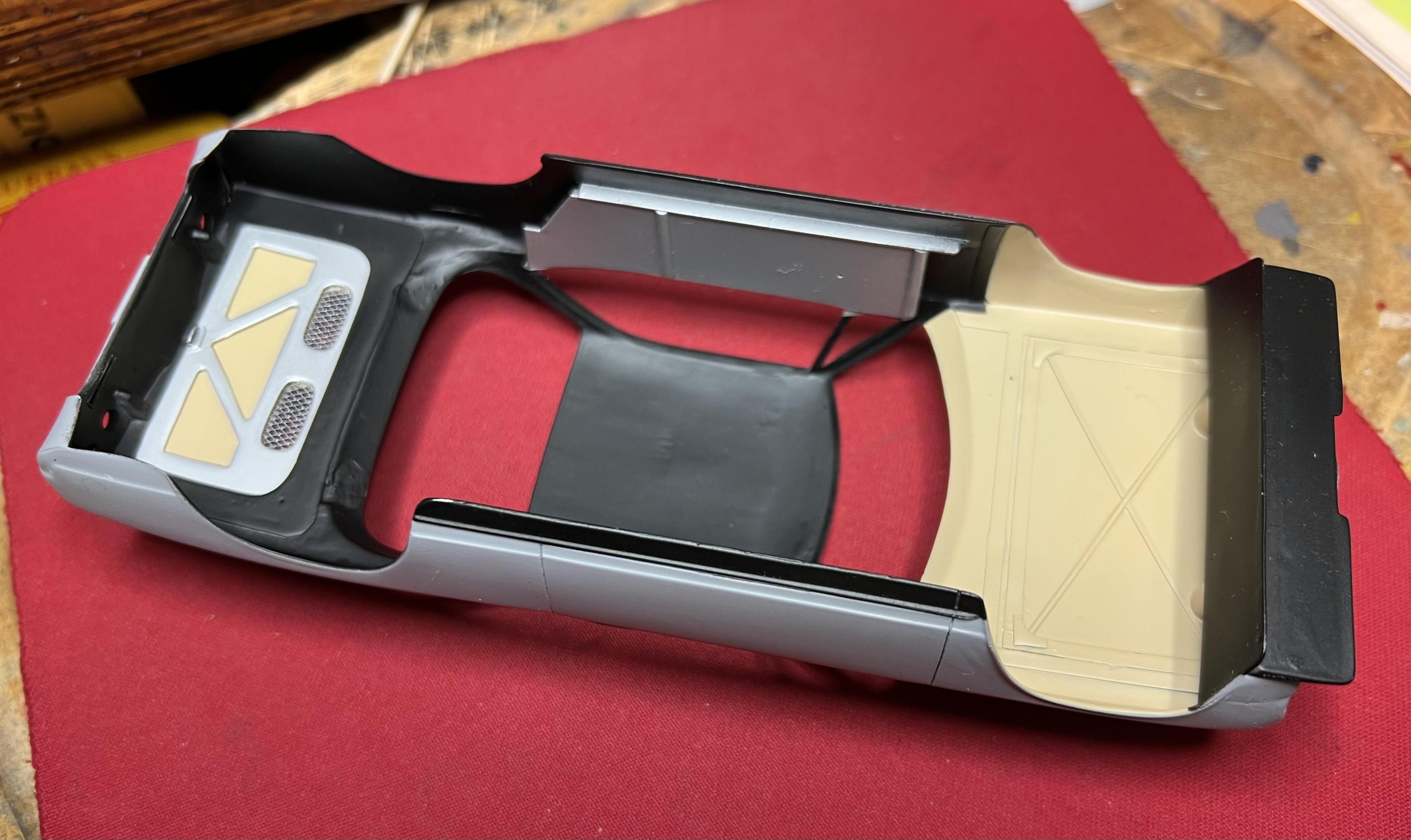

Here we see the underside of the engine cover, dash with locating holes for switches, the injector scoop, rear engine plate with the in/out box, and the parachute pack that will be further detailed with the release cable fitting to be added.

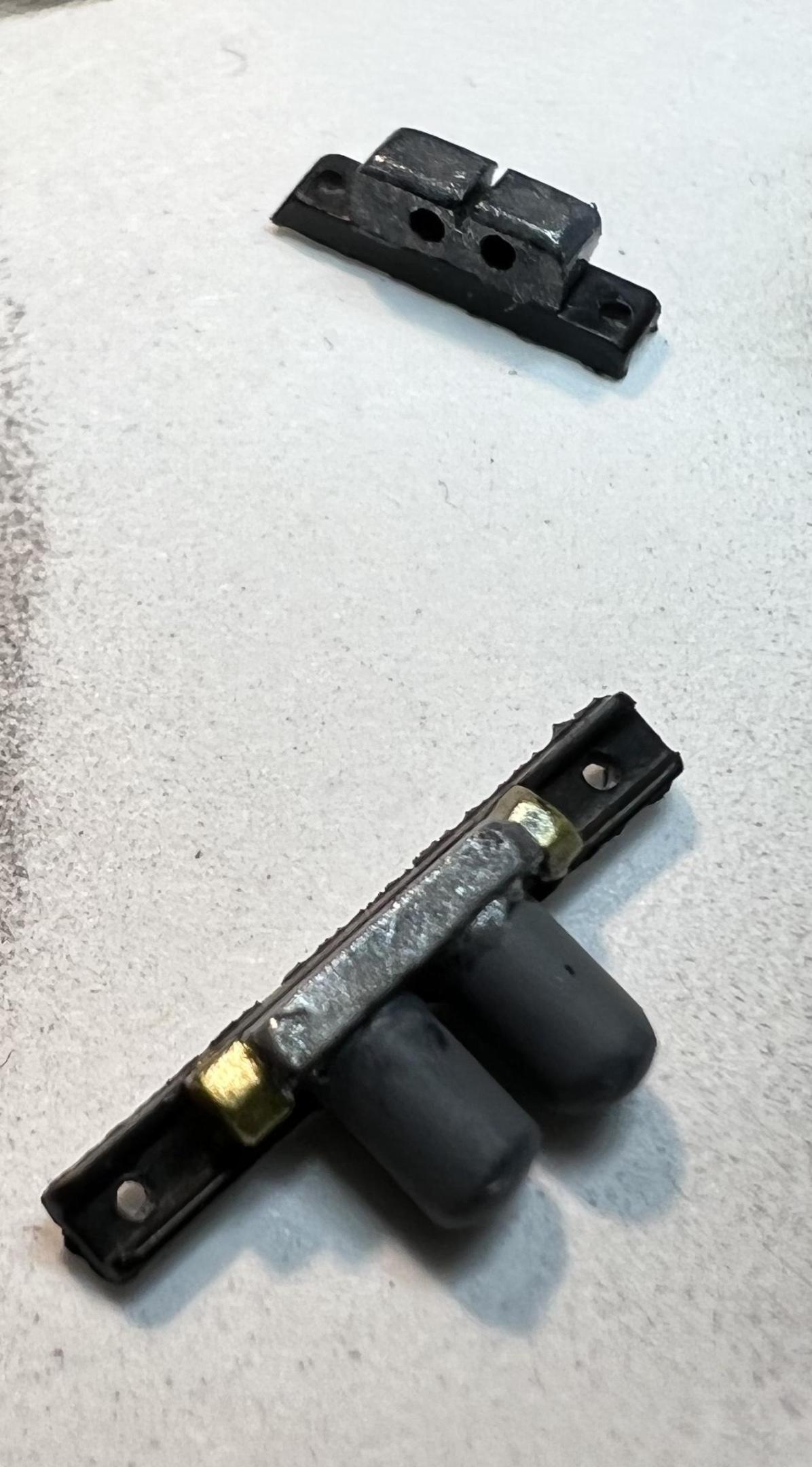

Scratch built the switch box for the battery cables that will run to the booster plate at the rear of the chassis. Below is the dual oil filter assembly

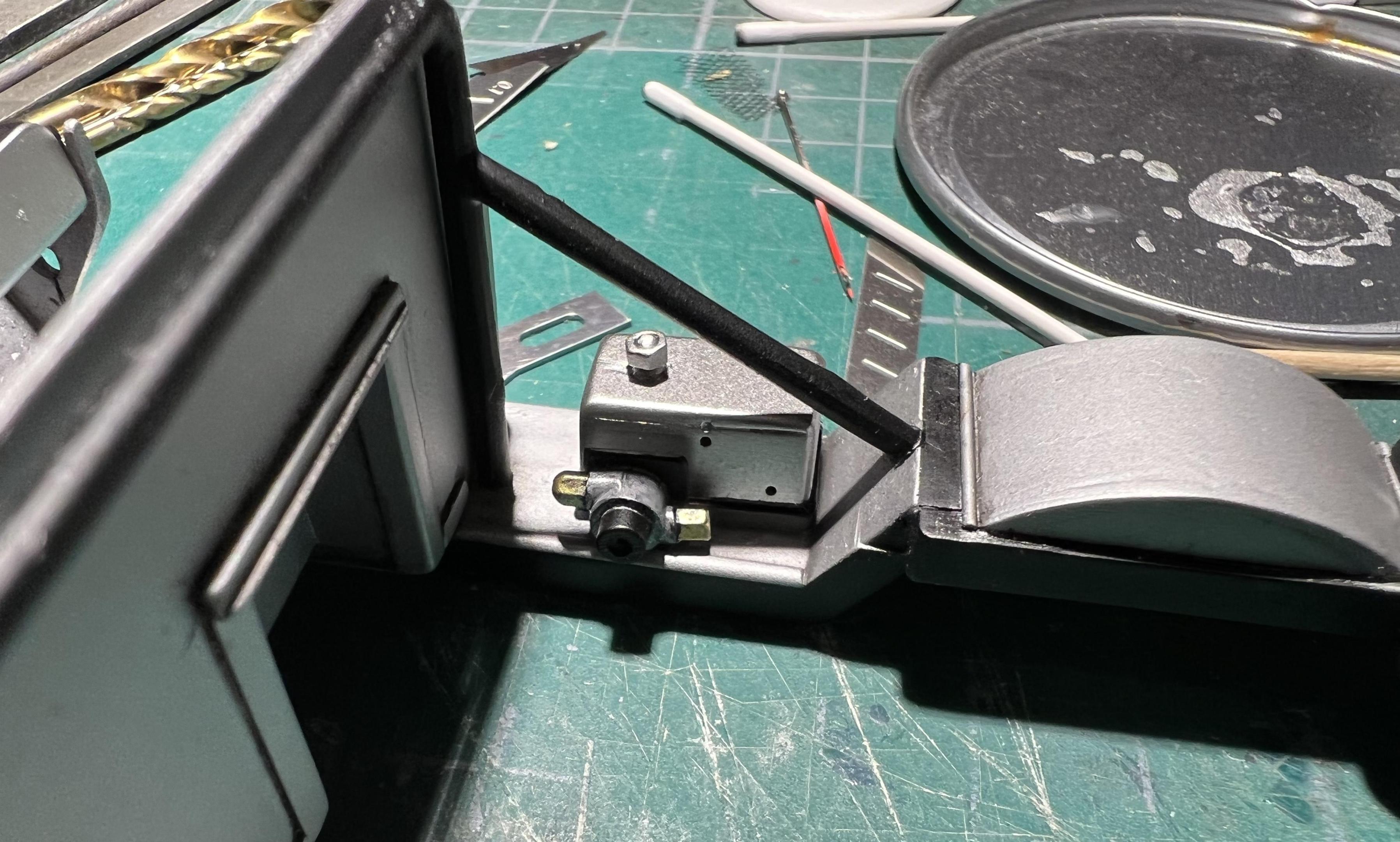

Here we see the moon tank being mocked up in preparation for routing fuel lines and the water tank still to be painted in polished aluminum.
Last shot shows the scratch built water pump that will be located on the firewall to circulate the coolant through the engine and tank.

Fitted new engine mounts on the front of the engine cradle for the BBC, and mocked up the exhausts to make sure it all fits; it’s all a tight fit yet so far so good (didn’t get a photo of it in the cradle).

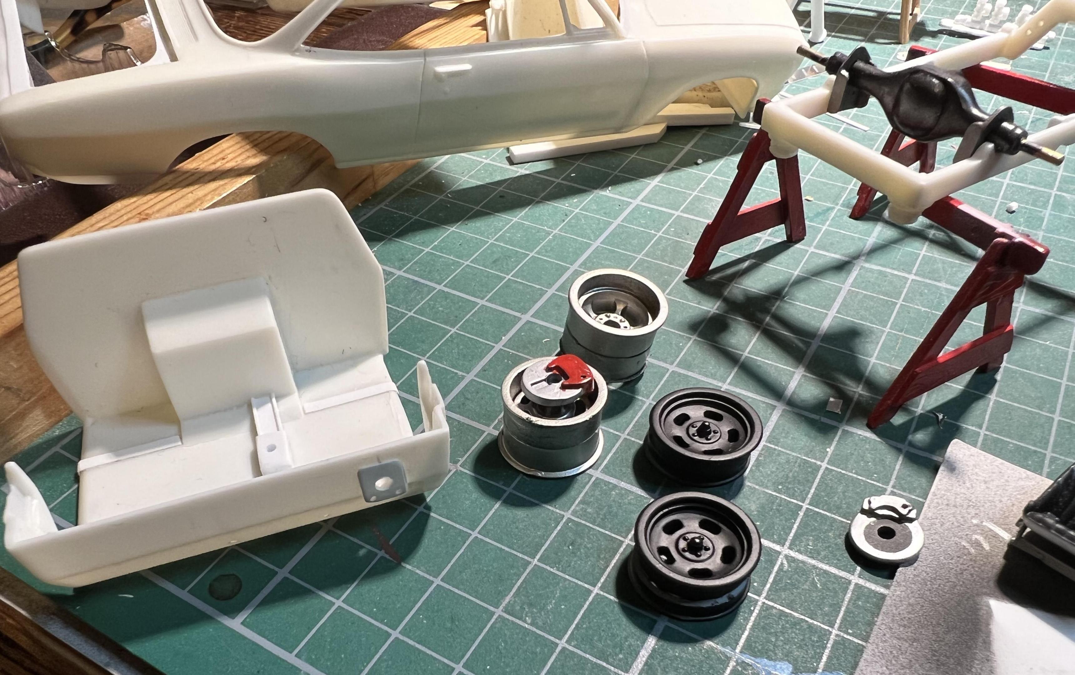

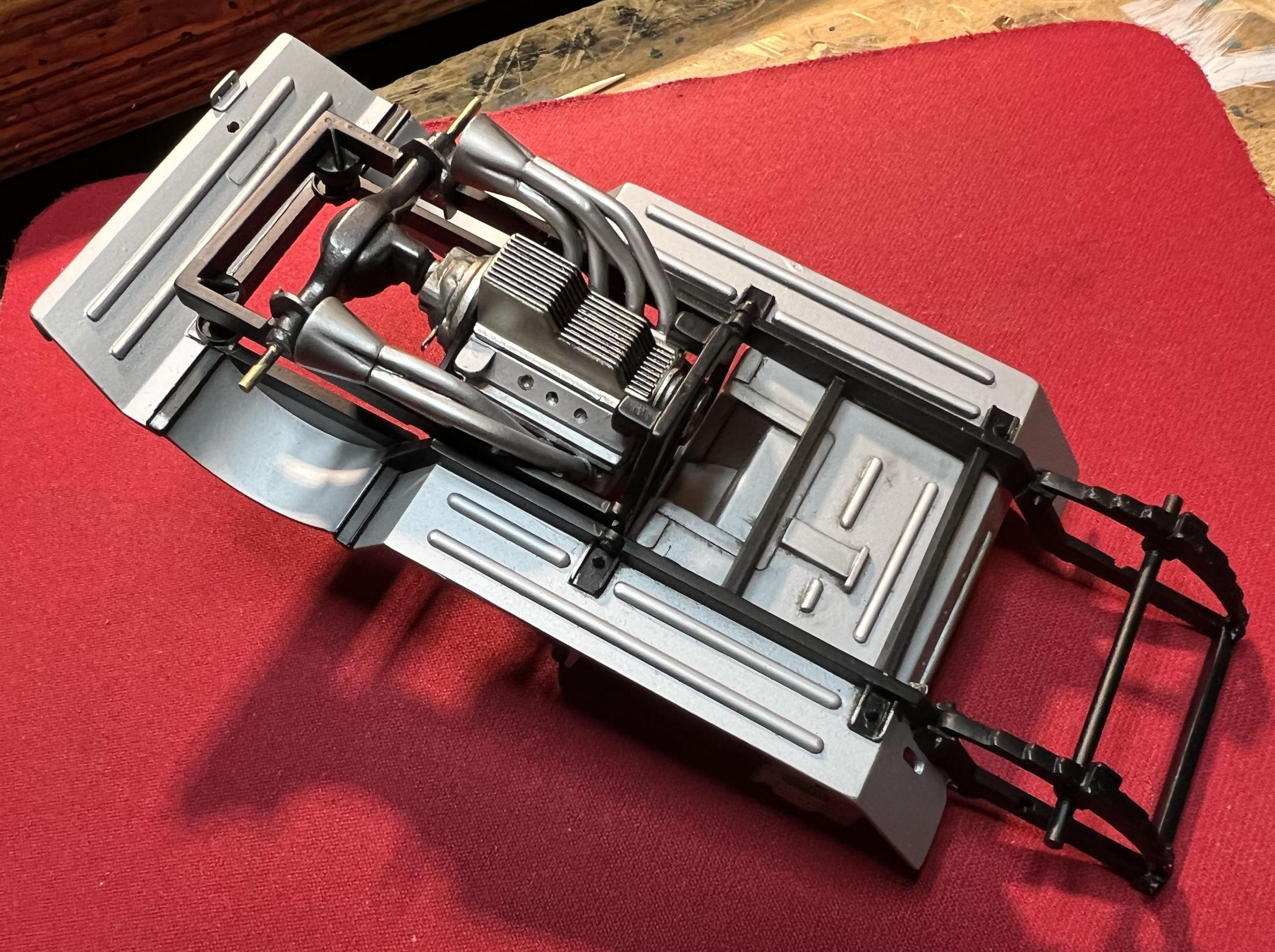

Have spent my workbench time split between it and the spray booth getting more assembly and paint on parts. Concentrated on the engine cradle getting it into shape by mocking up larger pieces. The rear axle is installed now awaiting brake lines, and the major engine components, except for the exhaust, have also been assembled. The next step will be wiring and fuel and water lines.
The chassis received its coat of semi gloss black LP 5 which will be masked off on the frame while the rest gets a dull aluminium finish (should I spray gloss black over the LP 5 before the metal finish?). After that some detail painting and further assembly of the smaller components onto the chassis. I’m quite happy with how the Chevy transplant is fitting in, mainly thanks to many mock ups with PVA glue to check measurements and clearances.
The body is now getting its interior sprayed, first with a sand colour to represent the fiberglass underside of the nose and the rear deck lid which is visible thru the aluminium frame that gives the piece its strength. Then remainder will be done in LP5 with aluminium door sides to complement the frame interior. Once all of that is accomplished I’ll move onto the exterior which will prove to be an interesting challenge!

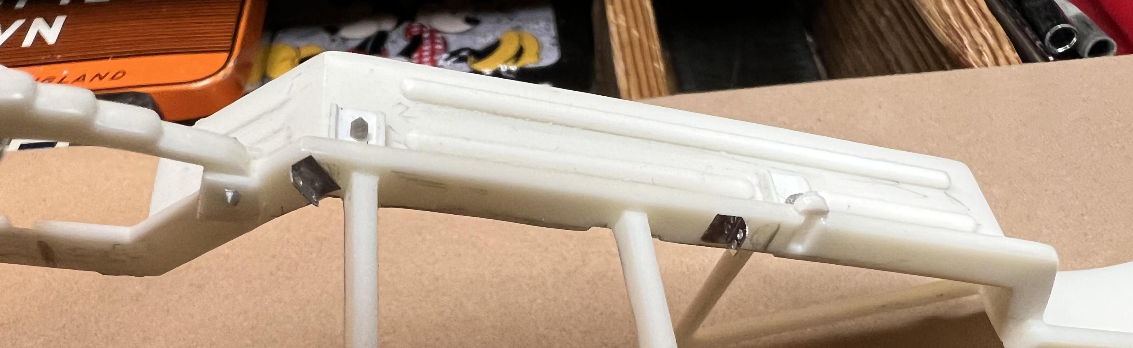

I like that you added supports inside the body so it actual rest on the chassis and not just held up by the top of the roll bar.

Thanks for checkin in JC & Steve ?

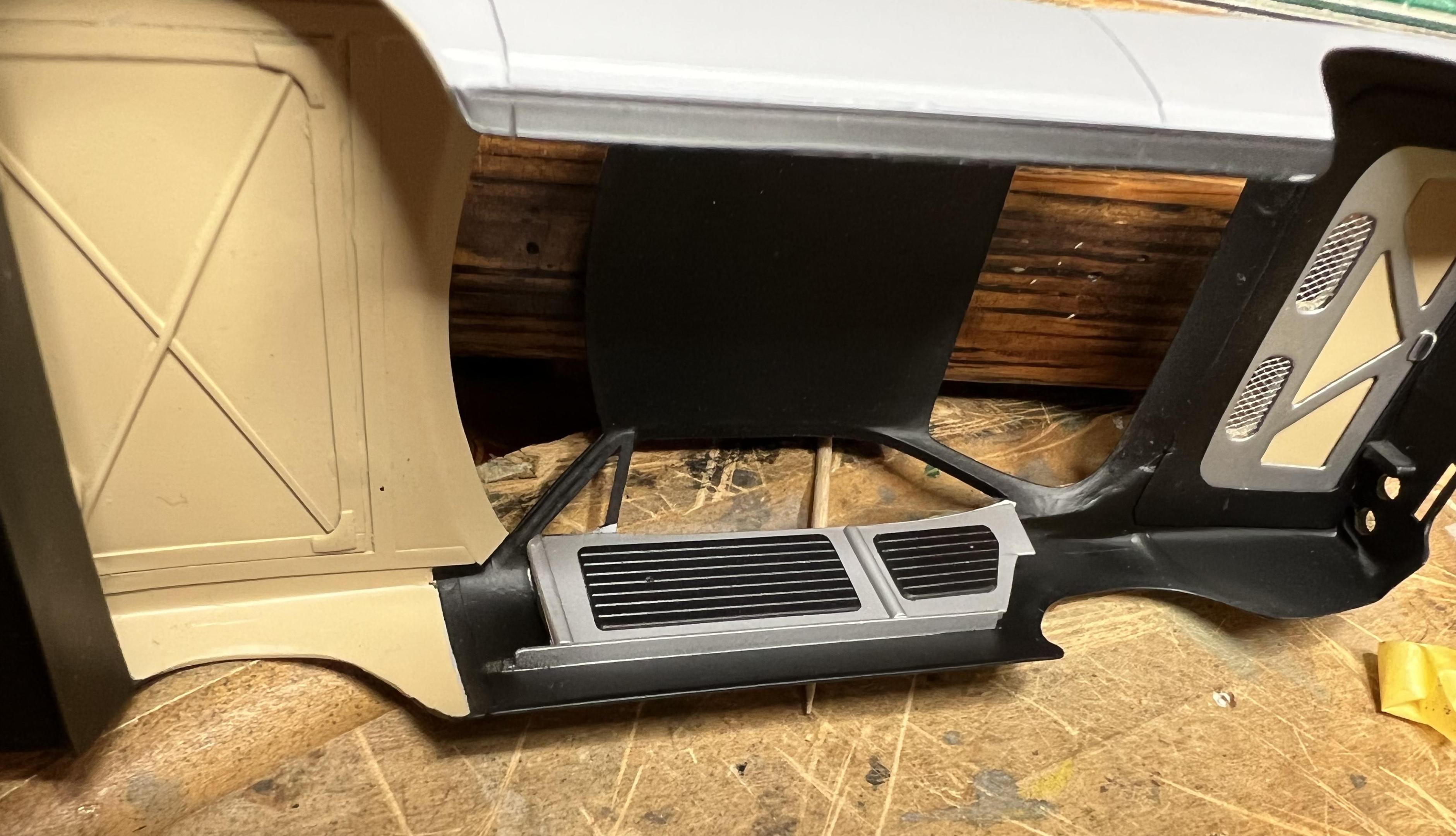

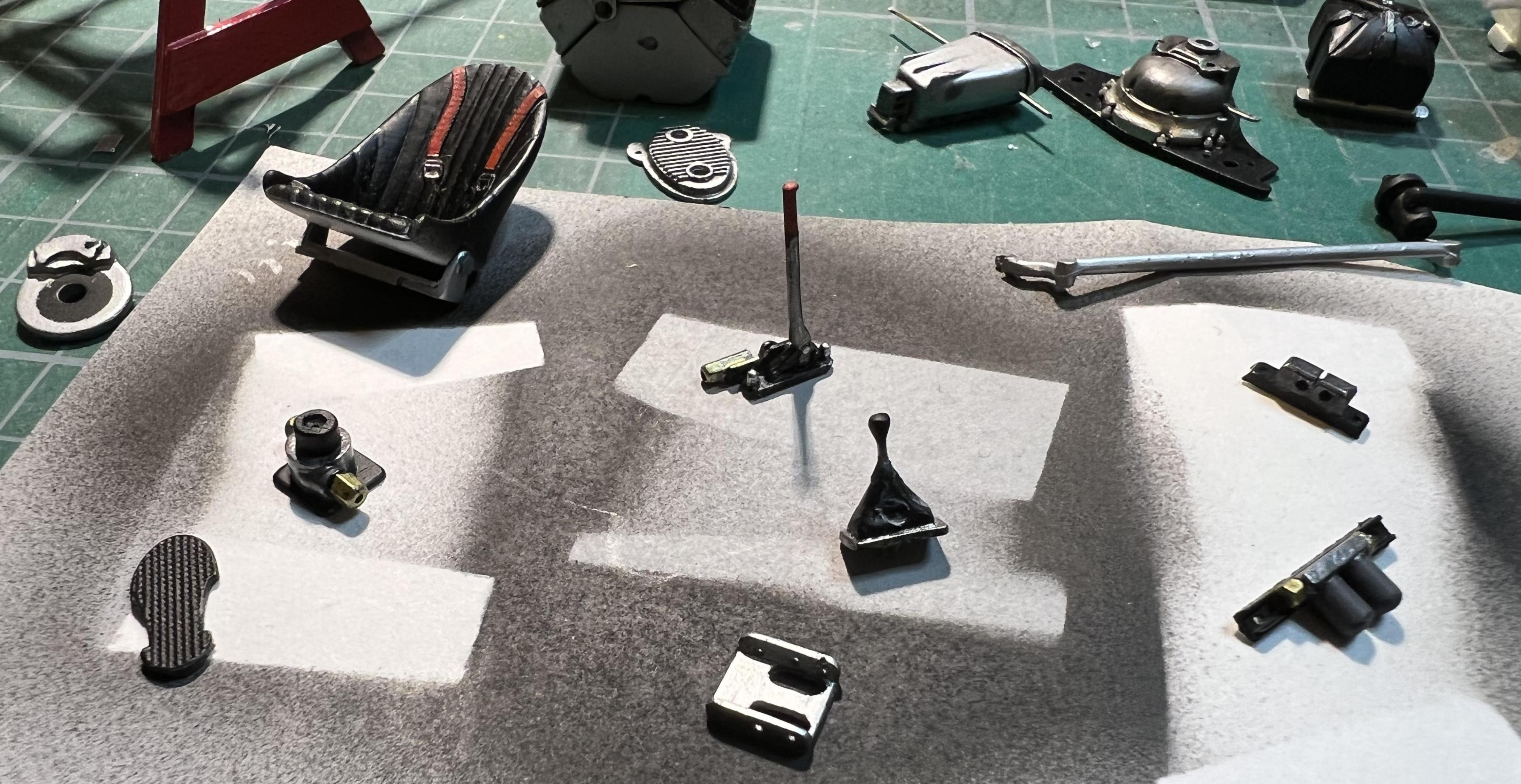

Spent time masking the interior for the semi-gloss black LP 5 and the rear panel with the trunk surround. Next step will have the door panels painted with aluminium and upholstery panels installed.

Mocked up the engine cradle one more time to check for fit and adjustment, again so far, ? so good!

An update from yesterday’s bench time. Finished spraying the interior of the body shell with the dull aluminium finish on the door panels, the upholstery panels are not installed yet, just positioned.

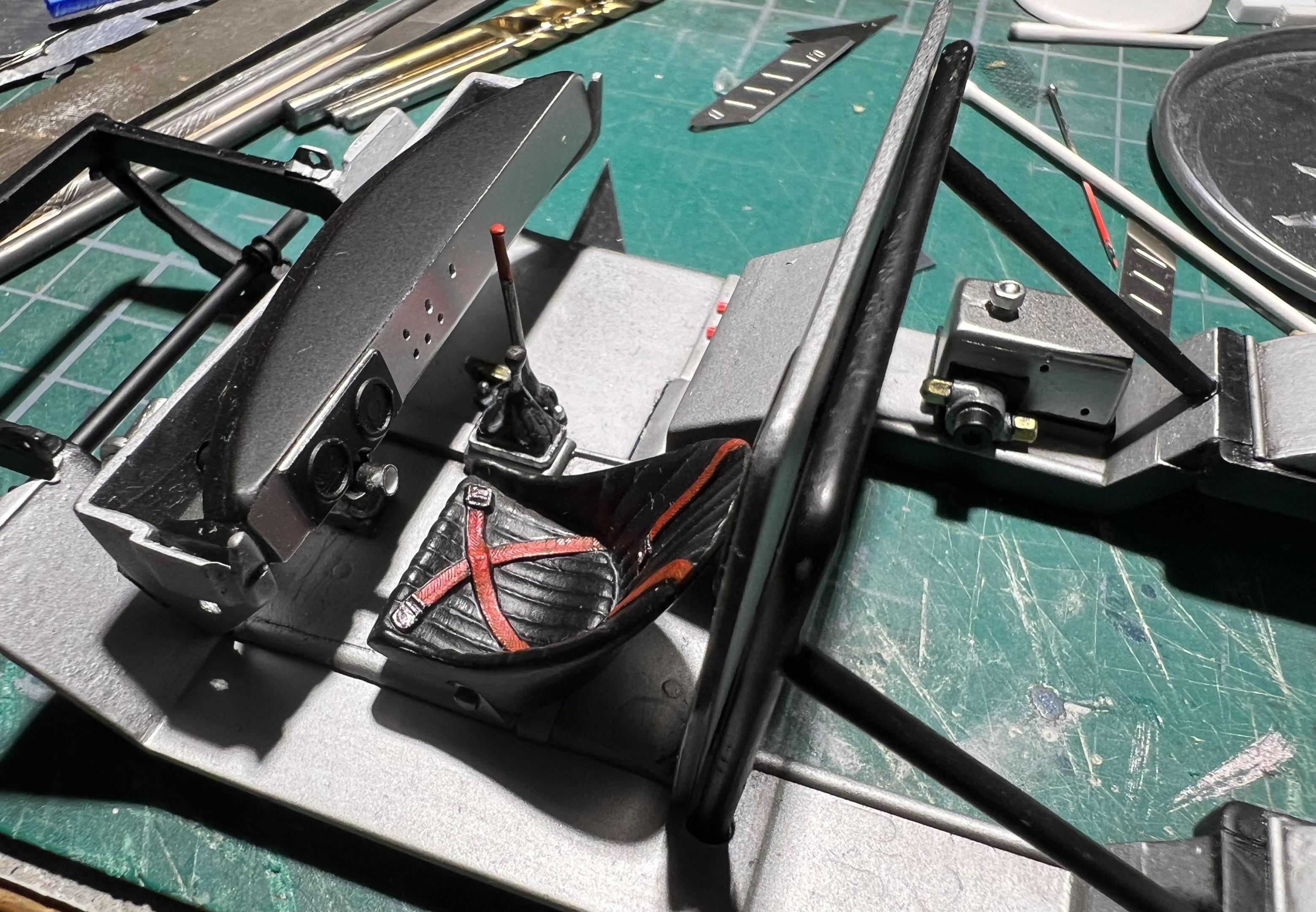

The cockpit also received the same aluminium finish and is ready to be further detailed. The parts are also just mocked up awaiting installation and wiring.

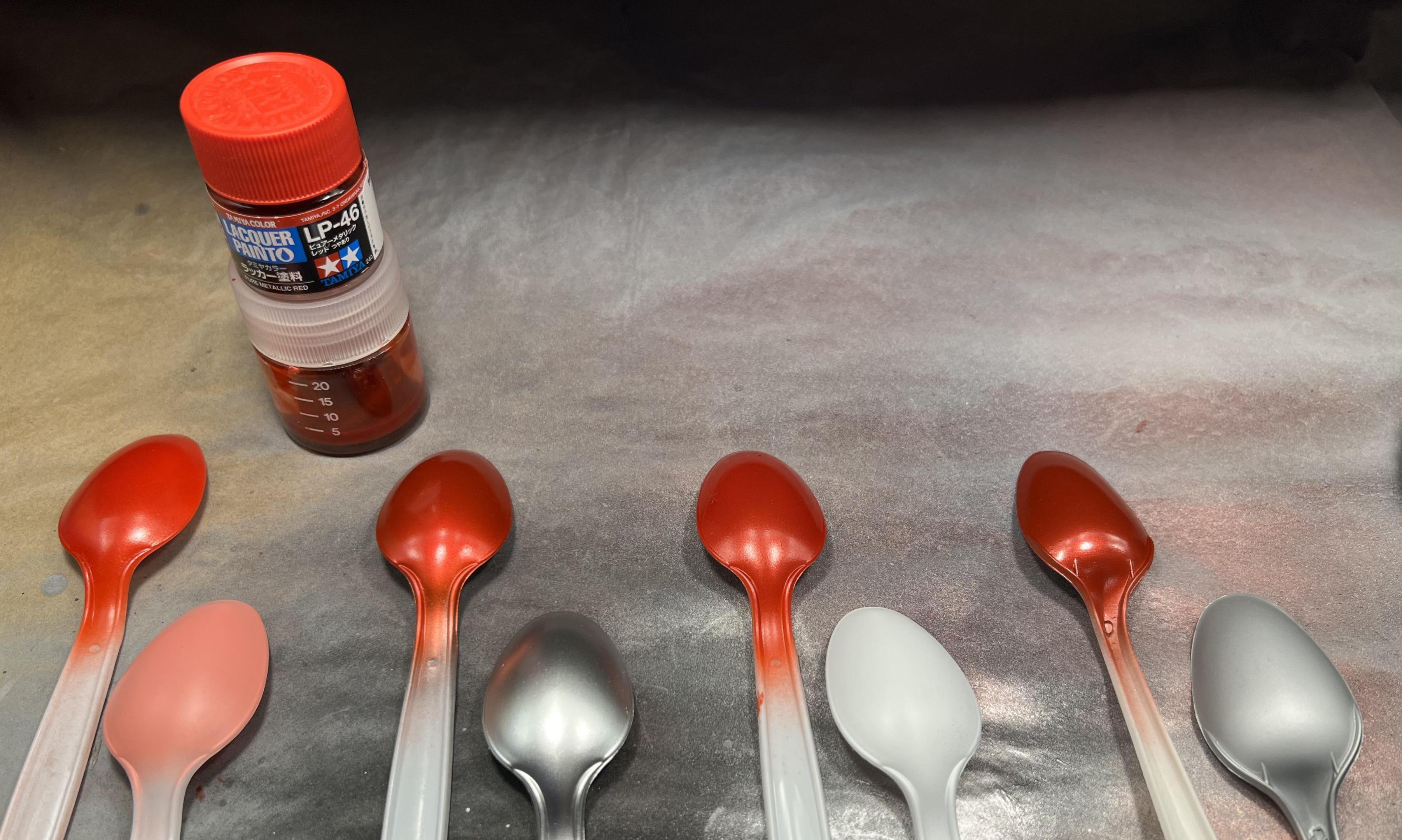

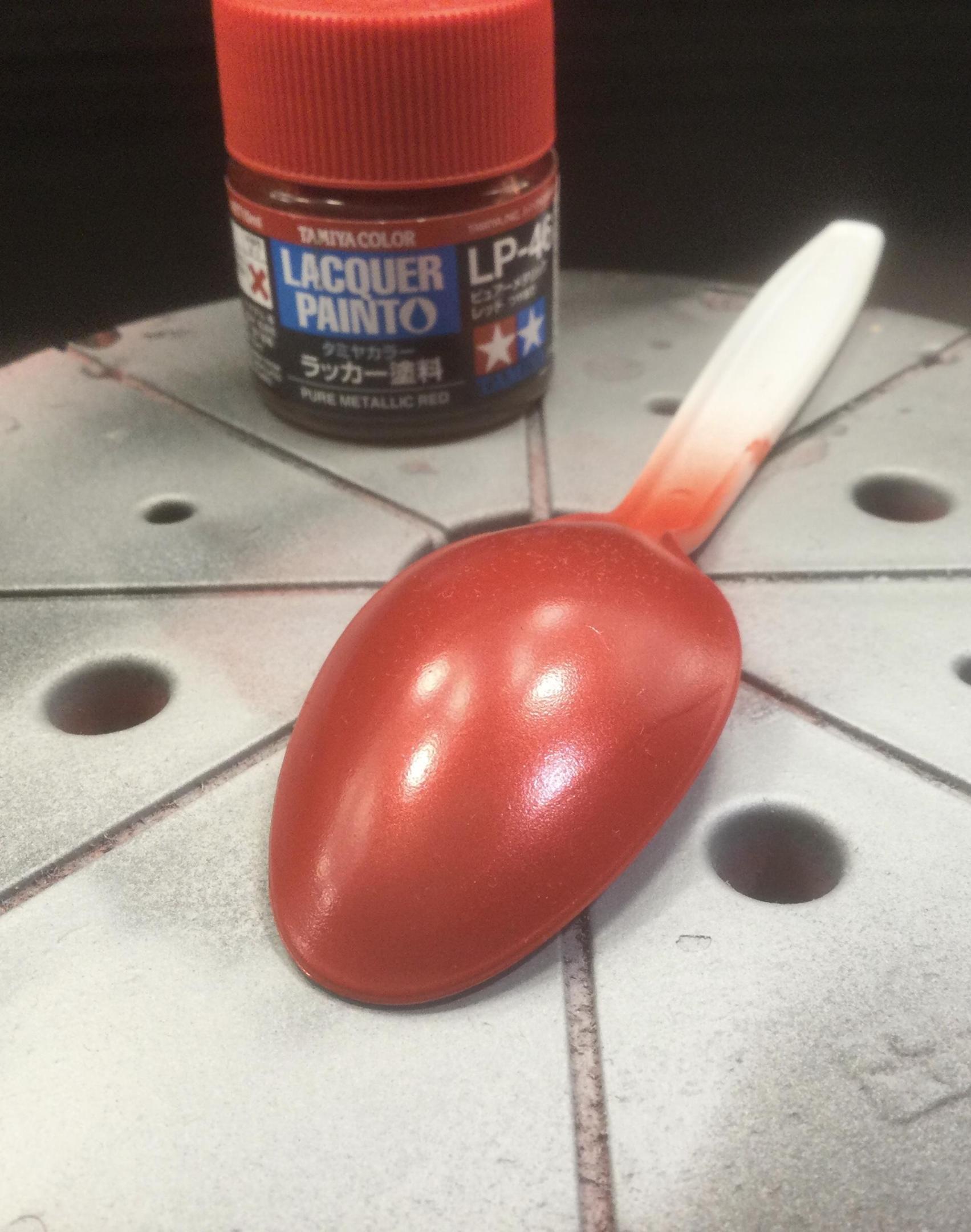

The exterior in now ready for its colour to be applied. Planning on white stripes with a pearl finish on top of am overall LP 46 Pure Metallic Red. The first spoon has the red over top of white primer, going to shoot a second one over top of LP 48 Sparkling Silver to see the change.

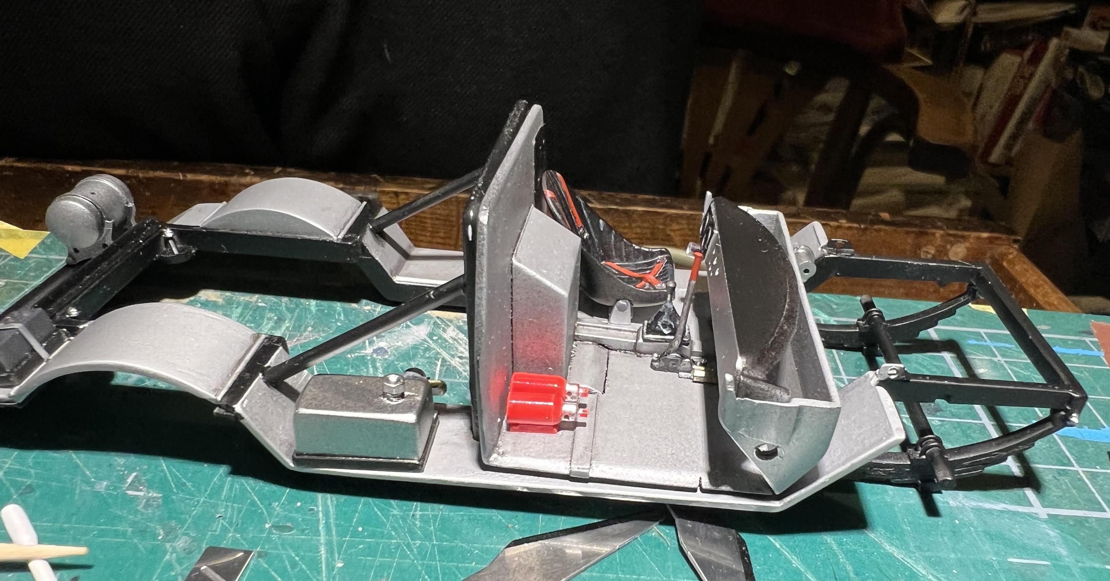

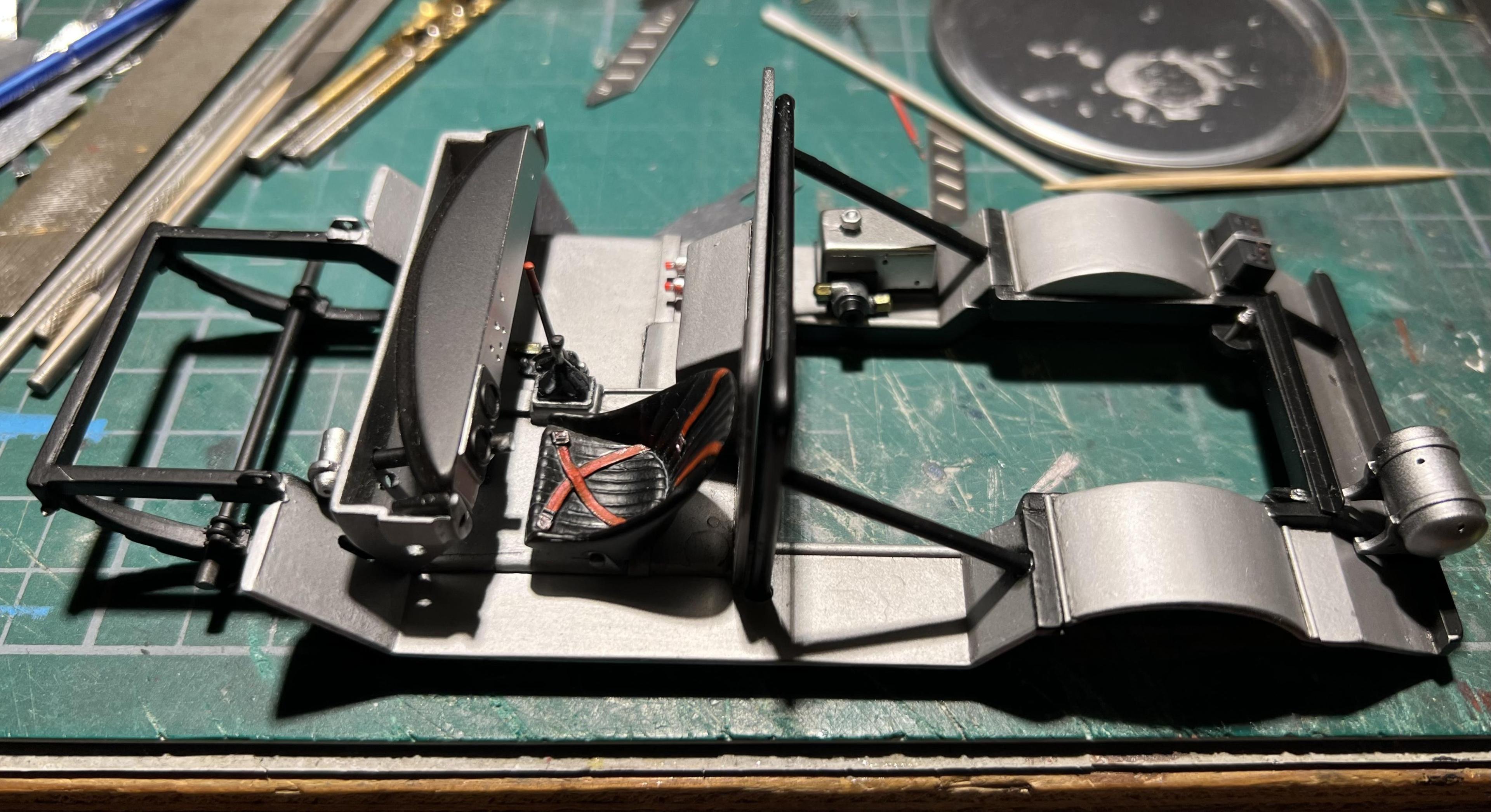

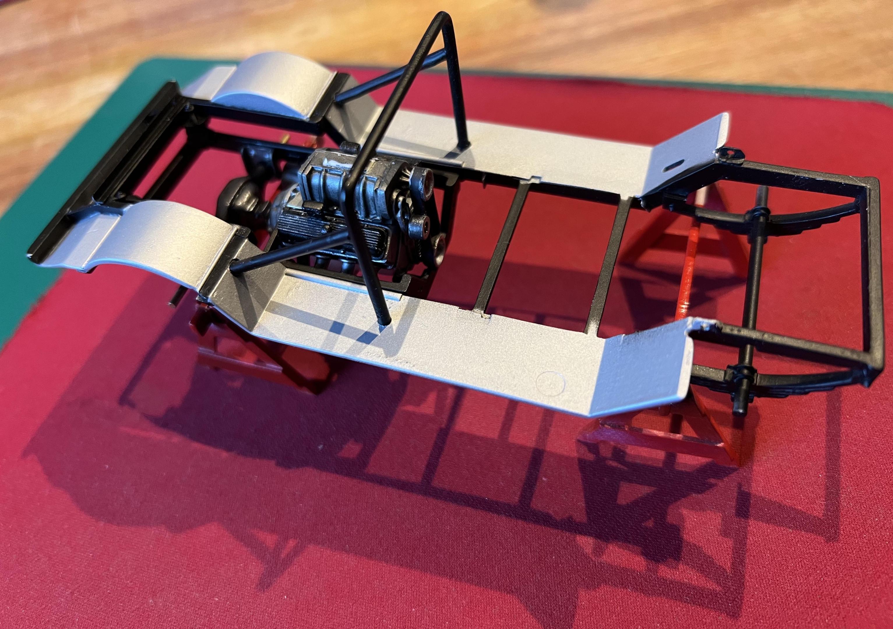

Spent a couple of evenings masking the frame rails in preparation for the aluminium treatment on the floor panels. Best part of masking is always removing all the bits to reveal the finish! All the time spent was well worth it as the chassis only requires a few touch ups with a brush, so I’m quite pleased with the result.
The next job will be to complete the engine cradle with a wired and plumbed engine, then onto the cockpit assembly. Getting closer!

Haven’t spent much time at the bench, yet couldn’t resist fitting the chassis into the body to see how it looks.
I did get a bit further with the interior now that most of the bits are painted and require mounting and having the appropriate wiring, switches, and belts installed. The assembly on the right side behind the firewall is the scratchbuilt water tank and pump, while the Moon tank is at the rear on the left and the small battery will be on the opposite side. Still a lot of work plumping and wiring to achieve back here.
In my search for the “preferred” colour for the updated box top scheme I settled upon Pure Metallic Red, LP 46 with white pearl stripes. To finalize the red a spoon test was run with various underpainting ranging from white primer to a couple of metallics. In the photo the lower line of spoons shows the base colour with the upper row having the LP 46 applied.   From left to right, Pink Primer, LP 48 Sparkling Silver, White Primer, and LP 38 Flat Aluminum. Over the white primer the colour didn’t have the bounce from the metalflake, this was helped by using the pink primer which gave the colour much more sparkle and liveliness, yet still short of what I had in mind. Mistakenly reaching for the flat aluminium, the red improved dramatically while remaining rather dark, perhaps a good Porsche colour to keep in mind. Realizing my error, I finally sprayed the red over the Sparkling Silver, bingo!
