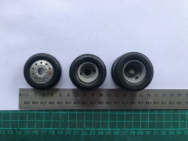

CharlieBravo Posted April 16, 2020 Posted April 16, 2020 (edited) Hi Guys, I'm Having a real hard time deciding on rim size for my 1/25 Kenworth Aerodyne BJ build and I need some expertise please. I thought it would be as easy as 1/25 scale rig/trailer - 1/25 rims. I'm using the 1/25 Revell Aerodyne and the 1/25 ERTL Reefer. To be honest the kit rims on the 1/25 trucks seem too small to me. They measure out to be 23.5mm in diameter. Can anyone answer whether the K-100 from Factory and particularly the BJ and the Bear Kenworth had 22.5 or 24.5 inch Alcoa rims? Was one a standard factory option over the other? In 1/25 scale that would measure out to be roughly 22.8 or 24.8mm in size. Kit rims are 23.5mm. I do have some nice aluminium rims that are 1/24 and measure out to be 26.7mm. Although the scale would dictate to use 1/25 rims, my eye tells me different in that the 1/24 scale rims might look better? Does anyone have experience fitting 1/24 rims to 1/25 trucks? There seems to be quite a size difference. Using 1/24 rims will result in width issues. I've tried to do a bit of a side on comparison with a Revell rig but note the height of the picture is not uniform in both pics so that could alter the view and I don't really know what i'm doing! opinions? cheers. chris Edited April 16, 2020 by CharlieBravo

KJ790 Posted April 17, 2020 Posted April 17, 2020 As mentioned, the real truck had 24.5" rims. This measurement is taken at the bead of the tire, so the actual outside diameter of a real rim will be larger than 22.5 or 24.5 inches respectively. The aftermarket rims from Moluminum are perfectly in scale, he offers both 22.5" and 24.5" rims. Doug Wagner also offers machined aluminum 24.5" rims in 1/25 scale that are perfectly to scale. If you want the most accurate looking build to the real thing, I would say use Doug's aluminum wheels. It is an expensive option, but it is the most accurate way to go. Moluminum's resin wheels would be my next choice.

peteski Posted April 19, 2020 Posted April 19, 2020 While in 1:1 world the tire size is measured on the inside of the bead, in the modeling world we really need to know what the visible diameter of the rim is. I do that for passenger car wheels and it would be nice if this info was provided by aftermarket manufacturers (for both the tire and rim). Also, some model rims do not have any lip, others do. Same goes for model tires. That complicates trying to find the right wheel/tire combo. In passenger tires/wheels, the larges visible rim diameter is about 1.5" larger than the specified 1:1 tire diameter. So a 1:1 16" wheel will really have 17.5" diameter visible outside of the tire. If the same holds true for trucks (I suspect that it does, then a 22.5" rim would actually have visible diameter of 24" and a 24.5" rim would have visible diameter of 26". That would be respectively 1" in 1:24 scale; 0.96" in 1:25 scale, and 1.08" in 1:24 scale; 1:04" in 1:25 scale. It would be very helpful if aftermarket manufacturers provided this type of dimensions to modelers. That way it would be easier to find matching rims and tires. American SATCO provided theses actual tire dimensions on their tire sets.
KJ790 Posted April 19, 2020 Posted April 19, 2020 12 hours ago, peteski said: While in 1:1 world the tire size is measured on the inside of the bead, in the modeling world we really need to know what the visible diameter of the rim is. I do that for passenger car wheels and it would be nice if this info was provided by aftermarket manufacturers (for both the tire and rim). Also, some model rims do not have any lip, others do. Same goes for model tires. That complicates trying to find the right wheel/tire combo. In passenger tires/wheels, the larges visible rim diameter is about 1.5" larger than the specified 1:1 tire diameter. So a 1:1 16" wheel will really have 17.5" diameter visible outside of the tire. If the same holds true for trucks (I suspect that it does, then a 22.5" rim would actually have visible diameter of 24" and a 24.5" rim would have visible diameter of 26". That would be respectively 1" in 1:24 scale; 0.96" in 1:25 scale, and 1.08" in 1:24 scale; 1:04" in 1:25 scale. It would be very helpful if aftermarket manufacturers provided this type of dimensions to modelers. That way it would be easier to find matching rims and tires. American SATCO provided theses actual tire dimensions on their tire sets. While I agree to some extent, it may make it even more confusing for some. Most of the model truck kits (AMT kits at least) come with older tube-type rims. These had a deeper lip, and were 20" or 22" when measured at the tire bead. For this reason, AMT tires are stamped as 20" or 22" on the sidewalls. In real life, when the switch to tubeless tires occurred, the lip on the rim became shorter, making a 22.5" tubless wheel equivalent to a 20" tube type, and a 24.5" tubeless wheel equivalent to a 22" tube type. In general, a 20" tube-type rim and a 22.5" tubeless rim will have an OD of approximately 24.5" while a 22" tube-type and a 24.5" tubeless rim will have an OD of approximately 26.5". The problem lies in that many people do not know the difference between tube-type and tubeless rims. Since many people want to use kit tires on aftermarket rims, many aftermarket manufacturers try to list the rim size to match the kit tire nomenclature, so they may call a 24.5" tubless rim a "22 inch rim" so that people know that AMT's 22" tires will fit on it.
peteski Posted April 19, 2020 Posted April 19, 2020 (edited) OK than, so it is not as clear-cut with truck wheels as it is with cars. With cars, the 1.5" size difference between the stated bead size, and outside rim diameter is pretty much given. I learned something new here - thanks. I was also wondering why trucks have odd size rims (like 22.5), instead of full numbers used on cars (15, 16, 18). But is seems that originally (with tube tires) rims did have full number sizes, and they gained the 0.5" when migrating to tubeless rims/tires. If that is accurate, it makes sense to me now. Edited April 19, 2020 by peteski

DrKerry Posted April 22, 2020 Posted April 22, 2020 So on the Bear build I found out that rear wheels from a Freightliner Kit and the front wheels from a KW Aerodyne are close to what the Bear rig is.. Thinking that’s the way I’m going with mine. My buddy and I are ordering 22 inch resin 2 hole Buds, him for two trucks and trailers, me just for the trailer for my Bear build..
Force Posted April 22, 2020 Posted April 22, 2020 (edited) It depends on how close to the real thing you want your model to be, the real BJ truck has 24.5 inch tubeless wheels and the AMT White Freightliner wheels are 22 inch lock ring style wheels for tube tires and they look different, the rims for tube tires are flat and the rims for tubeless tires has a dip in the center of the rim wich is there so you can put the tire on the rim as the outside diameter of the rim is larger than the inside diameter of the tire bead. But of course it's up to you what you want to use. Here is a picture to explain what I mean. I myself would go for the 22 inch 10-hole wheels Mo'luminum has on his website as they have the right look, the size on them says 22 inches but as they are tubeless style one piece wheels they have to be 24.5 inches and not 22, or one can go the more expensive way and get real aluminum wheels...but the resin wheels are a lot cheaper as you get 10 wheels for the same price as 2 aluminum wheels costs. I don't know why Jamie has marked his tubeless wheels 20 and 22 inches when the sizes of real tubeless wheels are 22.5 and 24.5 inches, maybe it's to tell that the wheels will fit 20 and 22 inch kit tires. Edited April 24, 2020 by Force
