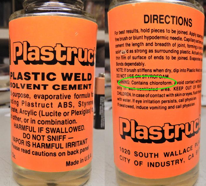

peteski Posted April 20, 2020 Posted April 20, 2020 6 hours ago, StevenGuthmiller said: Plastistruct Plastic Weld is a MEK based product. Steve The reason I stated what I did was because I looked at the label on my bottle. My Plastic Weld doesn't smell anything like MEK (I know the smell from sniffing Testors Liquid Cement, and the quart-size can of MEK I have in my workshop. Just kidding - I don't sniff this stuff, but I do what MEK smells like. Anyway, as you can see that the label mentions no MEK either. But granted, the bottle is at least 15 years old - maybe Plastuct changed their Plastic Weld Formula?
StevenGuthmiller Posted April 20, 2020 Posted April 20, 2020 2 hours ago, peteski said: The reason I stated what I did was because I looked at the label on my bottle. My Plastic Weld doesn't smell anything like MEK (I know the smell from sniffing Testors Liquid Cement, and the quart-size can of MEK I have in my workshop. Just kidding - I don't sniff this stuff, but I do what MEK smells like. Anyway, as you can see that the label mentions no MEK either. But granted, the bottle is at least 15 years old - maybe Plastuct changed their Plastic Weld Formula? I just got this bottle in the mail last Friday. Steve
peteski Posted April 20, 2020 Posted April 20, 2020 Since we both have proof of what we stated, then obviously Plastuct changed their formula. And for the cheapskates in us, MEK can be purchased at hardware stores in large quantities. I bought a quart container and it is much more economical than buying those expensive tiny hobby bottles of glue. I think MEK might be banned in some States in the U.S. but I found it in my hardware store in Mass.

Ace-Garageguy Posted April 21, 2020 Posted April 21, 2020 Note the orange bottle front label also states it bonds "Plastruct ABS". This was the source of the confusion in an earlier liquid glue thread. "Plastruct ABS" is not, in my experience, as solvent resistant as what are commonly referred to as "engineering grades" of ABS that many consumer products are made from. The original poster in that particular thread was wanting to repair the door on a microwave, and I recommended Plastruct's Bondene (methylene chloride) for that application, as it's labeling includes generic ABS.
peteski Posted April 21, 2020 Posted April 21, 2020 (edited) 8 hours ago, Ace-Garageguy said: Note the orange bottle front label also states it bonds "Plastruct ABS". This was the source of the confusion in an earlier liquid glue thread. "Plastruct ABS" is not, in my experience, as solvent resistant as what are commonly referred to as "engineering grades" of ABS that many consumer products are made from. The original poster in that particular thread was wanting to repair the door on a microwave, and I recommended Plastruct's Bondene (methylene chloride) for that application, as it's labeling includes generic ABS. Methylene Chloride is a very potent solvent for *ANY* type of Polystyrene and acrylic. I still have *REALLY* hard time believing that it would not instantly melt any formulation of ABS. And my 16-year-old bottle of Plastuct Bondene lists Dichloromethane (not MEK) as it's contents. I can take a photo if you don't believe me. And neither Dichloromethane, nor MEK are anywhere as potent as Methylene Chloride. Edited April 21, 2020 by peteski
Ace-Garageguy Posted April 21, 2020 Posted April 21, 2020 (edited) 2 hours ago, peteski said: Methylene Chloride is a very potent solvent for *ANY* type of Polystyrene and acrylic. I still have *REALLY* hard time believing that it would not instantly melt any formulation of ABS. And my 16-year-old bottle of Plastuct Bondene lists Dichloromethane (not MEK) as it's contents. I can take a photo if you don't believe me. And neither Dichloromethane, nor MEK are anywhere as potent as Methylene Chloride. Here we go again. Methylene chloride IS dichloromethane. Same thing. CH2Cl2 Bondene. WHITE BOTTLE. Reasonably effective on garden variety ABS. Labeled as such. CHEMICAL REFERENCE: https://pubchem.ncbi.nlm.nih.gov/compound/Dichloromethane Stronger solvent than MEK MEK is Plastruct's Plastic Weld. ORANGE BOTTLE. Works on Plastruct's wimpier version of ABS. Labeled as such. Which is what I said last time (other than the reference to Plastruct's version of ABS). NOTE: ABS FORMULATIONS HAVE VARYING DEGREES OF SOLVENT RESISTANCE. SOLVENT "ADHESIVES" ALSO HAVE VARYING DEGREES OF CONCENTRATION OF THE PRIMARY SOLVENT IN THE COMMERCIAL MIXTURE, WHICH MAY CONTAIN INACTIVE DILUENTS. GREATER OR LESSER CONCENTRATIONS OF THE PRIMARY SOLVENT WILL HAVE A MARKED EFFECT ON THE STRENGTH OF THE "ADHESIVE" AND ITS ABILITY TO SOFTEN WHAT IT'S APPLIED TO. Edited April 21, 2020 by Ace-Garageguy
peteski Posted April 21, 2020 Posted April 21, 2020 47 minutes ago, Ace-Garageguy said: Here we go again. Methylene chloride IS dichloromethane. Same thing. CH2Cl2 Bondene. WHITE BOTTLE. Reasonably effective on garden variety ABS. Labeled as such. CHEMICAL REFERENCE: https://pubchem.ncbi.nlm.nih.gov/compound/Dichloromethane Stronger solvent than MEK MEK is Plastruct's Plastic Weld. ORANGE BOTTLE. Works on Plastruct's wimpier version of ABS. Labeled as such. Which is what I said last time (other than the reference to Plastruct's version of ABS). NOTE: ABS FORMULATIONS HAVE VARYING DEGREES OF SOLVENT RESISTANCE. SOLVENT "ADHESIVES" ALSO HAVE VARYING DEGREES OF CONCENTRATION OF THE PRIMARY SOLVENT IN THE COMMERCIAL MIXTURE, WHICH MAY CONTAIN INACTIVE DILUENTS. GREATER OR LESSER CONCENTRATIONS OF THE PRIMARY SOLVENT WILL HAVE A MARKED EFFECT ON THE STRENGTH OF THE "ADHESIVE" AND ITS ABILITY TO SOFTEN WHAT IT'S APPLIED TO. I misunderstood your post - I thought you were *NOT* recommending Plastruct Bondene as adhesive for the "engineering grade" ABS. I think we are on the same page now.
