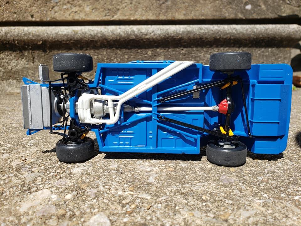

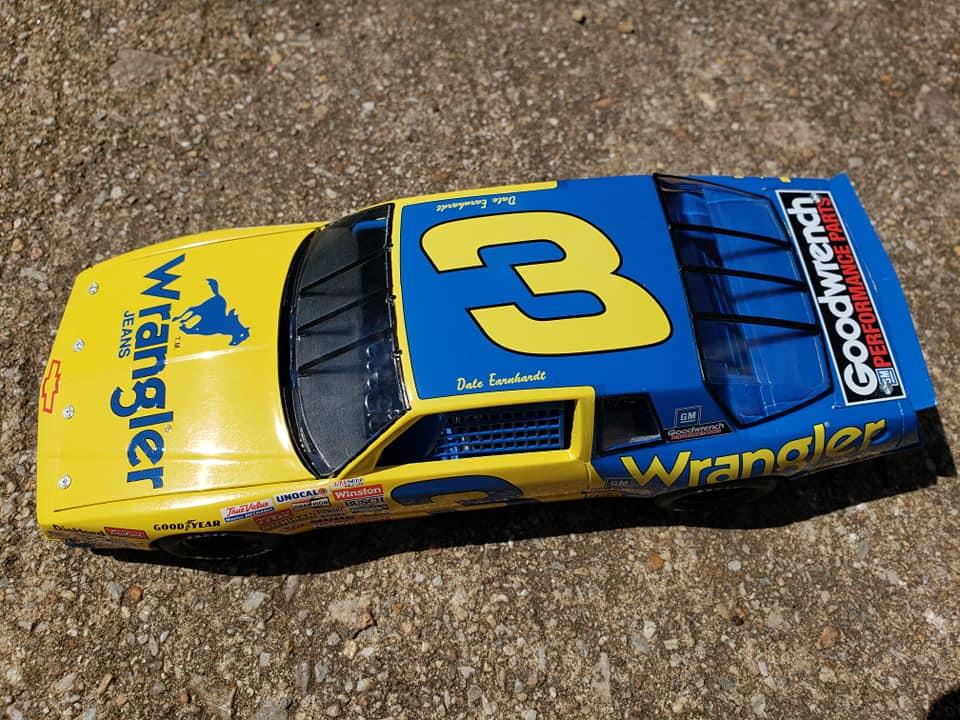

Was never really much of an Earnhardt fan but sure do miss the man. Racing to me, hasn't been the same since his death. Always thought about building as many of the championship car as I can so, naturally had to add this one. Glad I did. Really pleased with of this one turned out.
Started the Revell "Pass in the Grass" kit and ordered up a set of Powerslide decals. Went looking and researching what colors best matched the decals and found Rustoleum Sun Yellow and Brilliant Blue matched the best. Never used Rustoleum on a model before so I was alittle worried as to how it would turn out. Prepped the body sprayed the inside first Blue, then taped the inside up and sprayed the Yellow and then taped that and sprayed the Blue on the outside. A little polishing and pleased with it. Applied the decals and got excited to finish it up. Not perfect but very pleased with it. Now to see what else is in my stash that I can build fairly quickly during the "stay at home" order due to the virus. Trying to get what work done, help home school and some down time for myself, not easy.

Wow. It really pops.  How long did it take for the paint to dry before you could do the second color? In my experience Rust Oleum takes an eternity to dry.
Just a few days if I remember correctly. I had painted this back before winter and didn't get around to building it until now.
Great job, I have a couple Race cars to do and  not sure about all the decals , So you applied the decals over polished enamel and did you seal the decals with a clear coat or wax?
