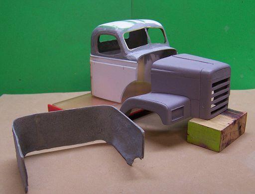

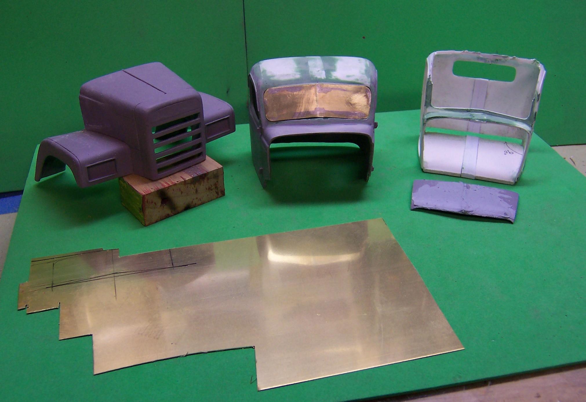

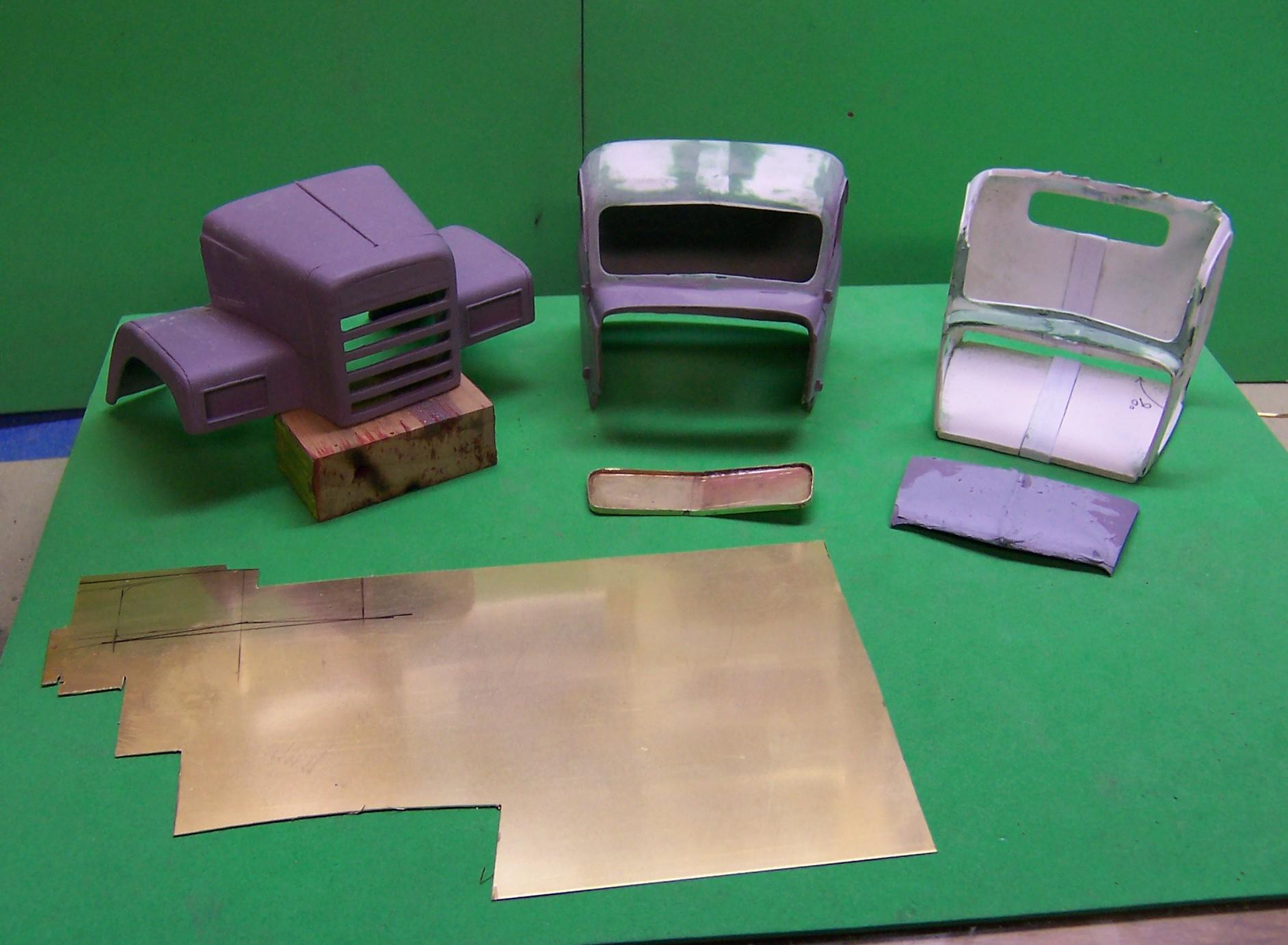

Chariots of Fire Posted April 21, 2020 Posted April 21, 2020 Now that the Mashpee rig is done I've gone back to a project that I introduced some time ago. It had me at a loss as to really go about rebuilding the casting because it was so poor. The time away from it gave me some added incentive to try again so here is the beginning. Here was the original casting. At this point the hood and fenders have been cut free and some modifications were begin on the location of the windshield. It was relocated more above the cowl and was given some V shape. To make a new windshield surround it was laid out on sheet brass, bent in the middle and a small strip of brass was soldered around the edge. The finished windshield surround is in the middle. The windshield was rough fit in the opening and then mounted securely with additional fitting and supergluing. Next was the lower cab sides. They were bowed in, very thin and not good to work with. So new sides were made up of plastic sheet stock and tubing. In the photo above the windshield has been opened up leaving in effect a brass angle completely around it. The angle will help hold the windshield glass in position. There are some relief sculpture lines on the cab but they are not quite as pronounced as what is in the photo. The lower ones need to be diminished quite a bit. The door panels have been filled in some and will be reshaped. The cowl is being reshaped with some putty and the fenders and hood have been roughed out. Renshape was used for the fenders and hood. It is great stuff to work with, having no grain, it sands and cuts easily in any direction but is very strong. I made paper templates of the hood and fenders and one of the fender templates is still in place on the right fender. The fenders were first cut out on a band saw and then sanded to the outer shape on a disk sander. The edges can be rounded by hand. The underside will be hollowed out using a Dremel and some sanding disks.

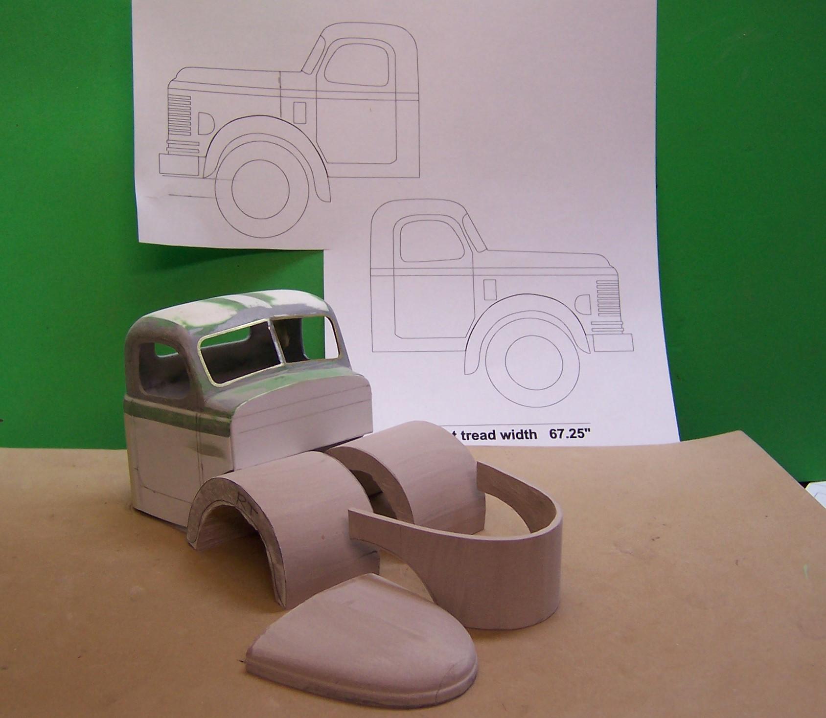

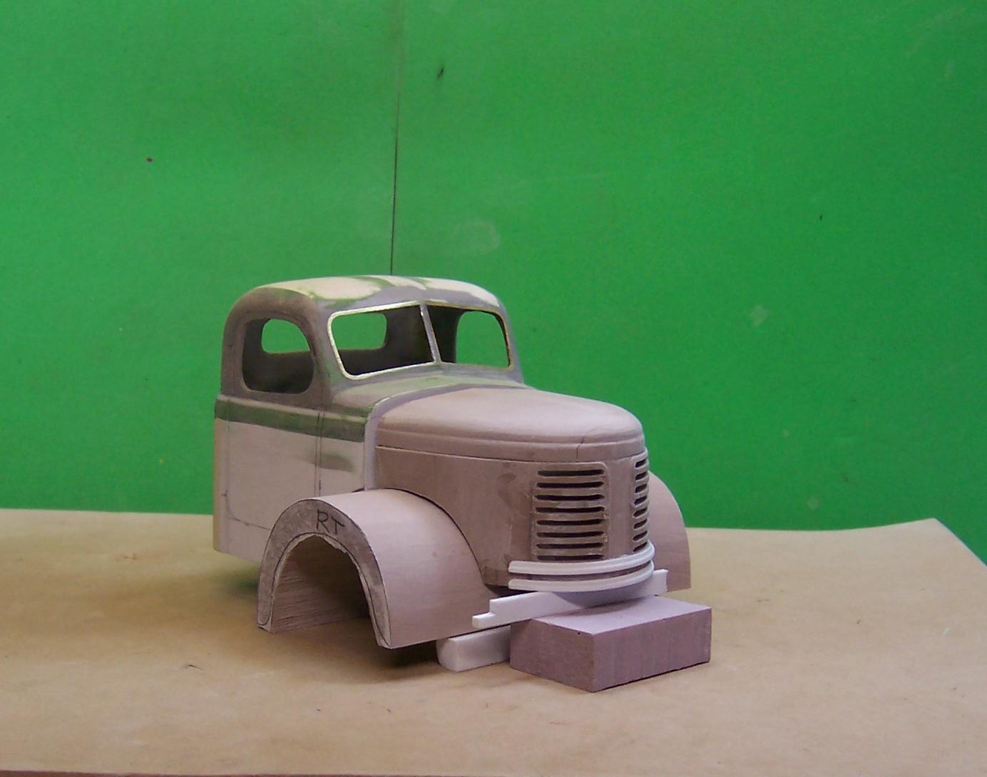

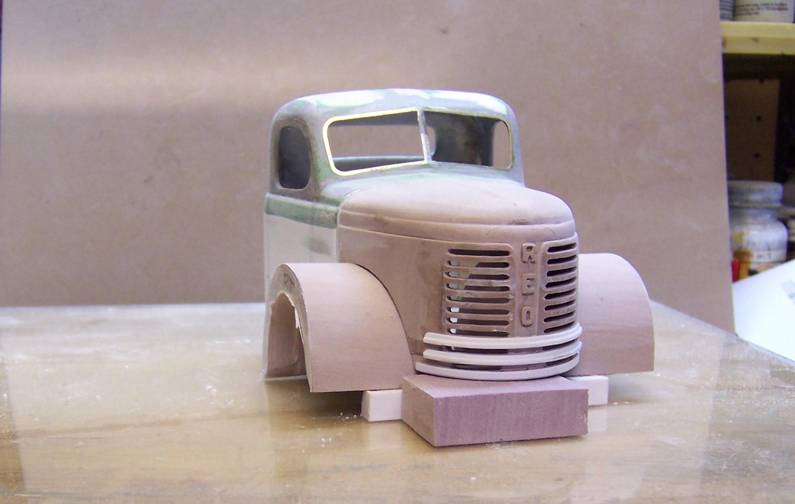

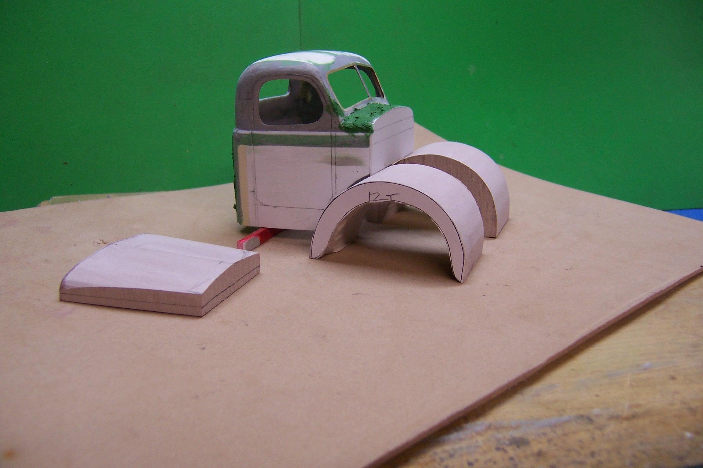

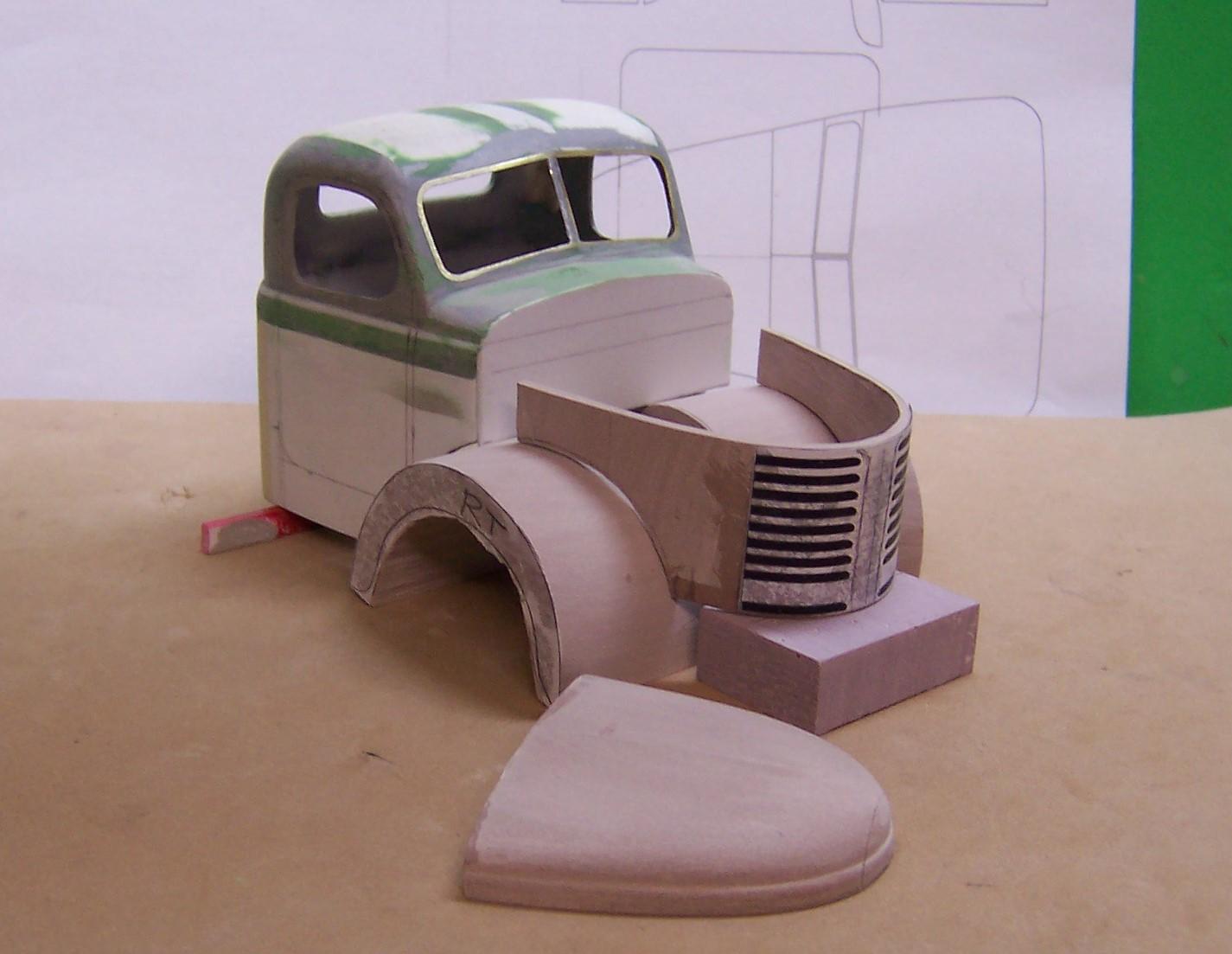

Chariots of Fire Posted April 22, 2020 Author Posted April 22, 2020 Not a lot going on today so there was more to do on the Reo. Hood was cut from Renshape the same as the fender blanks. The hood sides were also cut from that material which made it easy to shape the rounded front. Renshape is strong enough that I could cut out the grill area as well. The grill area was printed out on paper and glued to the nose. Then a cutting wheel was used to open up the slots. A small file was used to finish up the openings. There is still some fitting to do so that the cab and hood line up over the fenders. Next will be to round off the fenders on the outside and grind away the inner portion of the blanks to get the thinness of each fender.

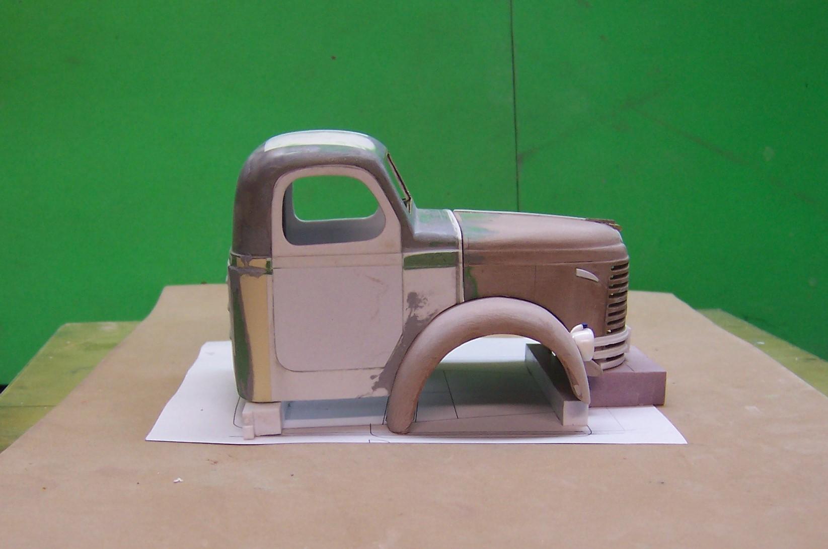

misterNNL Posted April 22, 2020 Posted April 22, 2020 Amazing work. I have the greatest respect for those capable of this level of scratch building. Are you using templates to be consistent from side to side?
Chariots of Fire Posted April 22, 2020 Author Posted April 22, 2020 Yes to templates. It's easy to do once I have the drawing of one side. In the graphics program I can flip the image and it creates it automatically in the opposite view. That's what you see in the third picture up from here.

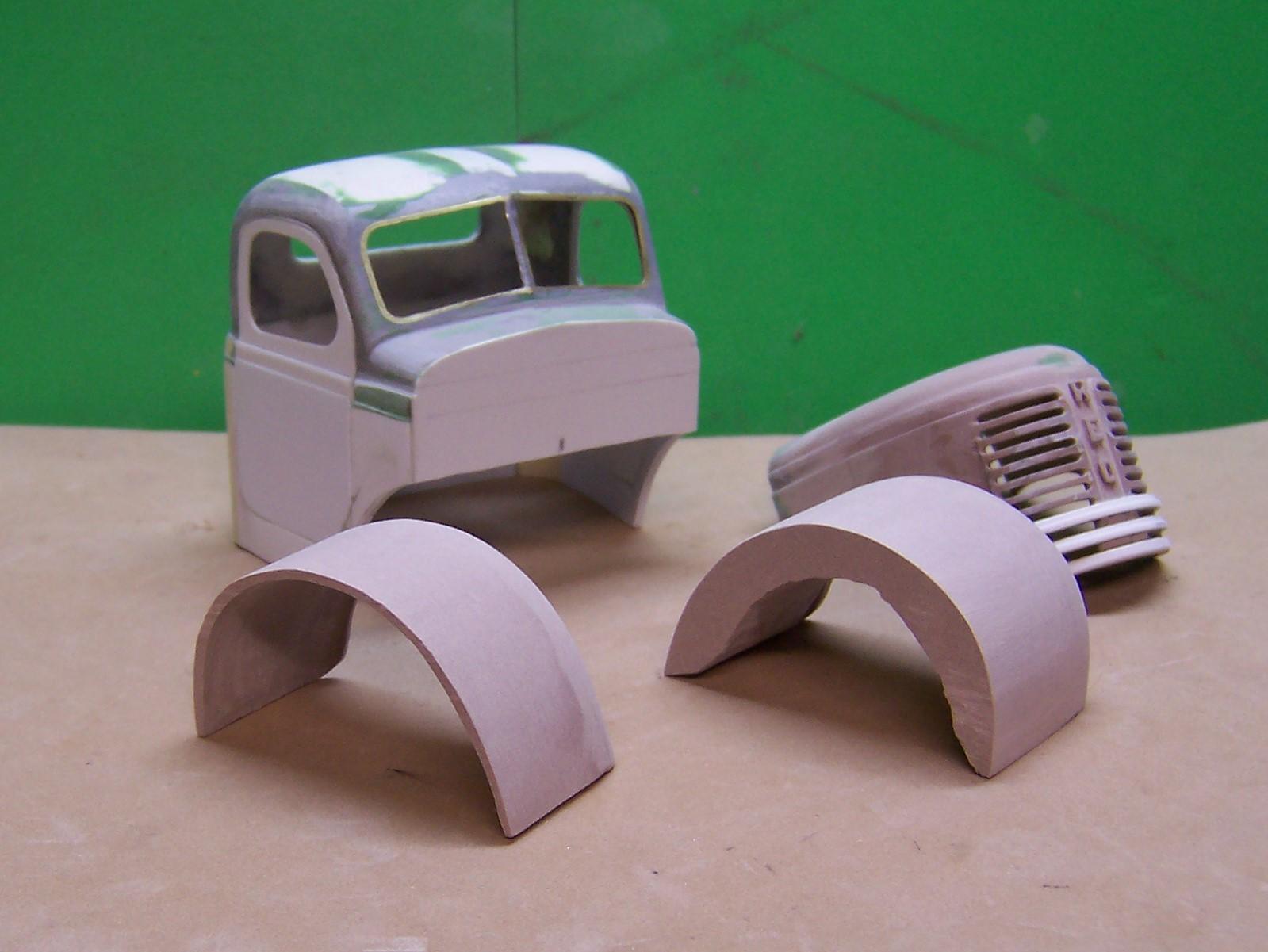

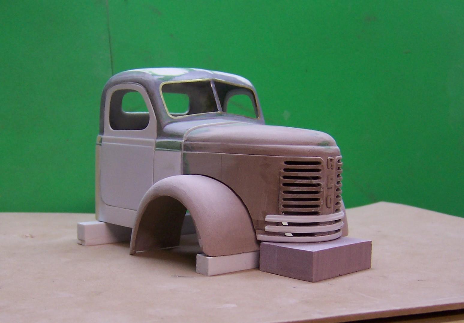

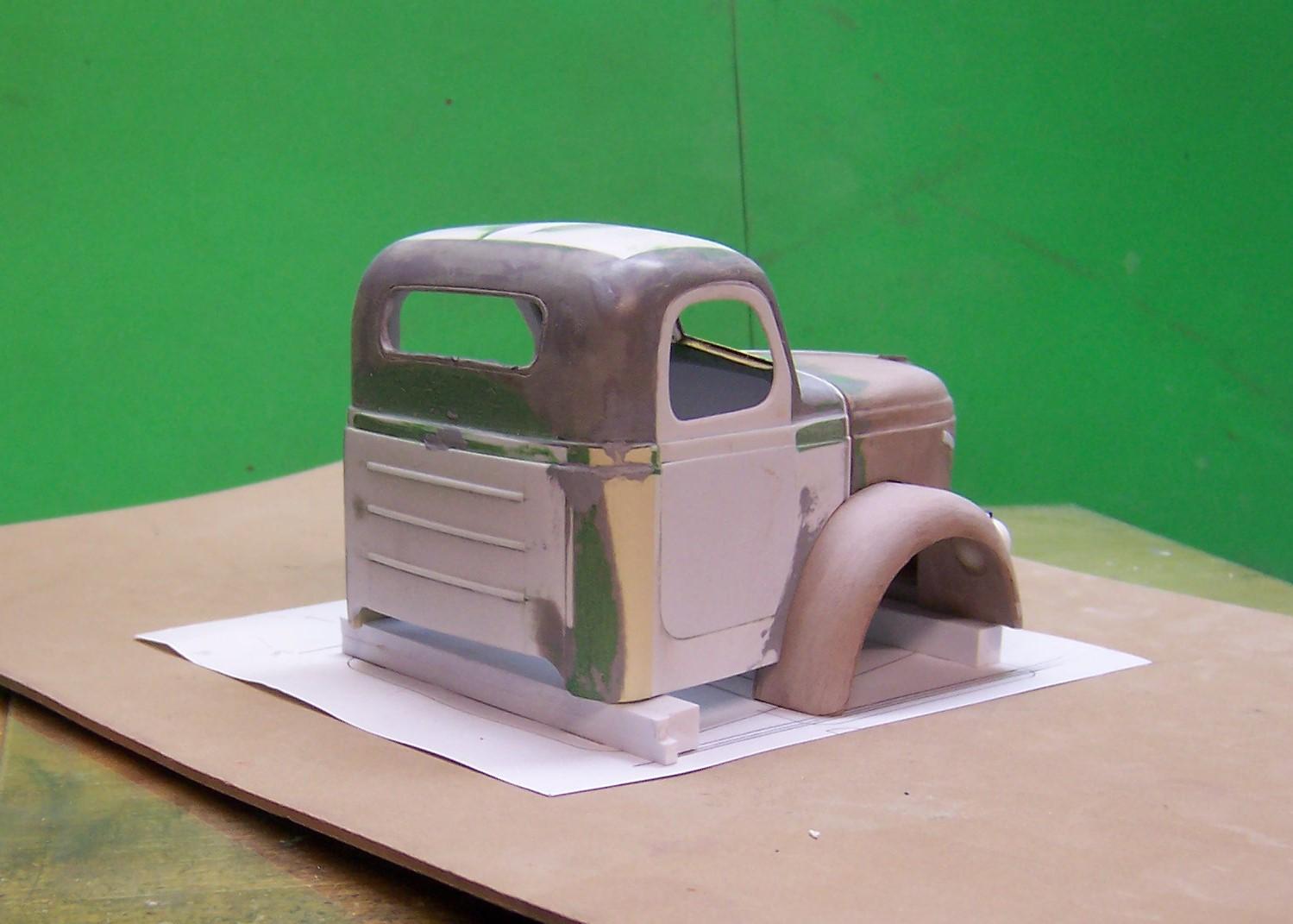

Chariots of Fire Posted April 22, 2020 Author Posted April 22, 2020 Here's an update. Next is to round off the fenders and begin to final fit the three pieces together.

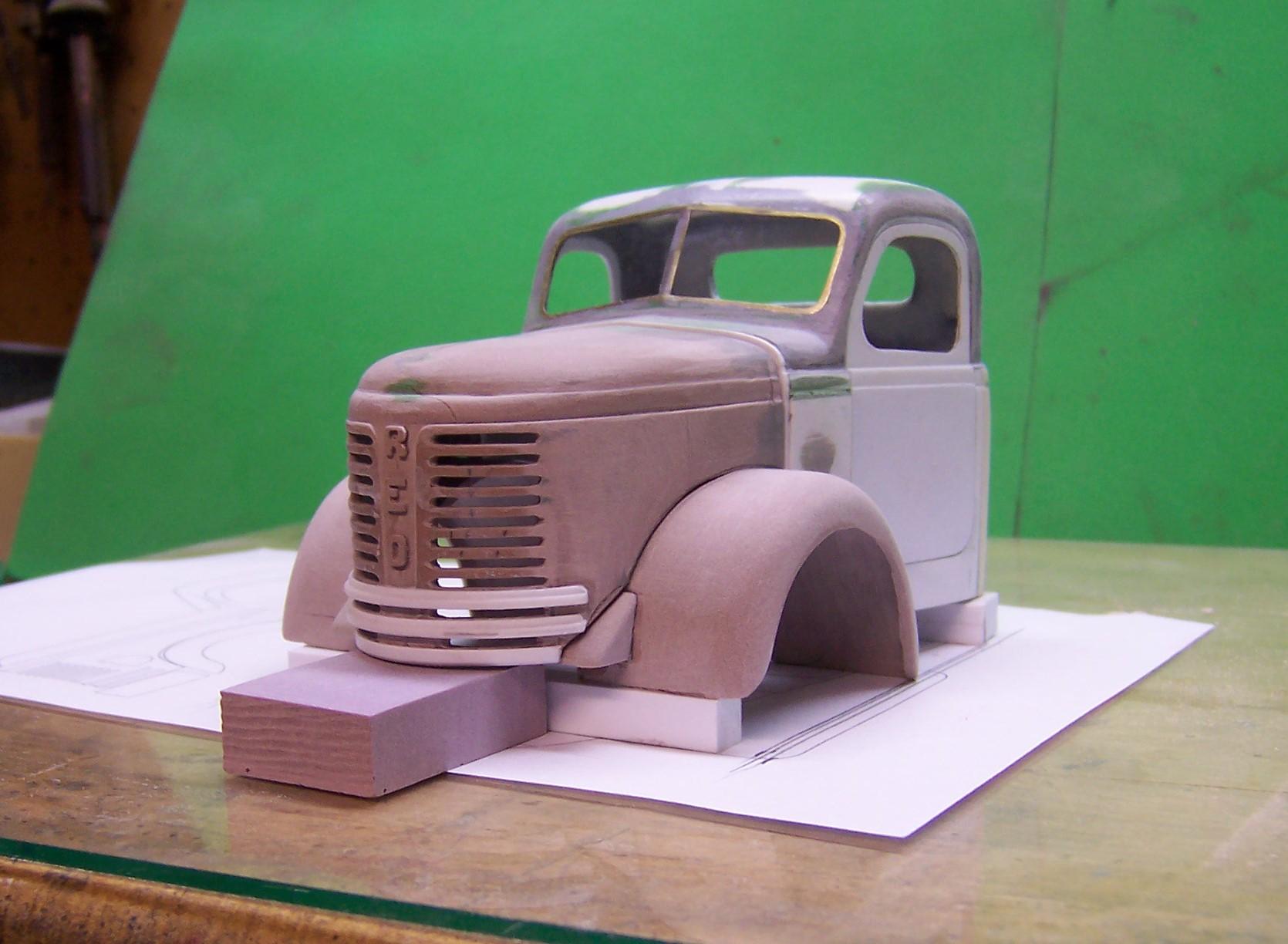

Chariots of Fire Posted April 26, 2020 Author Posted April 26, 2020 I watched the video. I really had my doubts that you were going to get that out of the woods with that little track machine. Like most things small there is persistence that pays off! Here's an update on the Reo. I know I said it is a 57 but it actually is a 53 that I am modeling. Not a lot of difference but it still should be accurate. Fenders are now hollowed out and rounded. Cab and hood fitting is coming along.

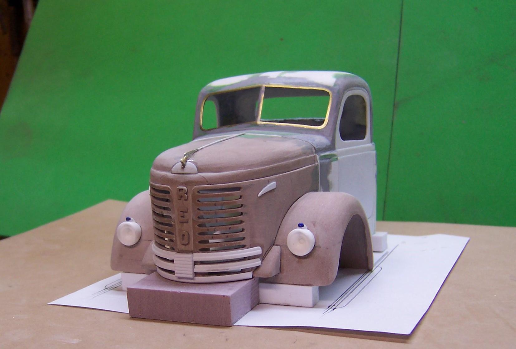

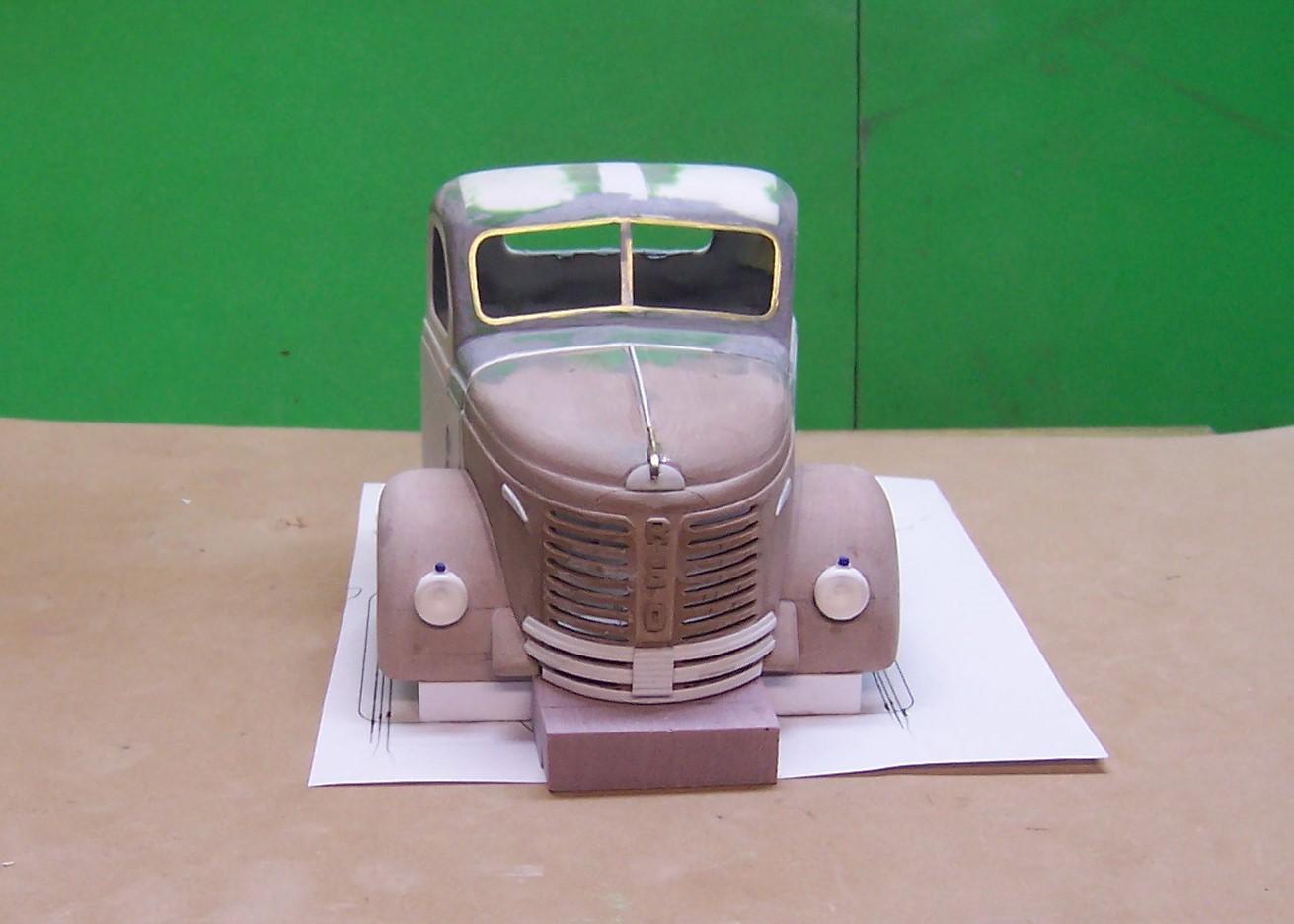

Chariots of Fire Posted April 29, 2020 Author Posted April 29, 2020 I got some additional work done on the nose. Added the Gold Comet badge to the sides, did up the headlights and added the hood ornament. I found that the right side grill openings were just a bit off so the outside edges were extended a tad and that required moving the Comet badge back a smidge as well. Small parking lights have been added to the top of the headlight buckets. These were taken before I adjusted the right side grill openings and the parts have since been given an initial coat of primer. It does wonders to bring out the flaws that need attention.
