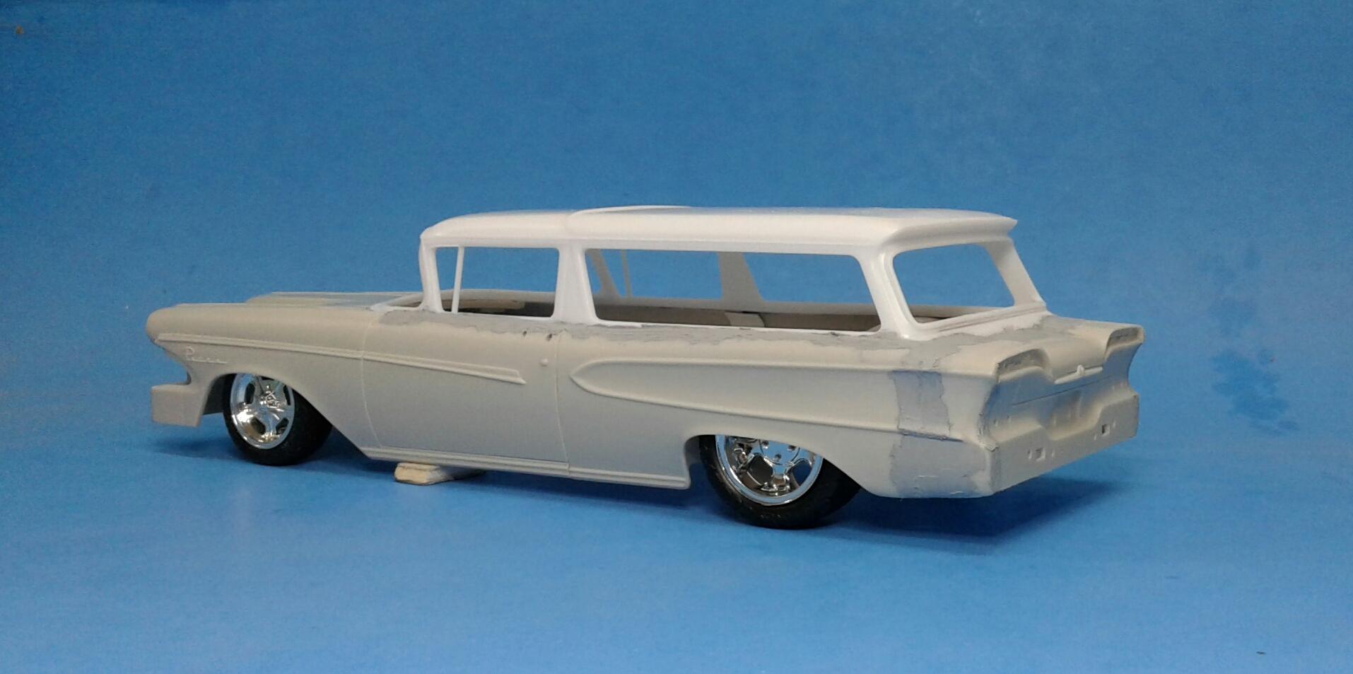

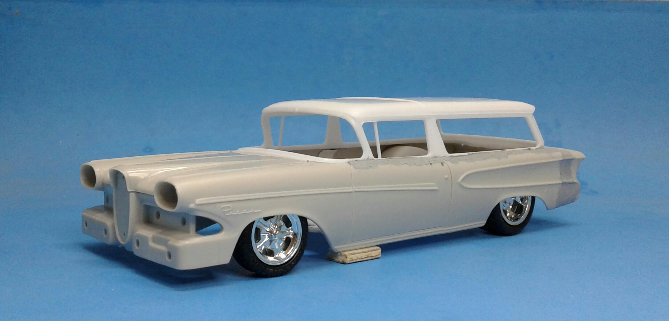

Plowboy Posted April 21, 2020 Posted April 21, 2020 Just started this one yesterday. I've had this idea ever since the Del Rio came out. The full scale wagon is pretty much the Del Rio with the Edsel clip and different tail lights. I wanted my wagon to look like an Edsel front to rear. The coved quarter panels and tail lights are important styling elements to me I started by removing the top from the Edsel. I'm going to hang onto it in case I ever need it. Then I cut the roof from the Del Rio and stuck it on the Edsel. The Edsel has a lot more rear overhang than the Del Rio. So, I sectioned 7 mms out of the length behind the wheel wells. The plan is to use the Edsel interior and modify it with the Del Rio parts necessary. The engine will be from the AMT Phantom Vickie. I may use these wheels or maybe the ones from the AMT Wagonrod.
David G. Posted April 21, 2020 Posted April 21, 2020 (edited) Interesting concept, I like it very much. Please forgive the unsolicited tip. But to me, the tail clip looks like it could be shortened just a bit. The way it is now makes for a rather deep tailgate and I'm having a hard envisioning how it would open. David G. Edited April 21, 2020 by David G.

Plowboy Posted April 22, 2020 Author Posted April 22, 2020 22 hours ago, David G. said: Interesting concept, I like it very much. Please forgive the unsolicited tip. But to me, the tail clip looks like it could be shortened just a bit. The way it is now makes for a rather deep tailgate and I'm having a hard envisioning how it would open. David G. It can't be shortened any more. As it is, the quarters are the same length as the Del Rio's. The floor pan/frame from the Del Rio fits like it should. It does look deep. But, there's no way to lean the center section in without wrecking the rest of it. My idea for it is to make it like a lift gate where all of it would simply raise up. I've been contemplating opening and hinging it. But, I don't know if I could make hinges that wouldn't be visible.

misterNNL Posted April 23, 2020 Posted April 23, 2020 10 hours ago, David G. said: I really like the concept you've come up with and I can't wait to see where you take it. David G. I propose splitting the tailgate into two sections. The upper would have the rear glass of course and all of the distance to the tail lights creating an "L" shape. That piece would swing up. The lower section could then swing down or to one side. Just might be a viable solution.
Plowboy Posted April 23, 2020 Author Posted April 23, 2020 5 hours ago, misterNNL said: I propose splitting the tailgate into two sections. The upper would have the rear glass of course and all of the distance to the tail lights creating an "L" shape. That piece would swing up. The lower section could then swing down or to one side. Just might be a viable solution. That's a good idea. Definitely something to think about. Only issue is where to split it. I got a light coat of primer on today. Just have a few touch ups and a little more sanding. I removed the Pacer script, rocker panel trim and the trim between the taillights. I filled in the trunk line and scribed in new ones.

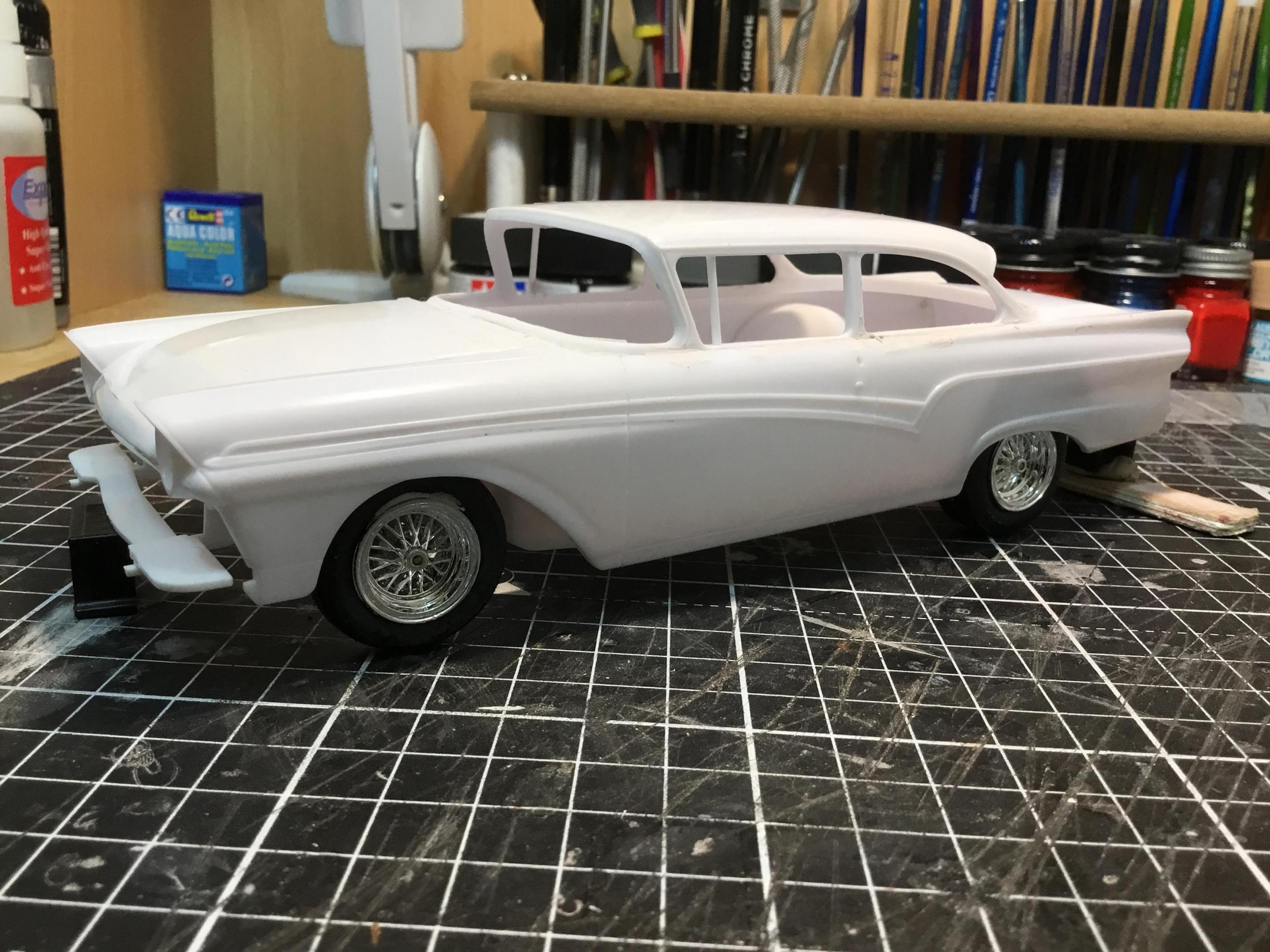

crossfire 2004 Posted April 23, 2020 Posted April 23, 2020 I love where this is going, great idea and it works for me. In a similar vein I removed the tops from both the sedan and del Rio and swapped them to give me the correct side trim on the sedan for a project I have waiting in the wings.
Bills72sj Posted April 23, 2020 Posted April 23, 2020 On 4/21/2020 at 6:37 AM, David G. said: Interesting concept, I like it very much. Please forgive the unsolicited tip. But to me, the tail clip looks like it could be shortened just a bit. The way it is now makes for a rather deep tailgate and I'm having a hard envisioning how it would open. David G. I'm with David here. I love the concept of what you are doing very much. I would suggest lengthening the roof. I will be following this build.
DrKerry Posted April 23, 2020 Posted April 23, 2020 7 minutes ago, Bills72sj said: I'm with David here. I love the concept of what you are doing very much. I would suggest lengthening the roof. I will be following this build. I thought the same or shorten the quarters some.. either way it looks good!!
Plowboy Posted April 24, 2020 Author Posted April 24, 2020 If I lengthen the roof, I'll have to lengthen the interior also. Rather not do that. If I make the quarters shorter (they're the same length as the Del Rio's), I'll have to shorten the floorpan, gas tank and frame. Don't want to do that either. I think I'm going to open the rear hatch and see if I can make some hinges that won't be too visible. If I can't, I'll just glue it back together. We'll see.
Plowboy Posted April 24, 2020 Author Posted April 24, 2020 I've began getting the interior pieced together. I had already mini tubbed the rear wheel wells on the floor pan. I modified the Edsel rear seat to fit. I had to narrow the floor piece also. I joined the rear quarter panels/tailgate panel from the Del Rio to the Edsel's interior panels. I still have some trimming and fitting to do. But, I have a start on it.
