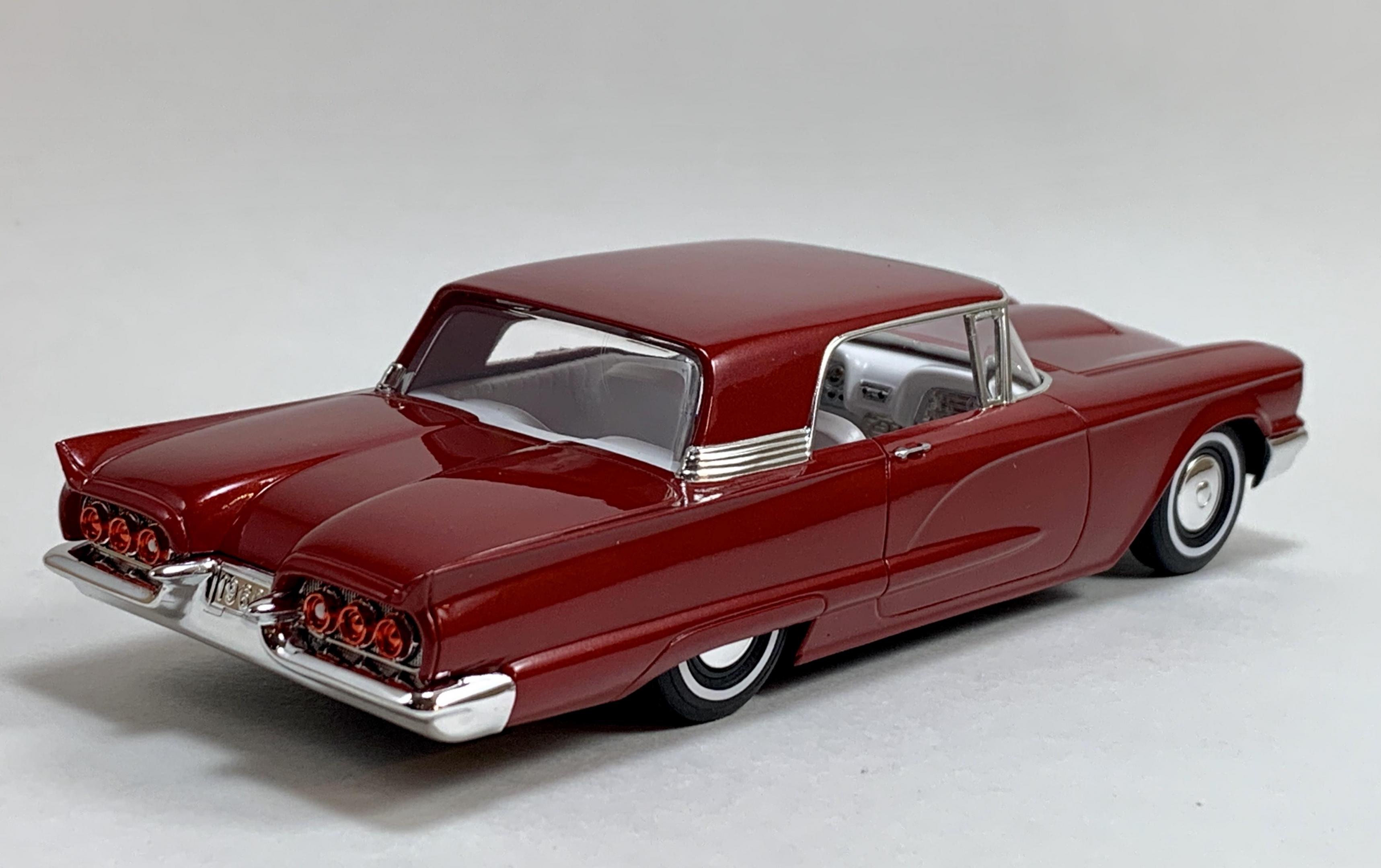

gman Posted April 23, 2020 Posted April 23, 2020 Not my photo, borrowed from this thread: ^^ if you are talking about the horizontal body side molding running front to back above the wheels, try a pack of sanding sticks. https://www.ebay.com/itm/Flex-I-File-525-Flex-Pad-Into-Set-Finishing-Sanding-Polishing-Hobby-Craft/232923298661?hash=item363b4f7b65:g:Zc0AAOSweW5VAGba ^^ these sanding sticks are really good, and the assortment pack has grits from rough to ultra fine. You can lay some masking tape above and below the trim you want to remove, and work on removing the trim starting with the course stick and progressing through finer grits. You may have to re-scribe door lines a little bit after trim is removed. You can use the back of a #11 hobby blade to clean up door lines where the trim was- go easy.
