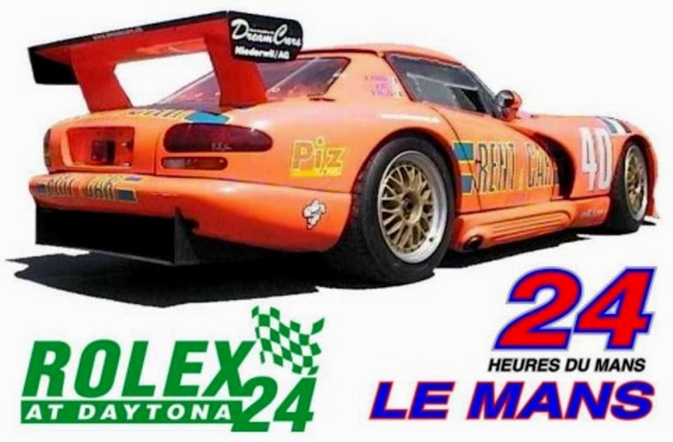

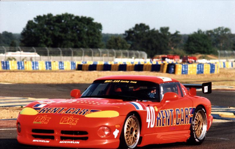

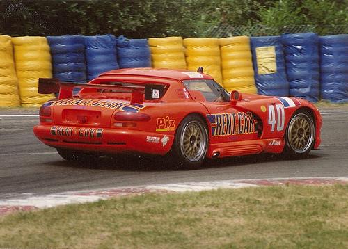

chaves pah Posted April 30, 2020 Posted April 30, 2020 Did somebody build the Dodge Viper RT/10 "Rent-A-Car" Le Mans 1994 (1/25 AMT base)? I can I find the correct BBS wheels for this particular car?

chaves pah Posted May 2, 2020 Author Posted May 2, 2020 Thank you very much, Andy, but I have to disagree totally with you... first of all the Viper is a 1/25 model, while the GT1 Evo is at 1/24... second, the Viper wheels centers are "outlined" by a multi nut rim, unlike the Porsche's... I posted this query yesterday, in total despair, since I found once in some modellers forum that the answer would be the Le Mans Miniatures Dauer Porsche, and, when I opened the box and tested it in my Viper, the world just collapsed... these wheels, with it's tires, are monstruous in this car! that is why I ranned to internet to find some help... BUT, today, looking again to these wheels, I decided to try to figure a way to save it, so I began to test some tires from different cars and makes, and fond that the FRONT Dauer wheels, and TIRES, are exactly the proper size to fit the rear Viper wheels; so the next thing was to solve the front wheels problem, which is the REAL challenge... First, tires had to have a smaller diameter; after extensive search I found that the Scale Production 16"/19" BBS front tires will be PERFECT, I have only to order it, but I found they are now out of stock... Now the final and Main problem: modifying the Dauer front wheels to become Viper wheels... the latter are quite different, the center part is considerably less deeper, and protrude the outer rim, so I will have to separate/cut the center part from the rim, glue it in a tube which outer diameter is exactely the inner diameter of the wheel rim, so I can pull it out about 1,5mm; in the end, I will have to trim the rear chromed metal rims to make it the same width of the front ones, and I WILL AT LAST BE ABLE TO FINISH MY 1994 "L' Orange" RT/10 Dodge Viper! I hope this is of help for you all...

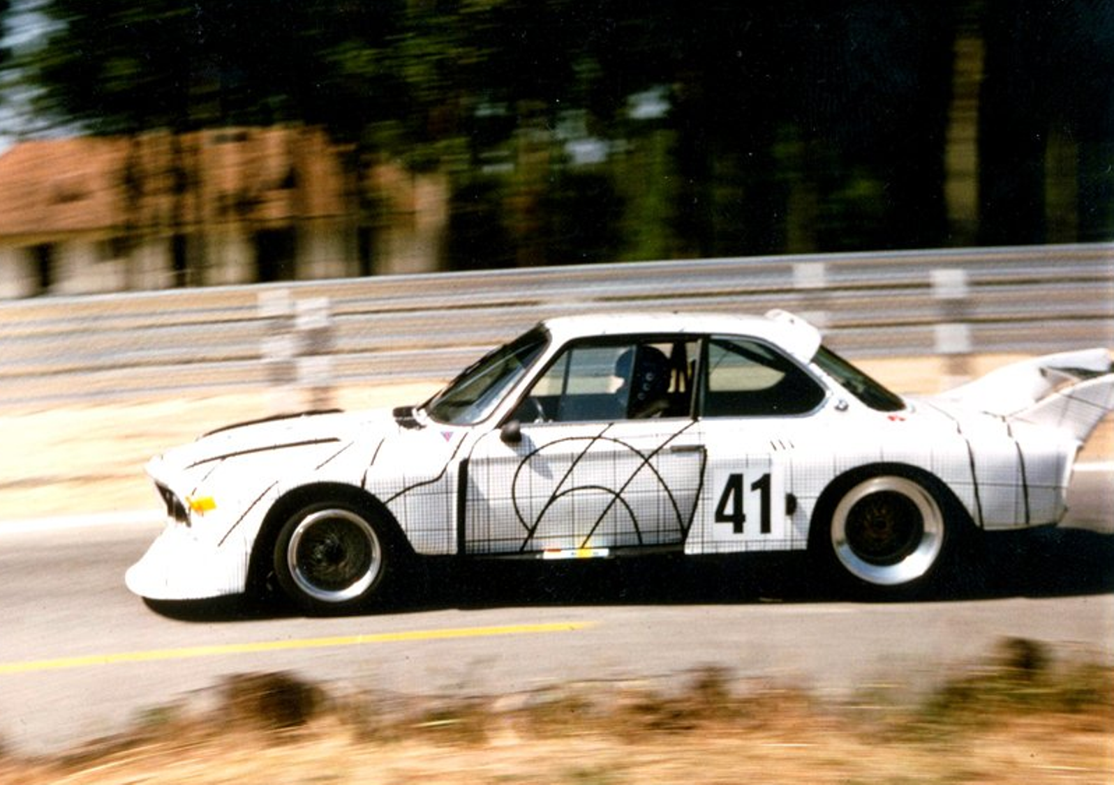

chaves pah Posted May 3, 2020 Author Posted May 3, 2020 Yes, I usually buy in Scale Prod, but none fits this particular car... first, it would have to be 1/24 16", that would become 17" in 1/25; this Viper is in 1/25th scale... no one of his BBS in 16" have the surrounding multi nuts ring, that is clearly apparent in this car's wheels!... I will post some photos as soon as I have the wheels made... and have to be assured by him he will restock the 16"/19" BBSs , as I need the front 16" slicks from this set; I have one set already, but I am waiting for an ARII BMW 3.5 CSL, that will become Frank Stella's Le Mans Art Car, the only of the four 3.5 CSL built that used Bi Turbos, but was so powerful that needed much bigger/wider rear wheels to put all that power on the ground; wheels did hold it, but not the trans-axles... even a new and stronger one in the following year, barely did the job... 19"s will be great in the model, and this one will be static, no trans axle problems at all! Thank you very much for keeping this thread on!

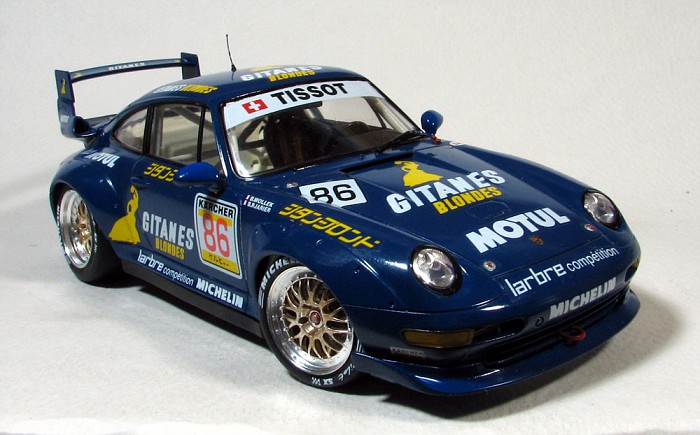

RancheroSteve Posted May 8, 2020 Posted May 8, 2020 Just a possibility? This Tamiya Porsche (originally the Taisan Starcard 911 GT2) is 1/24, but the wheels look close, maybe? I can measure them if you'd like me to.

williamdp Posted May 10, 2020 Posted May 10, 2020 Good morning, May I point out that the 1994 Viper RT/10's had 10 spoke wheels ? Attached is how far I got .. before my fluo paint job decided to crackle up completely (it apparently did NOT like the clear that I used …) IIRC, the wheels are based on a Fujimi set that used to be sold separately. W.

chaves pah Posted May 11, 2020 Author Posted May 11, 2020 Hi JC, well, I did already improve my chosen wheels, so I moved to another big issue, the hood, as this particular car is seen always without one... I suppose it would be sold as a roadster, as it does not have a rear windshield... so, I chopped an old ESCI 934 to get a roof for my Viper; it seemed a to be a "piece of cake"... cut it by the middle and added a 4mm plastic ribbon to increase the width and when I finally test fit it... the Viper just looked as the most beautiful of "all ever designed" trucks, the Spanish Z-206 Pegaso!... after checking the Viper blueprints I found that the AMT kit windshield is too high, or it might also be possible that these two racing Vipers had shorter windshields... a new rooftop was chopped from a Tamyia Moby Dick bought in a scrapyard sale and, after filing the windshield until reaching (above) the little protuberance where the rear mirror is attached, this time I think I finally made it! a little front spoiler was also added; the hole in the back is the second filler cap this car did have. Now I have to make a rear spoiler and the rear winshield (I found one photo where it clearly appears rear photos of this car are hard to find, and the rear spoiler is too big...)... there it is, that little white sticker... some more to come...
