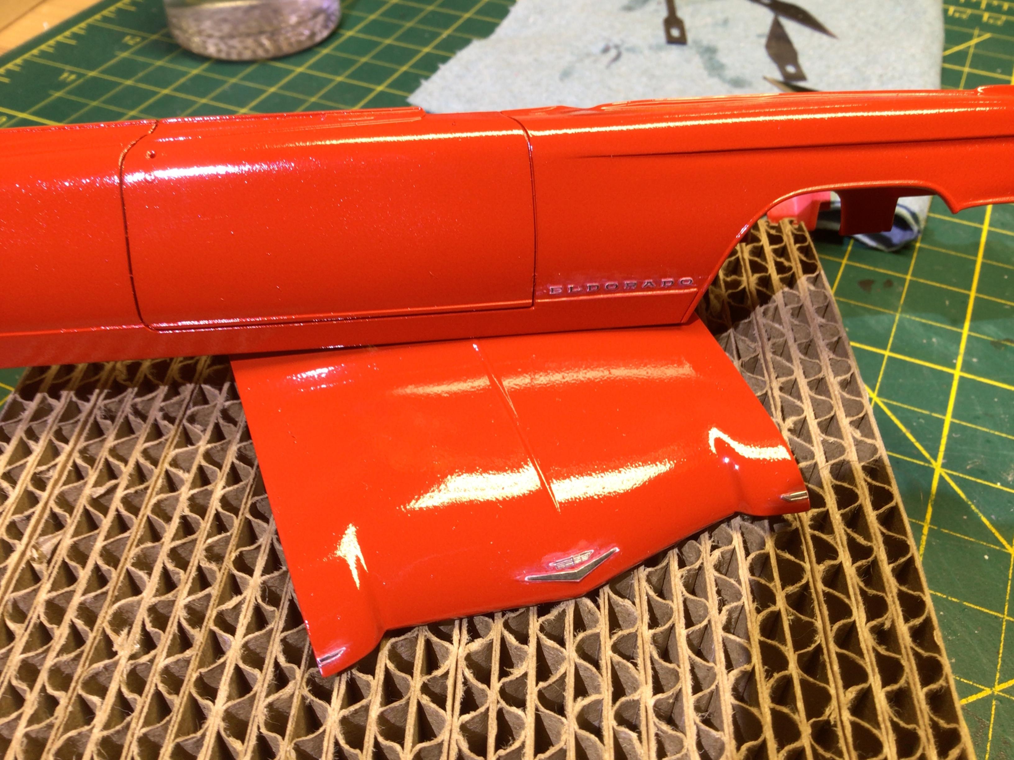

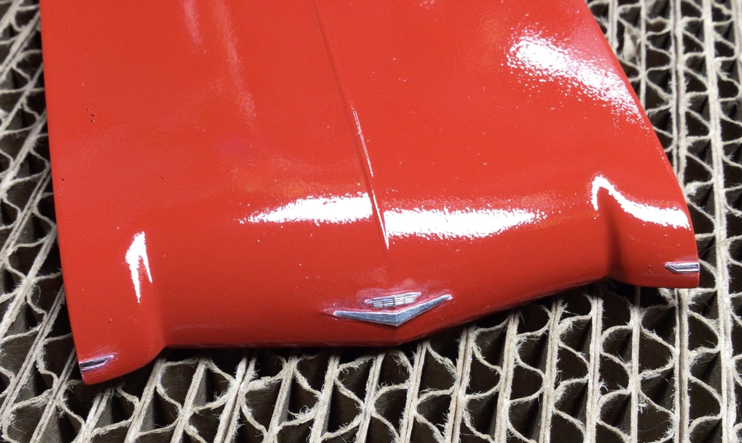

NOBLNG Posted June 1, 2023 Posted June 1, 2023 (edited) Here is an example of “foil under primer” technique.? You can clearly see the primer around the edges of the badges. It might be less noticeable on a light coloured paint job? I believe the “foil under paint” method is the better way to go. I am now debating whether or not to toss this one in the pond.? Edited June 1, 2023 by NOBLNG
stitchdup Posted June 1, 2023 Posted June 1, 2023 37 minutes ago, NOBLNG said: Here is an example of “foil under primer” technique.? You can clearly see the primer around the edges of the badges. It might be less noticeable on a light coloured paint job? I believe the “foil under paint” method is the better way to go. I am now debating whether or not to toss this one in the pond.? if you used black primer it would work for modern car emblems since most of them are plastic backed
StevenGuthmiller Posted June 1, 2023 Posted June 1, 2023 2 hours ago, NOBLNG said: Here is an example of “foil under primer” technique.? You can clearly see the primer around the edges of the badges. It might be less noticeable on a light coloured paint job? I believe the “foil under paint” method is the better way to go. I am now debating whether or not to toss this one in the pond.? Thank you for this post Greg. This depicts exactly what I was referring to when I was talking about a fine line of primer being visible around the perimeter of the script in some cases when applying the foil prior to primer. It might not always be evident, but you are running that risk if you apply it that early. I didn't bring this issue up because I heard it somewhere. I've experienced it and just wanted people to know that it could be a possibility. This is exactly the reason why I began applying the foil later in the painting process. Not only does it eliminate the possibility of this happening, but the less paint that you have to remove from the foil, the easier this technique is. Steve 1
