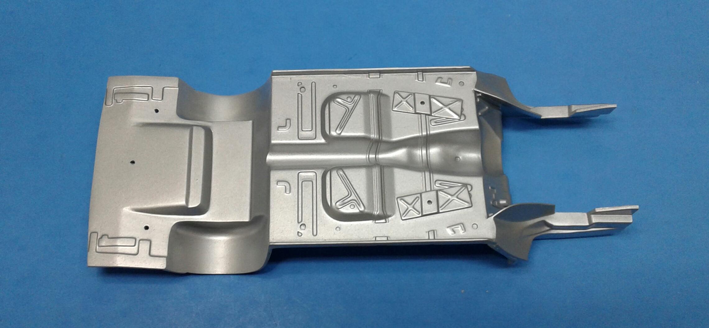

Plowboy Posted May 11, 2020 Posted May 11, 2020 Tamiya paints aren't going to dry with a shine. Almost all of them dry dull as they're a lacquer paint. Some of the solid colors will dry with a touch of shine. You can polish the solid colors. But, the metallics have to have a clear coat like TS-13. I clear over both. It kinda sounds like you tried to spray too much paint at once. Humidity isn't your problem at 67%. I've painted in my garage when it was raining with no problems. My method for painting is never more than two coats per day. I spray two coats of paint, allow it to dry a day. I'll sand and if I don't sand through, I'll spray two coats of clear. If I do sand through, I'll spray a coat of paint, allow it to dry a couple of hours and spray one coat of clear. Next day, sand again and spray one or two more coats of clear (depending on if I have one or two coats of clear over the paint). Next day, sand and polish. To fix what you have, allow it to dry a few days, sand with 1000 grit and spray a light coat of paint over it and see what happens. It would really help if you could post a photo. Otherwise, we're shooting in the dark.

Plowboy Posted May 11, 2020 Posted May 11, 2020 This is Tamiya Mica Silver straight from the can. No shine. This is the same color after three coats of clear and polished.
StevenGuthmiller Posted May 12, 2020 Posted May 12, 2020 5 hours ago, Plowboy said: This is Tamiya Mica Silver straight from the can. No shine. This is the same color after three coats of clear and polished. Not only can lacquers, (I imagine Tamiya's included) dry with little to no shine, but a clear coat might be necessary to bring out the true color. The above pictures dramatize that. The chassis plate looks drab and boring. The Ford body is rich and vibrant. I have really noticed this to an even greater extent with the Scale Finishes lacquers that I have been using. The colors before and after clear often bare no resemblance to one and other. This is a big part of the reason that I always use clear on a project. It adds great depth an richness to a color that can otherwise look washed out. Steve
