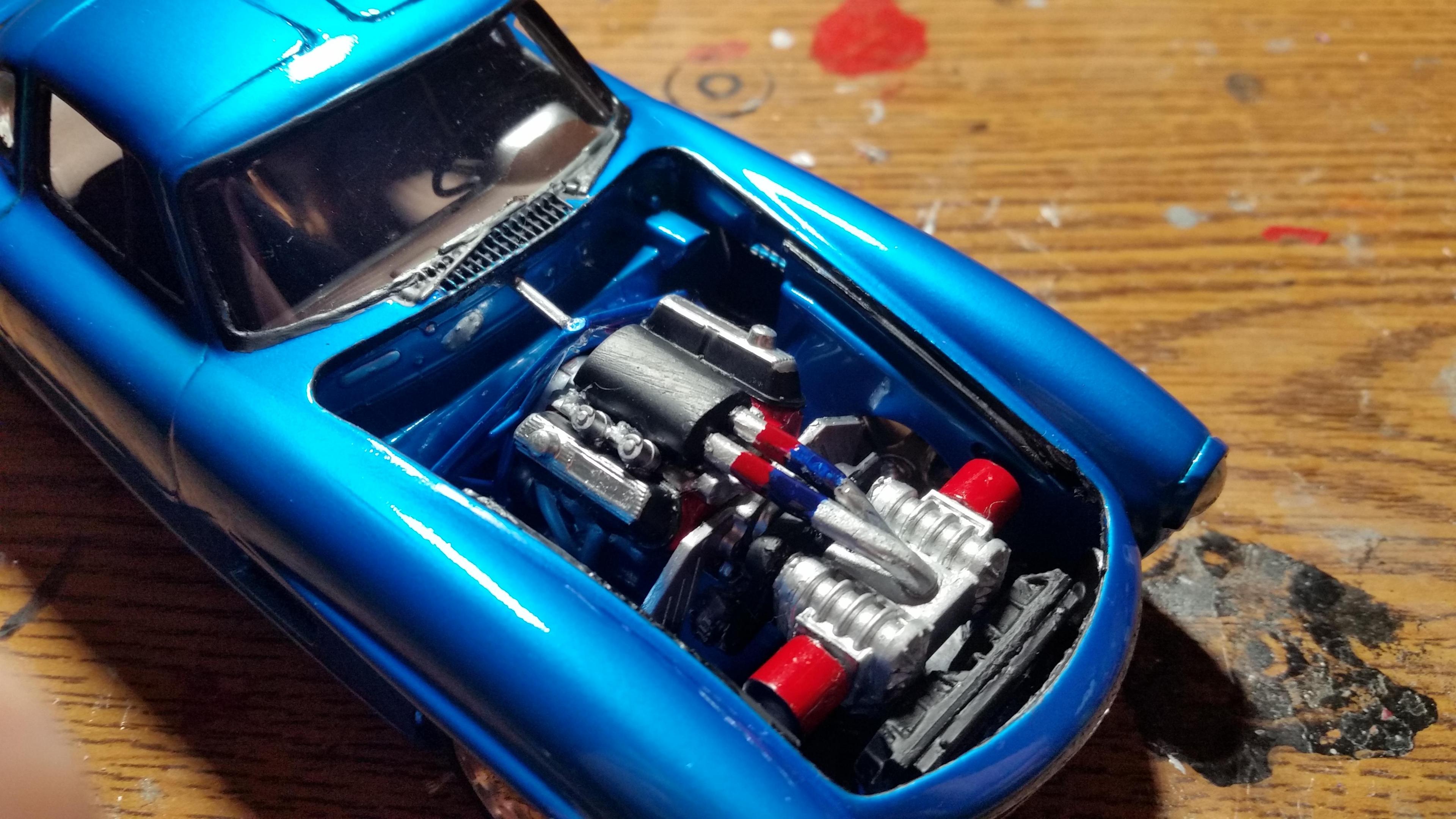

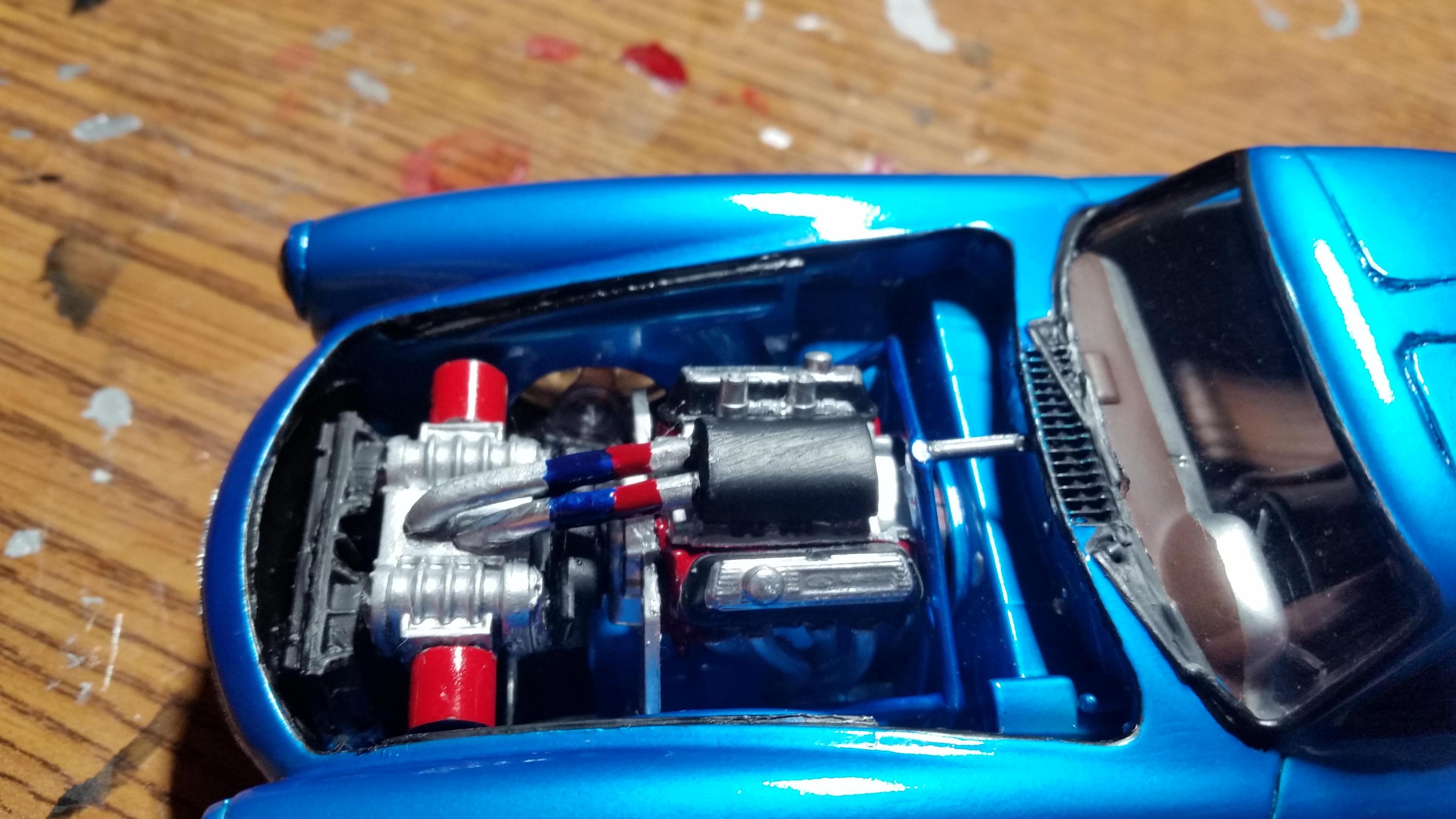

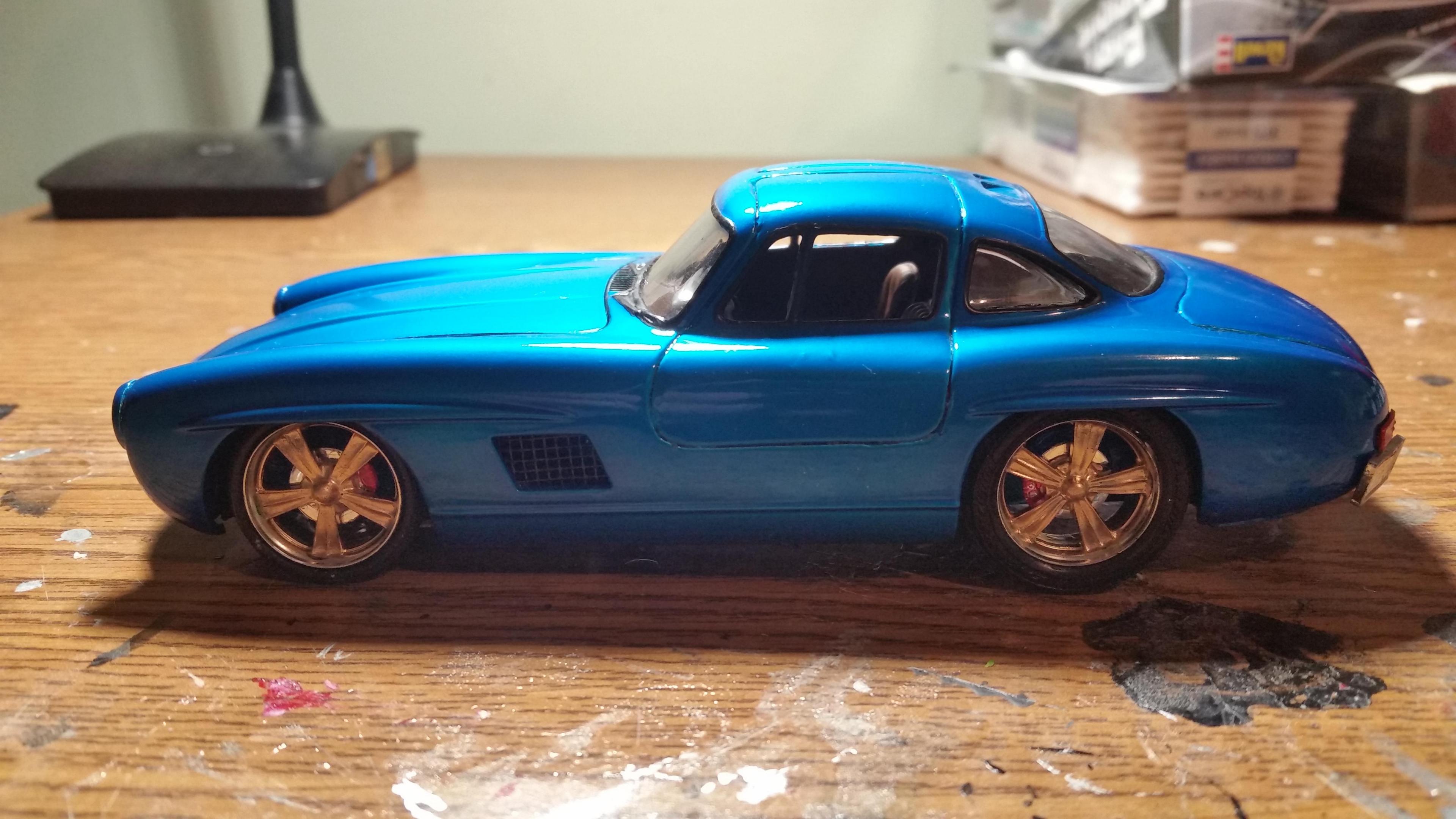

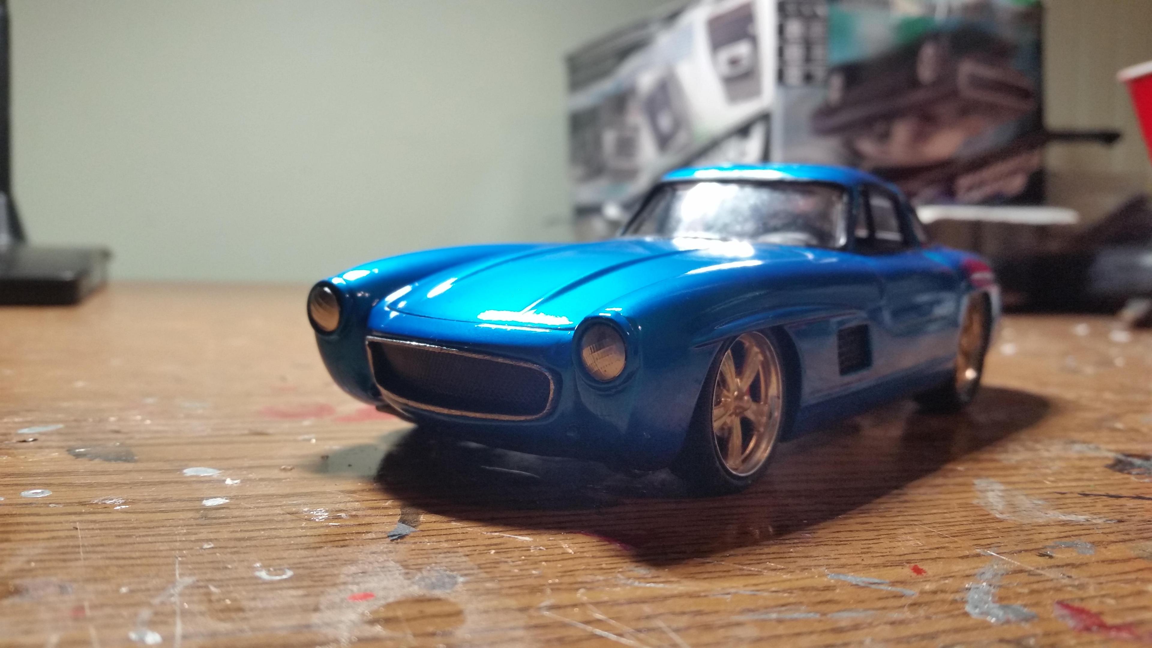

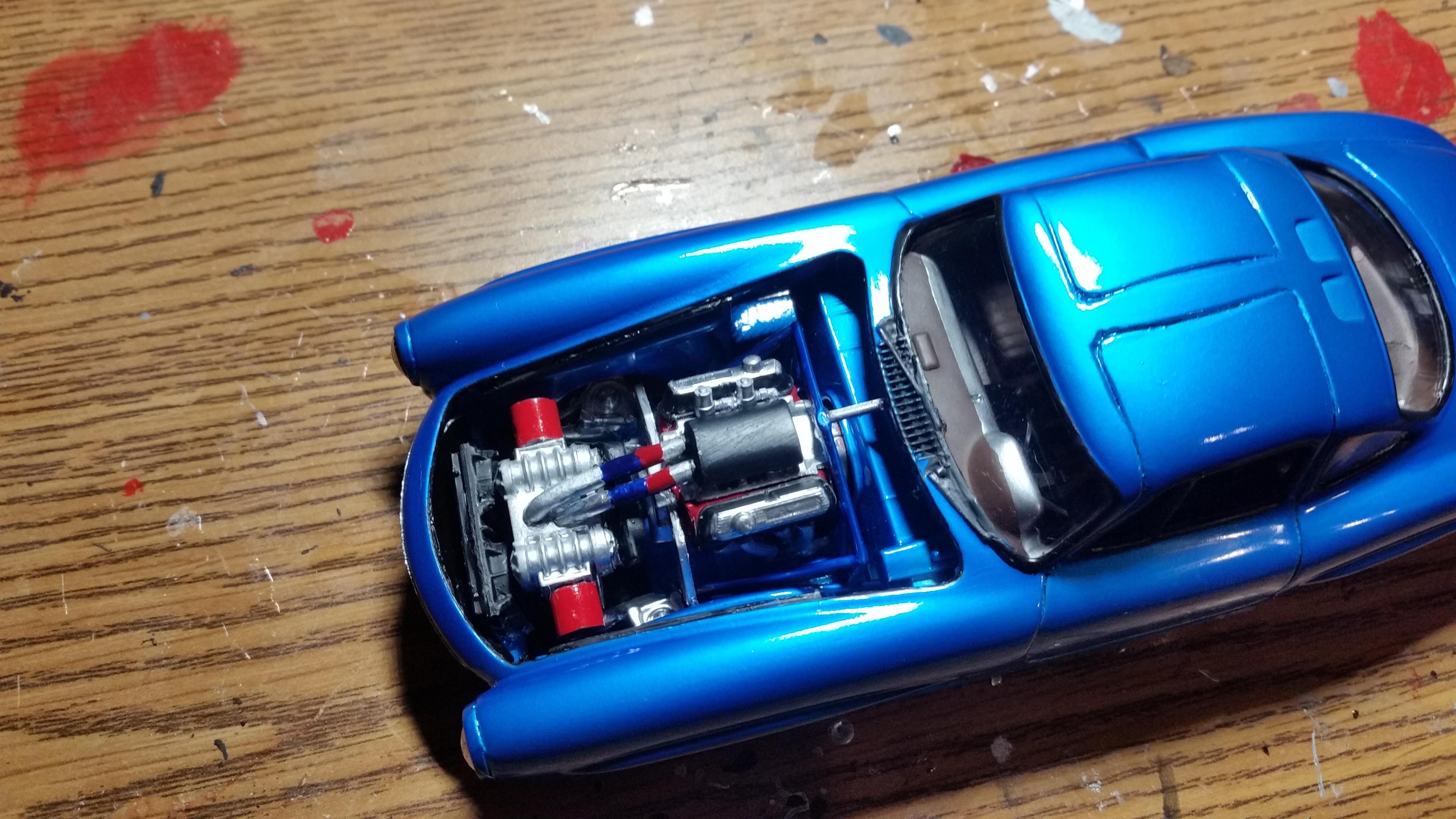

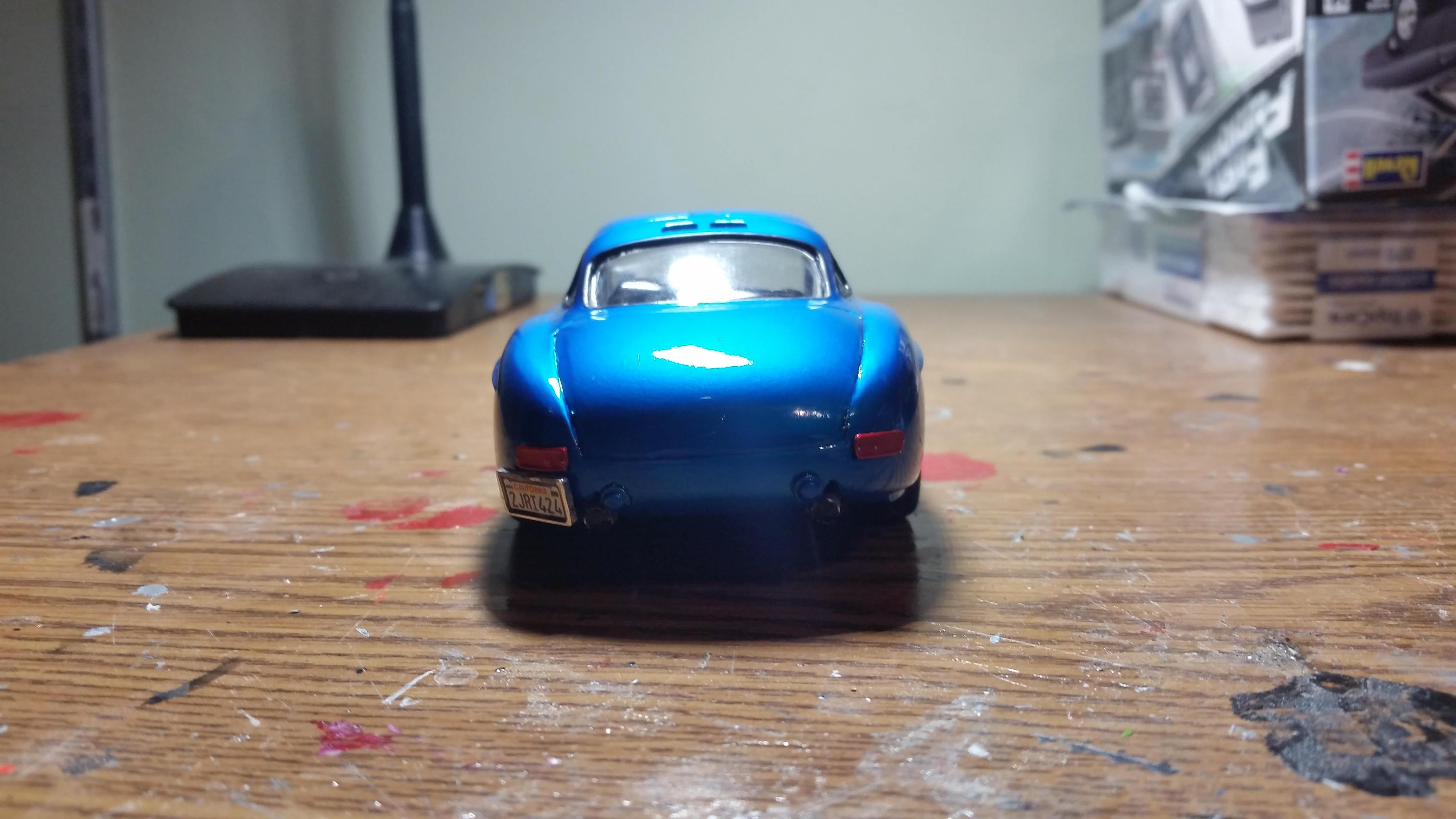

RickRollerLT1 Posted May 21, 2020 Posted May 21, 2020 Built from 1989 issue Prestige kit. Several parts had extremely poor placement and fit on top of being warped. The opening doors and trunk were the worst offenders, so those were glued shut and rescribed. Also, some parts were missing due to rattling in a battered holey box for 30 years. Nonetheless, I was customizing anyway with mods as followed: Twin Supercharged Ford V8 swap comes from Mathew and Debbie Heys T-Bird Pro Street, with a custom made intake as the original munti-piece chrome unit kept hitting the Mercedes hood. Styrene scrap trees bent as intake tubes and oil filters turned into air filters as the original pieces were missing. Electronic fan/radiator comes was also sourced from a Revell Acura Integra. T-Bird Pro Street's side exhaust was used with heavy modifications to exit at the rear Steering wheels comes from AMT Silhouette Mesh screening was used in lieu of kit's vent piece, which was an ill fitting heap when it hit's the inner fenders Front and rear bumpers were omitted to created cleaner look, bumper pins were used to cover up mounting holes. Badging and such were shaved and smoothed. Custom wheels form unknown Revell source, with front tires being Toyos from Revell Honda Civic and rear tires from Revell C5 Corvette. Disc brakes were used from a Revell Corvette Sting Ray III Interior paint is Rustoluem Advanced Formula Flat Brown. Exterior is Tamiya TS-72 Clear Blue over Rustoluem Silver cleared with Pledge

Modlbldr Posted May 22, 2020 Posted May 22, 2020 Amazing updates to this classic! What a great modern look it has. Love the color too. Later-
espo Posted May 22, 2020 Posted May 22, 2020 Very nice body and paint work. I like the way you did the twin blowers on the engine.
