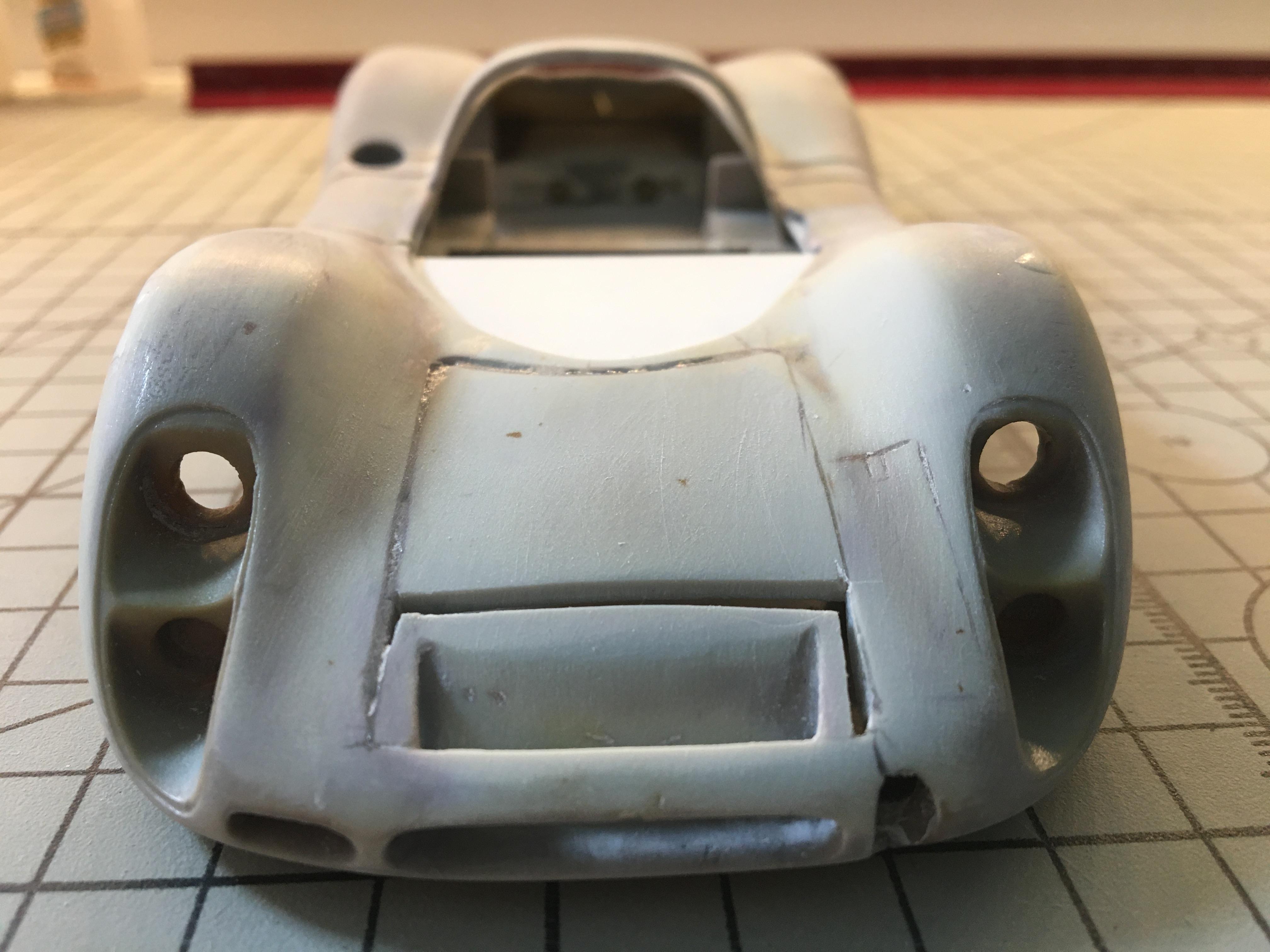

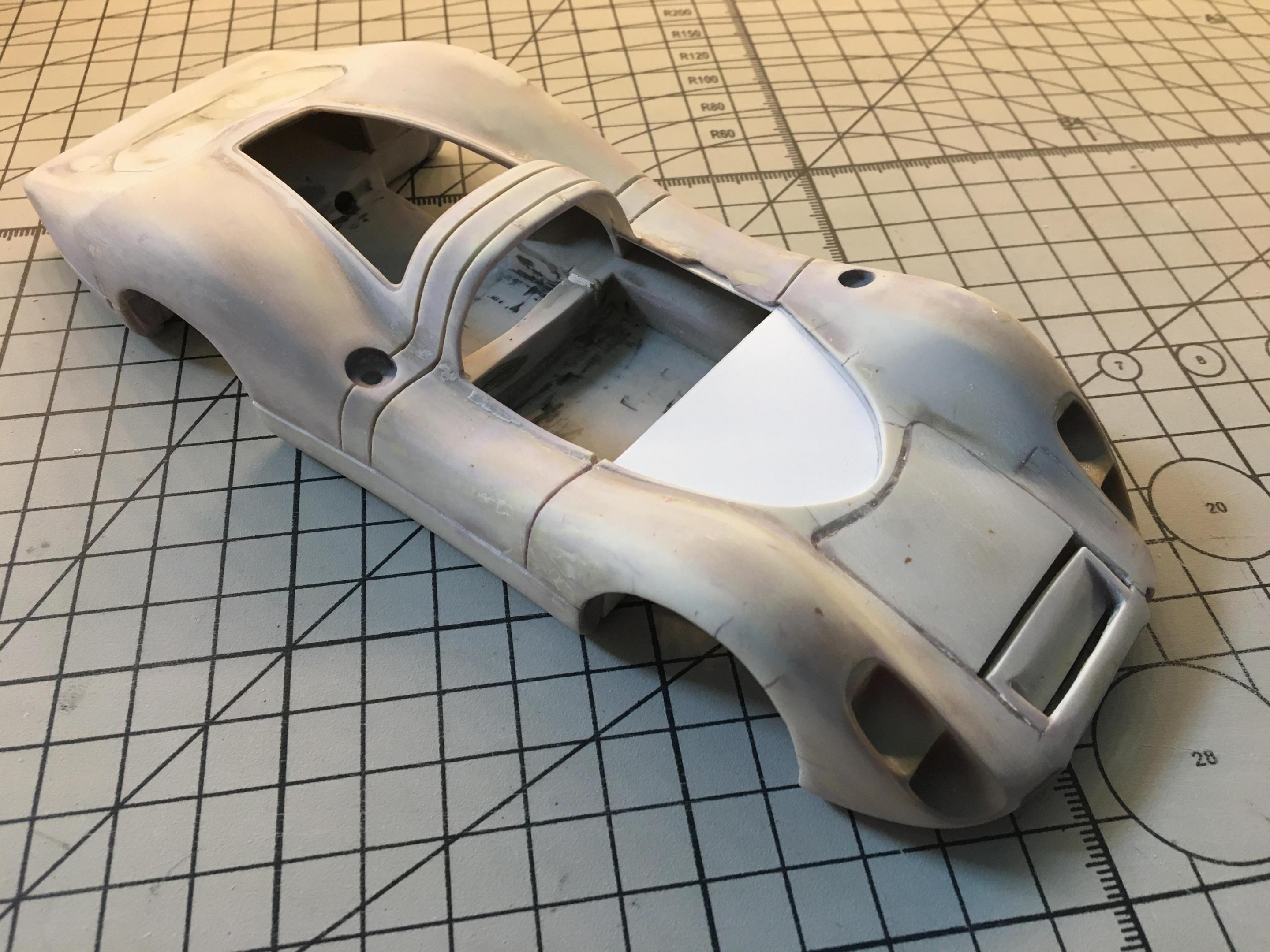

Recently I had soaked it in SuperClean which pretty much stripped it bare of all that junk.  However what was left was a straight but rubber body.  I had then soaked it in water over night in hopes to leach out any chemicals and then stuck it in the freezer.
What was left was a noticeably stiffer (between slot car and styrene) and still straight body.
I've decided to only used CA and recently ordered Milliput to work the model.
While it's still pretty soft in areas, attaching it to the tub will give it more structure.  Also of note is that the more I work it sanding etc... the more stiffer it seems to be getting.
At any rate I am getting a lot of pride and sense of accomplishment restoring this wonderful Fisher kit.
It will be a roadster.
