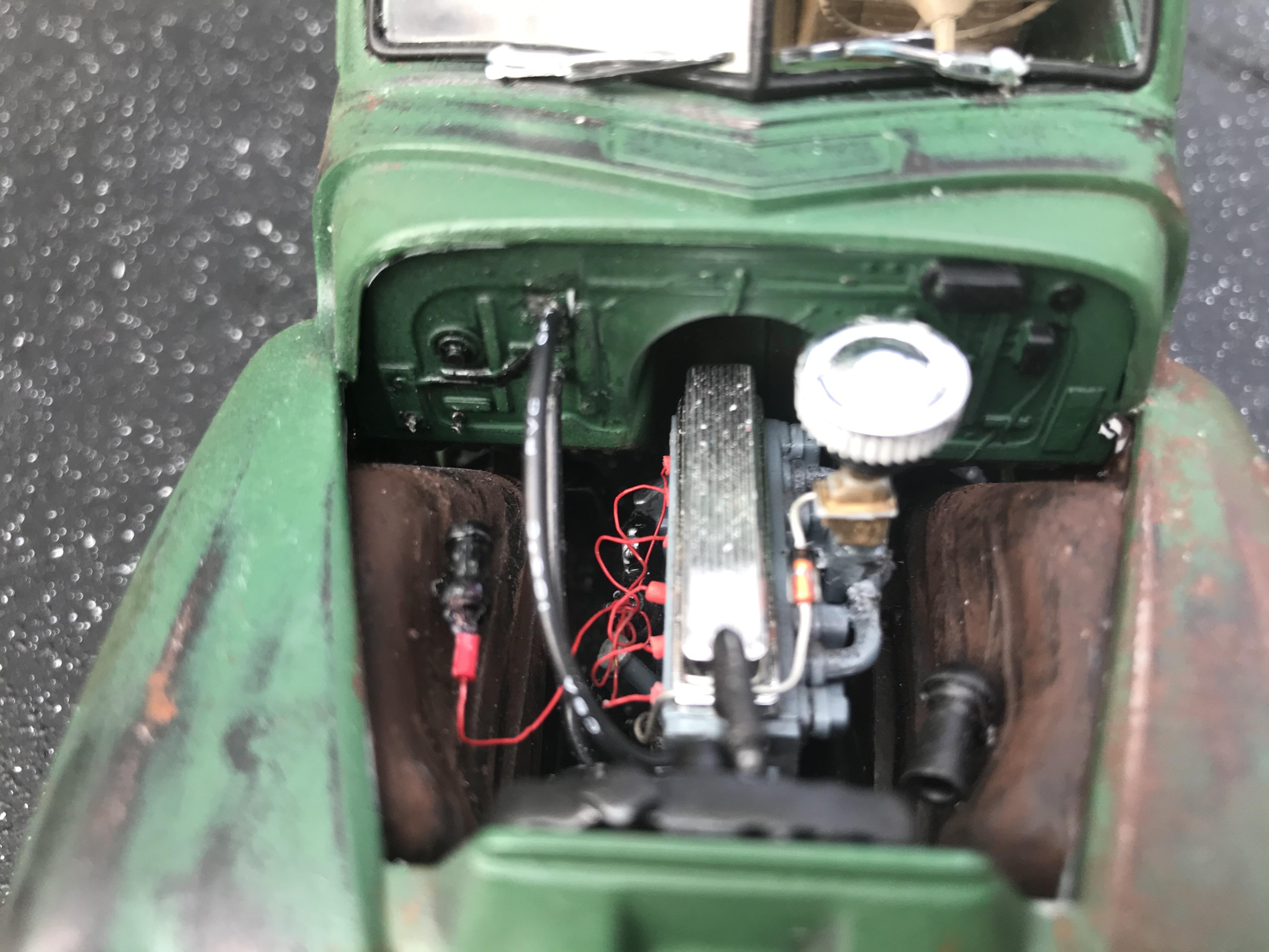

Tom Geiger Posted May 28, 2020 Posted May 28, 2020 I’m still working off a pack of Radio Shack diodes I bought around 1990 as fuel filters and lines.
