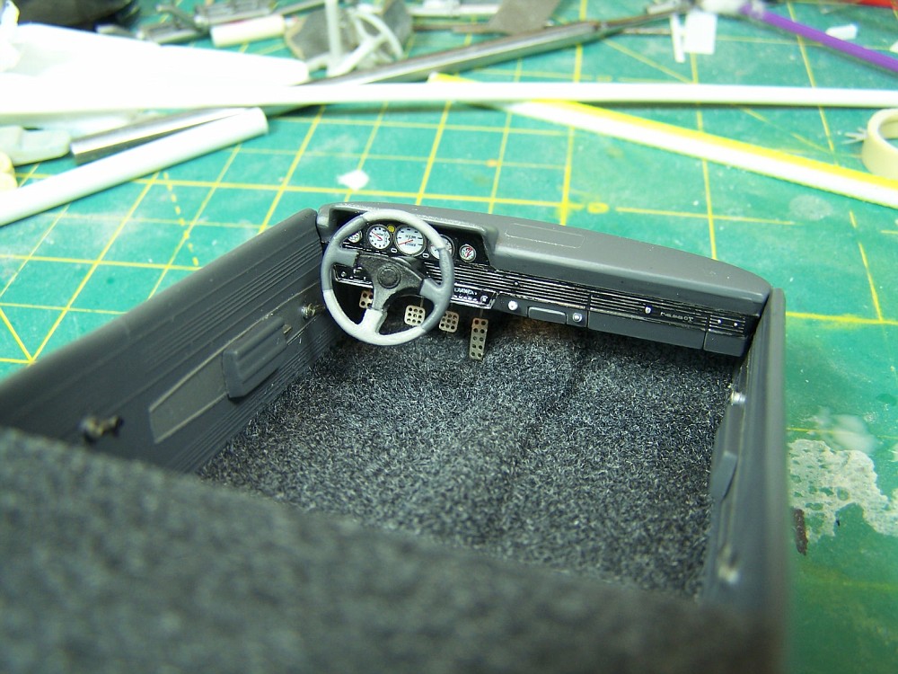

Marc @ MPC Motorsports Posted September 6, 2009 Author Posted September 6, 2009 After nearly a month, I'm getting a little bit of quality bench time this weekend. Got the interior of the Cyclone painted and flocked. Paint is Tamiya TS-67 IJN Gray and Testors Fabric Gray lacquer. Brushed metal door panel inserts are painted Tamiya AS-12 Bare Metal Silver. Flocking is from Ken's Fuzzi Fur. The front seats are from Reliable Resin and the rear bench is from an AMT '69 Torino Cobra as the Cyclone builder did not come with a back seat. Still to come are photo etch window cranks, resin arm rests and photo etch pedals. Enjoy!!! Marc @ MPC Motorsports
Marc @ MPC Motorsports Posted September 28, 2009 Author Posted September 28, 2009 I haven't really been at the bench since Labor Day until this weekend, when I managed to find a little time. Photoetched window cranks and pedals. Arm rests are GM A-body units that I resin cast. Steering column is scratchbuilt with a resin wheel cast from the custom unit in an AMT '66 Mustang Resto Rod kit. Here's a close up of the instrument panel. I painted the wheel to match the seats. Tonight, I begin painting the engine so hopefully I can continue what I've started and finish this sucker. Enjoy!!! Marc @ MPC Motorsports
