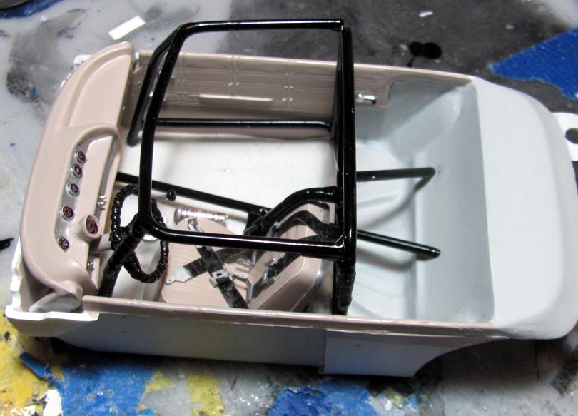

Tom Geiger Posted June 14, 2020 Posted June 14, 2020 (edited) I assemble everything with pins. There have been times I’ve tried to shortcut and just glued parts together and was sorry! Nothing magic or expensive here.. standard straight pins, wire cutters from my garage tool box. I do have a small battery power hobby drill, the new Tamiya one would be a wise investment. I drill and press fit all the joints. I had to resize the cage to fit in this model so it helped me with the fitment. Here is everything dry fit. The cage also gets pinned to the floor for an exact and permanent strong assembly. I had this entire interior in and out of the body to fit it to roofline etc before anything was painted or finished. Here we are all finished and ready for final assembly. Yes it’s a bit more work, but aren’t we in this for great results ? Edited June 14, 2020 by Tom Geiger
slusher Posted July 15, 2020 Posted July 15, 2020 On 6/14/2020 at 11:48 AM, Tom Geiger said: I assemble everything with pins. There have been times I’ve tried to shortcut and just glued parts together and was sorry! Nothing magic or expensive here.. standard straight pins, wire cutters from my garage tool box. I do have a small battery power hobby drill, the new Tamiya one would be a wise investment. I drill and press fit all the joints. I had to resize the cage to fit in this model so it helped me with the fitment. Here is everything dry fit. The cage also gets pinned to the floor for an exact and permanent strong assembly. I had this entire interior in and out of the body to fit it to roofline etc before anything was painted or finished. Here we are all finished and ready for final assembly. Yes it’s a bit more work, but aren’t we in this for great results ? Tom, what’s wrapped on the roll bars or is that paint?
Tom Geiger Posted July 15, 2020 Posted July 15, 2020 1 hour ago, slusher said: Tom, what’s wrapped on the roll bars or is that paint? Carl, that’s padding that’s molded with the roll bar. The roll cage came from the Falcon Modified Stocker, but cut down and reshaped in every direction.
