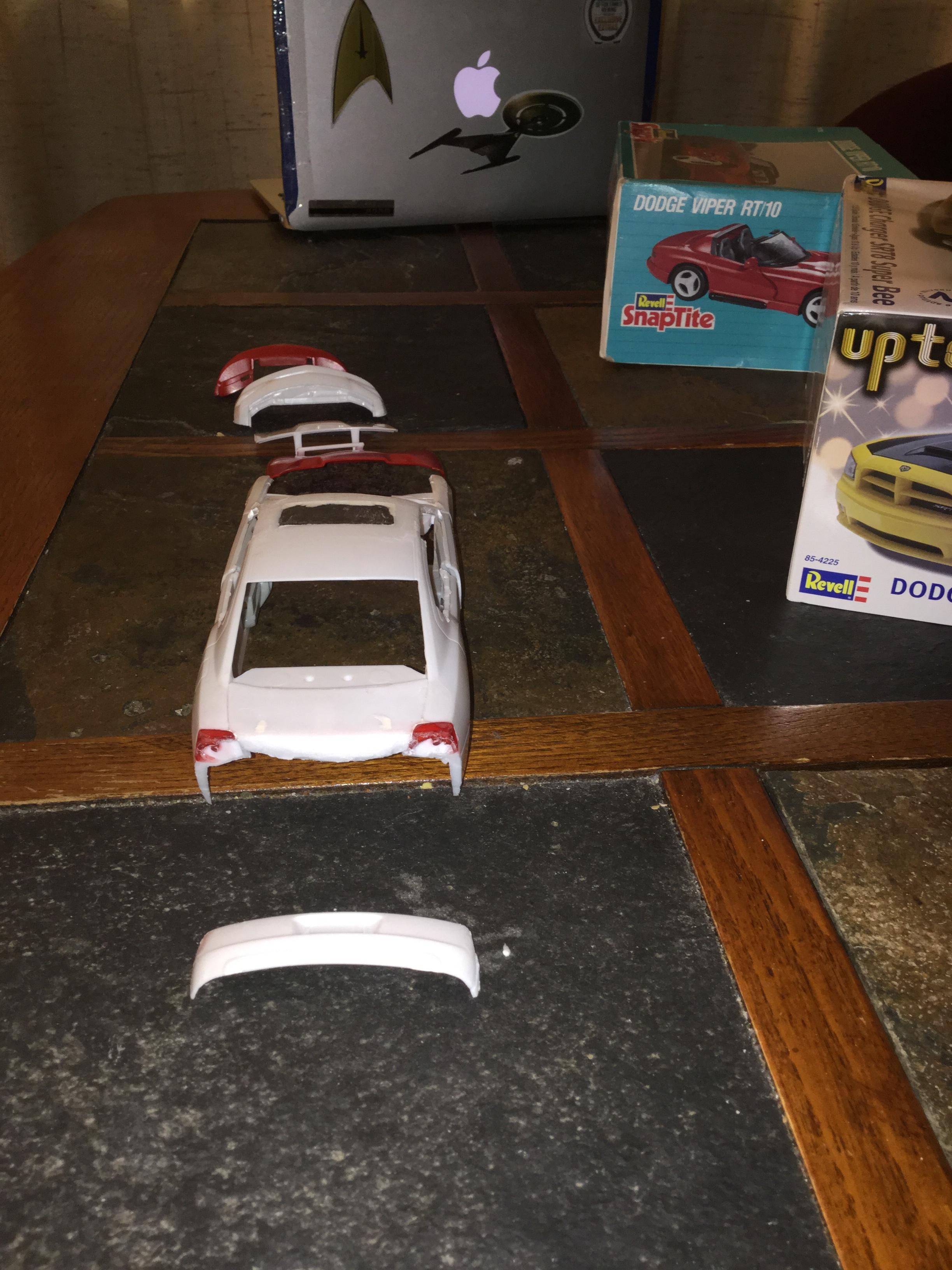

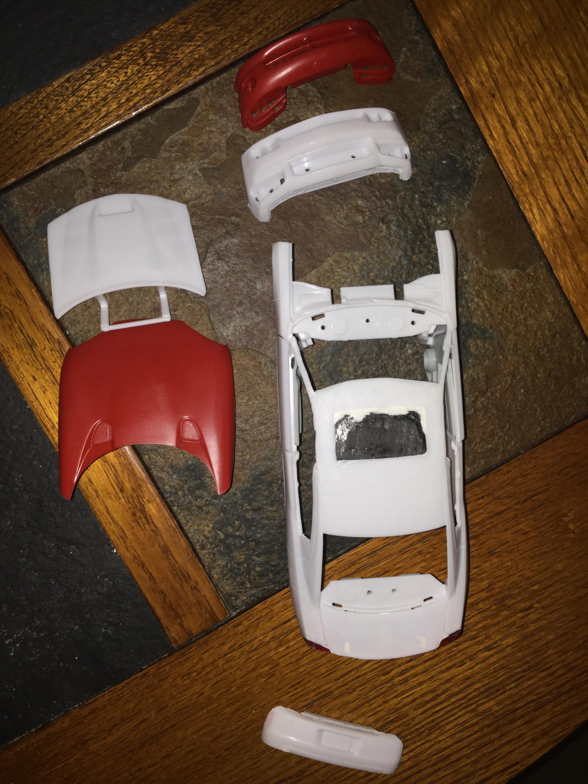

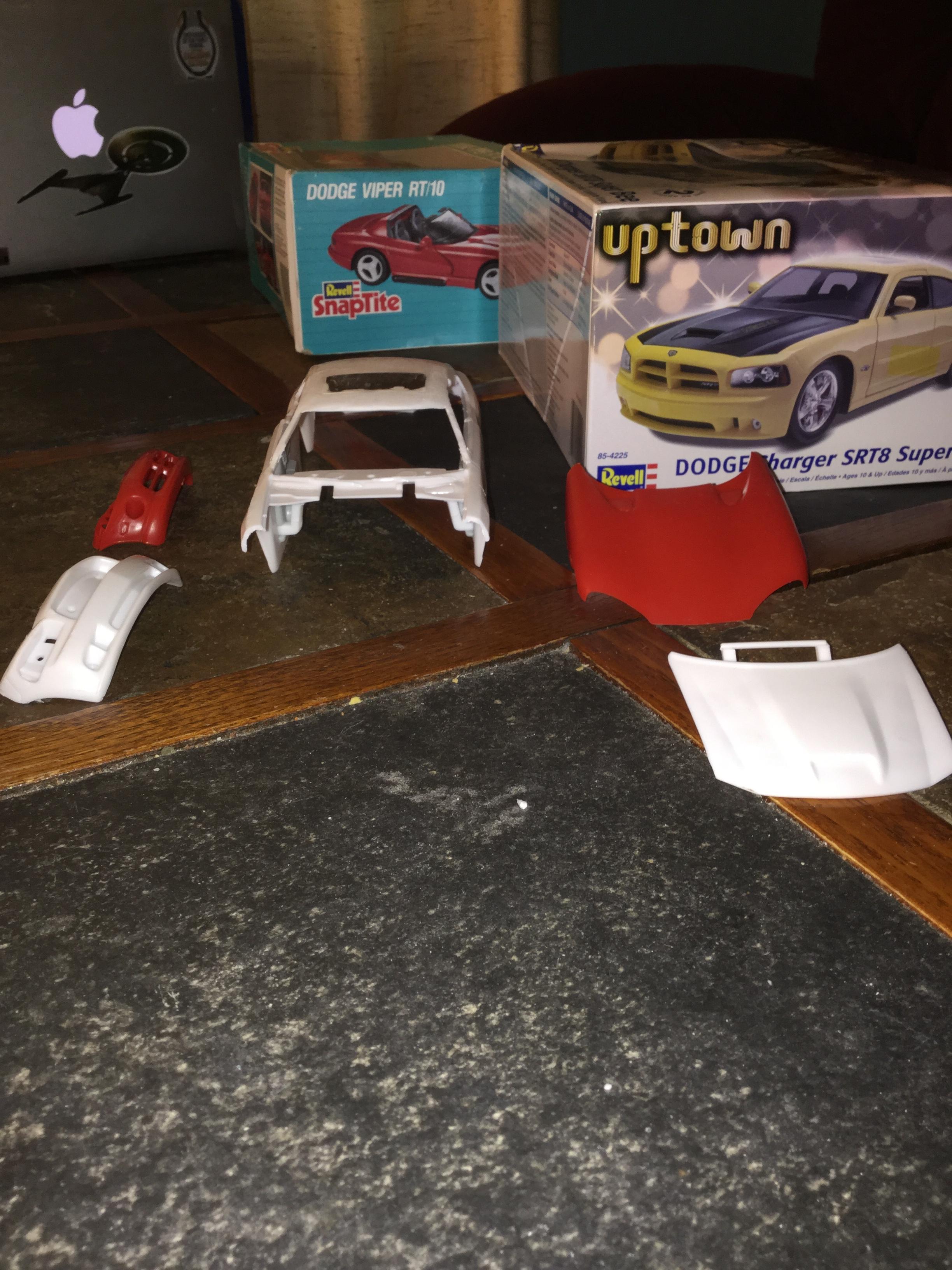

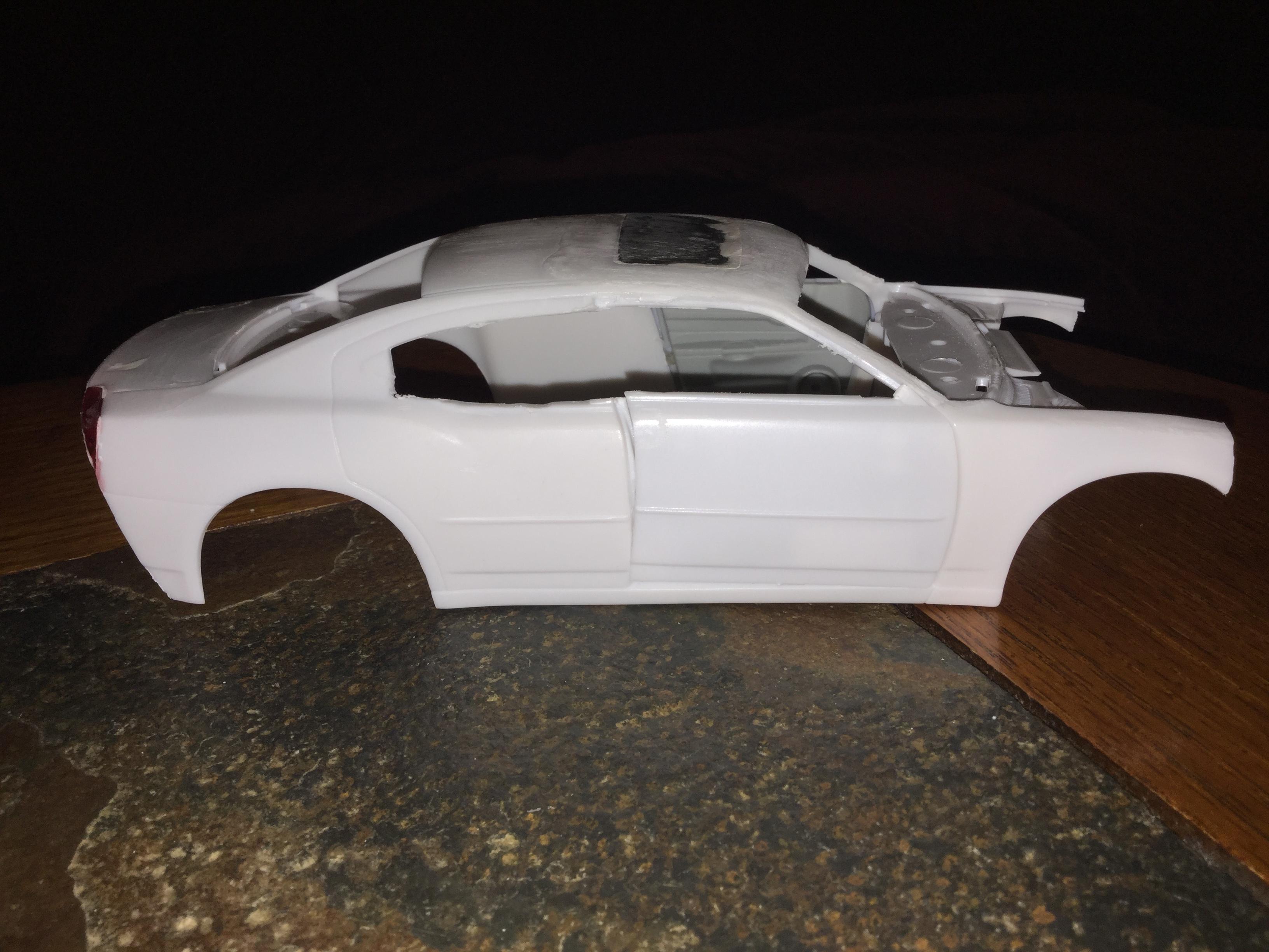

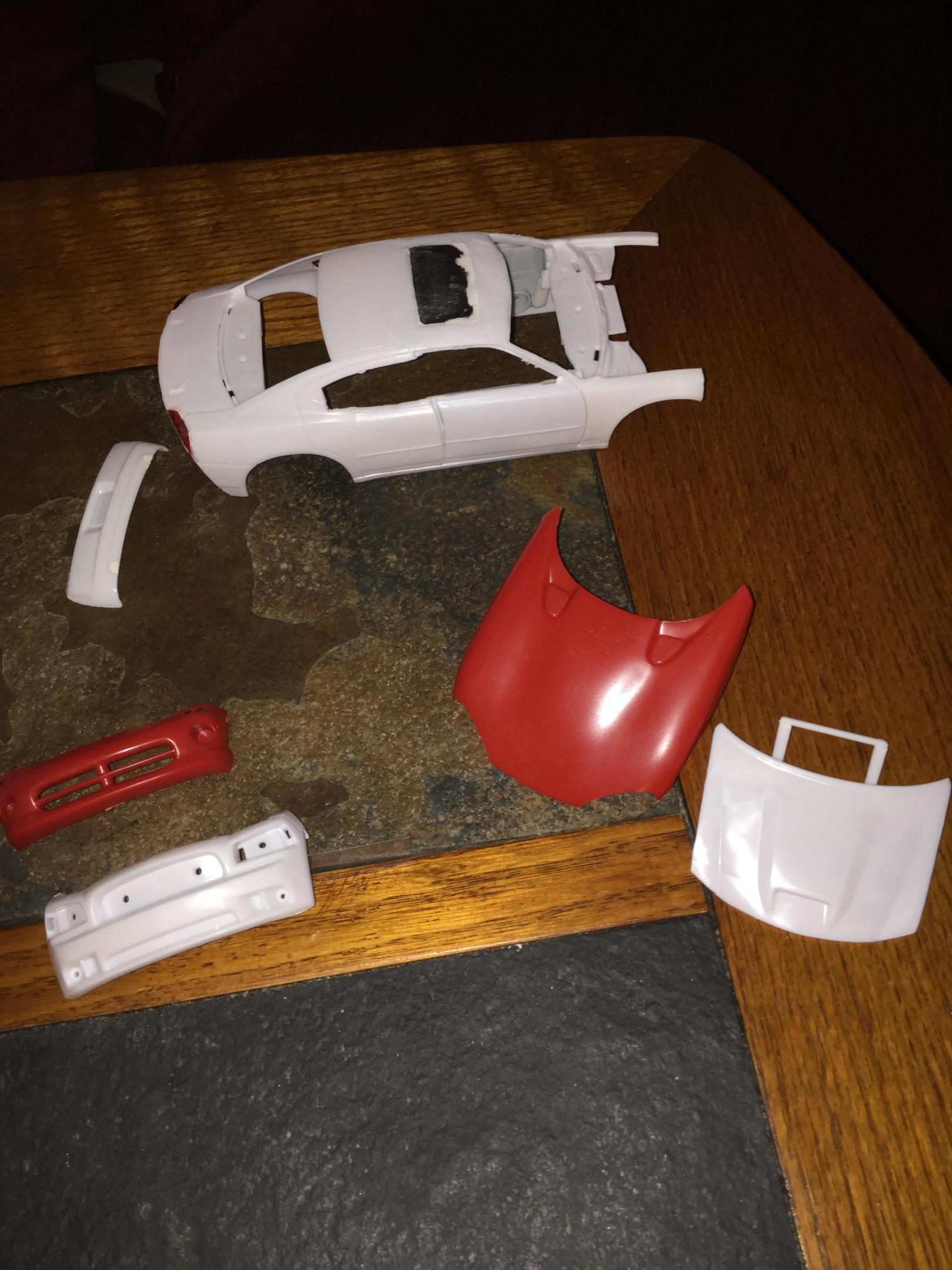

michelle Posted June 12, 2020 Posted June 12, 2020 (edited) i am trying to make the 1999 dodge charger r/t concept i bought two kits i figured would be the best for making it but after starting to mod the one body and getting ready to kitbash the parts from the other i realized some issues i not sure how to resolve in how to join them together into the right shapes and angles i hope someone here can help me figure it out Edited June 12, 2020 by michelle
Mike Young Posted June 12, 2020 Posted June 12, 2020 Not exactly sure how to get there from here, but I think it's going to be with a lot of scratch building with sheet material. I don't think the Viper parts will help much. The prototype is too square edged and flat compared to the Viper being a big, fat bubble. The biggest problem with the production Charger body is that it ended up so far removed from the prototype. It's a shame really, that prototype looks a lot better than what ended up being offered. The newest Charger looks closer to the original idea, but I don't think there is a model available for that. Looking at the prototype and what Dodge was doing back in the 90's, it's clearly based on an Intrepid with maybe some Viper or Prowler parts underneath. They basically put the next generation giant size quarter panel on an otherwise low profile body. There are Intrepid models, but the only ones I found are Nascar models which don't really look like the real car. You might as well start with what you have. The good thing is, the prototype is square edged and flat. It could be done with a lot of flat sheet. You'll have to chop the Charger body down a lot to get the prototype's low dropping hood line and there doesn't seem to be any reference photos of the drivetrain and engine bay. If it were me, I wouldn't bother with a drivetrain and just build it with a closed hood. It would save you a lot of frustration. Focus on the body and close up the bottom promo style with just the oil pan and exhaust sticking down. I'd think about grafting the windshield, A pillars, and front section of the roof from a 2015 Mustang to the back half of the Charger roof. Only because they're really close to what you need, and readily available. I'm just not sure about the width, though, might be too narrow. Maybe someone has one they can measure. You might be able to start with quarter panels from a '69 charger and build from there. Or just shape them from flat sheet. The rear bumper from the charger is close enough you could get a lot of the shape you'll need at the back end. This is an ambitious project, look forward to seeing it.
CapSat 6 Posted June 12, 2020 Posted June 12, 2020 That's an ambitious project. I like what you did with that Challenger Diamante concept! Call me crazy, but I don't see much Viper in the Charger RT concept. To me, the drop of the front fenders and the shape of the nose look a little more like a Firebird- that drop is what you want to capture, and the Viper nose . Maybe keep the Viper as-is since you didn't cut it up yet, and start looking for an early 2000's Firebird kit? Or perhaps a newer Revell Ferrari California.
michelle Posted June 13, 2020 Author Posted June 13, 2020 3 hours ago, CapSat 6 said: That's an ambitious project. I like what you did with that Challenger Diamante concept! Call me crazy, but I don't see much Viper in the Charger RT concept. To me, the drop of the front fenders and the shape of the nose look a little more like a Firebird- that drop is what you want to capture, and the Viper nose . Maybe keep the Viper as-is since you didn't cut it up yet, and start looking for an early 2000's Firebird kit? Or perhaps a newer Revell Ferrari California. thank you and i have a 2002 35th anniversary camaro parts kit would that work
michelle Posted June 13, 2020 Author Posted June 13, 2020 4 hours ago, Mike Young said: Not exactly sure how to get there from here, but I think it's going to be with a lot of scratch building with sheet material. I don't think the Viper parts will help much. The prototype is too square edged and flat compared to the Viper being a big, fat bubble. The biggest problem with the production Charger body is that it ended up so far removed from the prototype. It's a shame really, that prototype looks a lot better than what ended up being offered. The newest Charger looks closer to the original idea, but I don't think there is a model available for that. Looking at the prototype and what Dodge was doing back in the 90's, it's clearly based on an Intrepid with maybe some Viper or Prowler parts underneath. They basically put the next generation giant size quarter panel on an otherwise low profile body. There are Intrepid models, but the only ones I found are Nascar models which don't really look like the real car. You might as well start with what you have. The good thing is, the prototype is square edged and flat. It could be done with a lot of flat sheet. You'll have to chop the Charger body down a lot to get the prototype's low dropping hood line and there doesn't seem to be any reference photos of the drivetrain and engine bay. If it were me, I wouldn't bother with a drivetrain and just build it with a closed hood. It would save you a lot of frustration. Focus on the body and close up the bottom promo style with just the oil pan and exhaust sticking down. I'd think about grafting the windshield, A pillars, and front section of the roof from a 2015 Mustang to the back half of the Charger roof. Only because they're really close to what you need, and readily available. I'm just not sure about the width, though, might be too narrow. Maybe someone has one they can measure. You might be able to start with quarter panels from a '69 charger and build from there. Or just shape them from flat sheet. The rear bumper from the charger is close enough you could get a lot of the shape you'll need at the back end. This is an ambitious project, look forward to seeing it. thank you

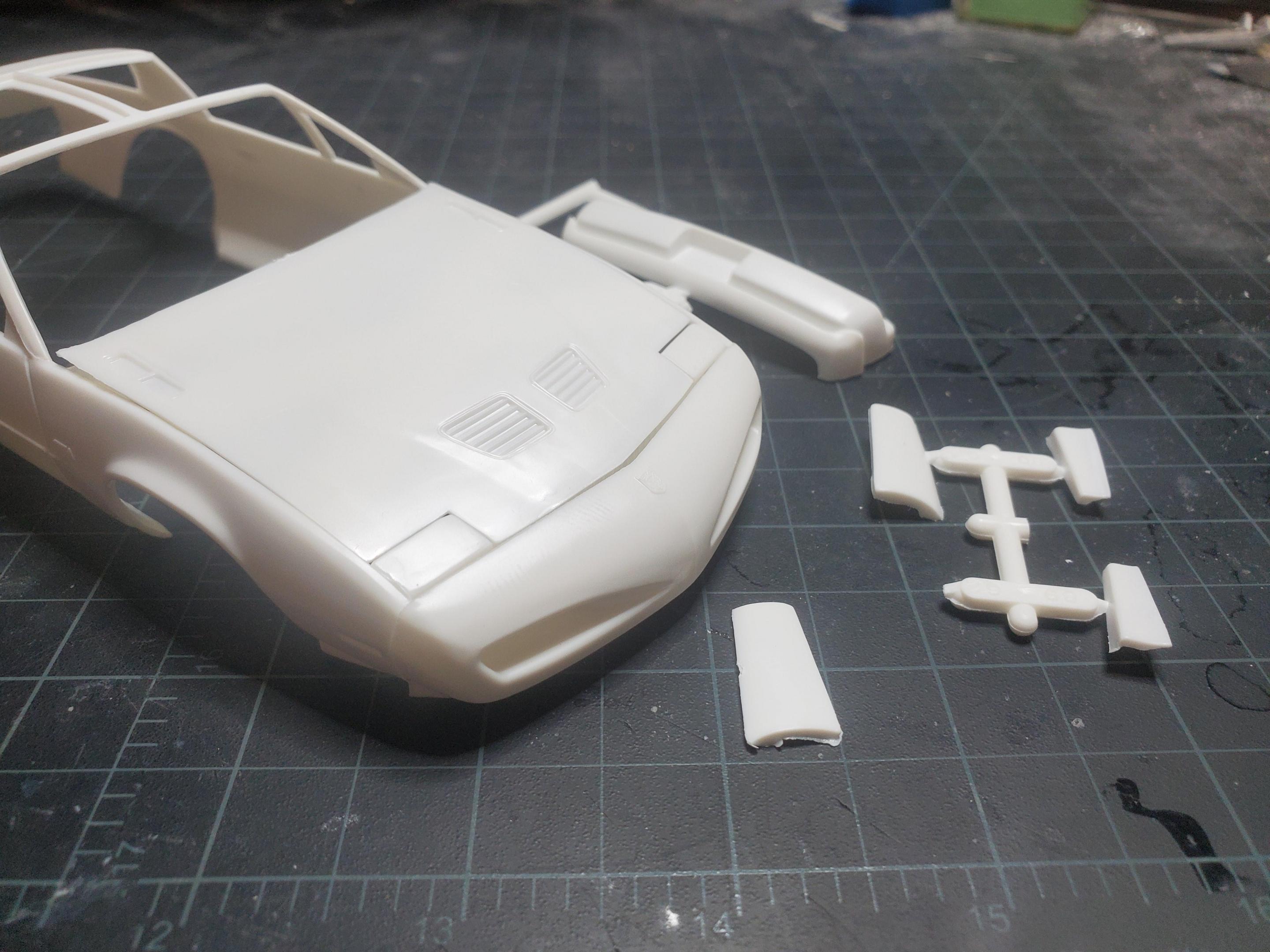

Mike Young Posted June 13, 2020 Posted June 13, 2020 So, I was cruising Ebay today and saw something that made me think of your project. '91 to '92 Pontiac Trans Am GTA. You could almost build your whole front end with the parts from that car. The hood is almost perfect, the fenders are almost just right, and the nose has the right kind of shape and size. Cut the 'egg crate' holes in the nose, come up with some headlights, finish with some putty, boom!
michelle Posted June 13, 2020 Author Posted June 13, 2020 29 minutes ago, Mike Young said: So, I was cruising Ebay today and saw something that made me think of your project. '91 to '92 Pontiac Trans Am GTA. You could almost build your whole front end with the parts from that car. The hood is almost perfect, the fenders are almost just right, and the nose has the right kind of shape and size. Cut the 'egg crate' holes in the nose, come up with some headlights, finish with some putty, boom! thanks

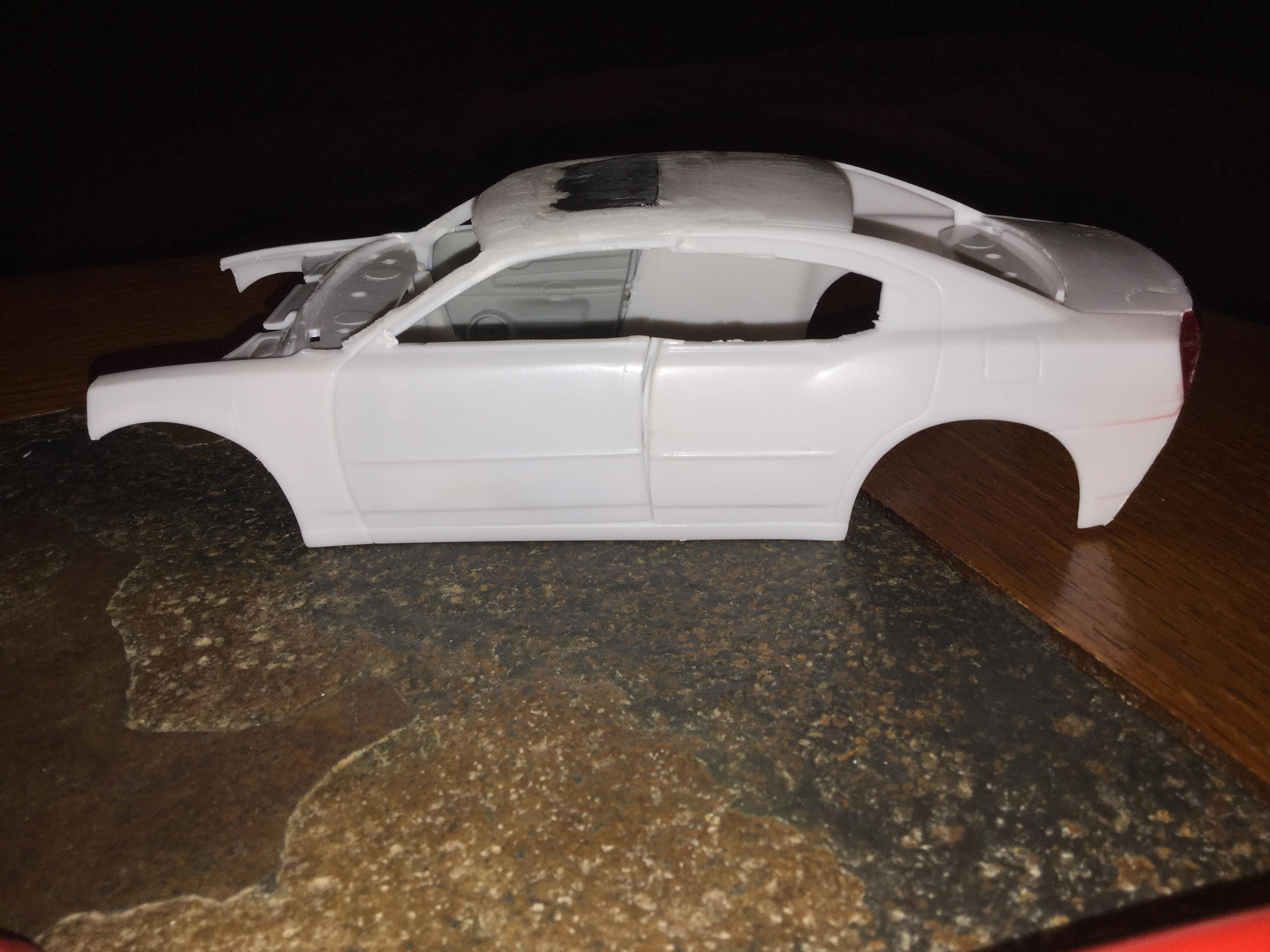

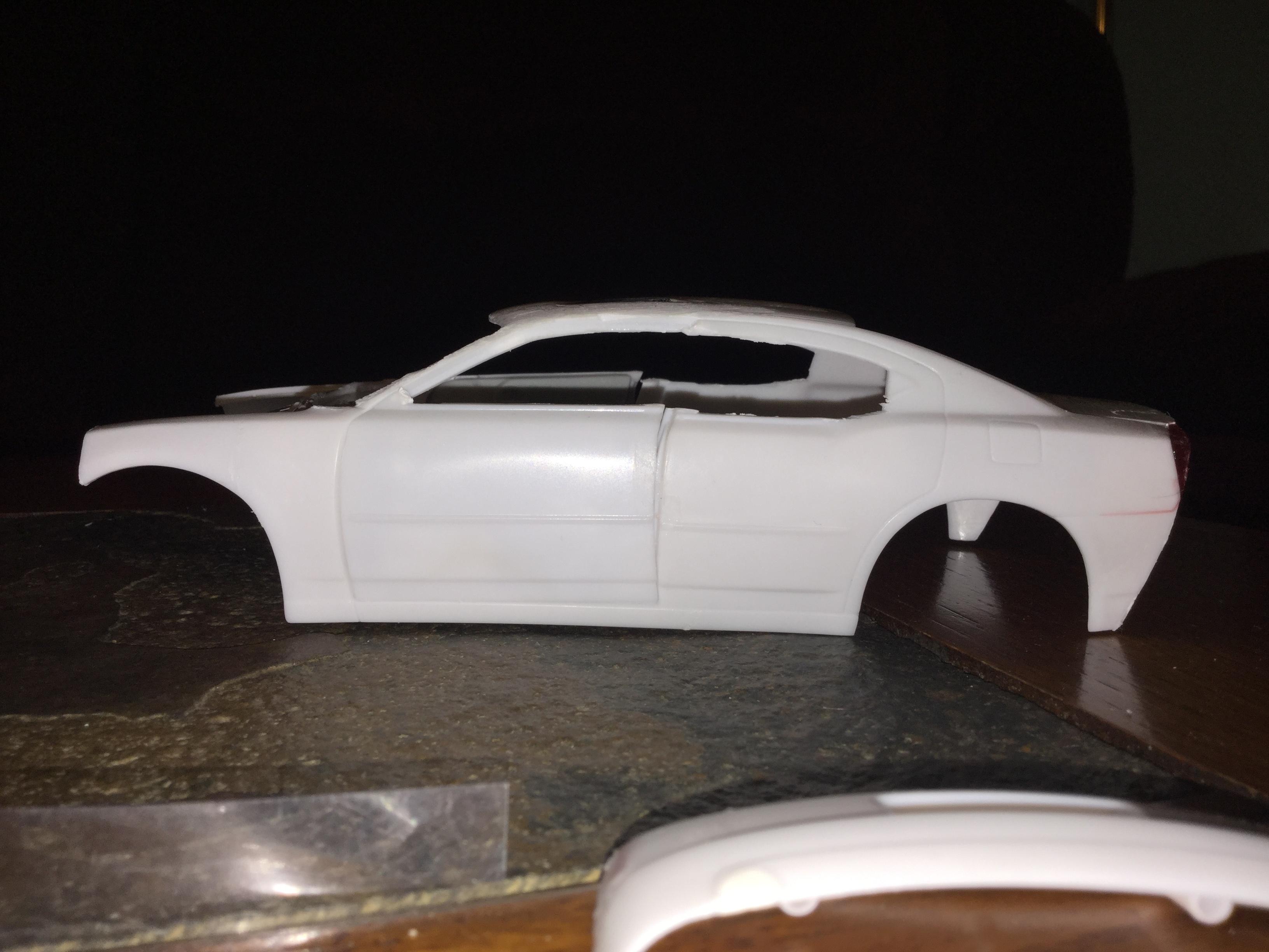

Oldcarfan27 Posted June 16, 2020 Posted June 16, 2020 Michelle, I deeply admire your creativity in wanting to scratchbuild something not available as a kit. However, you picked quite a "doozy" for a first project and I wouldn't want you to get frustrated and discouraged if it doesn't come out easy. If you do want to continue with this endeavor, I suggest using side profiles to get the general shapes right. I would start from the bottom and work your way up. Side fenders, I see a lot of Ferrari and 2007 Corvette blended together. The roof could be from the Charger kit that you have now, but chopped and recontoured. Lots of Sheet plastic and putty is going to have to go into this one. There just isn't a lot of readily available parts for this. Are you sure you're ready for all of this modification? I would suggest start with projects that have simpler mods. Smaller changes, but big on impact. Maybe try making an early 50s mild custom or even a 70s Corvette. Just to get your building skills down first. You can do a lot of scratching and puttying on one of those without having to redesign a whole car. And always remember to do most of your custom work in plastic or some solid base. Don't rely on putty alone to make heavy changes. Putty is easy to shape but won't hold up on it's own without a firm backing. Let it be the final finish to smooth out imperfections, not the "go to" to hide sloppy bodywork. Good luck, and make it fun!
