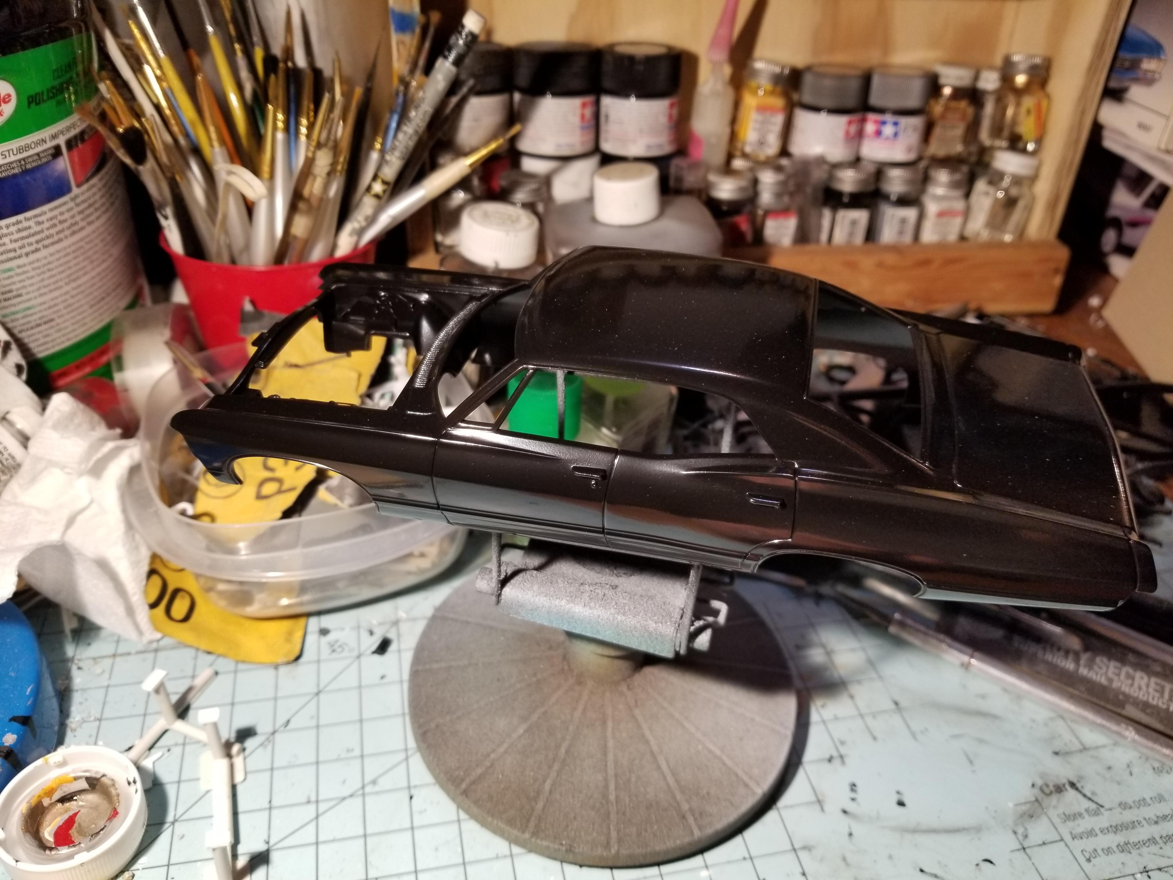

Rbray47 Posted June 19, 2020 Posted June 19, 2020 I was waiting for someone to do a WIP thread on this kit, but I'm impatient, so here goes... My wife is a huge fan of the show, and like an idiot, I told her about this kit when it was first announced. She's been after me ever since to get one and build it. Ofcourse, she wants it as accurate as possible. I started by smoothing out the body (it had a few scratches and gouges, I guess AMT's chicom workers weren't happy about getting back to the factory) I've already laid down some Testors black lacquer. Next I filled in the mounting hole for the console since obviously this car wont have one, and the bench seat only covers the rear mounting hole. I also filled in the rear seat speaker and rounded the edges of the bottom cushion. I wont correct the pattern to match the front, she wont notice hehe. Last pic shows the powerplant swap with the Amt 70 Monte Carlo. The 454/TH400 seems to fit fine. I haven't messed with the exhaust or driveshaft, so I'll worry about that after the rest of the chassis is painted and assembled. Also, I'll be coloring the valve covers with a Molotow pen. The engine as you see it is how I pulled it from the Monte kit (previously started) I'm not going to get too carried away with detailing, aside from fixing the obvious errors.
Bucky Posted June 19, 2020 Posted June 19, 2020 Off to a nice start. Rear seat looks good. Engine looks serious! One thing I noticed is the ejector pin mark in the front carpet. I haven't opened my kits yet, so I'm taking notes of what to look for when I do! LoL
Deuces ll Posted June 19, 2020 Posted June 19, 2020 Some floor mats should be able to hide those.....

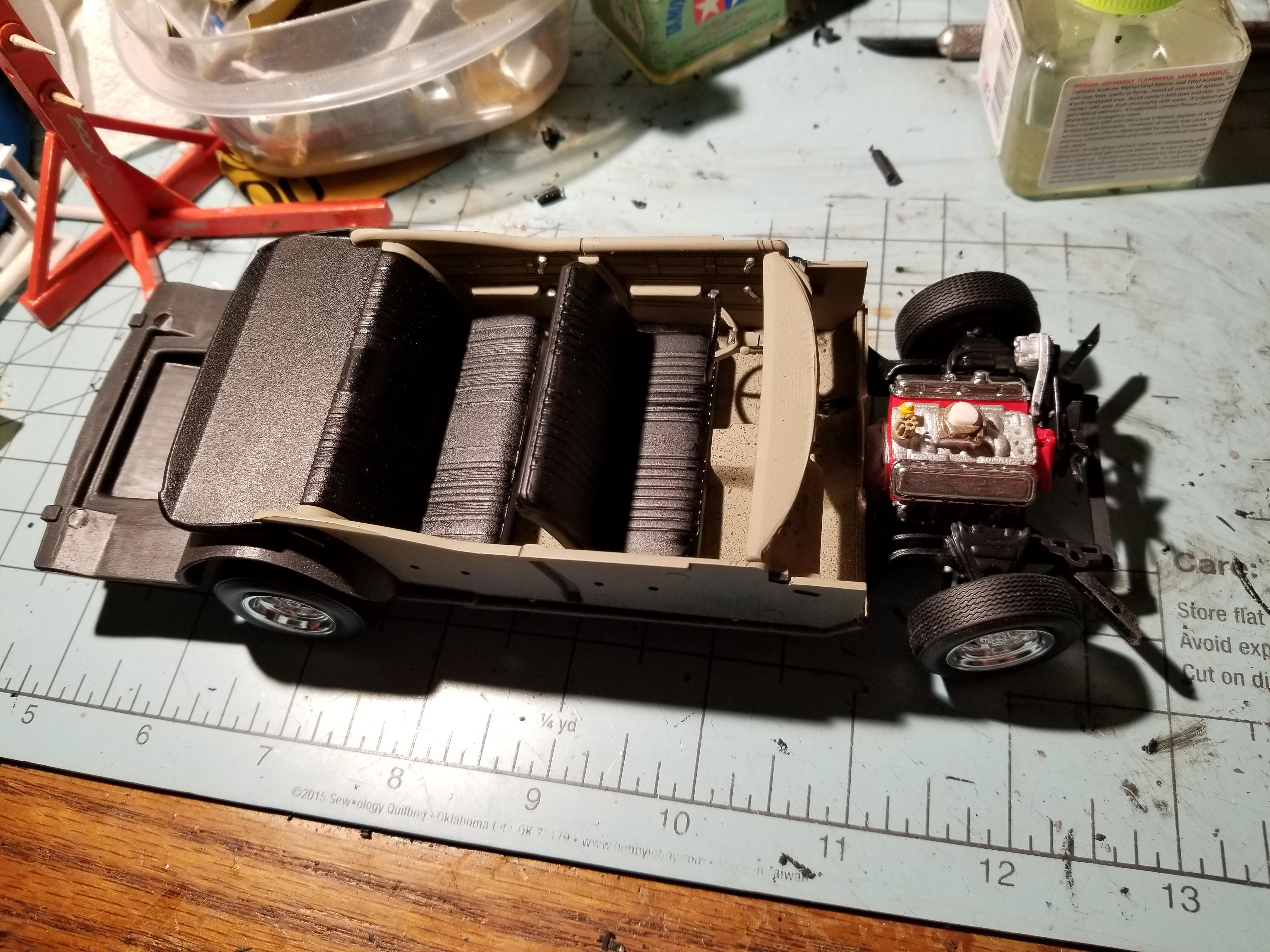

Rbray47 Posted June 27, 2020 Author Posted June 27, 2020 Been busy with life, but still managed some progress. The interior is mostly done. I painted it with Tamiya semi gloss black and Rustoleum flat khaki. I may redo the carpet in a slightly darker shade as I'm not happy with it being khaki with dark brown overspray. Also, my wife (who wanted this car bad) has decided she wants it inside of a wall display with a 1/25 paper Sam and Dean standing beside it. What that means is that I wasted a lot of time correcting things that will likely never be seen. Had I known, I wouldn't have done and engine/trans swap. The TH/400 is shorter overall than the 4 speed, so instead of fixing the driveshaft, I cheated and added about 1/8" of tubing to the tail shaft. On my kit, the hood wouldn't shut all the way. I didnt test fit before painting, either. I ended up grinding the top of the core support until the hood sat flush. I noticed in the built examples from here and Facebook that the car rides high in the front. Dean's car doesn't. I cut the wheel stubs off of the spindles and remounted them to drop it some, and while I was at it I bent the too-wide tie rod until the wheels were turned.

charlie8575 Posted July 2, 2020 Posted July 2, 2020 I'm trying to figure out how to make the front seat correct. I'm wondering if the rear seat could be used as a starting point, and adjust as needed? Charlie Larkin
doorsovdoon Posted August 31, 2020 Posted August 31, 2020 Did this get finished? Would like to see the end result, I built the same car recently and also had fit issues. Like you mentioned, the front sits too high which I found was the chassis not wanting to sit tight to the inner wings. Lots of shaving of plastic on this kit I found.
