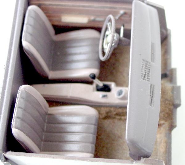

Ctmodeler Posted June 22, 2020 Author Posted June 22, 2020 35 minutes ago, CabDriver said: Just used some of the cheapest of the cheap Michael’s ones yesterday for some interior pieces - worked great! And you airbrush them right ,? Looks good
OldNYJim Posted June 22, 2020 Posted June 22, 2020 (edited) Yes sir! I thinned this stuff with a drop of Windex (just because it was the thinner that was closest to hand right that second ?). Didn’t need much though, just a drop. The second pic shows the seat after I gave it a light buff with some Novus cleaner to give a little more sheen, but for a matt finish I could’ve just left it alone ?? Edited June 22, 2020 by CabDriver

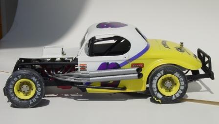

TarheelRick Posted June 23, 2020 Posted June 23, 2020 I use these paints quite often, takes a bit of trial and error but they work very well and the color palette is unbelievable, they are even offering metallic paints now. This El Camino interior and the Willys modified were both done with cheap acrylics.

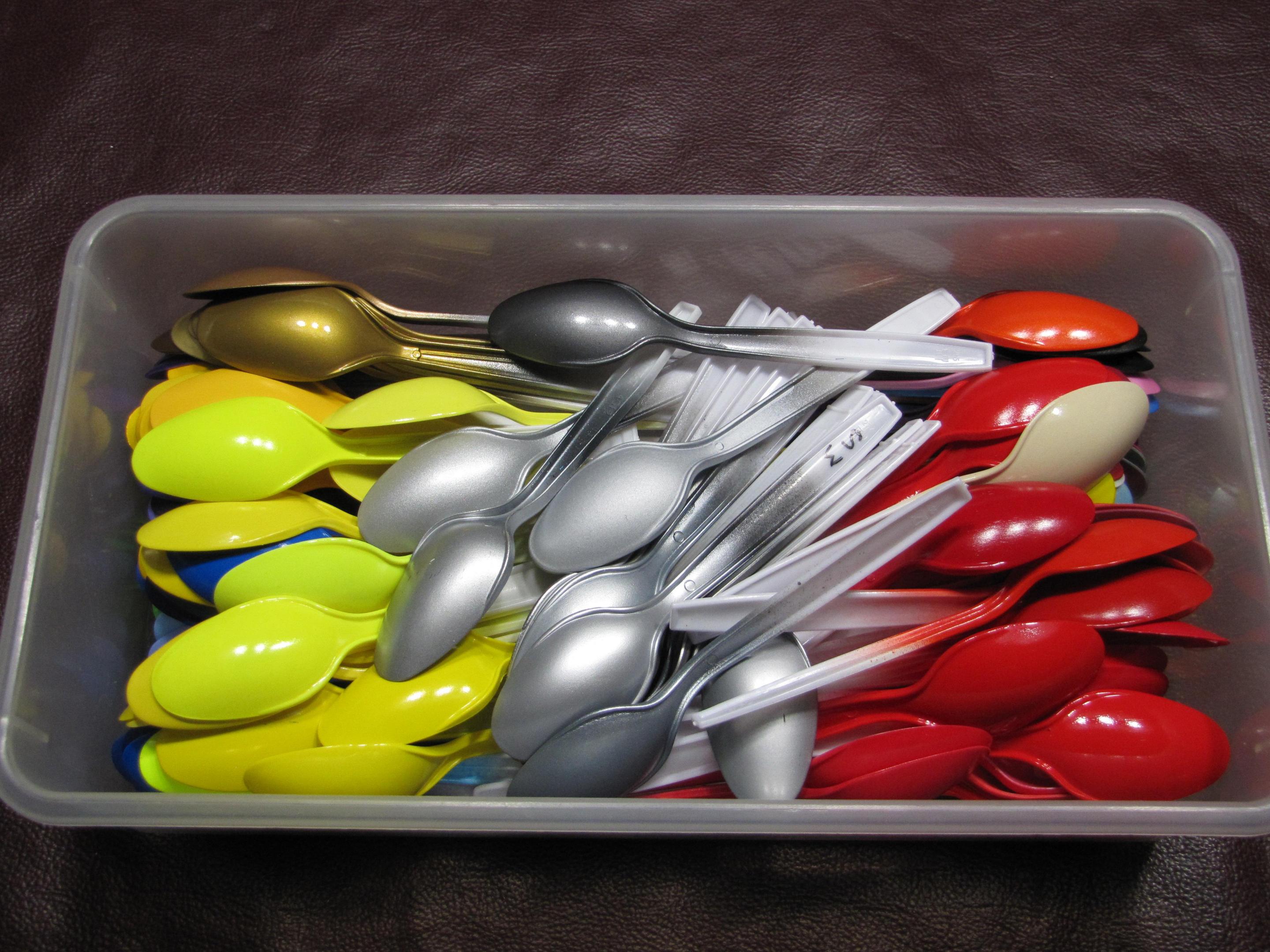

Kmidd65 Posted June 23, 2020 Posted June 23, 2020 Agree with all the other comments, use these all the time. One of the biggest issues is how the color will look once it is dried! What you see in the bottle will dry a bit darker. I also clear coat all my craft paints with Rustoleum 2x clear, Testors Lacquers, or varnish if hand brushing. The results with a clear coat will also differ from the color in the bottle or dried! Whenever I have the airbrush out, I have spoons primed that I then test colors and clear coat for later project ideas. I agree, large plethora of colors and mixing abilities with the craft paints. I also add Future/Pledge to my thinned acrylics before air brushing. Seems to help with durability and tip drying issues (airbrush). All the spoons in the attached image are craft paints, most cleared with the 2x. Definitely give it a try!
