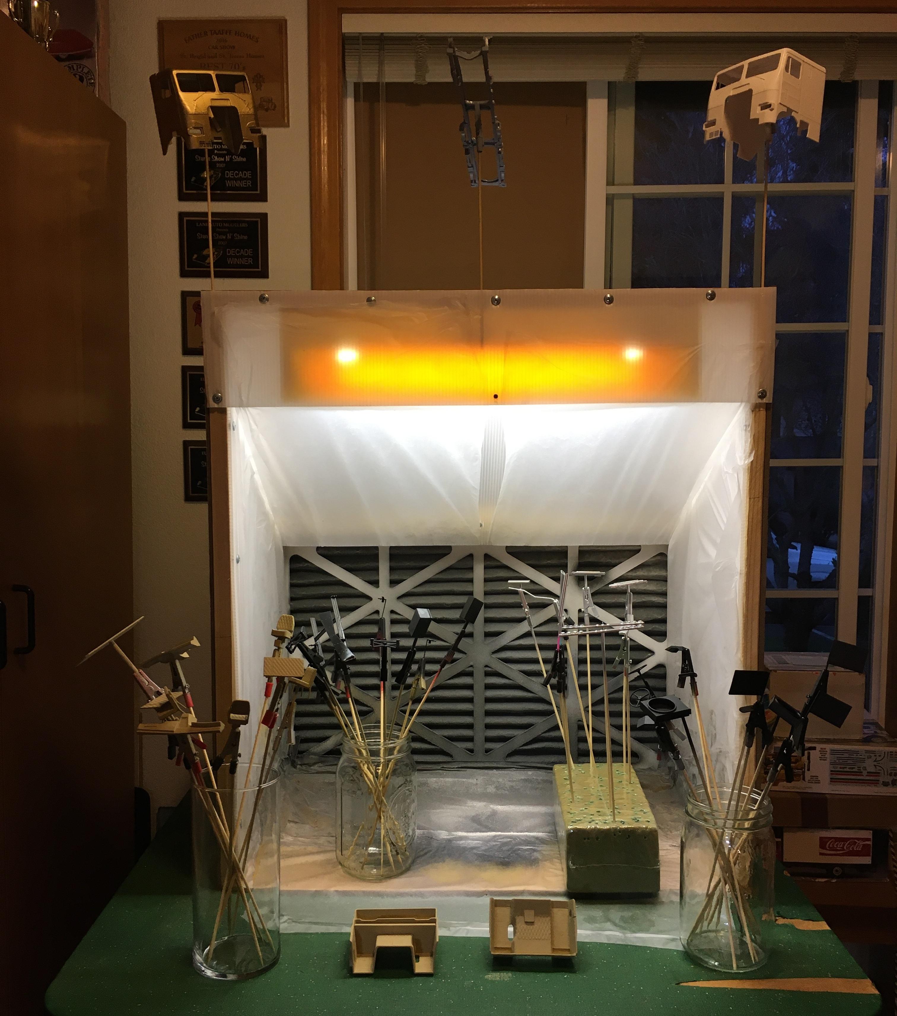

Bills72sj Posted August 12, 2020 Posted August 12, 2020 On 6/30/2020 at 9:08 PM, peteski said: Tried it once, years ago (on a recommendation for a modeling forum). It left lots of adhesive residue after I removed it. I tossed the roll in the trash - never again. I use Parafilm. I prefer Parafilm as well for masking. However, Press and seal does an ok job of keeping my paint booth walls from collecting build up and of dust and overspray. Pull toss and reapply.
